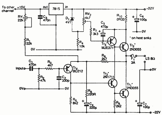

here one explendid class A schematic.

Just a slight word of caution. The circuit that destroyer X just posted was origianlly published with one small mistake. It is the JLH from 1996 and the cap (C4) in the lower fb arm should go to earth and not to the -ive power supply rail. This is a very good place to start using all your old 2n3055's. A very extensive discussion of this design can be found at Geoff Moss's site which is referred to frequently in the "JLH 10watt class A" thread.
