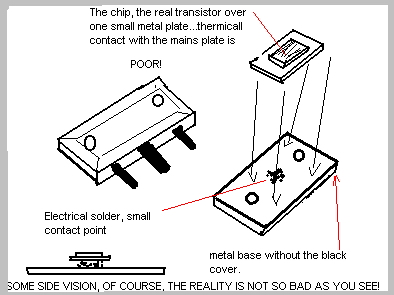

There are many bad constructions...i love Sanken devices...but the heat transfer is deeply stupid...the real transistor, the chip, is fixed in a small metal plate that is electrically soldered to a bigger plate that will be the real thermal conductance plate.... this method is awfull to heat transference.
Despite of that, those transistors are very powerfull...but could be better...maybe 20 percent better if better constructed.
