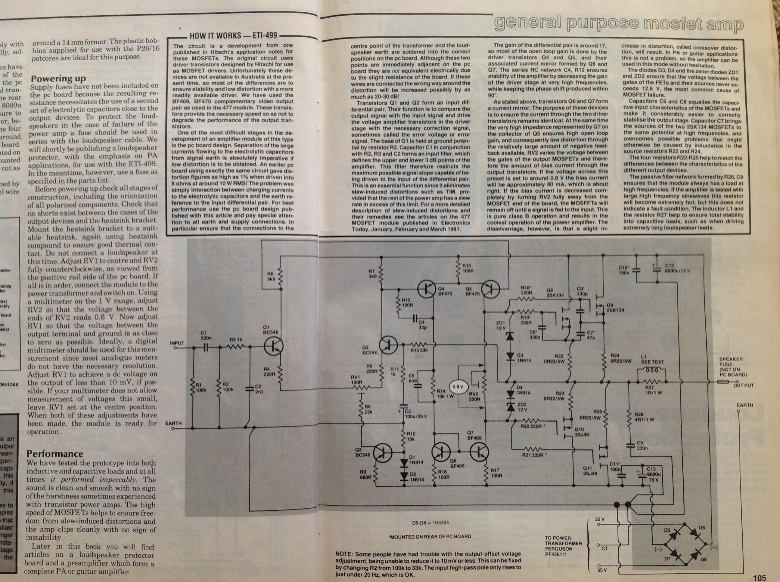

I was just flicking through my old eti magazines and found this. It's project 499 general purpose mosfet amp on p.104/105, from ETI Audio Projects Dec 1982.
That sch is wrong.
The top side outputs are drawn upside down. The bottom side uses Nchannel symbols.
I wonder how many other mistakes are in there?
The bias voltage of 0.8Vbias could be correct. But it's more likely to be ~1.5Vbias to turn on the two gates.
The mosFETs really need an EF stage after the VAS/TIS.
RV1 is a terrible way to adjust output offset. Don't do that !
Compare the front end to any of the SymaSym variants on this Forum.
Well spotted, I've looked at that schematic loads of times and not even noticed the mosfets are drawn incorrectly! Anyway when I was fiddling with these mosfets in the 1980s and 90s I used the voltage drop of a diode for each mosfet. So in the above diagram the bias voltage would be about 1.1v resulting in about 70ma per mosfet. This amp was intended by eti as a PA amp so the bias was kept low to keep it cool. But the crossover distortion on mosfet circuits like this is worse than the equivalent bipolar emitter follower which is why the negative feedback is so high in an attempt to correct it. Modern double pole compensation techniques would lessen HF distortion even further. But run at low voltage and in class A this amp's THD would be vanishingly low. Further things I fiddled with were to short out C3 altogether and thermally couple both input transistors.

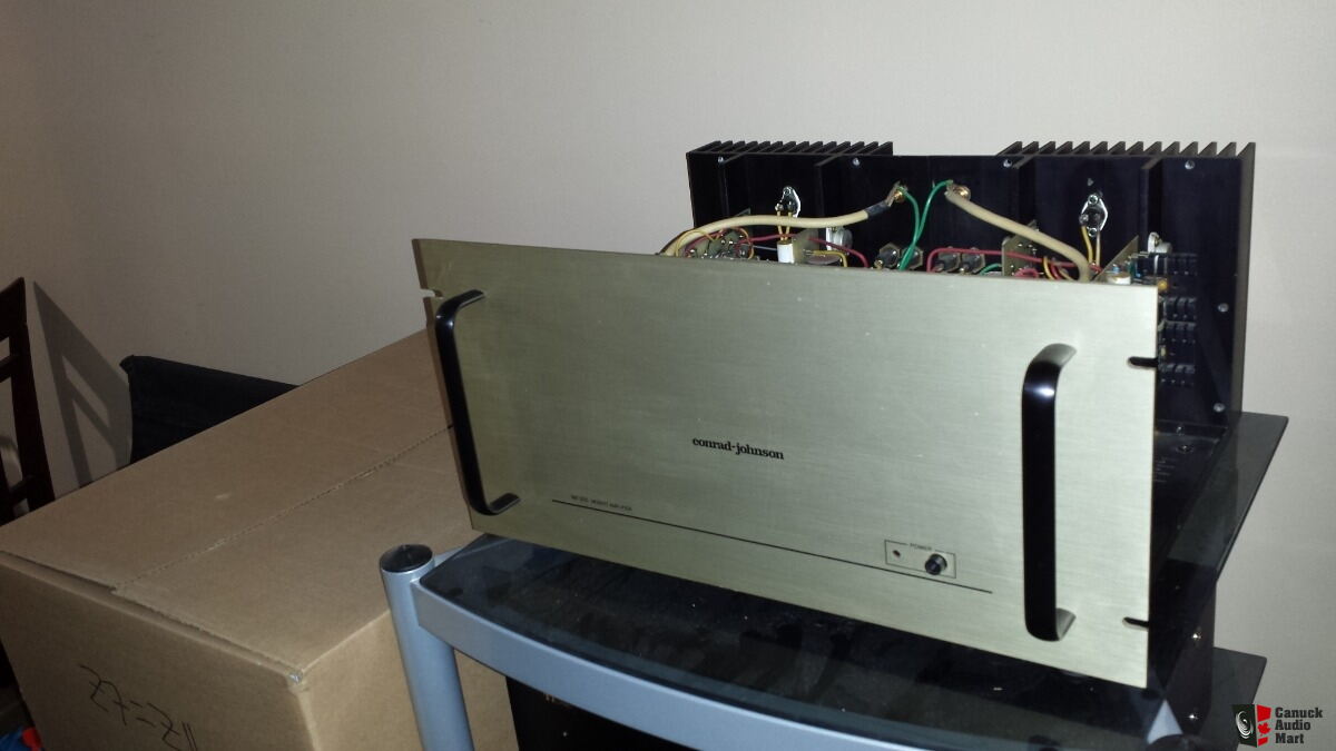

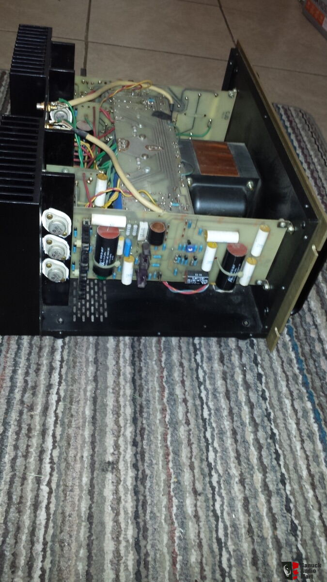

Most models of Conrad Johnson are tube amps, but any few models use the mentioned MOSFET's in the output stage in Class-A mode

Thx so much and I greatly appreciate this but I am not seeking a hybrid design. I am looking for a full solid state design. Also when I go online to seek out the specs for the CJ amp and look at the schematic it appears to be biased in its first few watts Class A then its a straight AB class amp at 200 watts. I was seeking a full on Class A amp design with 25ish watts that could use the noted Hitachi devices and I have done a good bit of searching and have not found any.
