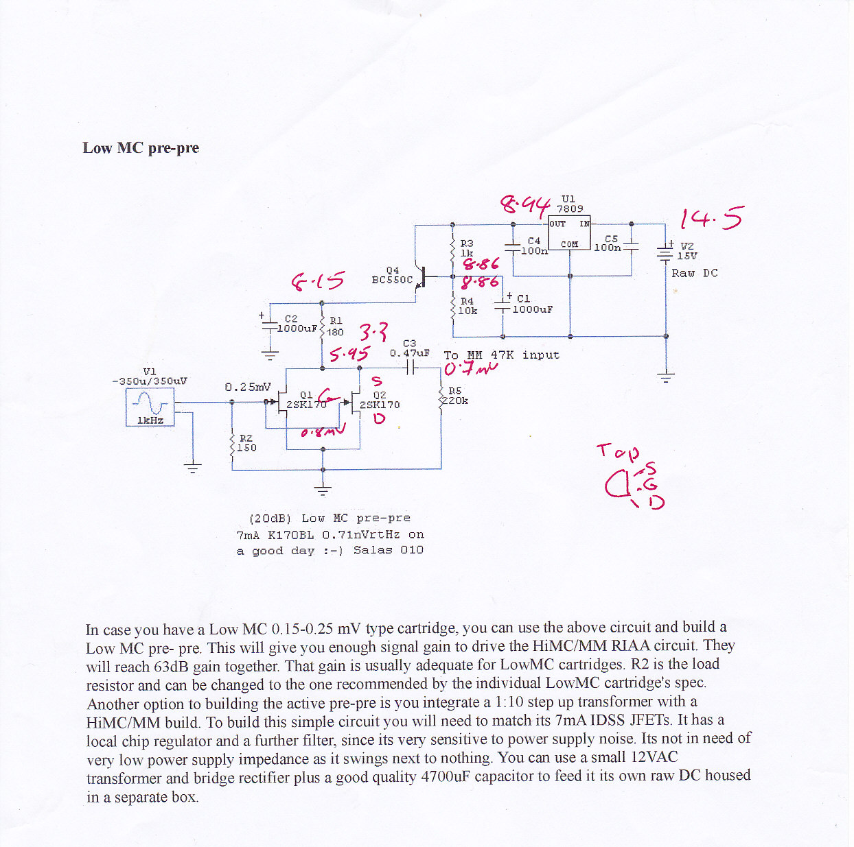

2SK170 BL MC step up amp
I have bought the remaining parts i needed and dug out an old 16V ac supply. I will need to build a bridge rectifier out of 4 of the diodes I have to get some DC to the 7809s. and a smoothing cap 4700 x 25v should do it.

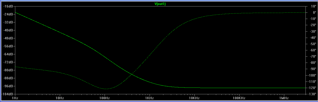

Will surely do it. See its really 16VAC off your wall, if more, use 35V cap for longevity. See to use good quality proper value load resistor for the cart (evaluate a couple, don't follow the manual's minimum blindly), and VERY good quality 0.47uF coupling output cap. Will be happy to know if it worked for you well enough.
P.S.
That is what the specific post 7809 cap multiplier filter in your circuit is supposed to do for cleaning its DCin (LT SPICE sim).

You can try whatever instead of the 7809 but leave the multiplier noise filter that comes after the 7809 there. That one defines the PSU Zo also. See not to have serious heat sources near the input JFETs.
Hi Salas,
I have fired this up without success. I have measured some voltages on the circuit attachment. Fets are IDss 6.5mA What do you think? I have only fed signal from my cartridge as i dont have anything with such a low output. If the dc readings look ok i might make up a divider from the cd ouput as the next step.
cheers
Craig
Thanks Salas i'm embarrassed to have them in the wrong way.
After reversing I still can't get any sound through either of the amps though.
I used different fets this time matched at 8.5 mA IDss is this ok?.
This is a question on my skills with so few parts!!!
Does the 5.95v measured at the drains seem ok?
Measuring output resistance gave 224k input resistance was as per loading value.
Are the two fets in parallel to reduce the noise?
I made them on perf board so i will check the layout again.
Thanks for your assistance
