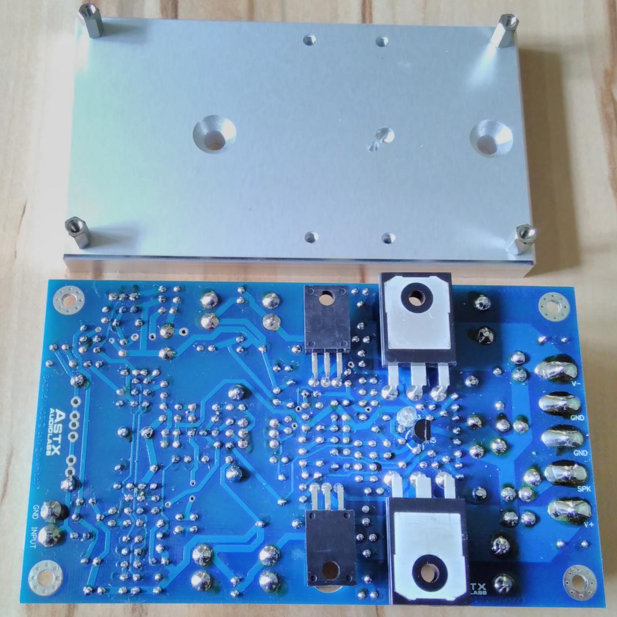

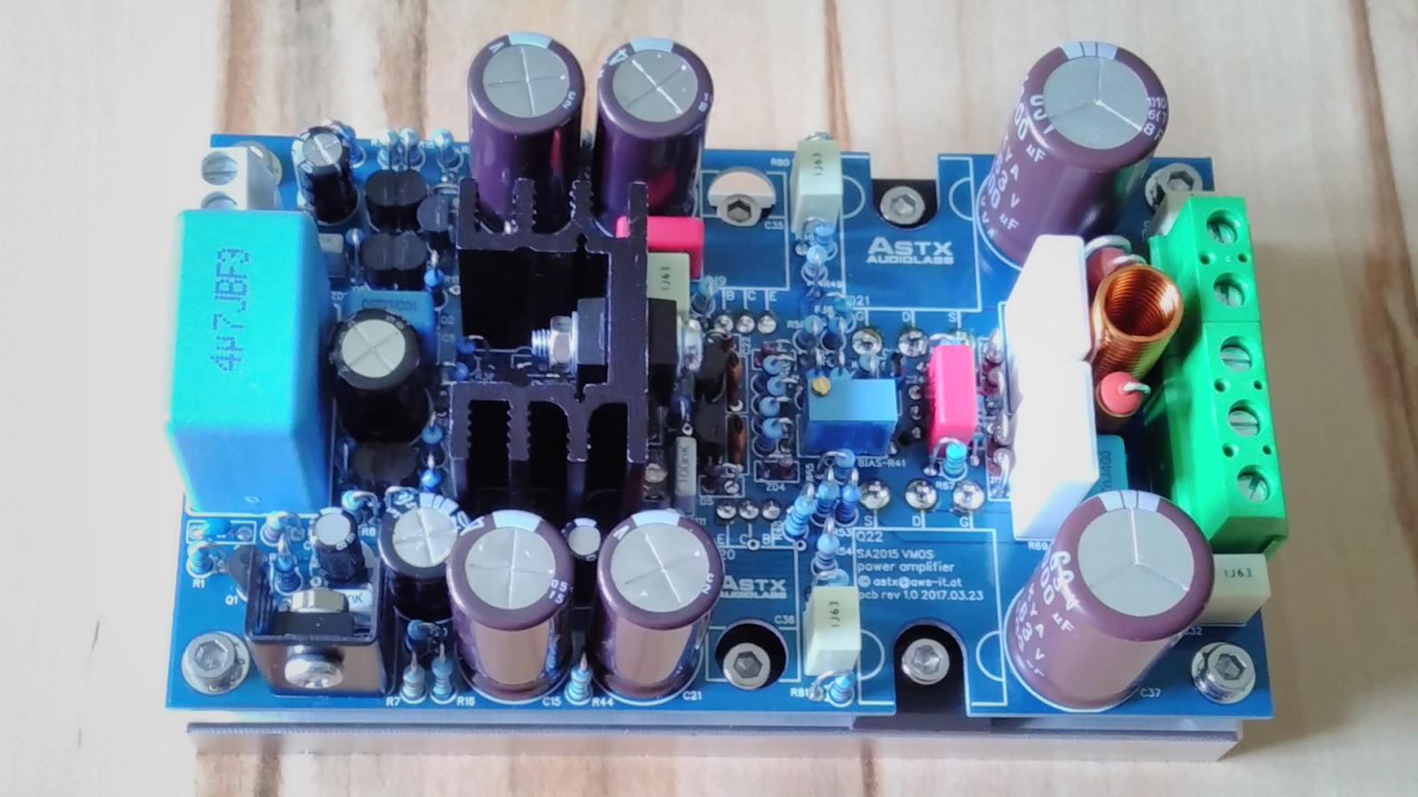

SA2015: using vertical mosfets IXTH80N20L and IXTH48P20P
heatspreader - to be mounted with 2 x M5 on big heatsink.
Joined 2011
Looks very nice!
Quick question: why do you use a heat spreader? Isn't it better to mount the PCB directly to the heatsink? This way there is a temp junction less.
Thanks! Of course they are not really necessary but I use it because:
  • heatspreader 10mm thick is manufactured at a CNC fab including M3 screw tapping which I hate. Making M3 taps soon becomes a night mare and your heatsink is afterwards unusable
  • heatspreader only requires 2 x M5 tap which can easier be done by yourself
  • you can use even multiple main heatsinks with lower base plate thickness. E.g. "Modu pessante dissipante" case comes with 2x heatsinks on each side.
  • you could use heat pipes if you need many modules in one case
  • it looks cool
BR, Toni

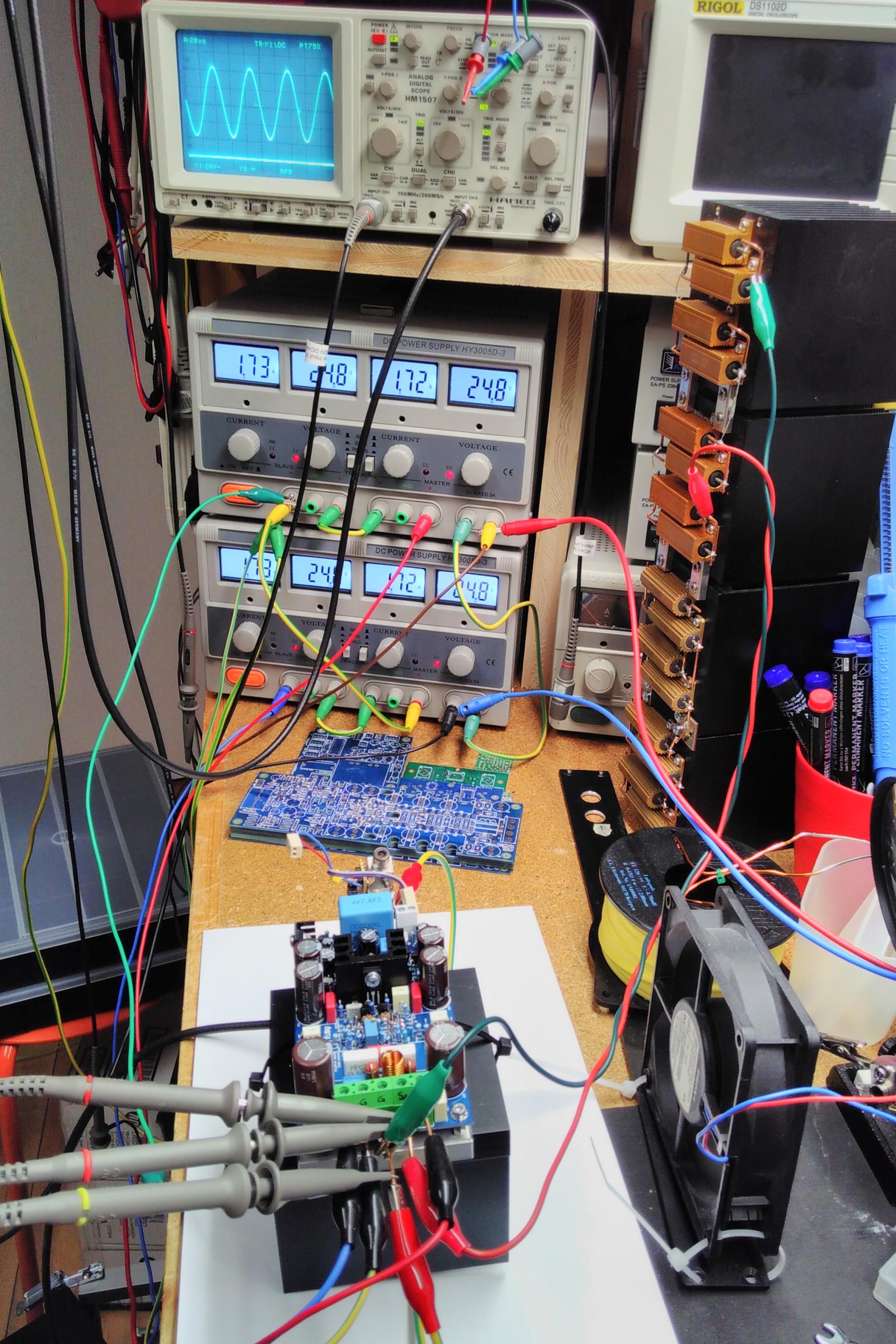

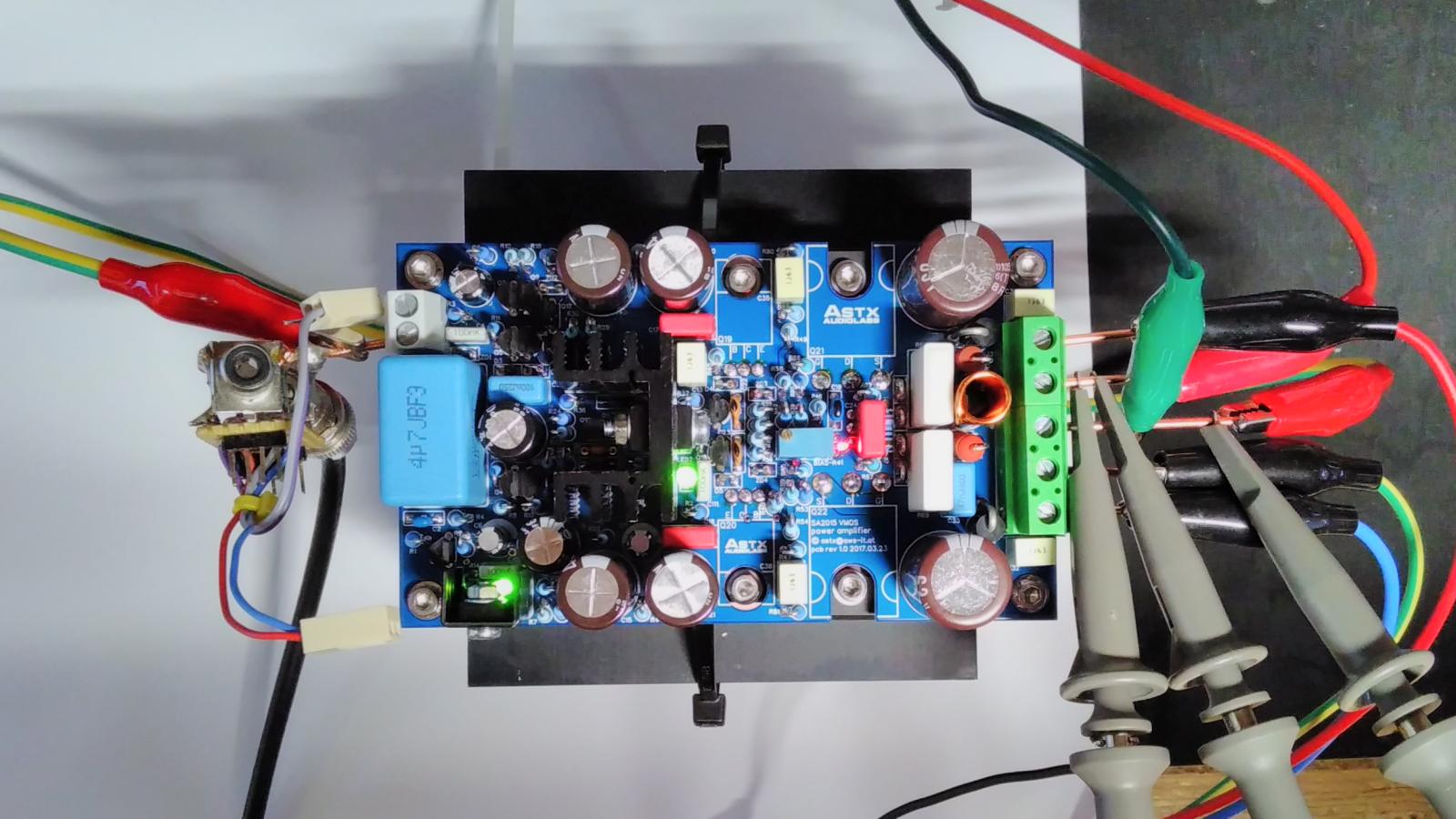

Joined 2011
... alive out of the box.
  • VAS diode and over current protection in situ
  • THD20k 100W@8R: 0.0045% (80k bw.)
BR, Toni

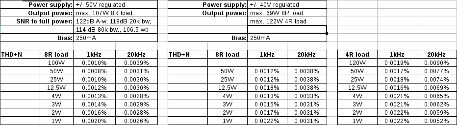

Some measurements, see attached picture.
Driving 4R load with +/-50V supply is not specified.
The amplifier modules have been soldered with components out of the box. No matching of any component values have been done. For LTP and current mirrors I have used transistors from same lot.
VAS diode and dual slope current limiter are in situ.
The distortion analyzers (Panasonic/Levear VP-7723D) sweetspot wasn't optimized during testing of lower power modes (1 - 4W). So it is expected this circuit to have better distortion figures in the "first watt" range as shown in the measurements table.
BR, Toni
The results confirm D.Self's "Load Invariant" philosophy.
The higher current load increases the distortion. In most cases @ the same power into the 4ohms non reactive load the distortions are roughly doubled.
To me it is slightly surprising that the higher supply rail voltages significantly reduce distortions into the 8ohms non reactive load.
Is there an explanation of why this is so?
Yes.
At HF, one of the biggest THD factors is wonky Cob of the VAS. Cob is reduced at higher Vce and hence, also its wonkiness, for a given output voltage.
Maybe because I don't fully undertstand the AC theory of a complex amplifier, I thought that the Cdom version of the VAS with lots of it's own HF feedback and that there is another gob of global feedback that the VAS Cob generated distortion was reduced to nearly unmeasurable levels.
But that is not what ASTX has measured.
He has ~38ppm @ 40Vdc reducing to ~30ppm @ 50Vdc. 12.5W into 8r0 @ 20kHz
That's high levels of distortion for a nearly "Blameless" style of topology.
And that is why I was surprised.
A dual slope limiter always injects some error currents from rails...

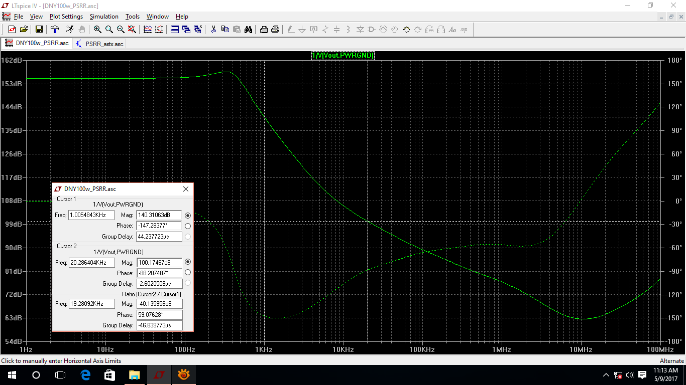

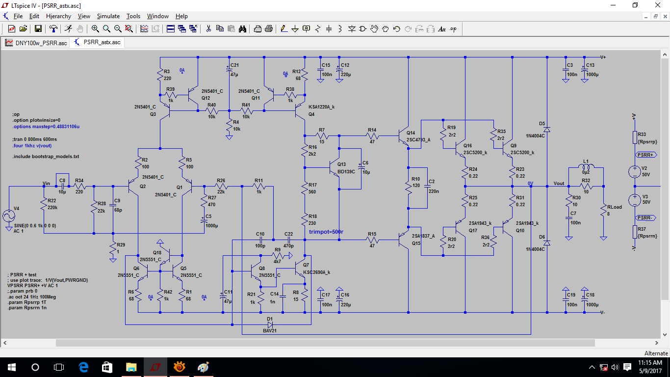

Hello,
Has anyone tried the PSRR directives of astx amp to a different schematic? I tried it on my schematic but not sure if the plot shows the correct figure. I do not know how to derive the Rpsrrp & Rpsrrn values, input source is a typical AC sine wave with an amplitude of 0.6v at 1KHz freq. It roughly outputs 50w of power. Shown is my schematic and the graph plot with the cursor set at 1KHz & 20KHz respectively. PSRR test is + rail only.
Sorry off topic but got a post approval from Sir Toni.
Sa muli,
Albert
Joined 2011
Rpsrrp and Rpsrrn are switches:
  • value 1T = switch open
  • value 1n = switch closed
During test of PSRR you need to disable input signals! Cut the trace from "V4" to "Vin".
"PWRGRND" is not viewable on picture - is it low ohmic connected to ground?
