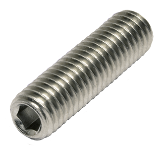

An option to increase thread life in aluminum is to use long set screws as studs and leave them in the heat sinks.

Install the studs/set screws in the heat sink and attach whatever to the heat sink with nuts. No wear/damage to the aluminum threads this way.

Another option is to use a tap that "forms" the threads rather than cuts them.
These work well in Aluminium, no chips and the tap is less likely to break, not weakened by chip clearance slots.

The drill size for a thread forming tap is bigger than the drill size for a thread cutting tap.
You will need to find out what drill size to use for the material you are working with.
Aluminiums are quite different formulations and I suspect this affects the drill size.

I will try using this one: gewindebohrer.de - BAER HSSE-TIN Forming Tap M 3 x 0,5 - DIN 371 with oil grooves 34TD70320601
You will need a
- 2.8mm drill for M3
- 3.7mm drill for M4
- 4.65mm drill for M5
BR, Toni
