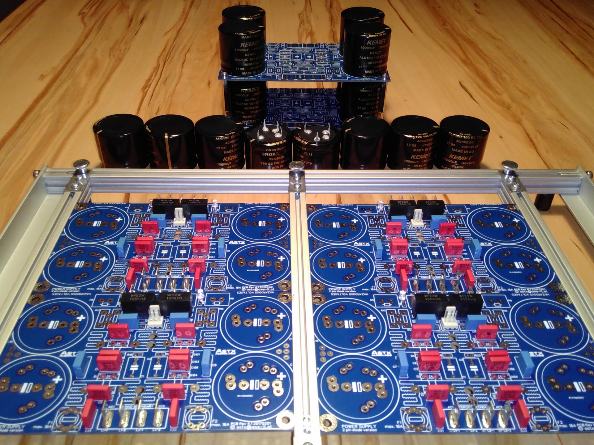

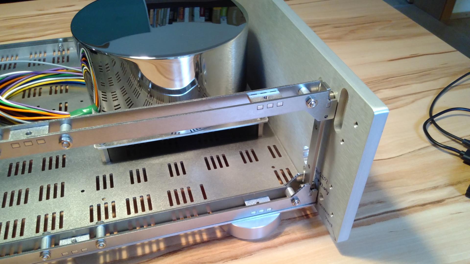

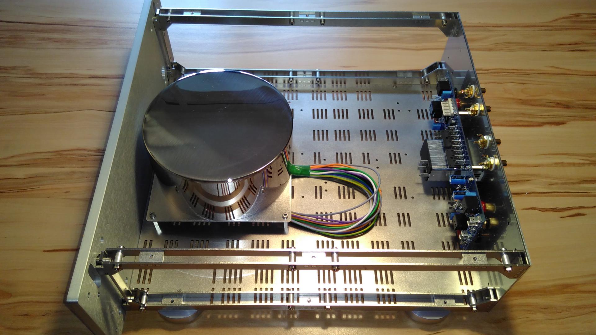

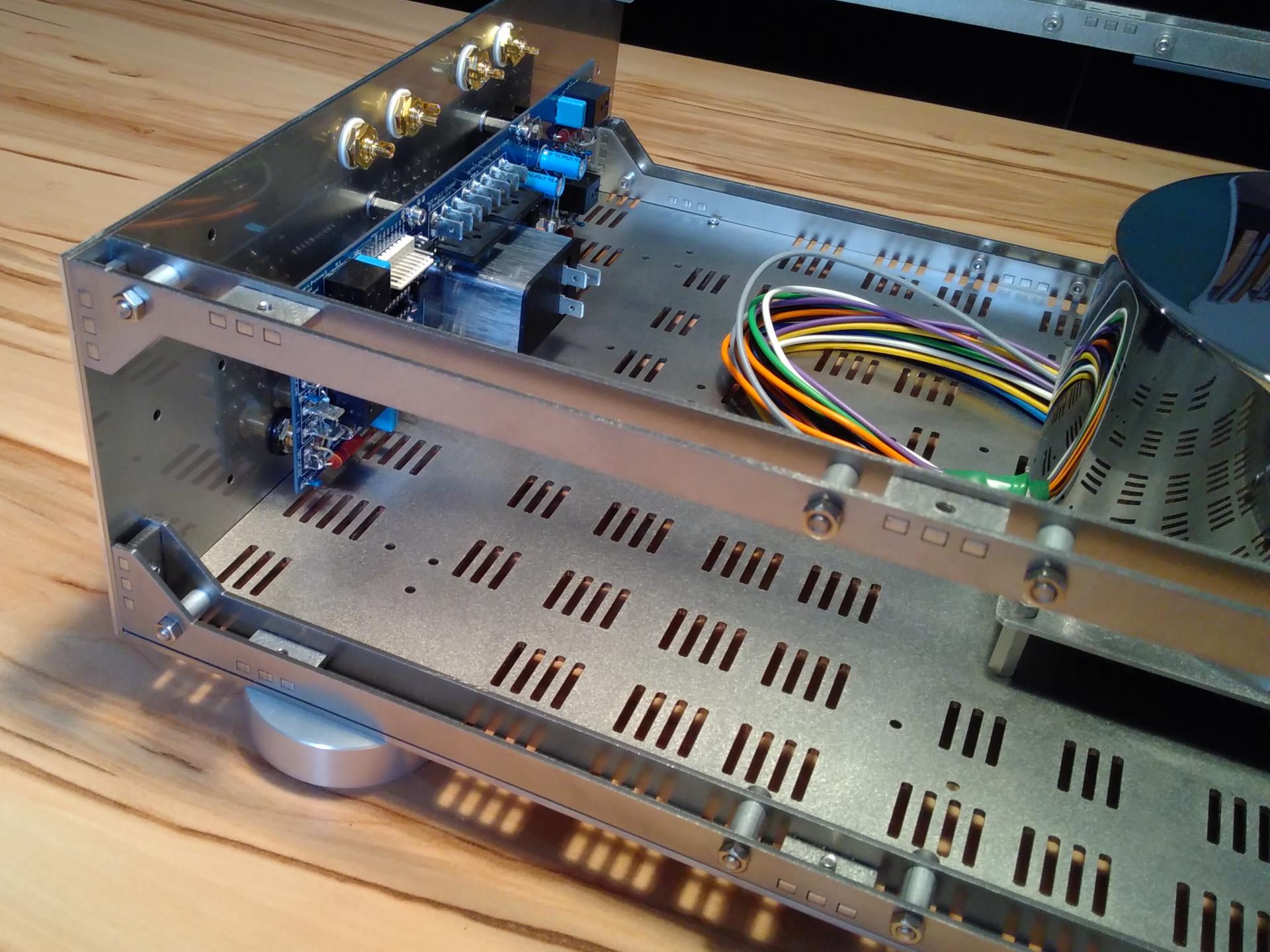

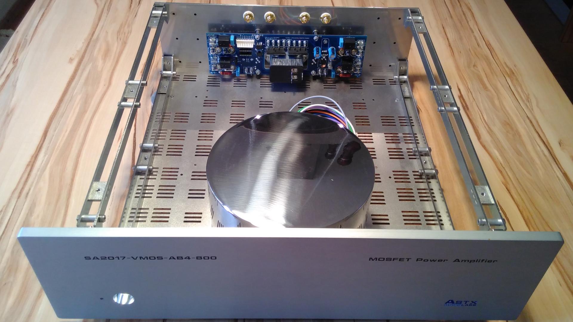

SA2015 4 channel VMOS - case layout
... added bottom. fits exactly. puuuh 😎

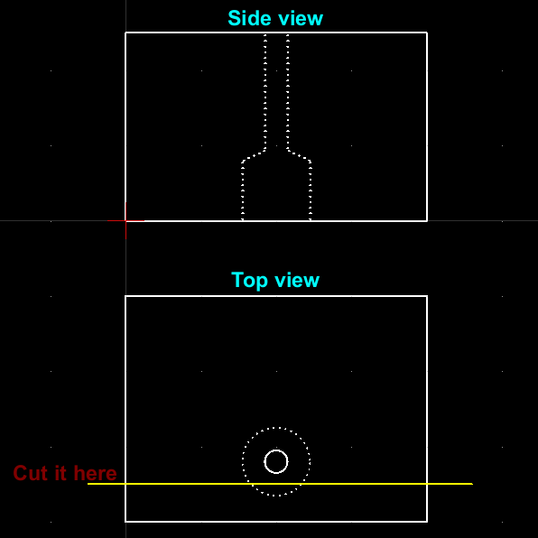

Something like this?
My screw tap needs room for the swarf. Maybe designing the wood-helper with a bigger, short hole from bottom and cut it to have room for the swarf/chips. As a side effect you can see what happens ...
BR, Toni
Mine's just a simple hole drilled to fit the tap snugly.
Of course your correct size drilled hole needs to be vertical too so best done in a drill press.
If you haven't got a drill press, find a friend with one and drill a couple of vertical holes in scrap plywood. One to fit your correct size drill and the other to fit your tap.
And thimios advice about using oil (any type) and "one turn (or less) in, one turn out" to break the swarf is important too.
That and with my 2 pieces of scrap wood, you can hand drill and tap (with crappy T handle taps) very quickly in Aluminium heatsinks.
