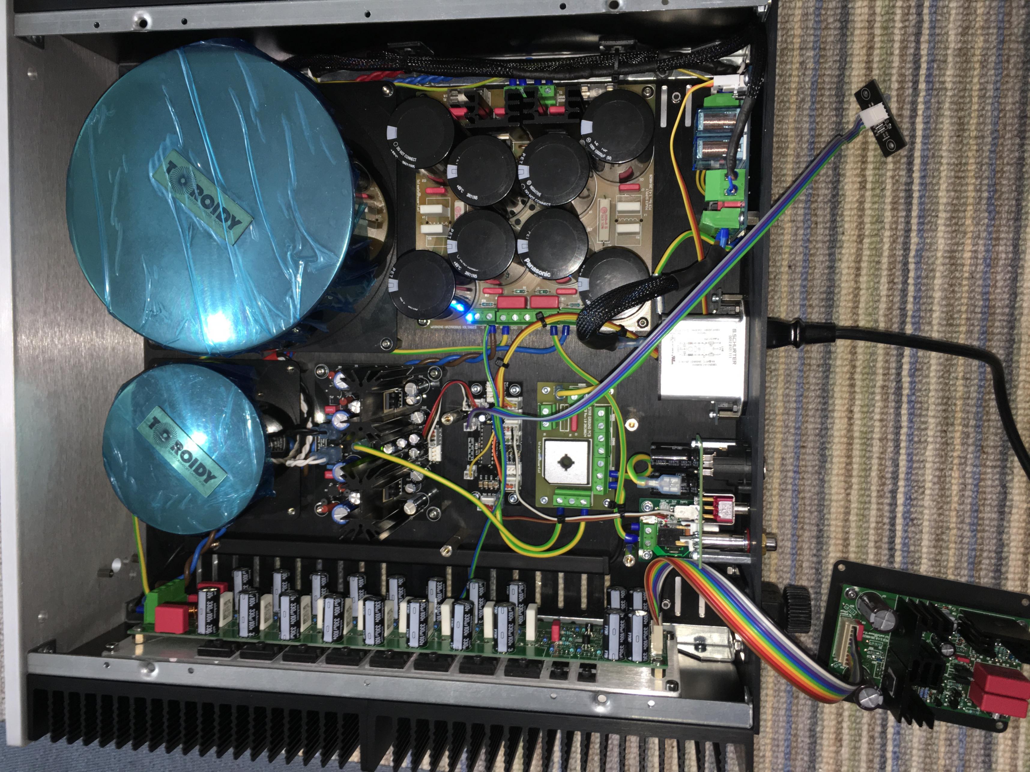

First power-up of my 120V mono build of astx's SA2014 amp. No smoke! 🙂
Unfortunately all my audio gear has been relegated into the utility room of our new house in Miami. It seems my wife is reneging on the deal we had re where I could place my gear made at time of purchase of the house. This is the problem with arriving 6 months after her. Possession is 9/10th of the law and she has taken full advantage. I will have to drag a speaker out to test the amp, perhaps with my iPhone as the source. 🙁
Dear Steve,
really really nice! Congratulation that it works out of the box!
Are you planning an iron shield between output stage and toroids?
I like your idea with the power switch. Can you post some detail pictures of the front mounting and steel-button?
Best regards, Toni
Wife still here. Protective plastic gone.
I wasn't planning anymore shielding. I have the output from the OPS to the speaker relay board running through rectangular iron tubing (visible in pic above) but that's it.

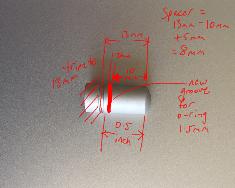

The front panel switch is rather simple. The boards are shown in this post. Basically anything can be used as a button to press the push-to-make SMD switch on the board. All it needs is an o-ring to stop the button from falling forward through the front panel (the board stops it moving the other way obviously). I have a bunch of these buttons but unfortunately they are meant for thicker than 10mm front panels and so I have to get them trimmed to size and a new groove cut for the o-ring to sit in. Oh to have a little lathe... This post has a pic of what the button looks like when finished. I have Modu do the mounting holes for the board threaded for standoffs, the holes for the button and led, and at the rear of the front panel the LED hole is wider so a piece of clear tubing can be slotted into the wider hole and run over the LED on the switch board. This just helps channel the LED light to the small hole in the front panel.

Ah now there lies the difficult part. The idea came from my Theta Digital gear. I searched everywhere for something similar and could not find them. In the end, I begged Theta for some. Neal Feay designs their enclosures. Someone with a mini lathe could churn them out in a heartbeat.
Speaker testing completed. I never thought it would be so nice, even after such a long time away from my audio gear, to listen to just my little centre Egglestonworks Andra III playing one channel of music from my computer. 😱
Waiting on modified front panel button to finish it all up and bolt down the lid. The first 120V SA2014 lives!
