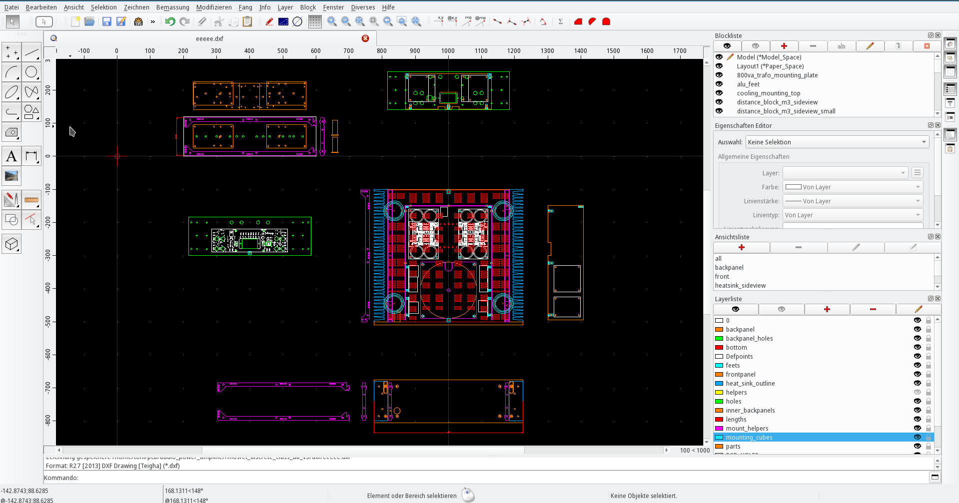

I'm using QCAD to design the case - so this case is completely custom made. For this amplifier the only part from modu.it is the brushed aluminium front panel.
All other parts are designed by me. CNC machining has been done mostly by
Have fun, Toni

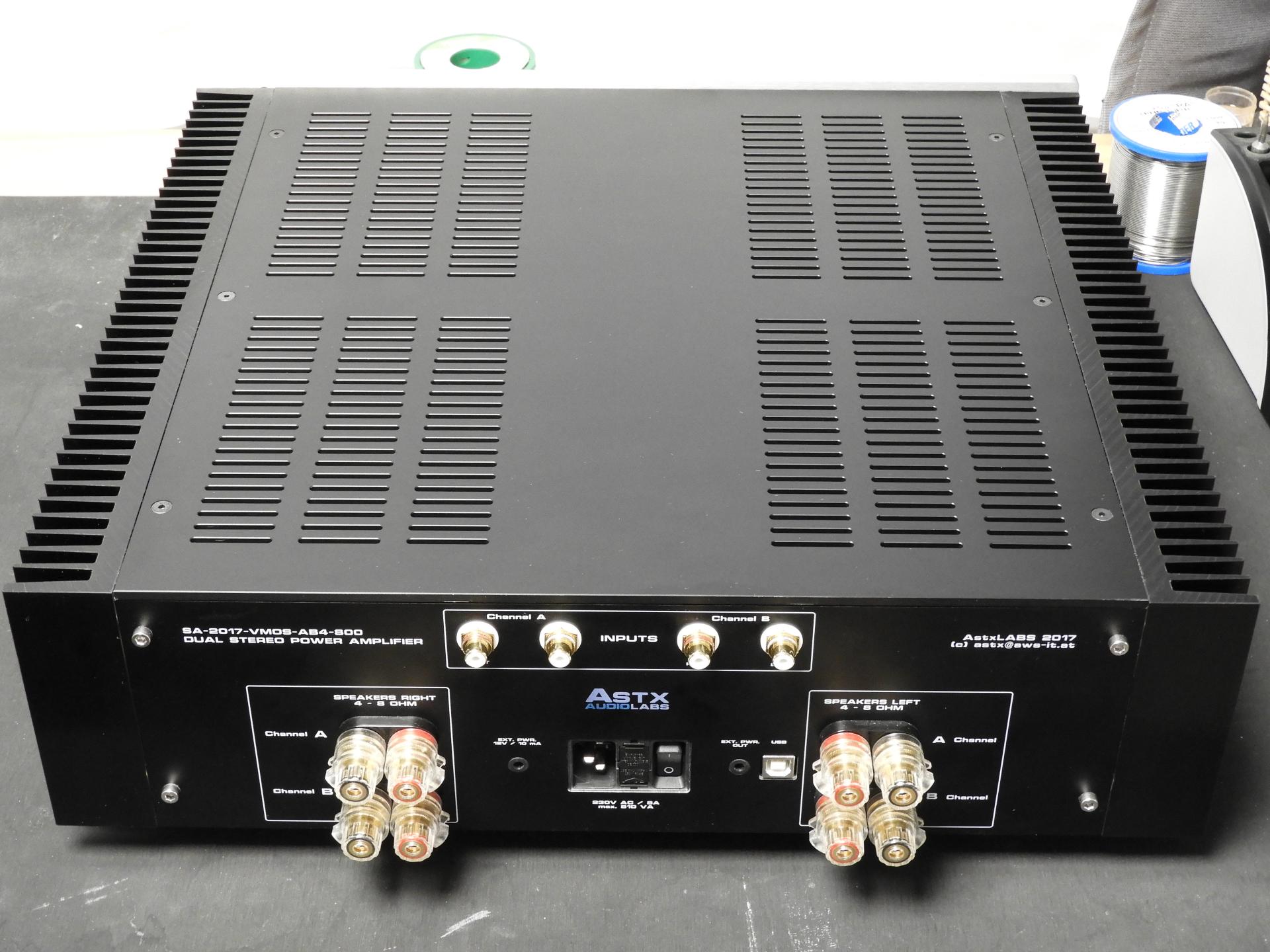

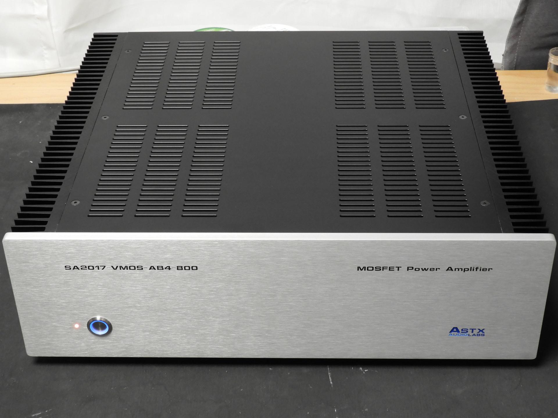

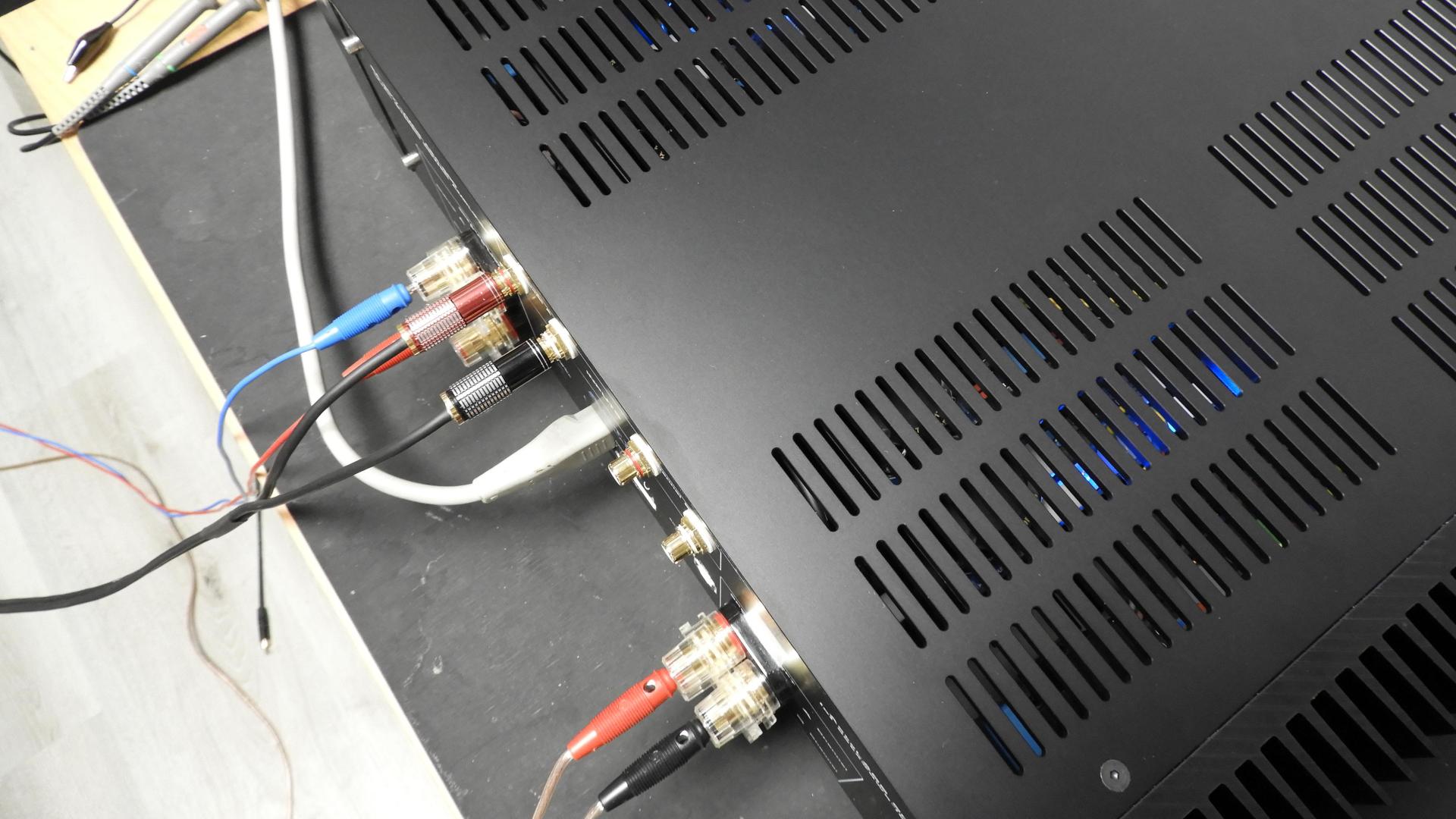

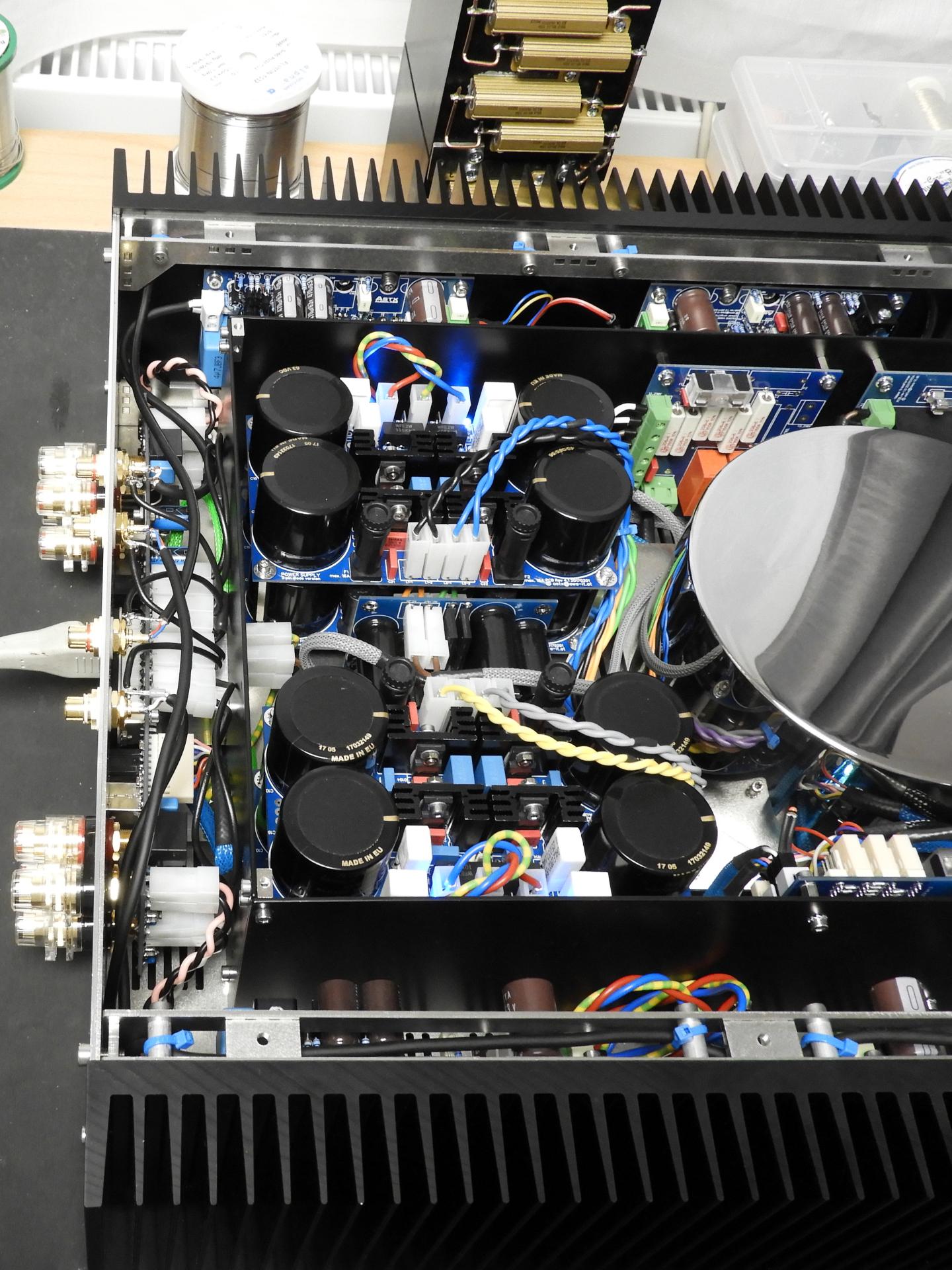

ASTX LABS - SA2017 VMOS IXYS - PROJECT FINISHED
... project successfully finished!
SA2017 IXYS MOSFET 4 channel is singing from first powering up. :)
No noise, hum, physical hum.
First noise measurements are indicating lowest noise - same as during tests of single modules on regulated supply / testbed. :)
Every channel has its own powersupply delivering 2x48V DC with a load of 250mA bias per amplifier. A powerful 800VA transformer does the 230V job.A longer run test showed that heatsink temperature doesn't go above 36 degree celsius (room temp ~ 23 - 24 degree). Inner temperature is about 29 degree.
Sound checked using ILLU18-8 monitor box (highend scanspeak illuminator beryllium tweeter [FONT=Arial, Helvetica, sans-serif]D3004/6640 [/FONT]and [FONT=Arial, Helvetica, sans-serif]mid/bass driver 18WU8741T) - a perfect sound stage.:cool::)
[/FONT]Next projects can begin ...;)
[FONT=Arial, Helvetica, sans-serif]Have fun, Toni[/FONT]
P.S. for Kay Pirinha: grounding color changed to black ;)

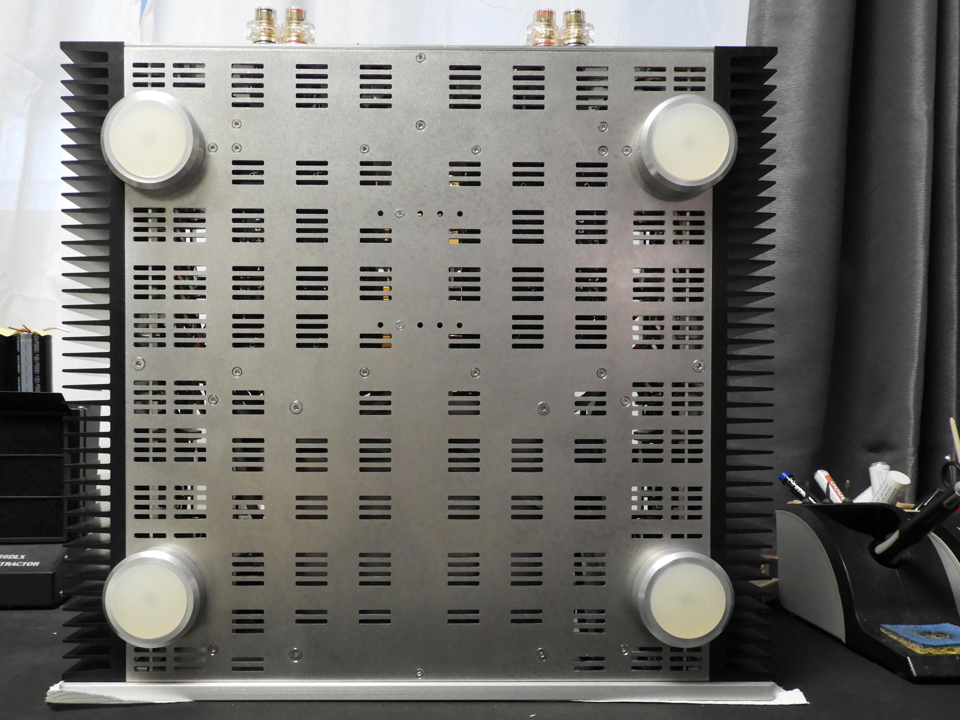

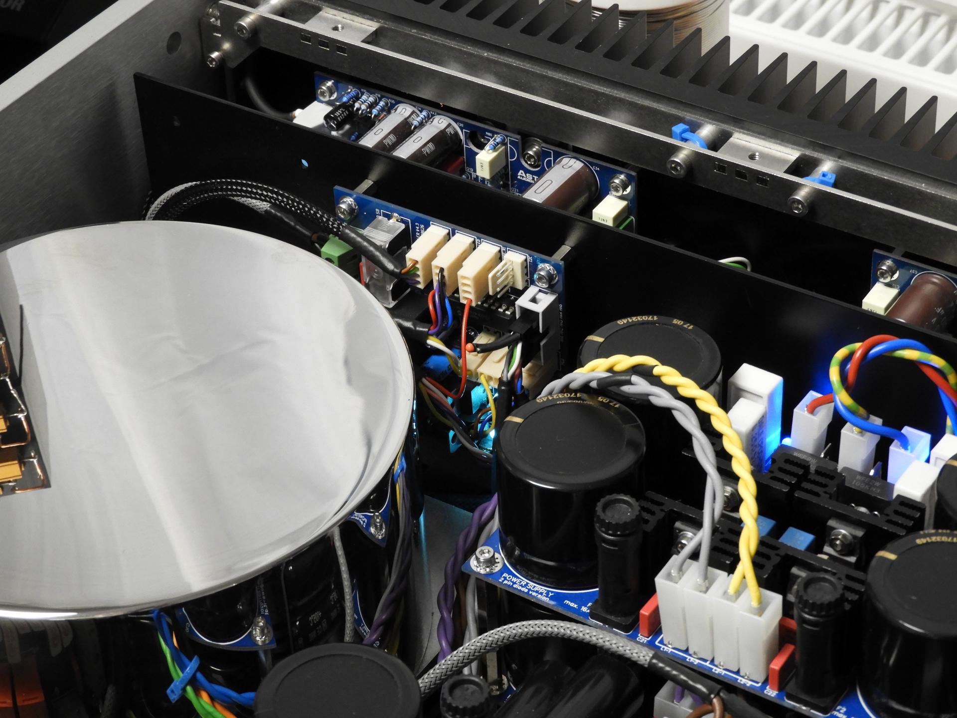

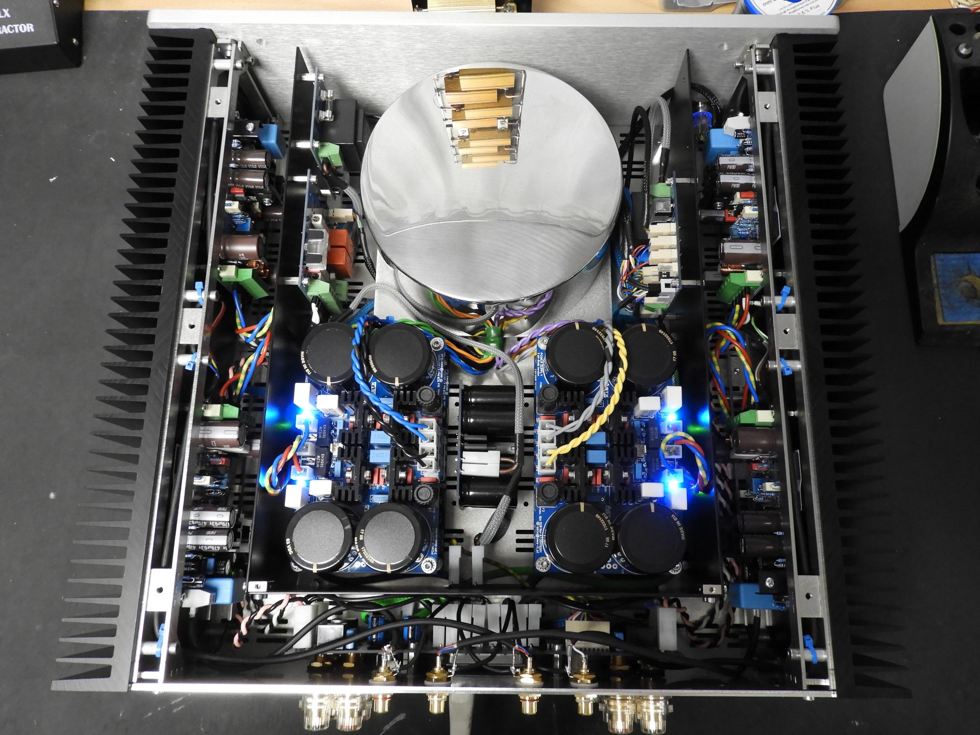

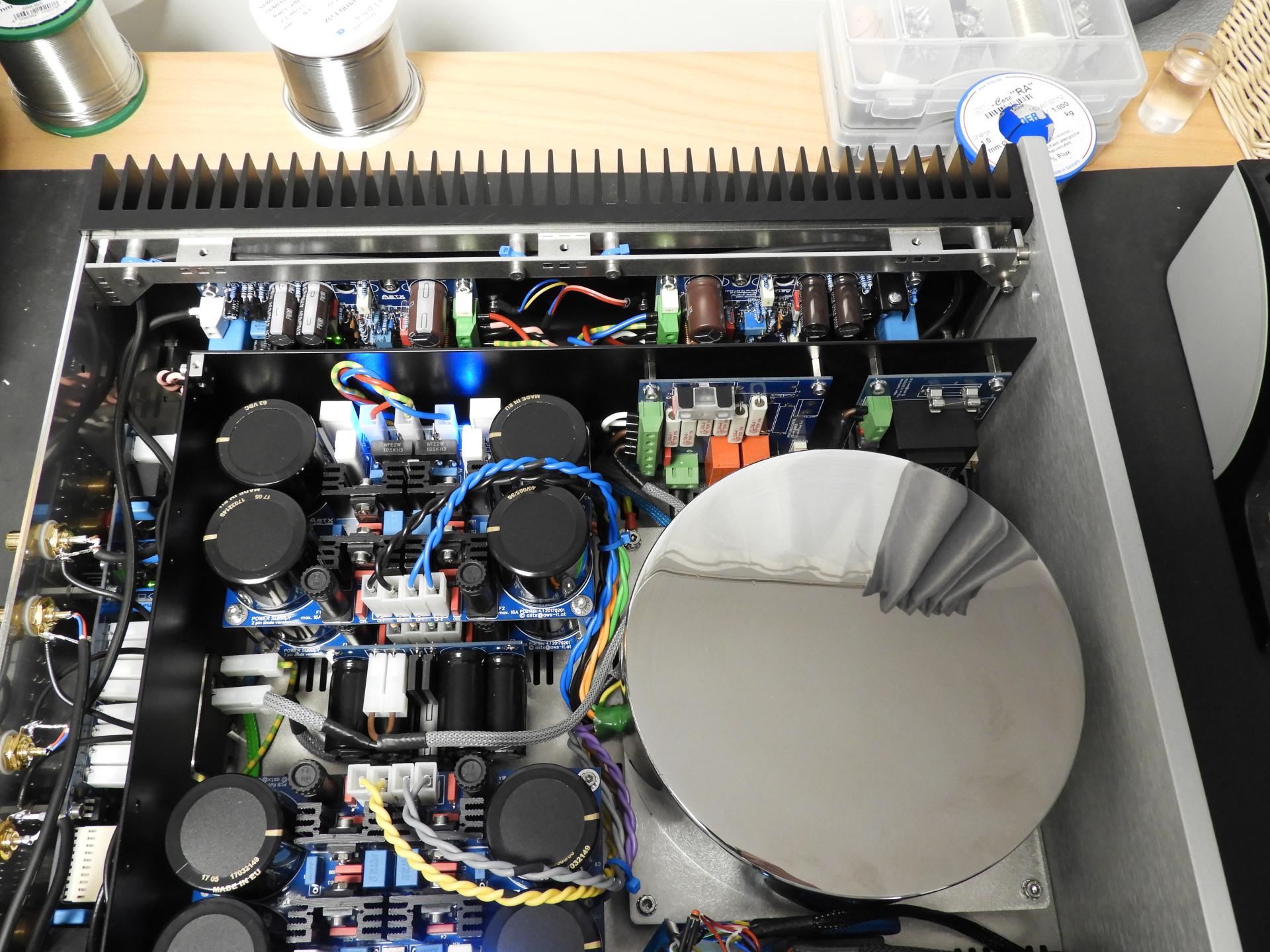

... some more photos ...

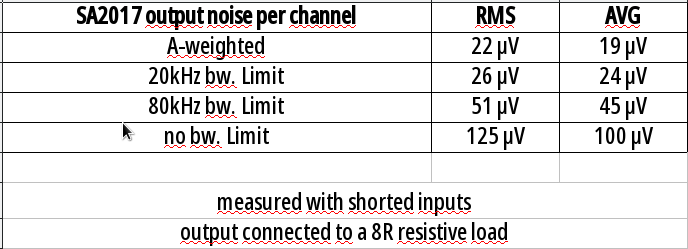

Joined 2011

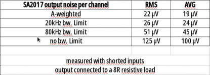

some noise measurements ...
Input cable routing is very important to get low noise on all channels. The routing is asymmetric as the amp modules are mounted different on left and right side. Obviously I have done it correct because low noise values compare to the amp during development phase. ;)
  • A-w S/N ratio is ~ 100dB compared to 1W@8R output power.
  • DC-offset below 100mV.
More measurement values will follow.
BR, Toni

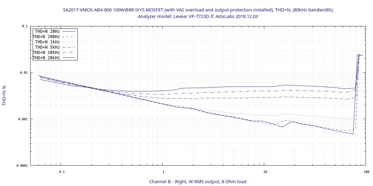

Joined 2011
ASTX LABS - SA2017 VMOS IXYS - Measurements
Amazing project and finish! Chapeau!
Thx!

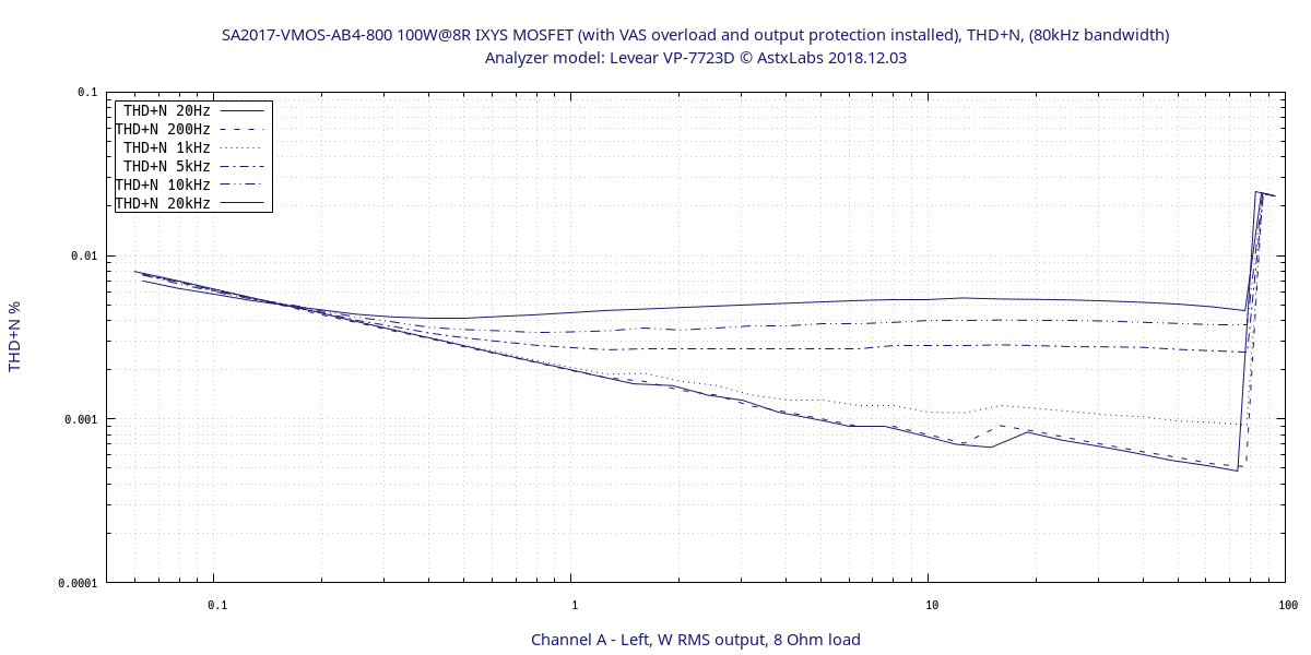

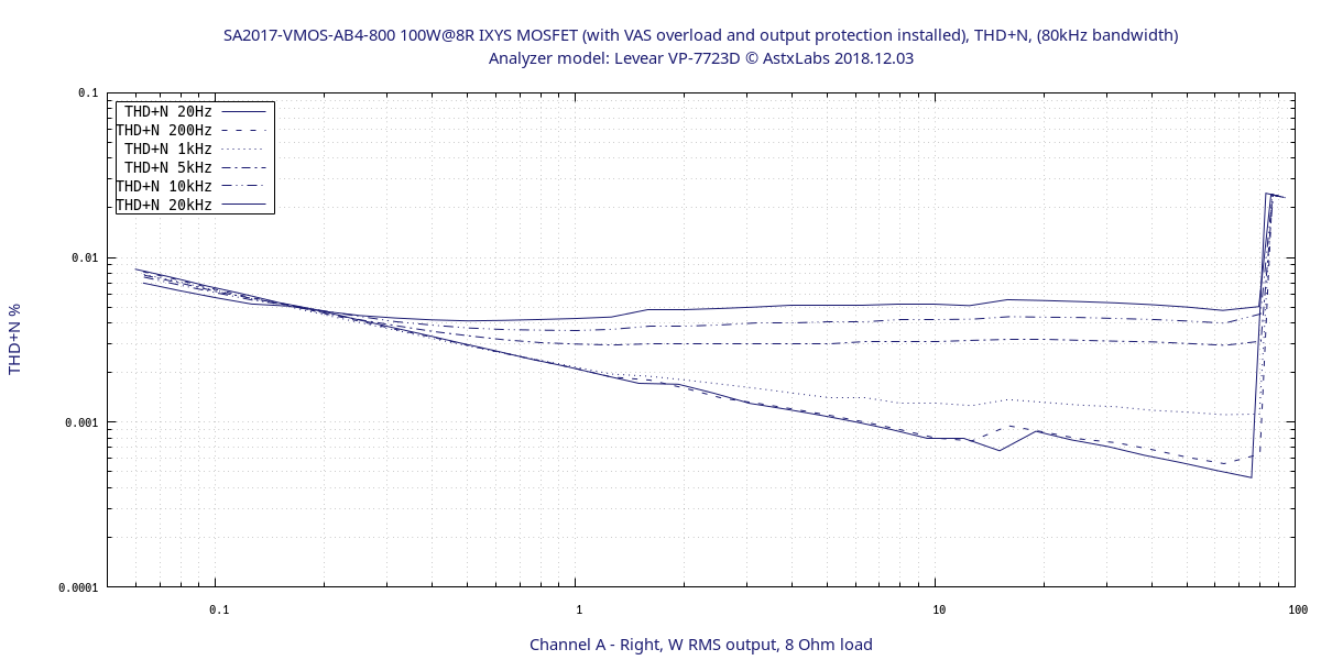

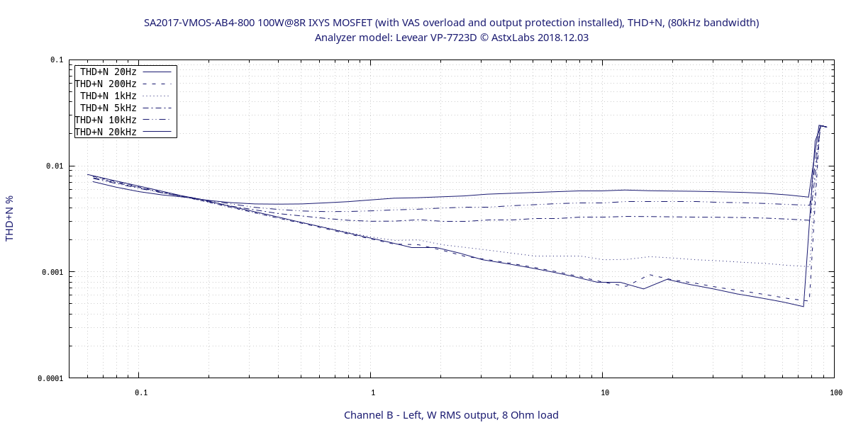

Attached some THD+N measurements for my newest "product".
SA2017-VMOS-AB4-800 100W IXYS MOSFET:
  • Channel A - Left
  • Channel A -Right
  • Channel B - Left
  • Channel B -Right
I haven't done any sweet spot tuning for my analyzer. Interpret the results as "better as".
BR, Toni

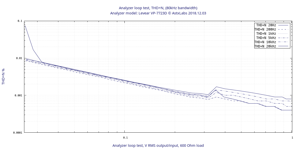

Joined 2011
Hi astx,
can you please show the analyzer chart with loop connector?
Dear Ralf,
making a loop plot of VP7723D analyzer itself with same output levels and therefore with very low input levels is hardly better as the shown results.
I have tested the analyzer loop with -32db to 0db output with 600R load which delivers a rms signal to the input like this table:
#20.2 HZ
# Hz DB Input Vrms THD+N
1 19.99000000 -32DB 0.02530000 0.07540000
1 19.99000000 -31DB 0.02830000 0.01680000
1 19.99000000 -30DB 0.03180000 0.00790000
1 19.99000000 -29DB 0.03570000 0.00670000
1 19.99000000 -28DB 0.03990000 0.00610000
1 19.99000000 -27DB 0.04470000 0.00540000
1 19.99000000 -26DB 0.05010000 0.00480000
1 19.99000000 -25DB 0.05620000 0.00430000
1 19.99000000 -24DB 0.06320000 0.00390000
1 19.99000000 -23DB 0.07080000 0.00340000
1 19.99000000 -22DB 0.07930000 0.00310000
1 19.99000000 -21DB 0.08900000 0.00280000
1 19.99000000 -20DB 0.09970000 0.00250000
1 19.99000000 -19DB 0.11170000 0.00222000
On analyzer I have to switch from balanced to single ended input with a direct connected coax cable to get the best loop test results.
If I compare the results of -19DB with the data line from output via amplifier:
1 20.02000000 -19DB 3.08400000 0.00195000
... think you can see the problem ... IMHO the notch filter works better with higher input signal levels and/or the analyzer internal input noise makes the difference ...
especially in the lower power range < 10W. Don't forget the amplifier has a dual slope current protection active which slightly increases the distortions above 5kHz. But we still have comfortably two zeroes THD+N behind the dot ...
