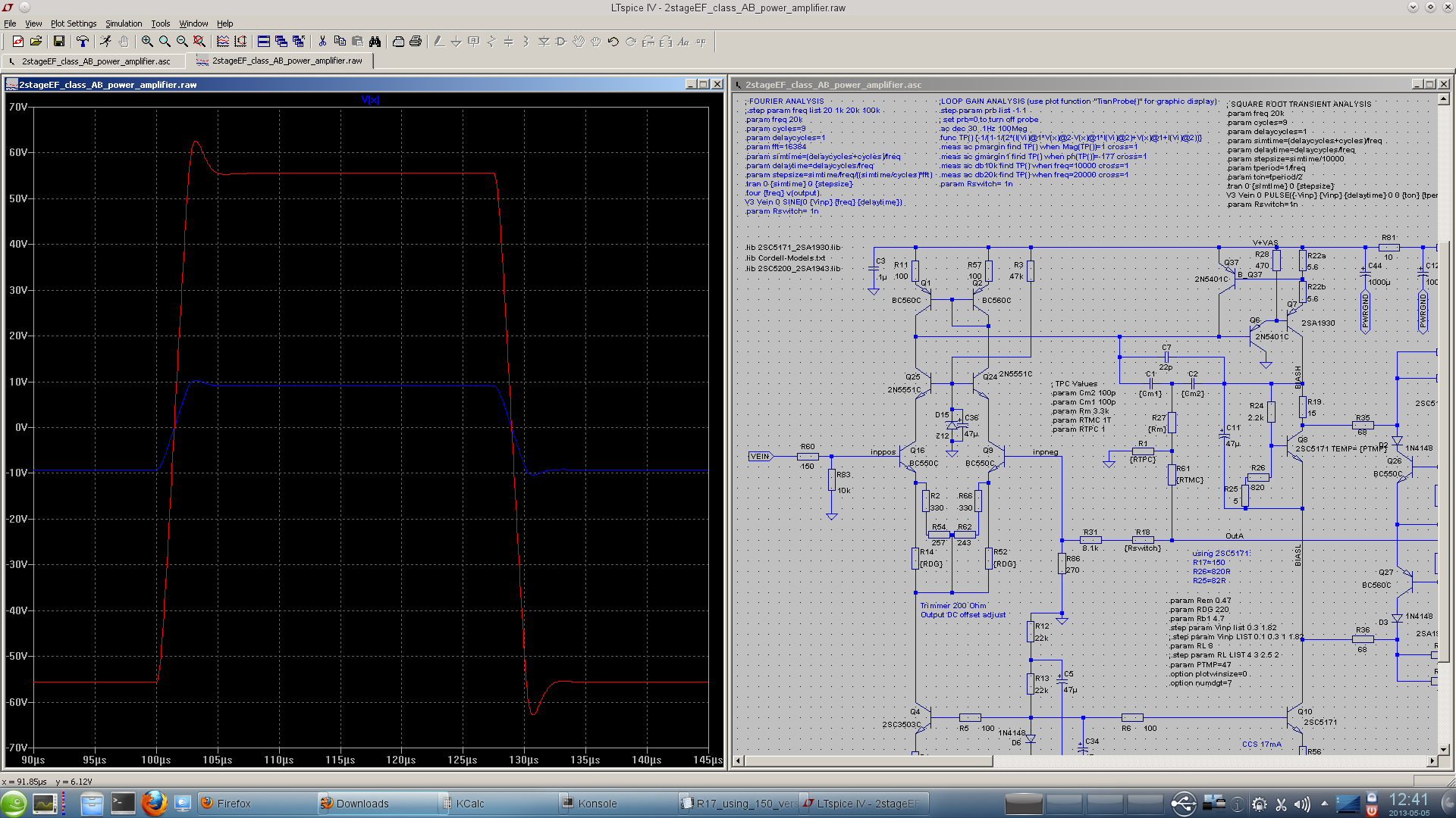

Understood. And what about the transient response? I think, that it's more important, than the THD.
Sajti
See attached sim. It looks pretty good. Overshoot due to TPC compensation is normal. No ringing!
Slew rate better 45V/µs.

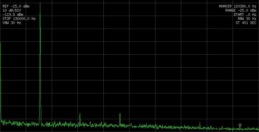

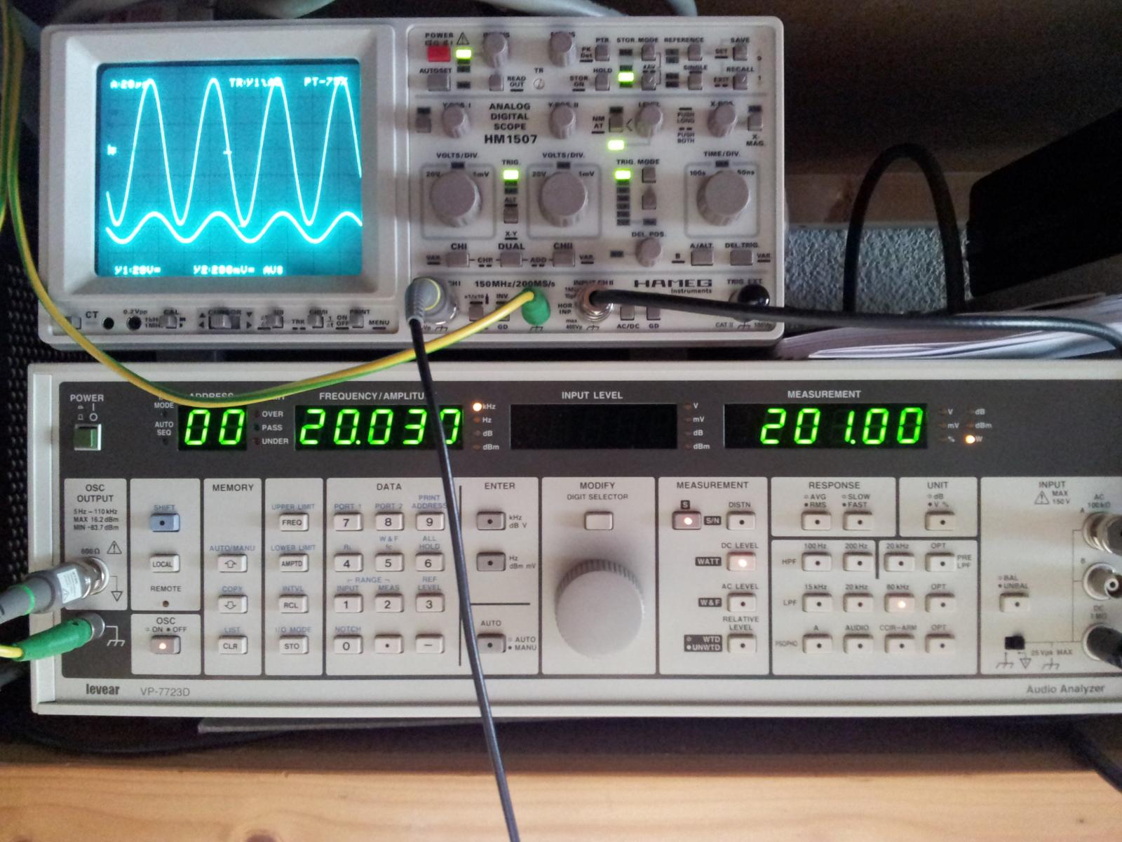

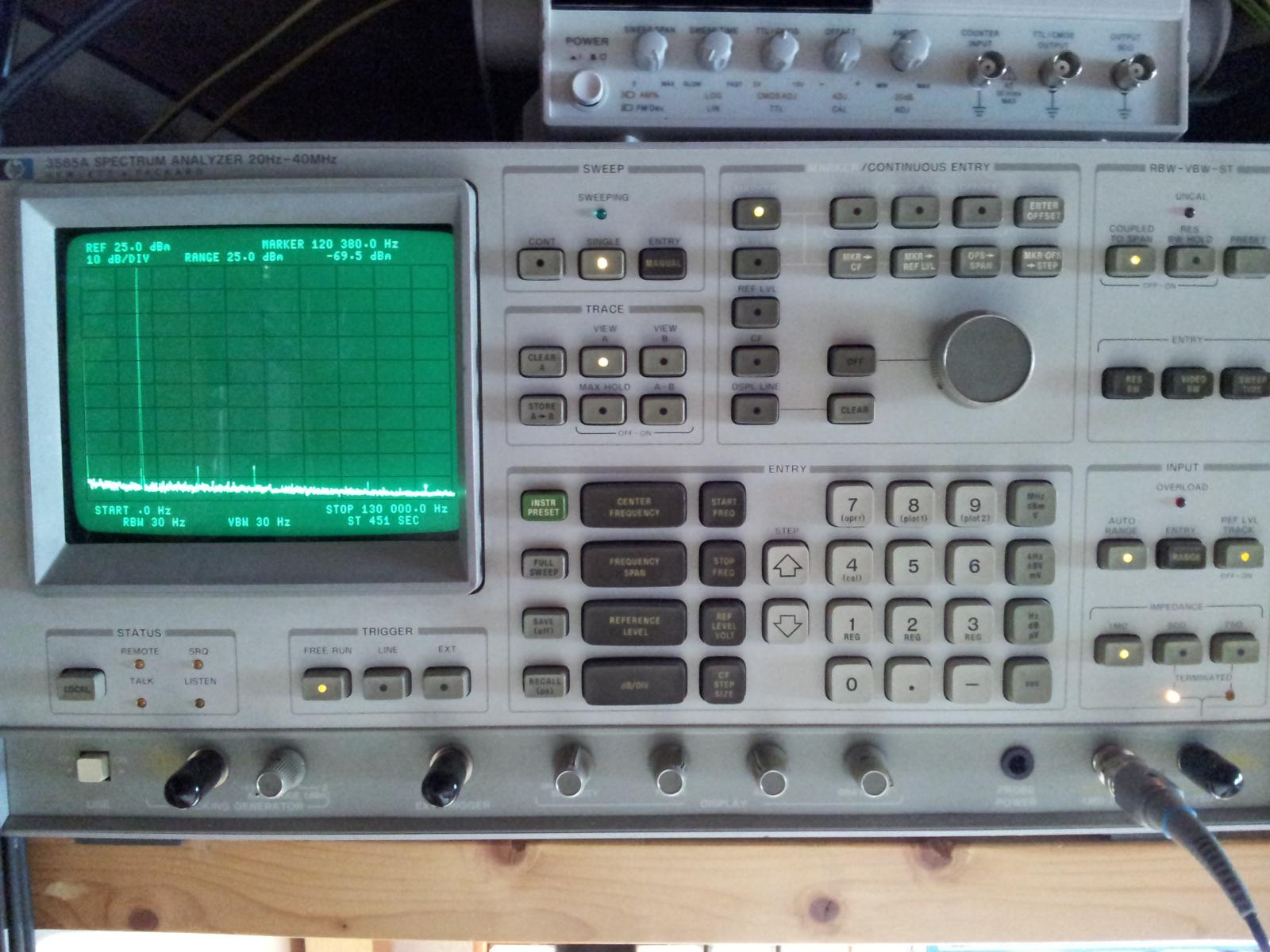

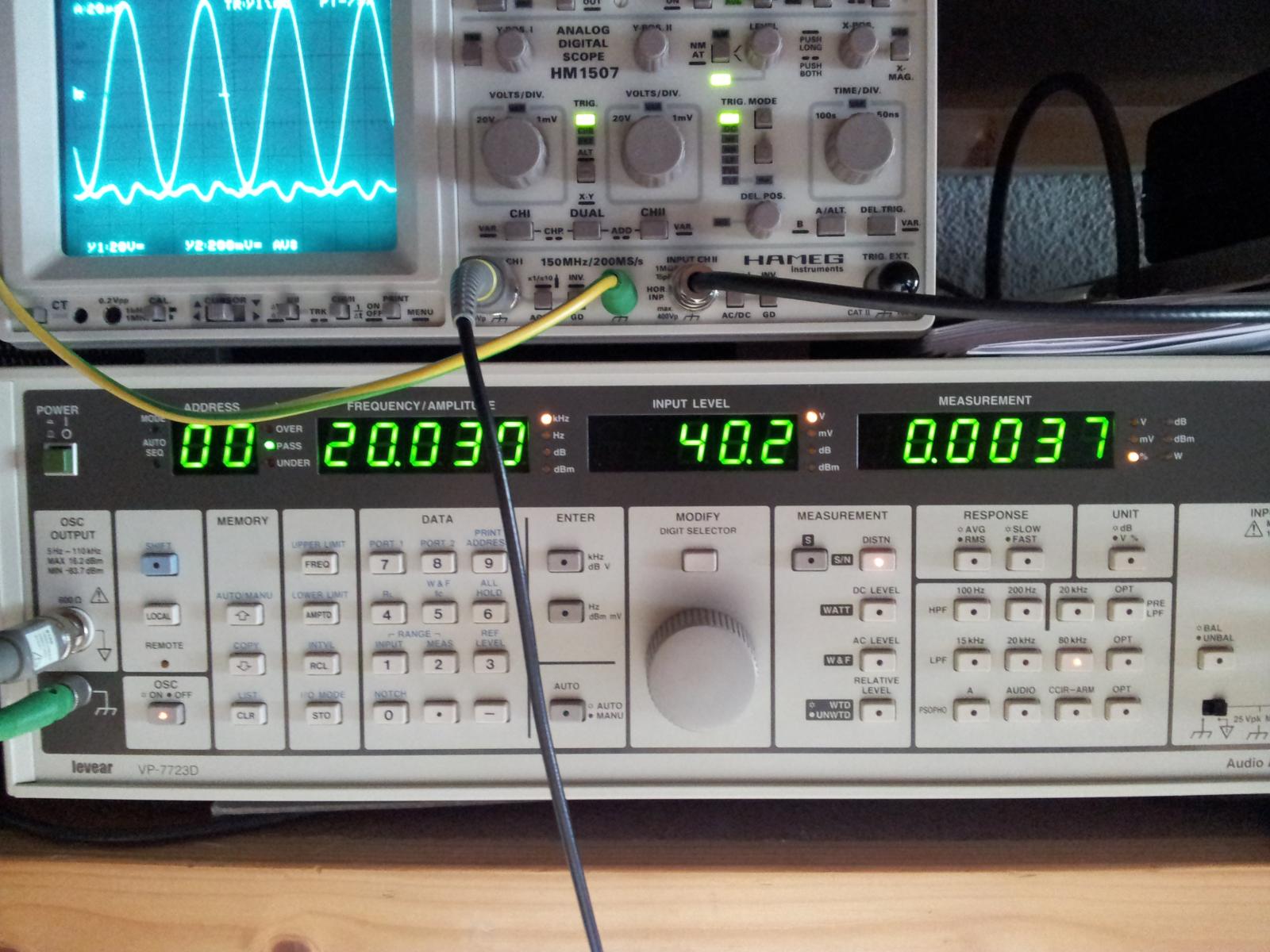

Some measurements with R17=150R
Yesterday made some measurements with R17=150R.
Most of the H2/H3 is produced from the analyzer oscillator output itself.
Load 8R, 200W, 20kHz.

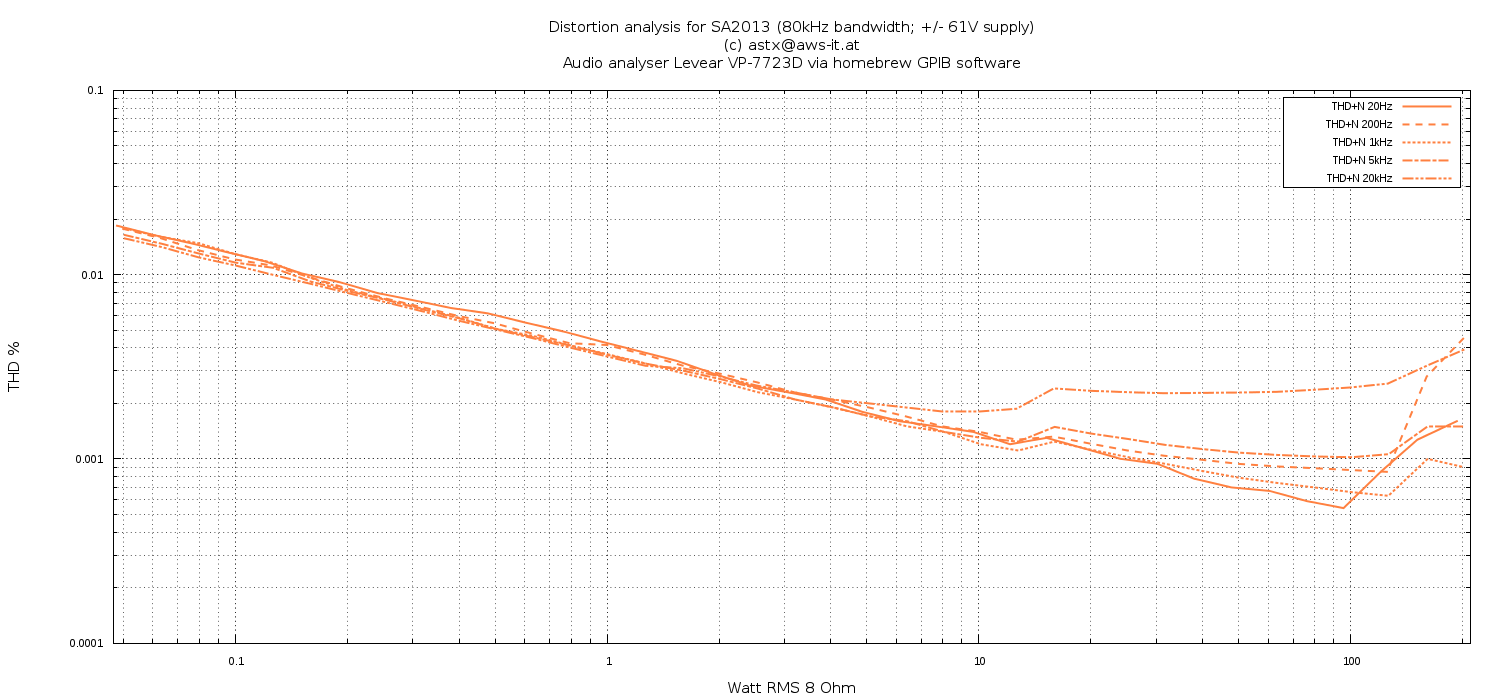

Distortion analysis for R17=150R
See attached distortion plot for SA2013 using R17=150R.
At very high power levels (100W - 200W) the THD values for 20Hz, 200Hz and 1kHz would be a little bit better if the used regulated laboratory power supplies wouldn't start activating the current limiter...
Can someone compare these results with other real life amplifiers out there to get a feeling in which category the 2stageEF may be playing?
BR, Toni

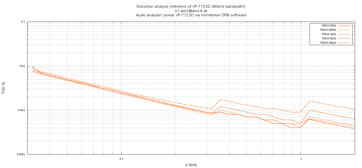

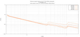

Audio Analyzer Reference Plot ...
BR, Toni
attached a distortion plot of audio analyzer itself for comparison. The 2StageEF distortion plot is only a few ppm higher ...
BR, Toni
