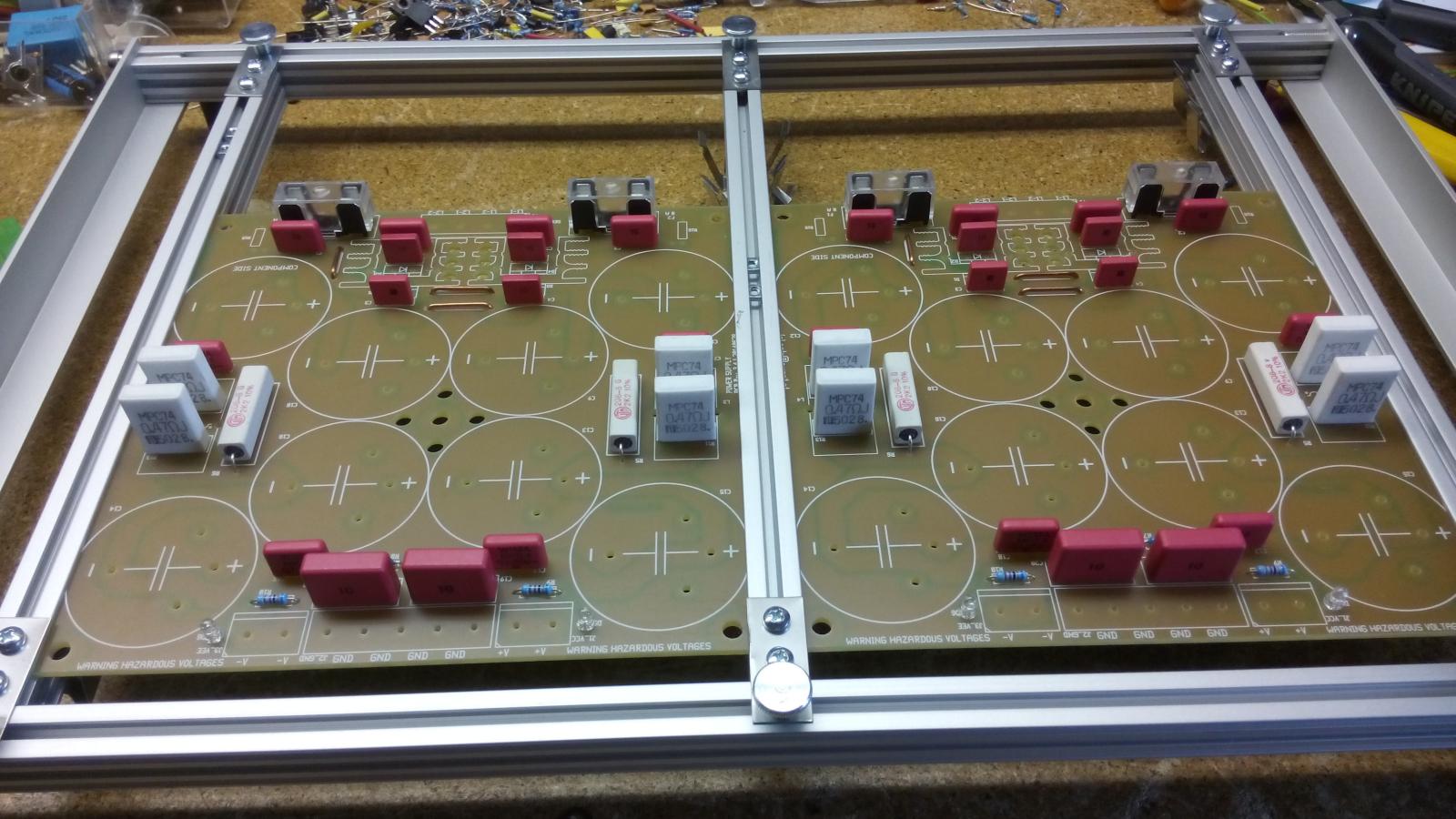

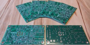

Got some pcb's today ... 🙂

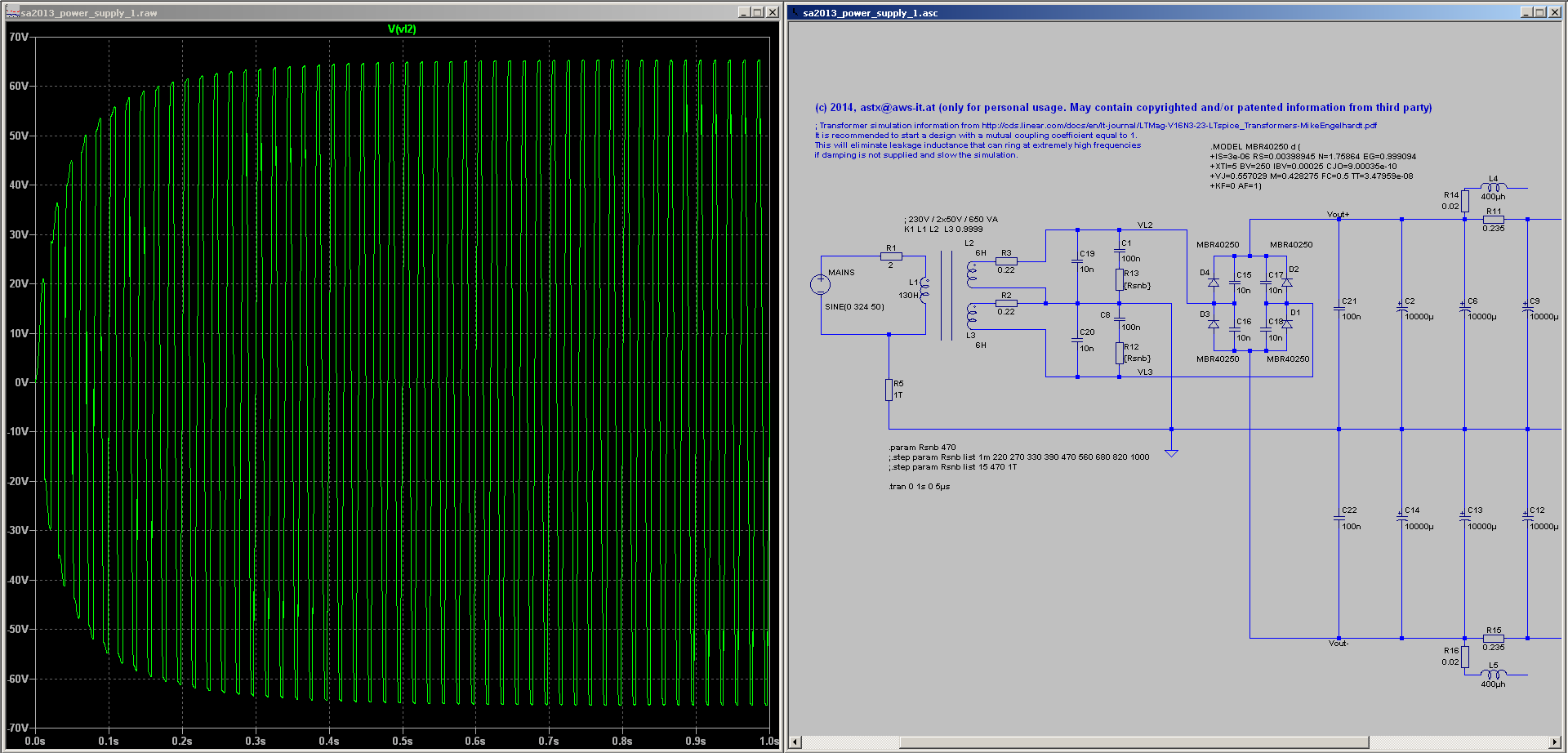

...the transformer model isn't correct...
Better transformer simulation models are always welcome...
You built a nice amplifier in the time I took just to make some measurements for an improved model.😉

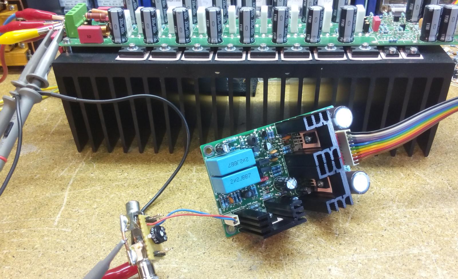

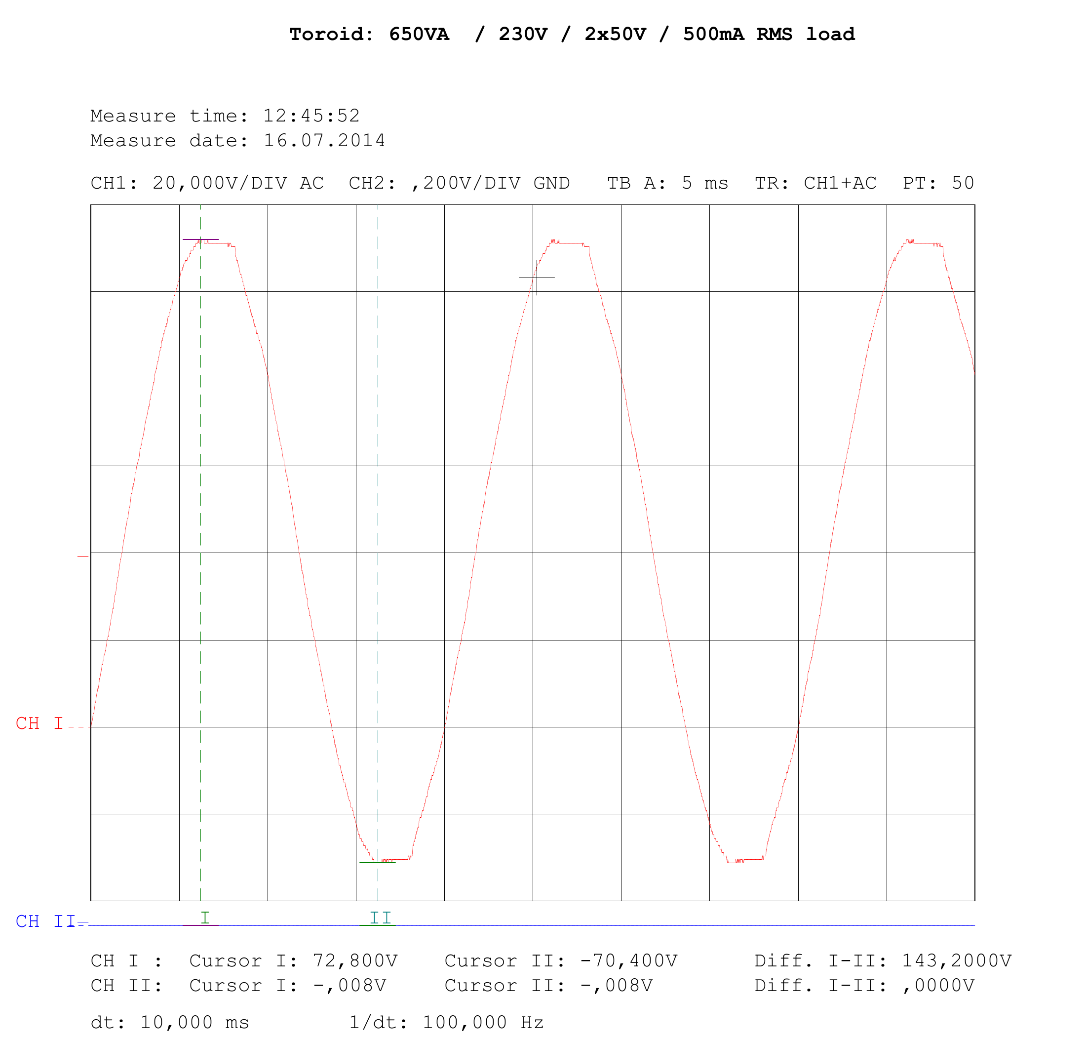

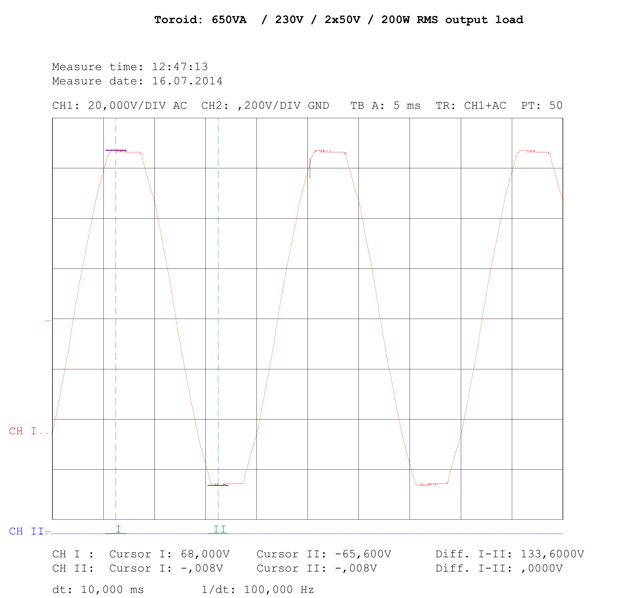

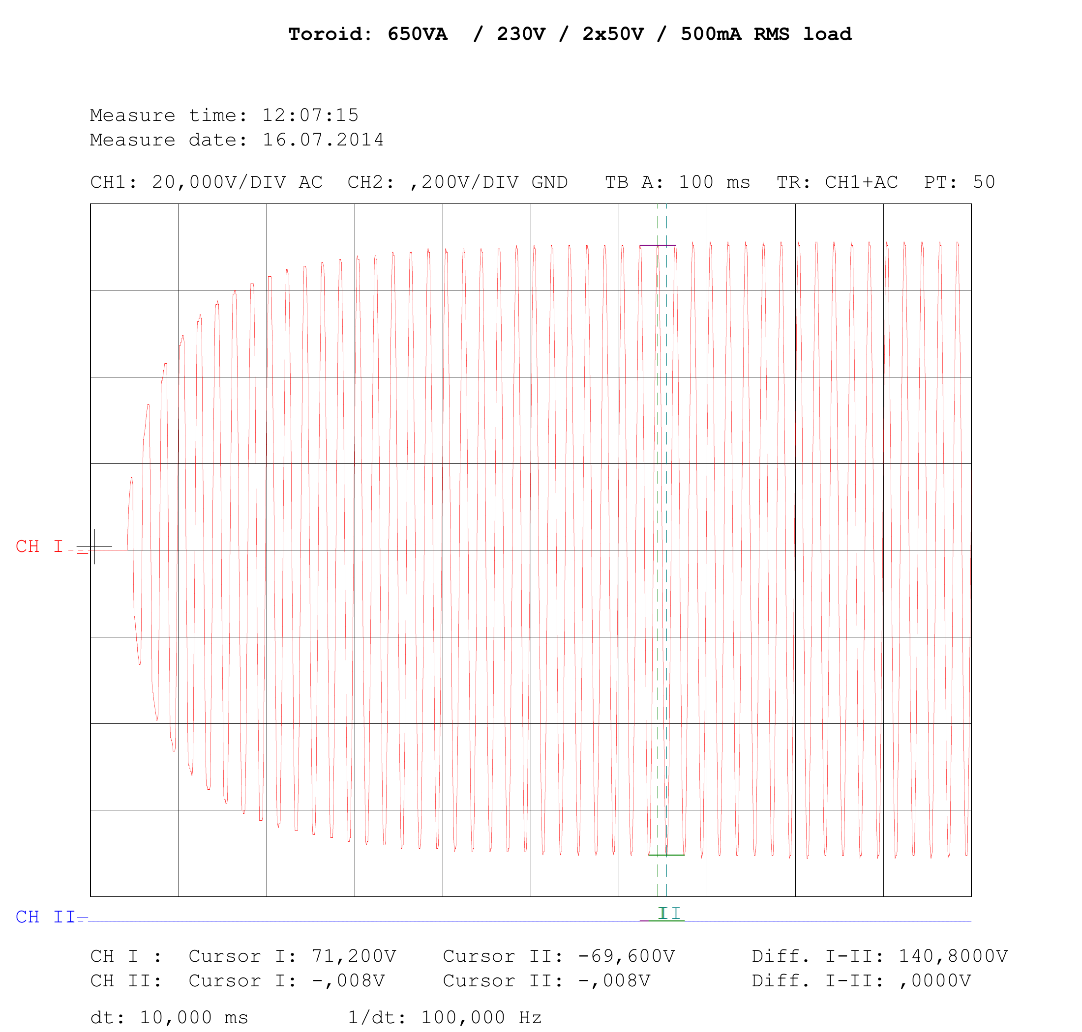

Attached the startup sequence of my new power supply with connected power amplifier (consumes about 500mA if idle). (osci screenshot: 20V/div and 100ms/div)
Used Toroid: 650VA / 230V / 2 x 50V
The voltage has been taken directly at network F1-C21-C1-D1 (schematic see post 1005). Maybe this helps to refine the simulation model.

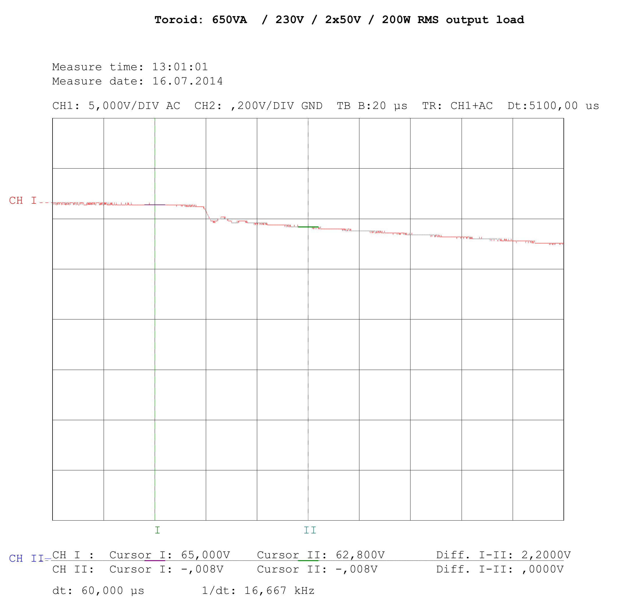

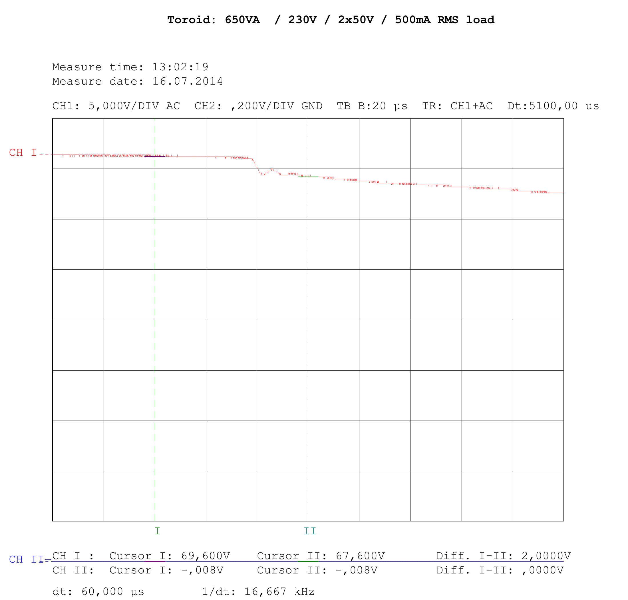

... nearly no ringing viewable at network F1-C21-C1-D1
left picture: amplifier idle / ~ 500mA consumption
right picture: amplifier serving 200W RMS @8R (~ 2,5A consumption)

... zoomed to view diode switch ringing ...

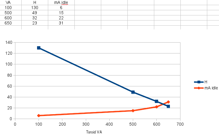

... used 0.1R in series with coil to measure mV rms.
Here are my measurement results (note: my mV rms meter isn't very exact so the results are preliminary!)
650VA: 23H
600VA: 32H
500VA: 49H
Has anyone results comparable to this one?

The snubber capacitors should be at least 16 times the size of the parallel capacitance (yours plus stray distributed) if you want to kill the resonance completely. So increase the snubbers a little and/or decrease these.
As the ratio increases the optimum value of Rsnubber becomes less critical.
That is, the curve of resonance suppression versus Rsnubber develops a plateau rather than an optimum peak.

Thanks for the measurements. More or less what I expected, will compare and see how much variation for similar size transformers.
What was the mains volts?
I don't have experimental data on this but I think Andrew is correct, it may be quite sensitive.
