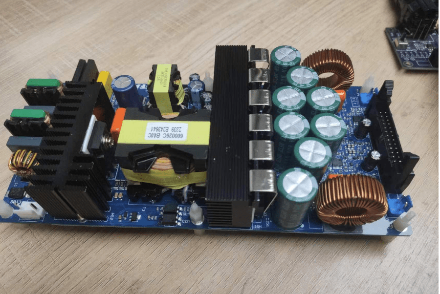

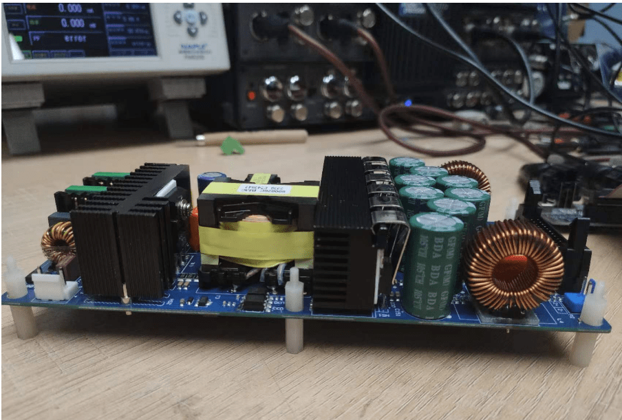

The universal power supply 2*300W amplifier module is ready for the public now 🙂

Thanks for your continuous support for my project. Regarding your questions, here is the answer:
1. This amplifier module has the special SMPS design without the primary capacitor reservior, instead we put the capacitors on the secondary side, so the turn on surge current does not cause any trouble, and somehow you can omit this parameter when design your system.
2. The max AC power draw is near to 800W when driving this amplifier module into maximum output.

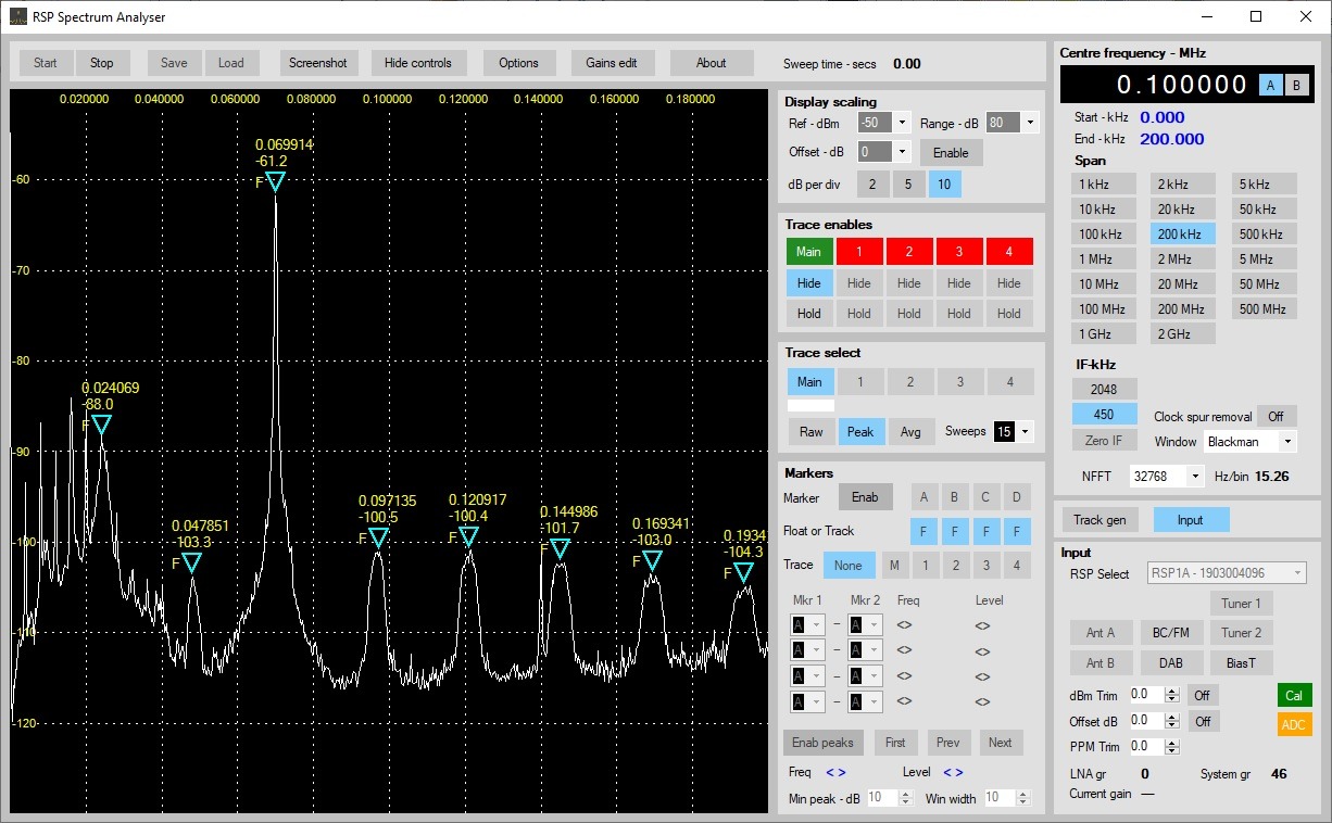

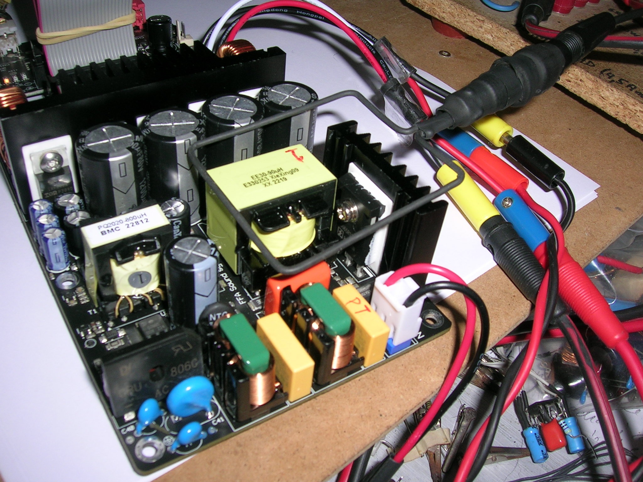

I switch on four FFA001V3 modules (2x150W) simultaneously. I have no issue with inrush current.1. This amplifier module has the special SMPS design without the primary capacitor reservior, instead we put the capacitors on the secondary side, so the turn on surge current does not cause any trouble, and somehow you can omit this parameter when design your system.
In these, the primary side capacitor is indeed small (47uF/400V). Secondary side has four 1200uF/80V capacitors.
SMPS switching frequency is 70kHz
George

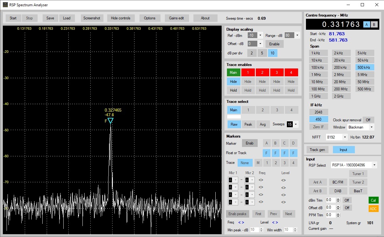

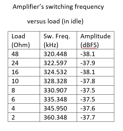

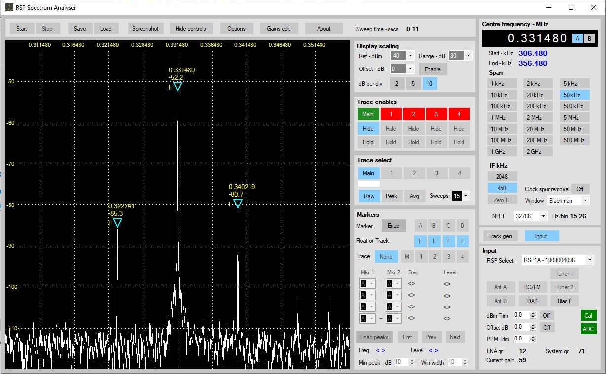

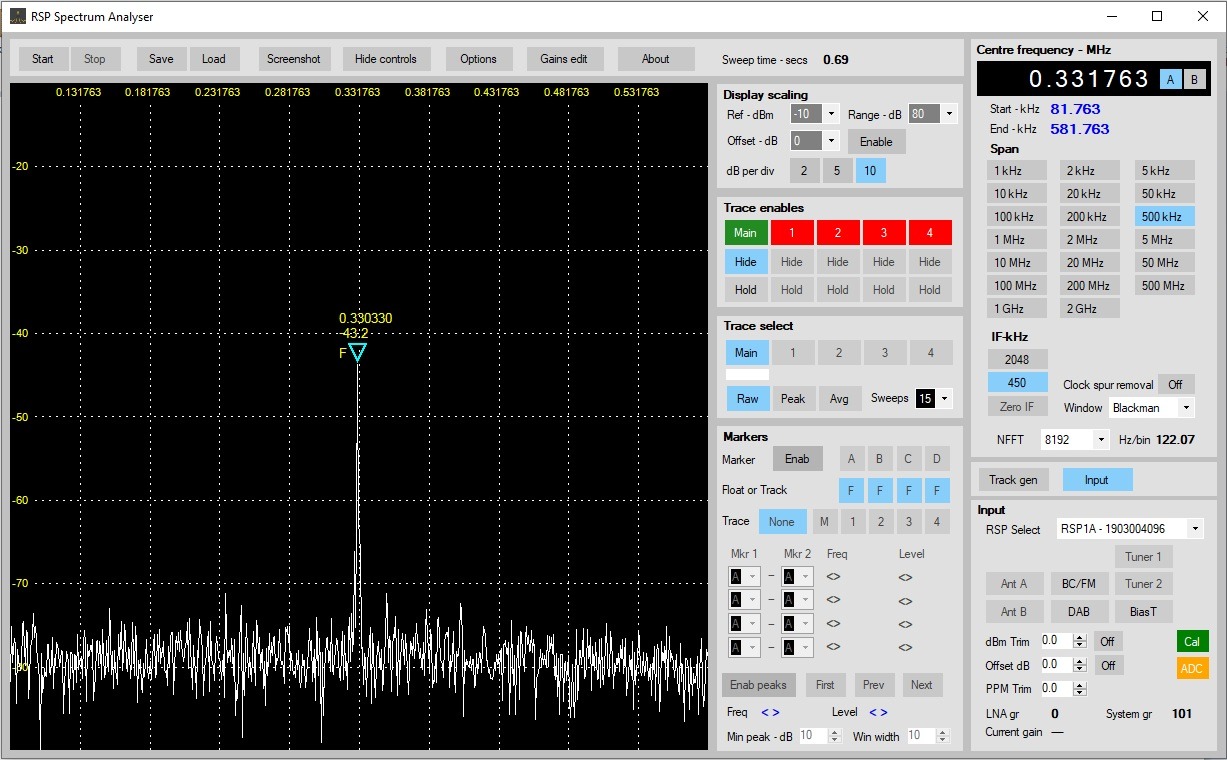

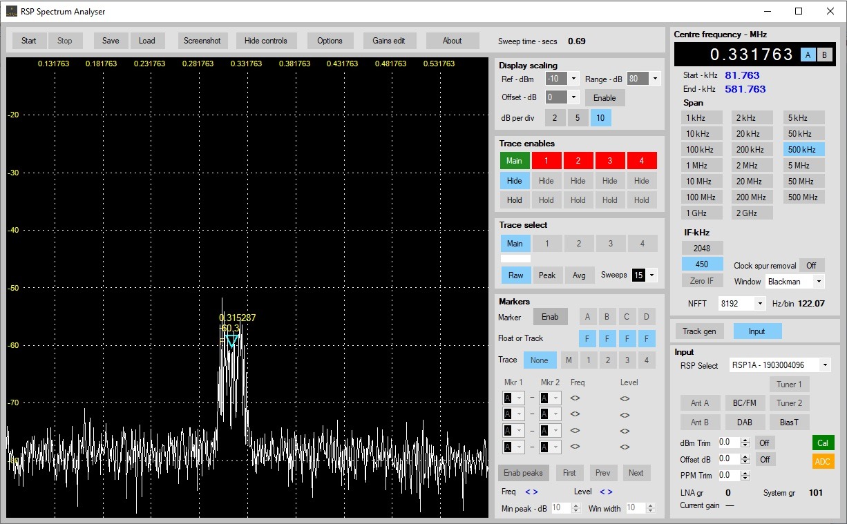

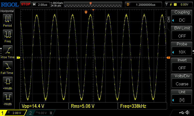

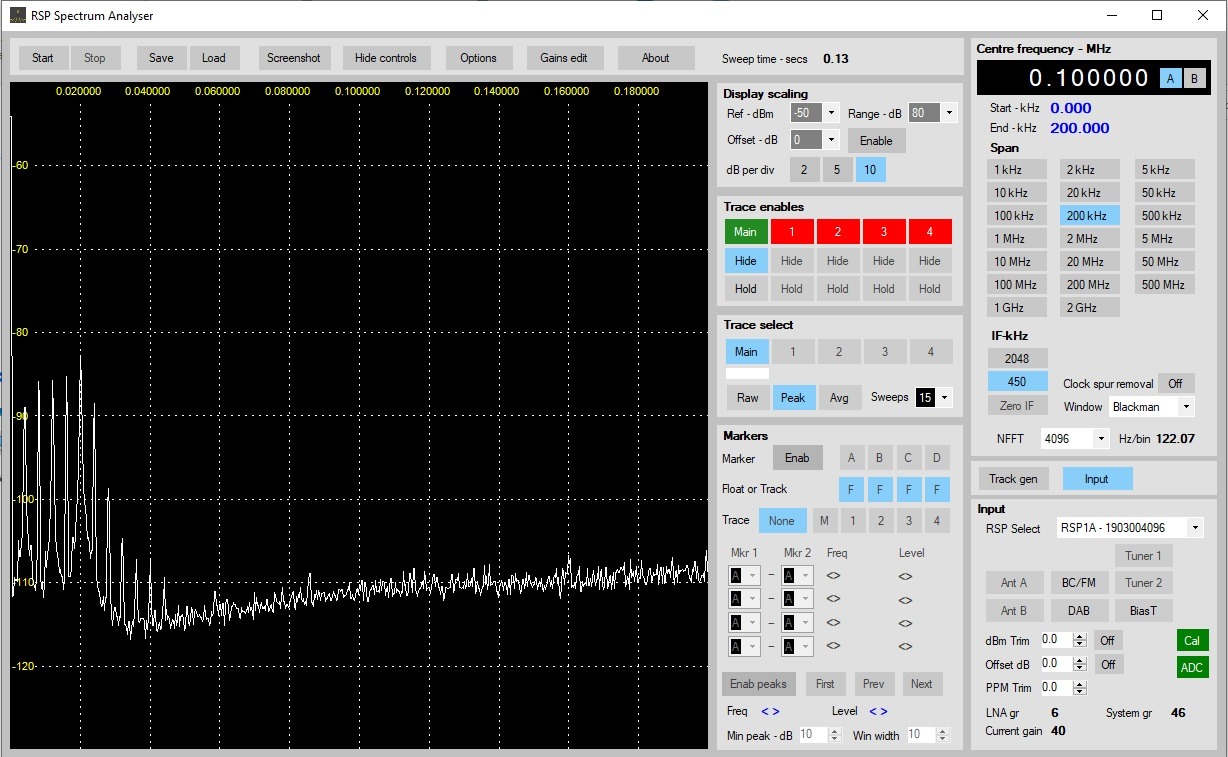

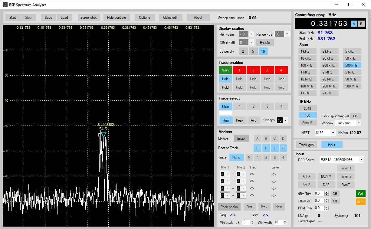

WOW that seems quite low! Are the first 2 screen captures from a oscilloscope? What does it tell you about the amps?SMPS switching frequency is 70kHz
Hi Mike
The spectrum analyser screenshots (FFTs) were taken with a sniffer probe connected at the input of an SDR (SDRplay RSP1A).
Please note that this 70kHz is the switching frequency of the PSU.
Now, the switching frequency of the class D amplifier is much higher >300kHz.
This switching frequency varies with the load connected to the amp and the power supplied to it. See attachments.
1st att. is with oscilloscope probe across load.
Rest att. are FFTs from a small 10mm X 10mm sniffer probe over amplifier output coil
George
