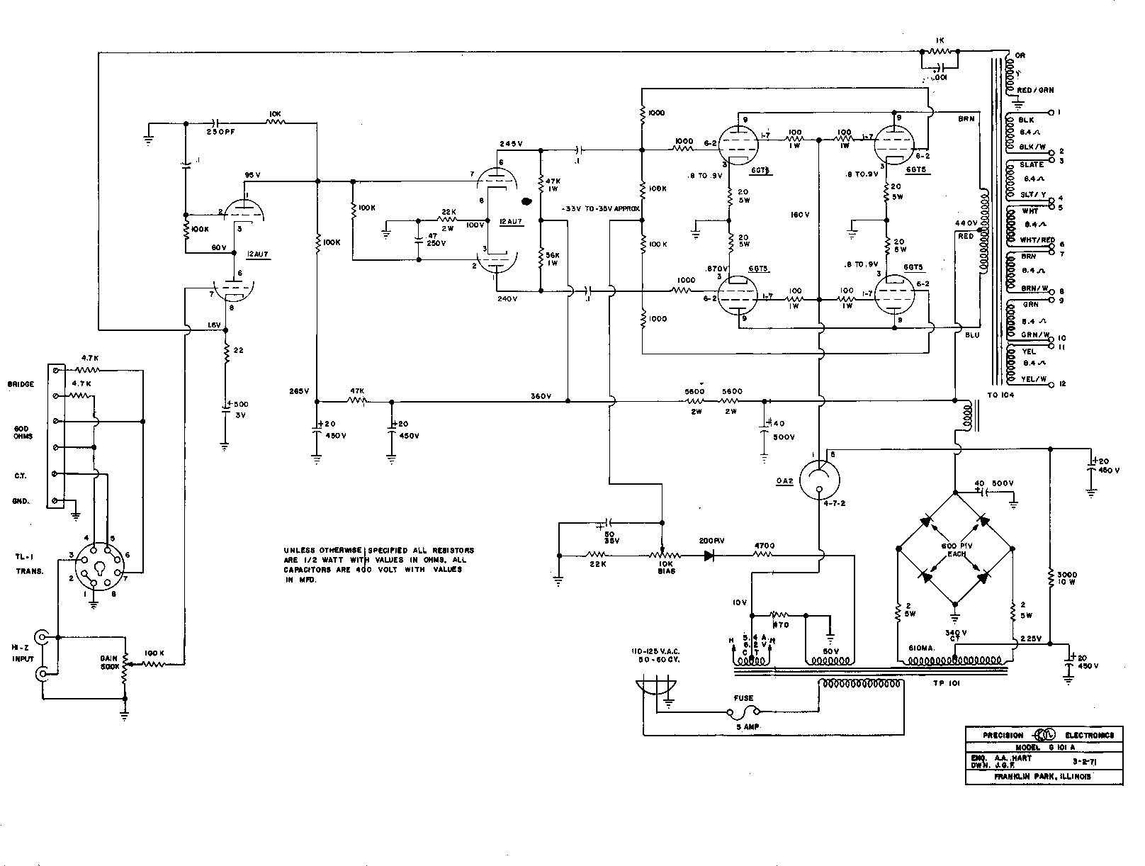

ah - Al Hart's cascode front end - that and his cascode phono preamp probably spurred the Paragon and other tube preamps (such as Bruce Moore's stuff) Fantastic "gift" and very valuable amps .

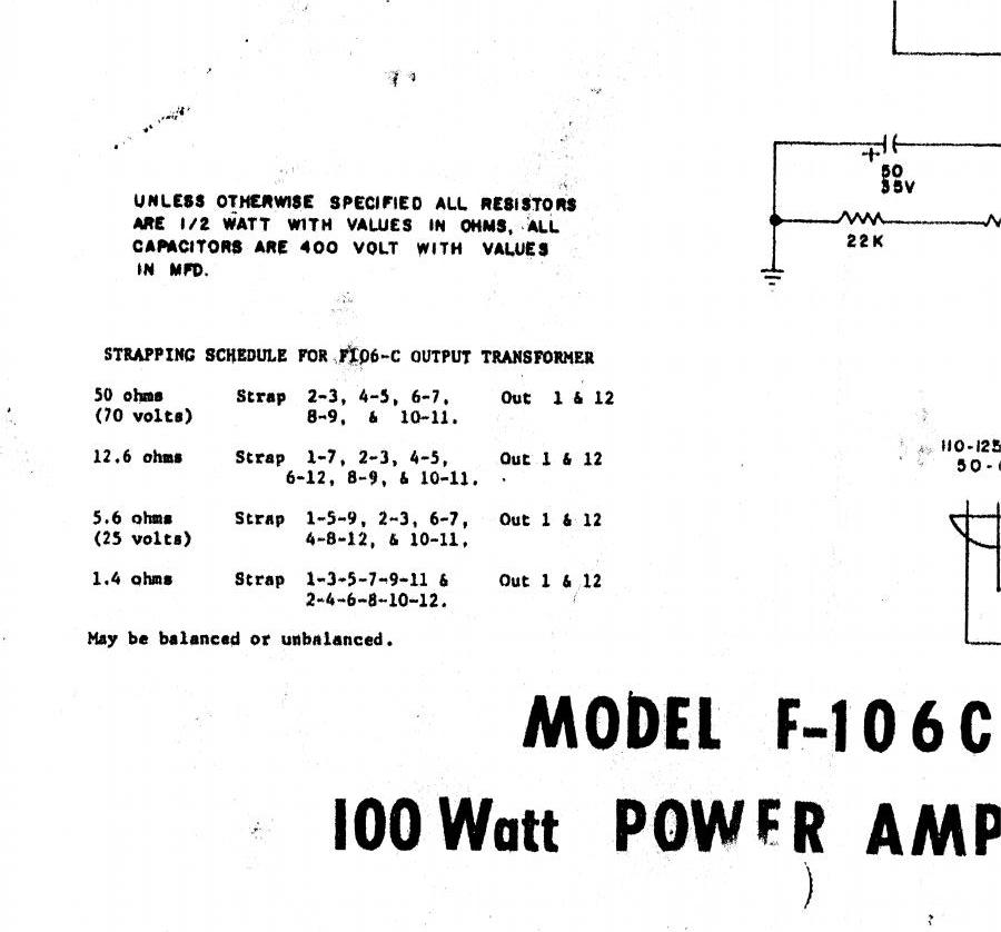

I believe they can be configured for lower load impedances than 25V/70V line applications, but you will need to find the manual online to figure out how to strap the other secondaries.

Thanks to everyone for all the great comments and info. I kind of wish there was a like button at the bottom of each post. I think I should be able to fix one by it's self and then take the 2 left and make one. Each of the other 2 have physical broken parts but different on each. So I will have 2 complete amps when done.
The aim would be to use as many of the separated output windings in parallel as possible - not sure if they are all the same 6.4 or 8.4 ??
Making the bias pot failsafe, and even doubling up the pot to allow bias setting of each side would make sense.
It will be interesting to see how the global feedback, and the doubled up 15Hz low fre RC corners and the 63kHz high final step response RC network work out.

I found a post on AK that had this small pic from a schematic on the Frazier F-106-c 3 which is the exact same amp with just the Frazier name put on it. It shows the proper hookups for the different ohm settings. Should I use the 1.4 ohm setting to run my Maggies.
