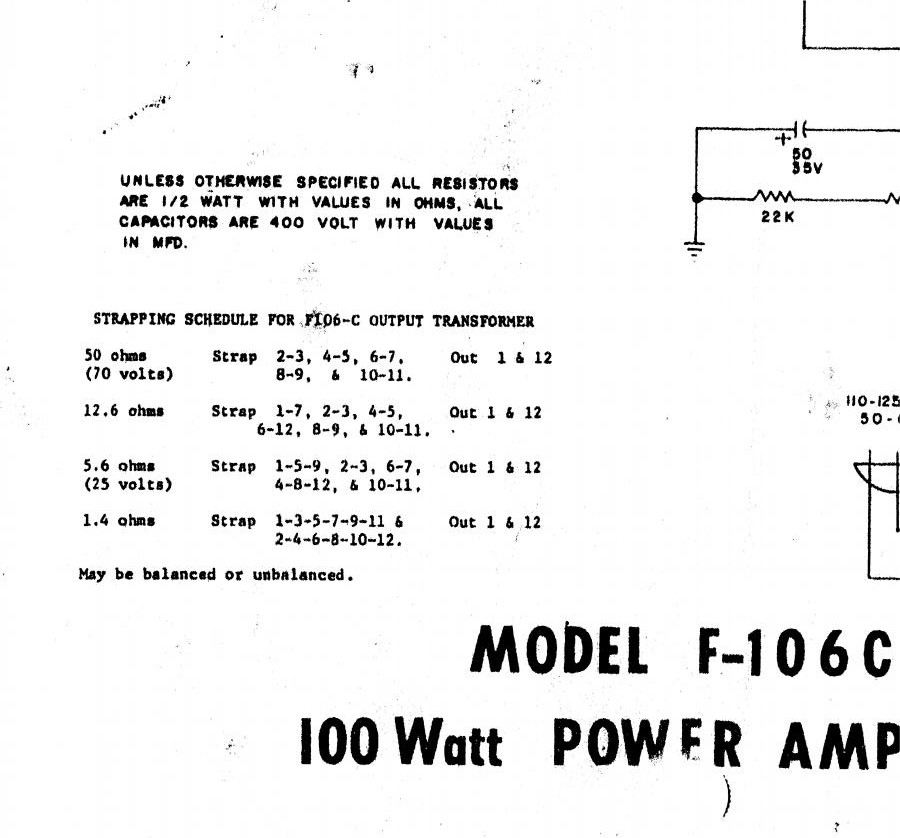

You hit the nail on the head on your post #s 18 & 23. These were either special ordered amps or a previous owner changed out the output transformers in these. The "smallest" transformer that you referred to earlier is the power supply choke shown in Jazbo8's schematic in post #2. The original output transformer in these were great quality OTs and can do 20Hz at nice power levels. The originals had 1750 ohm plate to plate primary impedance and 6 secondaries at 1.4 ohms each. These were meant for PA applications where they would be configured as 25 volt or 70 volt line transformers and not hooked up directly to loudspeakers... But that doesn't mean that they can't be hooked directly to speakers; they can. The two most common ways to hook the secondaries up for common loudspeaker impedances is either in parallel-series (5.6 ohms) or series-parallel (12.6 ohms). These two choices will cover 4, 8, or 16 ohm speakers.

Here's the secondary connections for different impedance configurations of the original OTs.

Okay yesterday I hooked one up and got it playing. Now I used the jumper pattern I found at first but when I did I got zero output. So I just hooked up my speaker to the 25v 6.25ohm section on the back of my amp and it played great. Well today I took a better look at the pics of the others on the net and here is another difference on mine you don't see on others. On the back of the others you see the jumper symbols above the output terminals. On the back of mine it just tells you to hook it to pins 1 and 2 for 6.25ohms and pins 3 and 5 for 50ohm out. I have come to the conclusion that my amps are definitely wired different than the other G 101 A amps. Here is a pic of the back of mine and one from the others on the net. You can see the different markings on the outputs. The one with the blue and red wires is off the net.
