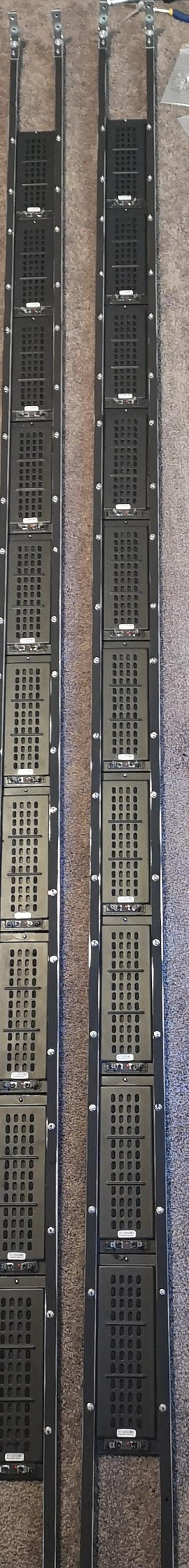

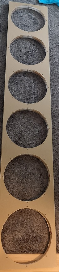

2 midrange panels!
Also got some clear acrylic 18mm cut for 6 x 15" woofer. Was going to use 15PR400 but was easier and cheaper to get deltalite 2515. Will have to live with the slightly higher FS. The eminence and B&C/Faital woofers have different screw hole ring diameters so made the holes bigger and shot for the middle. Might have to sand the edges to clean up the fog but I depends how lazy I get.

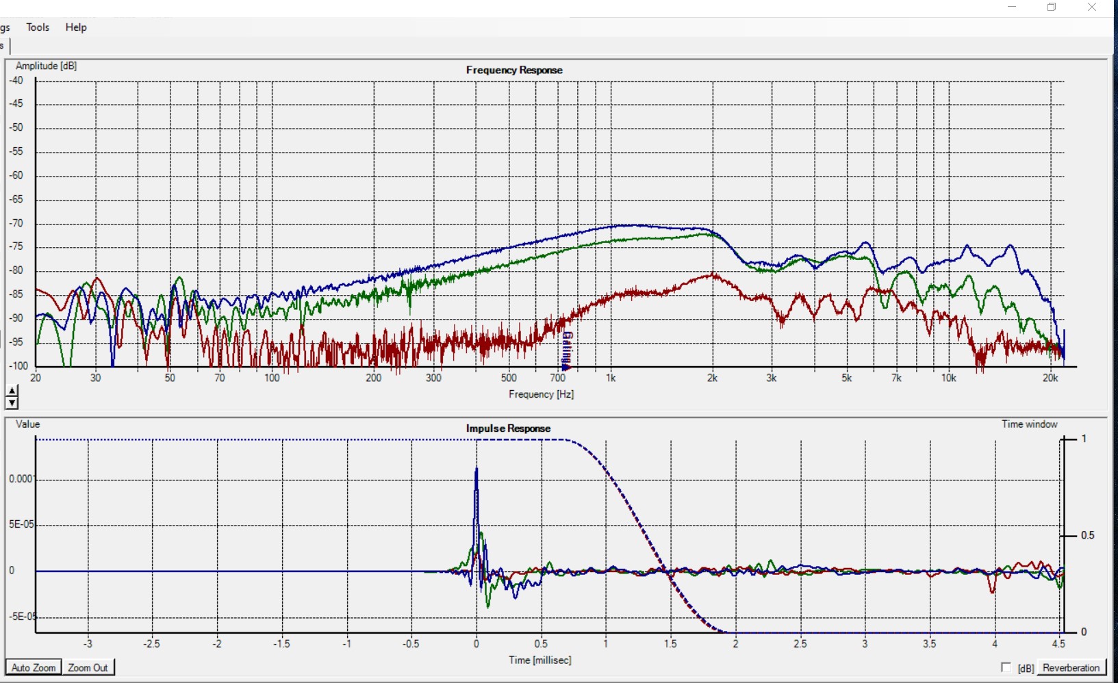

Was hoping to get some better measurements but this is tough in the position they are located in. Looks like measurements are only good till 700hz gated but will be taking some smoothed measurements later.
Midrange panel only. Blue is on axis about 12" from driver and halfway from floor to ceiling. Green is roughly 45 degrees and Red is 90 degrees. Maybe cross to the tweeter array at 7khz.

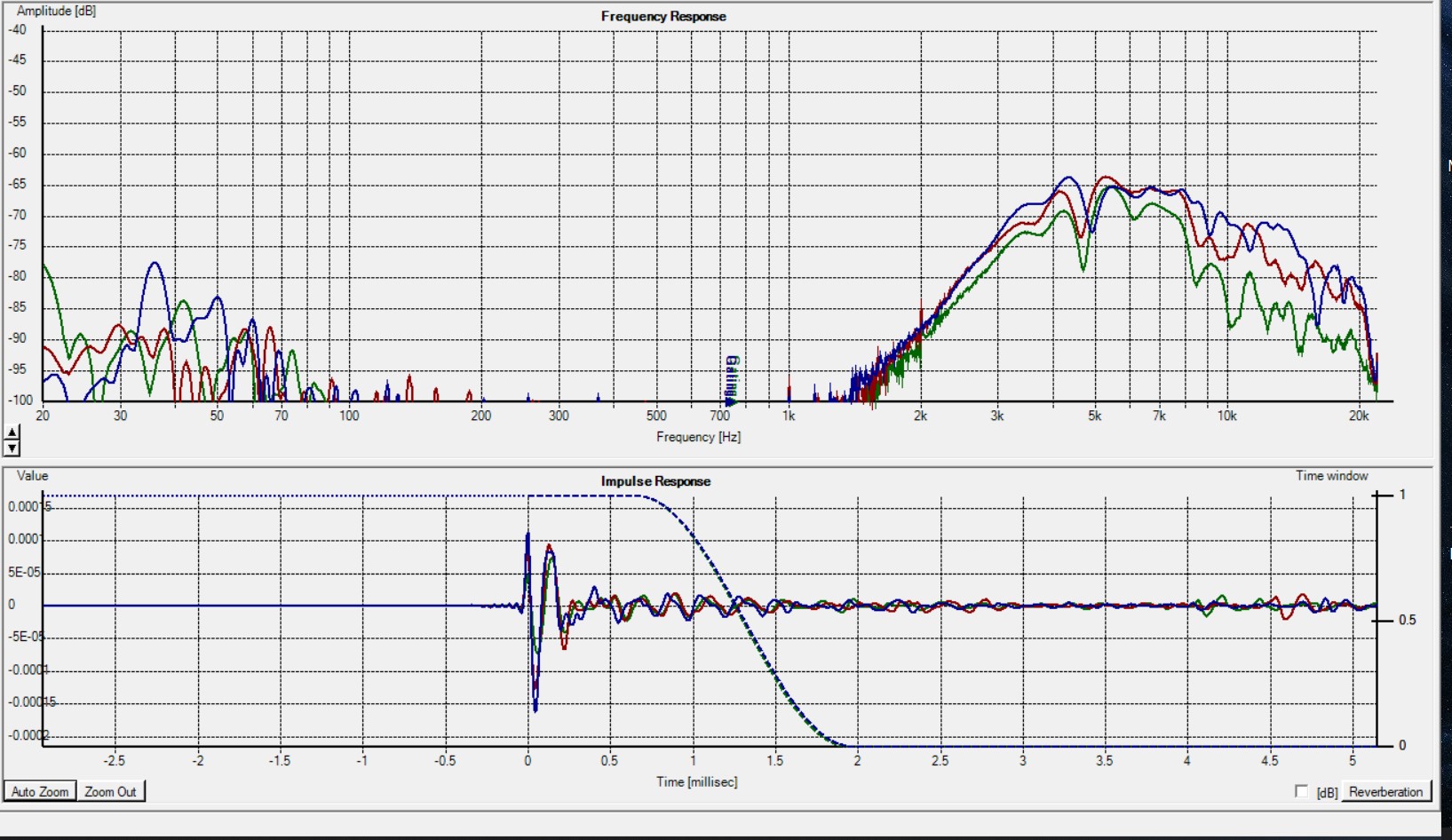

Also tweeter array at the same distance and degrees. This is non-dipole tweeter config.

You can easily use 4ms gating, but there will be some dips from reflections.
Looks like dipole pattern goes up to 2khz. Progressive directivity from 7kHz up. This means that in a room (with sidewalls) you'll get too much sound energy and poor CSD between 2 - 7khz, at listening spot.
Really interesting to me is to see how response changes with distance. Line arrays were invented for wide open spaces (PA use) when scattered interferences smooth the sound power through spectrum. Quite contrary to domestic hifi goal towards point source "coherence" with lots of direct sound. A dipole radiator in a room is also controversial...
Does it change with distance or angle, I don't see a distance change within these measurements...

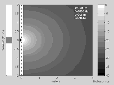

Domestic listening distance is in nearfield of a 2,5m high line array.
Speaker off axis: constant beamwidth transducers (CBTs) - Acoustic Frontiers
https://stevebunting.com/downloads/linearrays.pdf
FUNDAMENTAL LIMITATIONS OF LOUDSPEAKER DIRECTIVITY
Oh no, not the CBT graphs again, in here we talk about floor to ceiling arrays, not truncated arrays.
Infinite Line Source: analysis
So throw away those truncated array simulations as they do not apply.

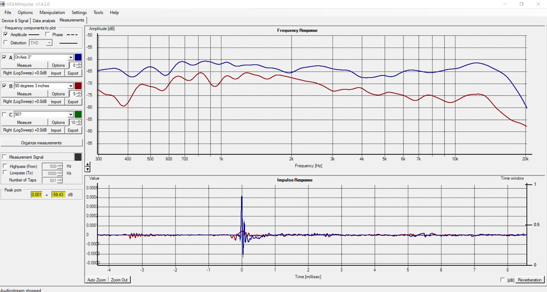

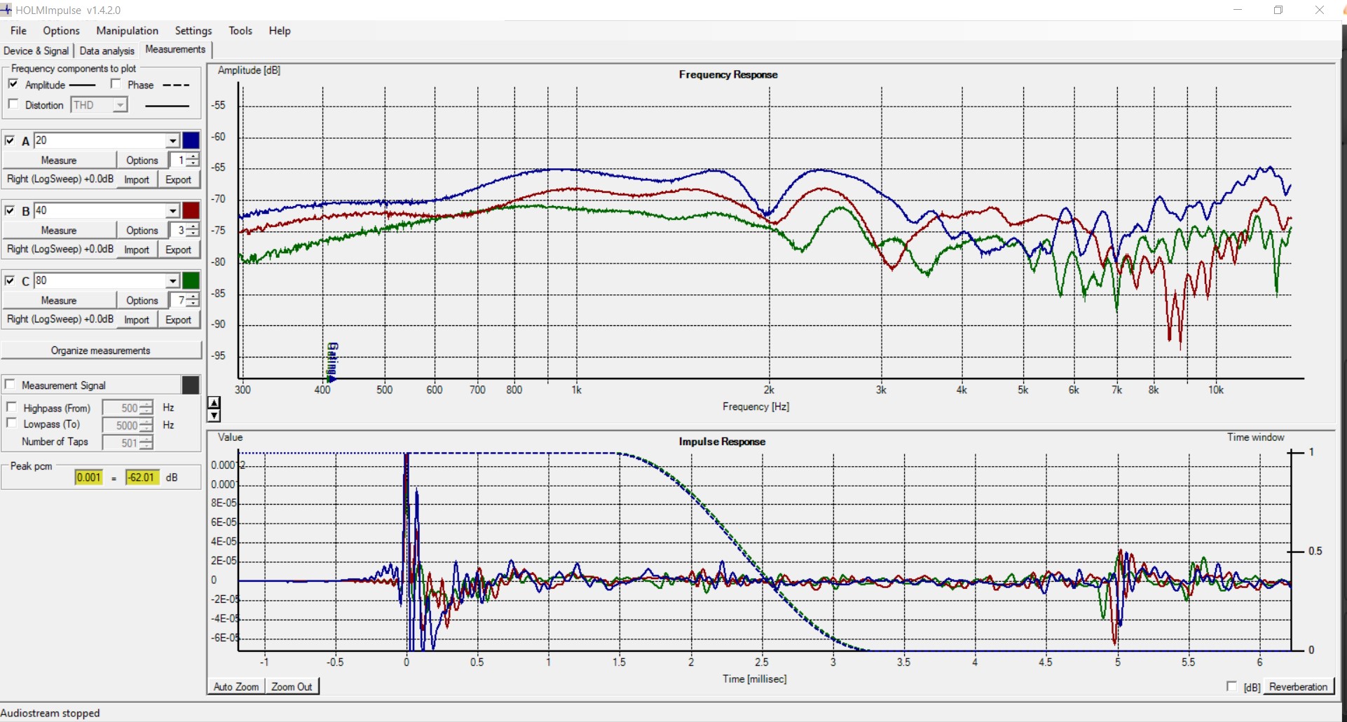

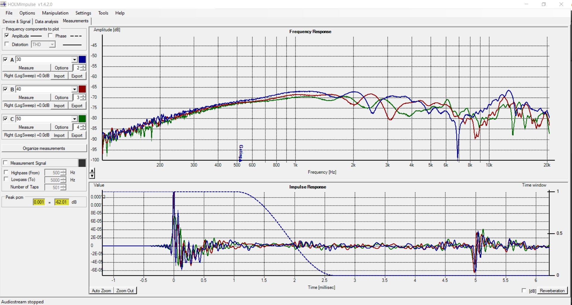

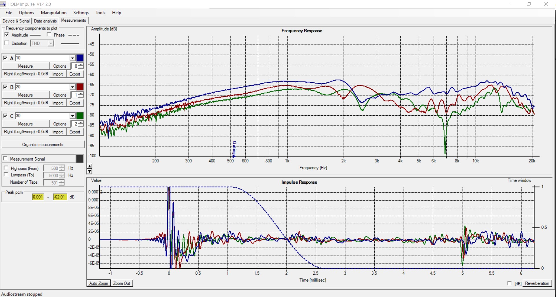

Midrange shown only. Couple more sweeps. Did on axis at various distances. Starting at roughly 10 inches and moving back 10 inches at a time.
There is 1 graph with 20, 40 and 80 inches, a bit zoomed in.

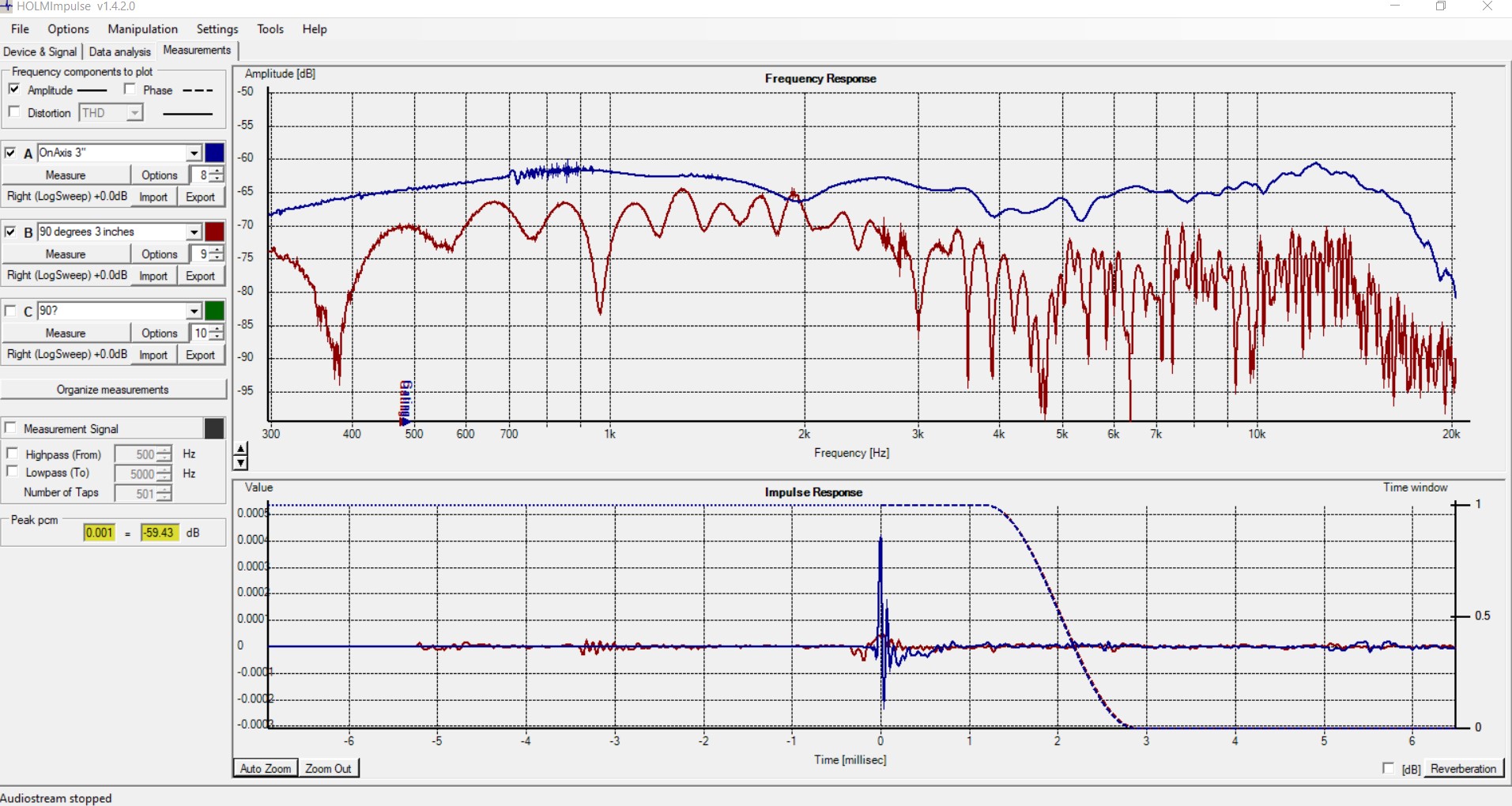

Mic is 3" from driver on axis and 3 " from panel at 90 degrees. Smoothed 1/6 and gated. While not indicative of the final array, I wanted to see the damage done.
