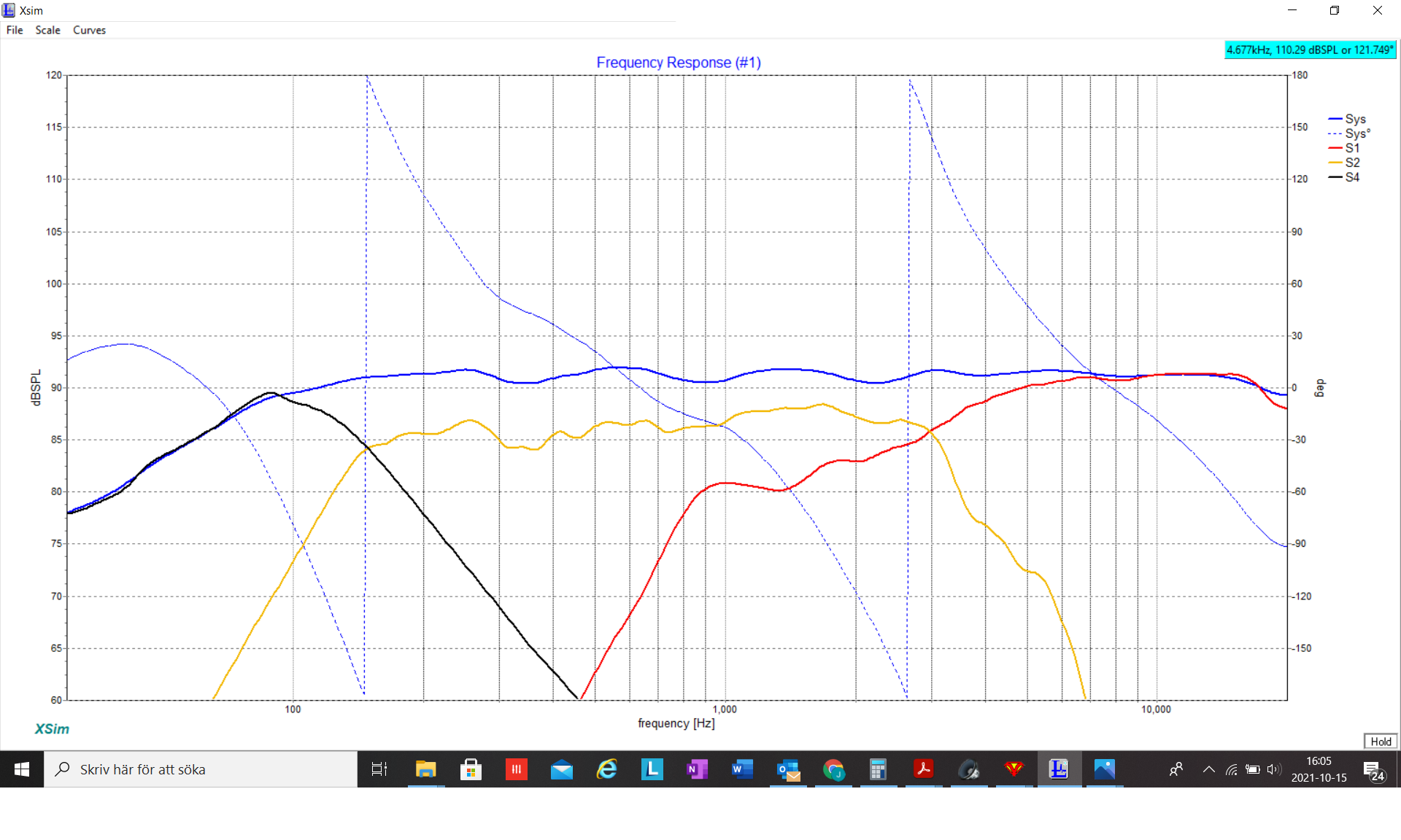

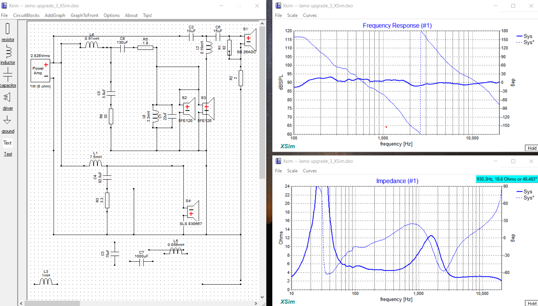

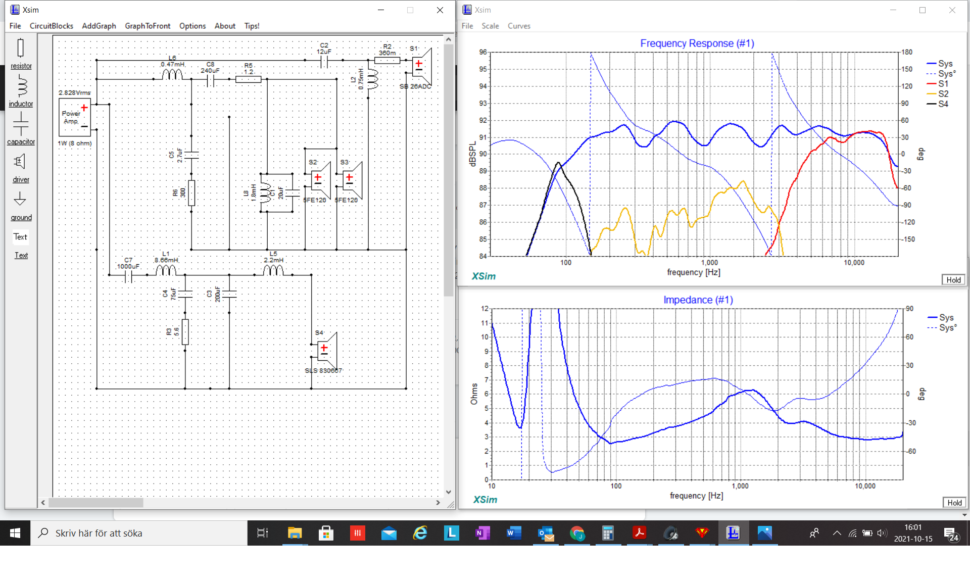

Have a question/problem with filterdesign in XSim, and my replacement drivers in my "upgraded" Jamo D590 project.
Are going to replace the orginal tweeter/midrange/woofer from my Jamo D590, and insteed use:
Sb Acoustics SB26ADC-C000-4 for tweeter
SB Acoustics SB26ADC-C000-4 Aluminum Dome Tweeter
2 x Faithal pro 5fe-120 8 Ohm for highbass/midrange
FaitalPRO 5FE120 - 5"
Peerlees SLS 830667 (8Ohm) for woofer
Peerless by Tymphany SLS-P830667 - 8" Subwoofer
Have spend many many hours simulating in XSim, and begain to get a nice curve, but the value´s on some of the component´s is abnormus.
This is only my secund xover i have build, and i know sometimes especially the capacitor value can by high but mine are ridiculous!.
Notice one of the pic´s has 1dB scale and the other ordinary 5dB, but look at the values like 1000uF in the bass-section and for example the 300 Ohm resistor in the midrange-sektion!
Could really need some help here.
Best regards John/Sweden

In the second image the yellow response looks sensible. Is it for one or two of the midrange units. I can only see an S2 and not an S2 and S3 ?
I think the tweeter response is extended to low in an attempt to maintain the overall level. Maybe a change of inductor to 0.18 - 0.3mH and tweaks to the capacitor such that the red and yellow traces mirror each other at your 3Khz crossover.
I would ditch the C7 for the time being and maybe adjust L1 to half its value and explore a crossover to the mid or mids at 250-400Hz, you will need to tune the capacitors C3 and C4 to match. Which will then require re adjustment of the mid roll on to suit.
Maybe consider sharing your files and see how others knock it into shape.

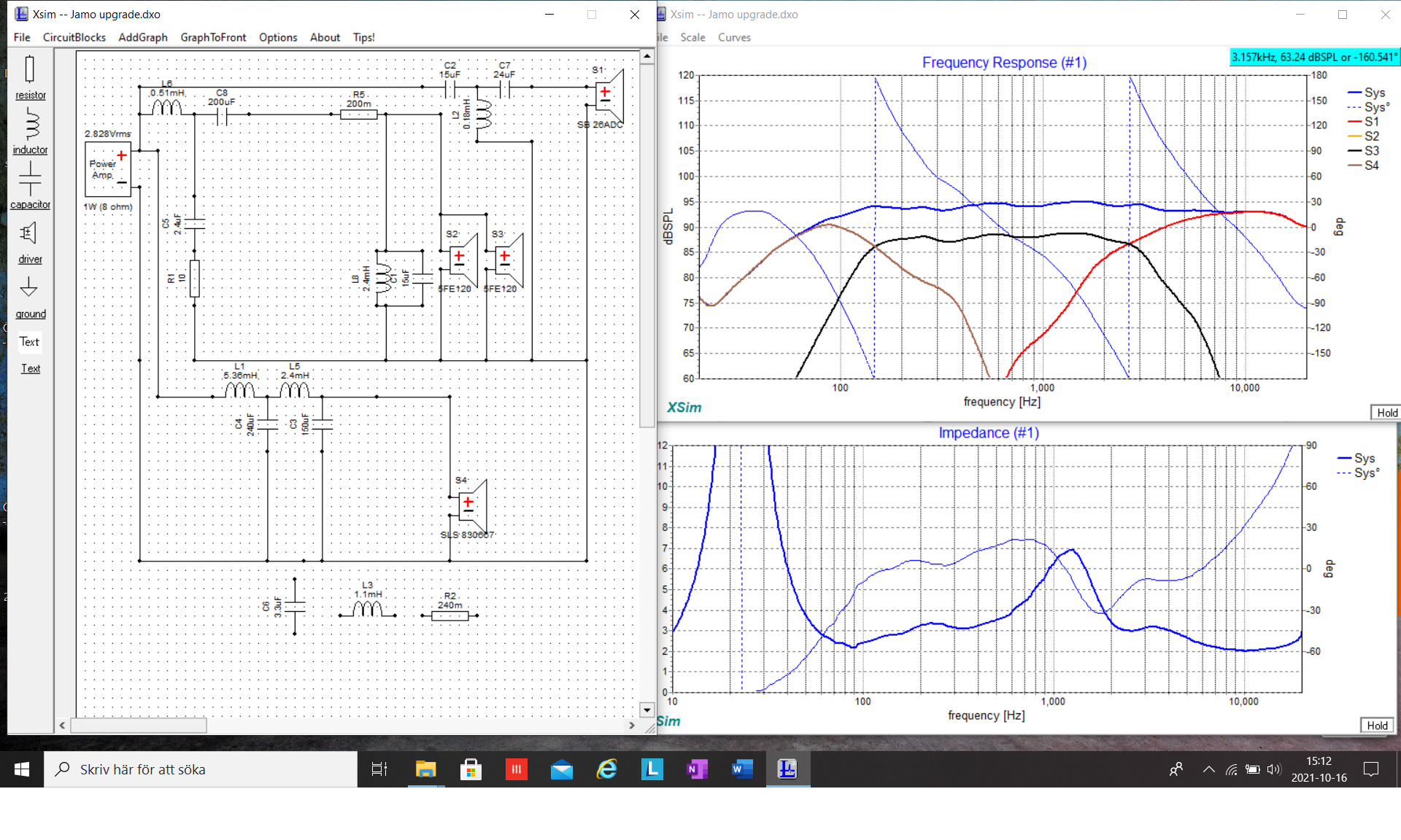

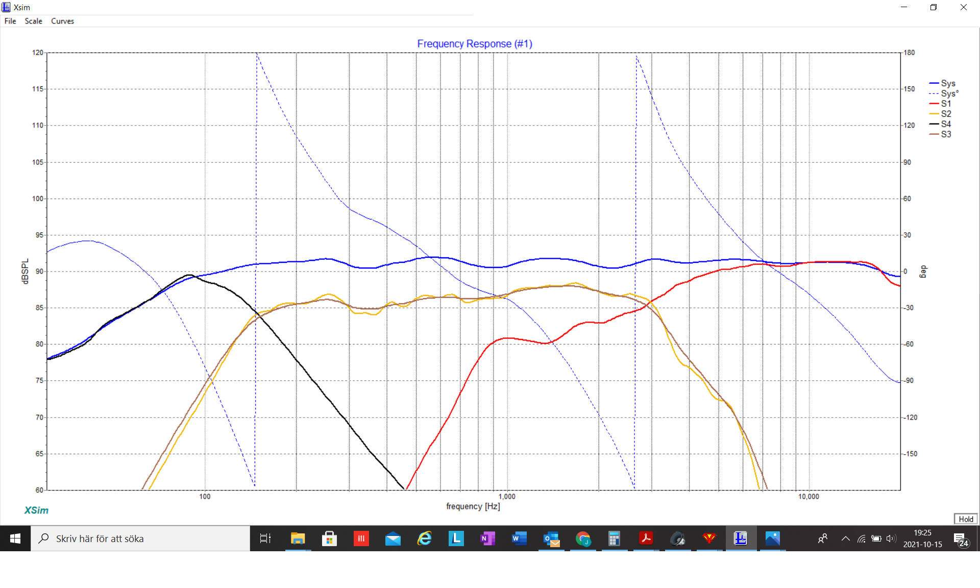

Thanks for answering raymondj
Usealy i don´t have both s2 and s3 in windows when i work with filer, so many colures and they use to be the same. ( here it is)
(even if this was not exaktly the same, when look´t at it)
I will try you´r uggestion "change of inductor to 0.18 - 0.3mH and tweaks to the capacitor such that the red and yellow traces mirror each other", and "ditch the C7"
But how and where do i "sharing your files and see how others knock it into shape"?

Forgot to answer about the woofer xover-point, i have read that downfiring-woofers ( as tha Jamo D590 have), shouldn't be crossed higher than about 150 hz.
The low vocal´s etc must come from the midwoofer/midrange.
( ditch the C7 and it give better low-end 🙂...Don´t know why i had it, but was quite tired after 7-80 hour´s of filterbuilding)
Regards John
When I commented I didnt know the details of the speaker.
I now know it is a MTM with a down firing woofer, and if others have told you 150Hz is optimum for this type of design, then take their advice.
The slot at the back of the cabinet is it for the woofer unit or the two midranges?

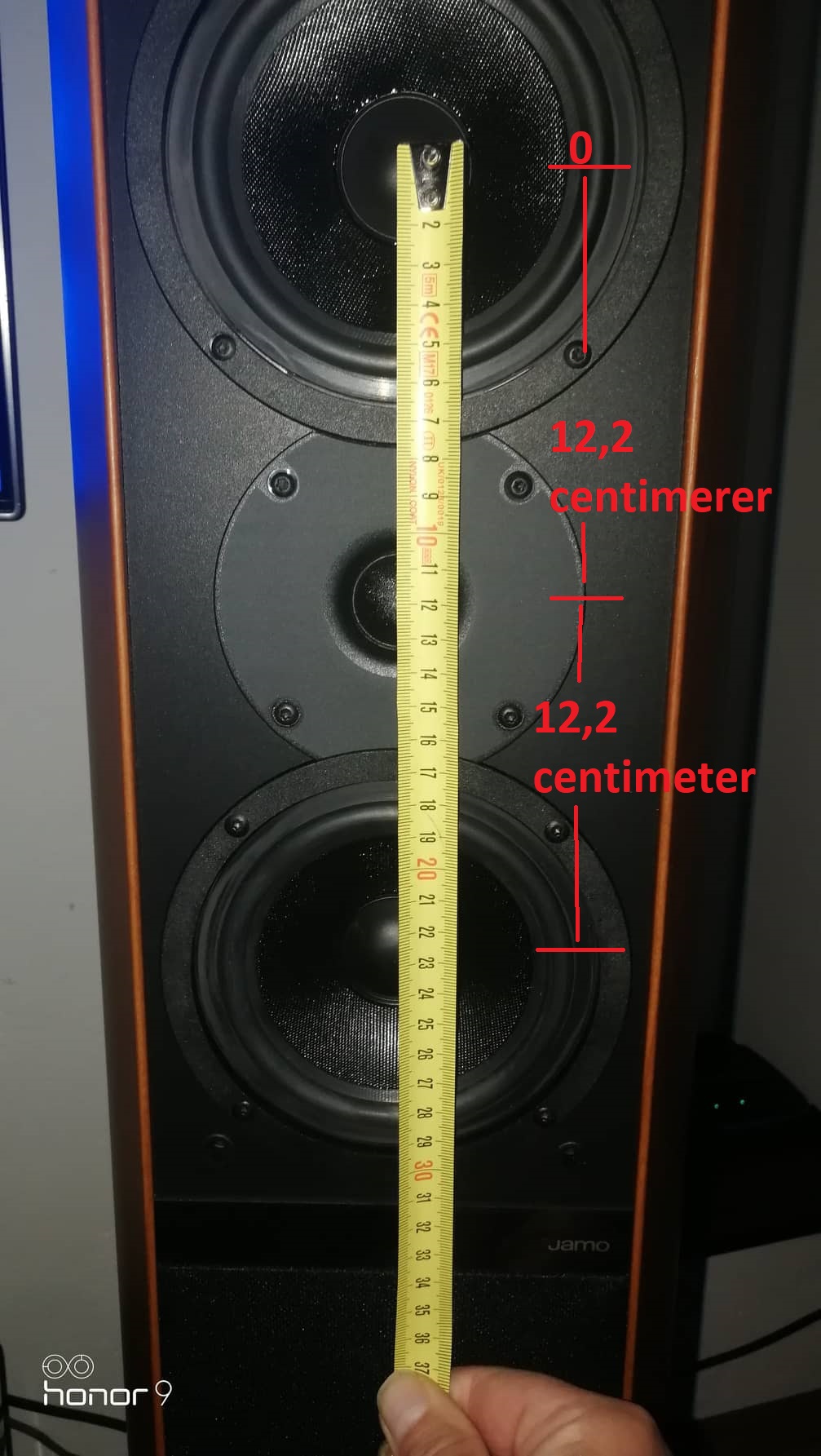

As to attaching your files. maybe zip the project or individual driver files and attach much like your image. Maybe let us know about driver centre to centre distances if you cannot zip the whole project?

Here a pic on the distance for the MTM, im sooo not technical with zip files and tech.
Regard John

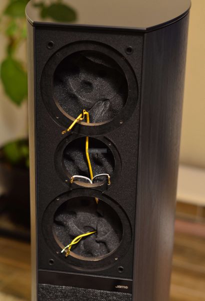

What happened to the original drivers, I am guessing they were good quality, vifa or scanspeak units. The tweeter looks a lot like a scan d2008/2010 and corresponding 5 inch paper drivers??

Think orginal drivers are Jamo self-produced ( i send a pic), the drivers look´s quite "inexpensive" so i think a have alot of better sound on my way with my project,
The Scan Speak d2008 have only 3 mounting holes, and the d2010 have the membran deeper in the faceplate a belive.
The D590 had later come in a 50th anniversary version, but i have the original.

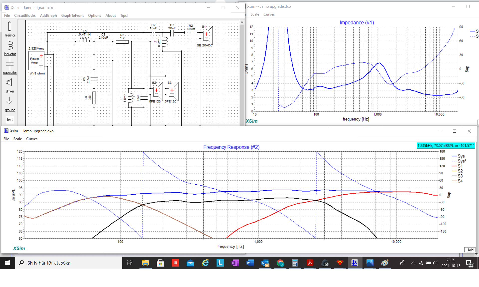

I have lower the tweeters inductor now to 0,22mH, change first cap to 12uF and also put a 36uF capacitor after (3rd Order)
Does it look better now raymondj?
Buy the way, my wanted xover-point´s are 150hz and 2700 hz
Some low impedance from 4k and up, between 3 and 2,4 Ohm!
Regards John

I guess all we have done is refine your original.
For better or worse, only listening backed up by measurement will tell. Even if by chance you hit a sweet sounding combination the room could change it all. Measurements also show how far we can be out by ear. However, if you are happy with the sound that is all that matters.
In terms of the drivers and cabinets there are still plenty of variables left. it would be nice to try and further simplify your crossovers and get back to some more sensible and hence relatively cheap components.
Additionally I haven't though about or applied any of the basic rules for a D'Appolito configuration. It might be worth trying that with your sensible crossover frequencies and then tune the woofer for the MTM array and your room.
Your last image is obviously better.
Its always a case of iteration. All simulations are possibilities.
Listening and making changes is time consuming to say the least. Measurements make it faster, then making changes and more listening to correct obvious areas of concern.

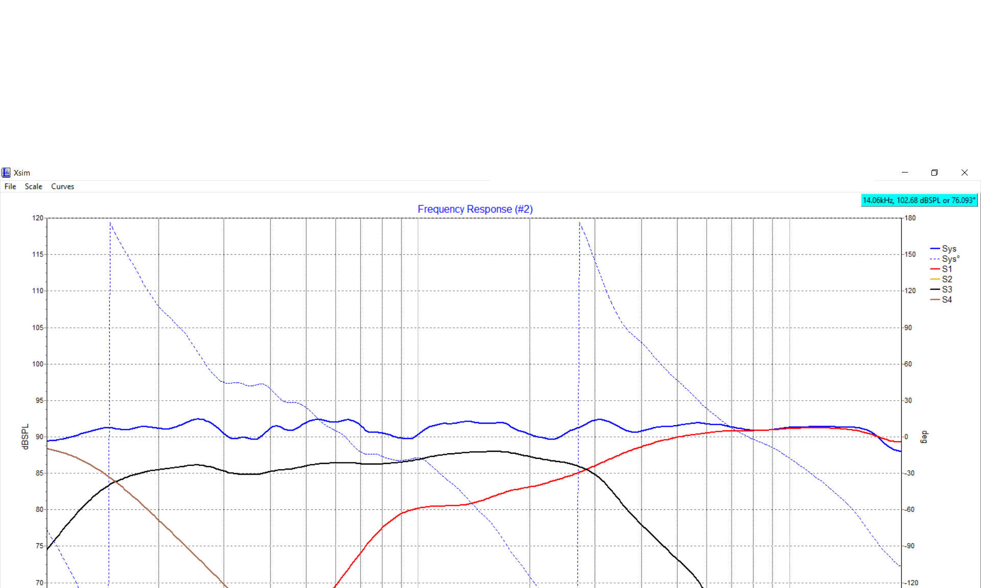

I have attached another possible starting point.
It is still a compromise. Also Post Covid prices for copper plus worldwide demand means low impedance inductors with lots of copper are expensive and some are on projected lead times for stock.
I haven't had time yet to figure out how the two mids will react to their volume, they may roll off quite naturally without two much help, or there may be a peak which will need working

Thank you so much rajmondj 🙂
You know when you sit a really long time making xover´s, you´r head begain to spin and in the end you hardley know what you´r doing!
Last XSim.dxo you post seems to have a nice curve and only 1 big 7,5mH coil, and a 130uF and 82uF capasitor.
My latest xover have a 5,36mH coil and 240,200 and 150uF capasitors, even if 2 of them are going to be cheep elektrolyt caps.
