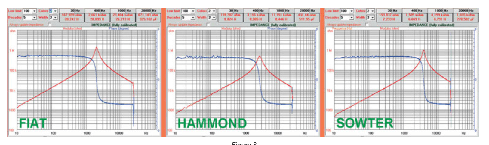

Test done with a sw of my friend Fabrizio , a little box to switch inout/out of sound card and a R as reference.
Secondary open
Three different OT, Fiat ( same people who made for me the trafo), Hammond s.e. and Sowter SF potted type
The red line is the impedance module and the blu is the fase.
The peak is different for each one and for all it is possible to see that until the resonance the andament is inductive after became capacitive.
For Fiat the resonace is at 2 kHz, Hammond is at 2 kHz (around) and Sowter is 3 kHz
( I try to ge the original image to read better the numbers
Walter

Without a knowing how you tested this it doesn’t mean anything to me. What kind of probe did you use?In attach an old graph alredy published here in the old thread about reverse test of OT

It is the same as testing a coil with a proper hw and sw
A sound card and switch box
I think that similar test can be done with Limp of Arta
( I don’t have the proper knowledge)
I will send the graph of test of the three trafos where it is possible to see the results that match with the indication of the previous graph
