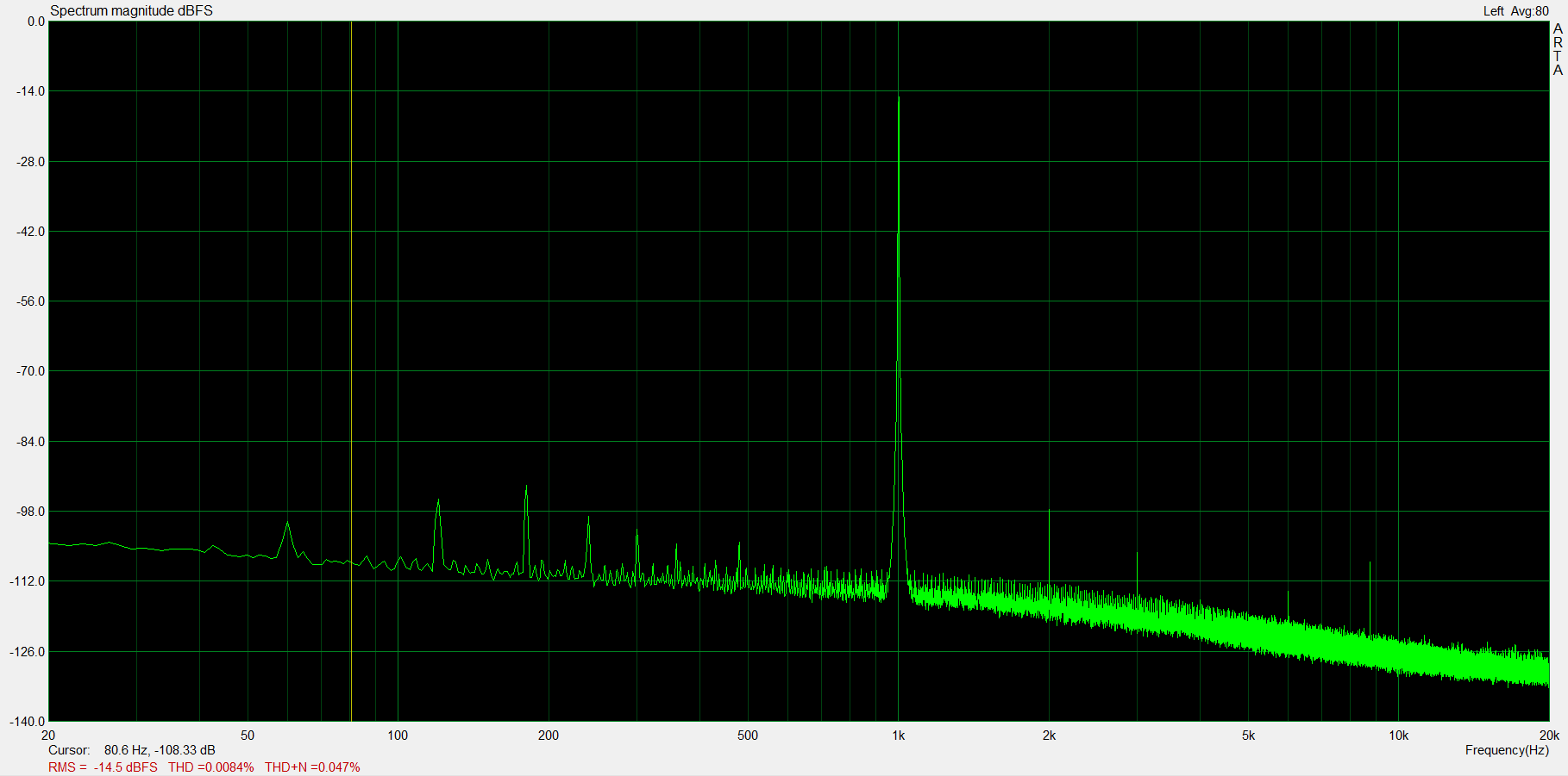

Attached is distortion spectrum from a CCS-loaded (10mA) EL84 with feedback set for gain of 10 and run at 10Vrms output. Ignore the spike between 8-9kHz. It's a measurement setup artifact.

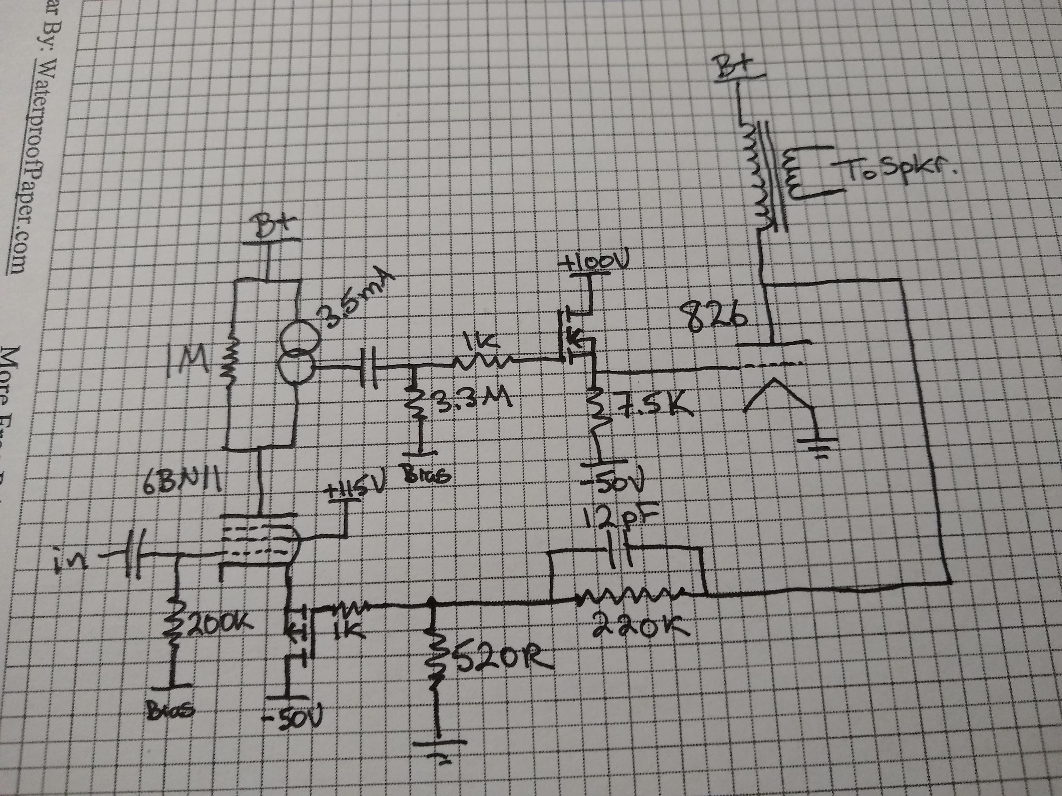

In those those earlier experiments I was using power pentodes, since I was trying to make a very high swing driver and needed a high idle plate voltage. I did try power beam tubes and got significantly more distortion. This makes sense, power beam tubes tend to have kinky characteristics at low plate voltages and low currents. Those kinks may have gone away at low screen voltages? I don't know, but I got better results with true pentodes before I tried reducing screen voltage as much as possible.
Right now I'm playing with a small-signal beam tube (6BN11, dual version of 6EW6) and getting very good results. EL34 gave me an open-loop gain of 300 with CCS load. 6BN11 is giving me 2600. I've extended my feedback loop to come from the output tube plate (so that I can use a positive-bias, high impedance transmitting triode that would otherwise be unsuitable for an open-loop SE amp), and I'm getting very low distortion (0.027% at 1W).
I'm driving the cathode with the p-channel FET but I don't think there's much "UL effect" since screen is pretty high and swings are 1V at most here. In any case, overall distortion is 1/3 as much as if I directly connect the input tube cathode to the feedback network, which is the more standard configuration.
I'm loving how simple it is, but it definitely doesn't add color to the sound like the earlier experiments I ran that had ~0.5% distortion at 1W. It is just very much in control of the speaker and authoritative.
I'd like to see what this 6BN11 or a similar tube is capable of in the configuration of the experiments I ran. I bet that the high open-loop gain would reduce distortion even closer to nothing.
If you do choose to rig something up to play with, I'd be happy to offer details on what worked best for me, like CCS FET selection, etc.

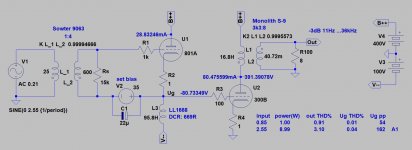

Sounds like heresy on a thread which I started to produce designs for an all-DHT 2 stage 300b SE, but I've been using indirectly heated drivers in triode for the last 2 weeks. First EL84 then EL33. Both surprisingly good sounding. And there are plenty of EL33 equivalents like KT61, 6P25, 6P26, EL41 etc. that I haven't even tried yet.
Once you have a mu of around 20 in the driver valve, you would then have enough gain if you used a 1:2 step-up input transformer. So my next question is please recommend a 1:2 step-up transformer for the input. Lundahl, Sowter, Jensen, Cinemag, Hammond Broadcast......? Plenty of models can do 1:2. So what is a truly inspirational SUT?

A 1:2 voltage step up transformer does several things:
Its input impedance is 1/4 of the load impedance.
Its low frequency roll off is dependent on the signal source's output impedance versus the primary inductance.
Its high frequency roll off is dependent on both the distributed capacitance of the primary and the leakage inductance from primary to secondary; versus the output impedance of the signal source, and the impedance that the secondary drives, respectively.
There may be large phase shifts in the transformer (large group delay).
Given enough money, all the above problems can be overcome.
Get your wallet or credit card out.

What is:
a. Bias voltage of the output tube,
b. Measured in-circuit voltage gain of the driver, and
c. Max available input voltage to the grid of driver
d. Impedance of the voltage source to the grid of the input tube.
Try and avoid need to use transformer.
Otherwise, LL7903 as 1:2 - just make sure the source drive impedance is suitably low if you use RC circuit across the secondary. With open grid to signal common, drive impedance doesn't matter nearly as much.
