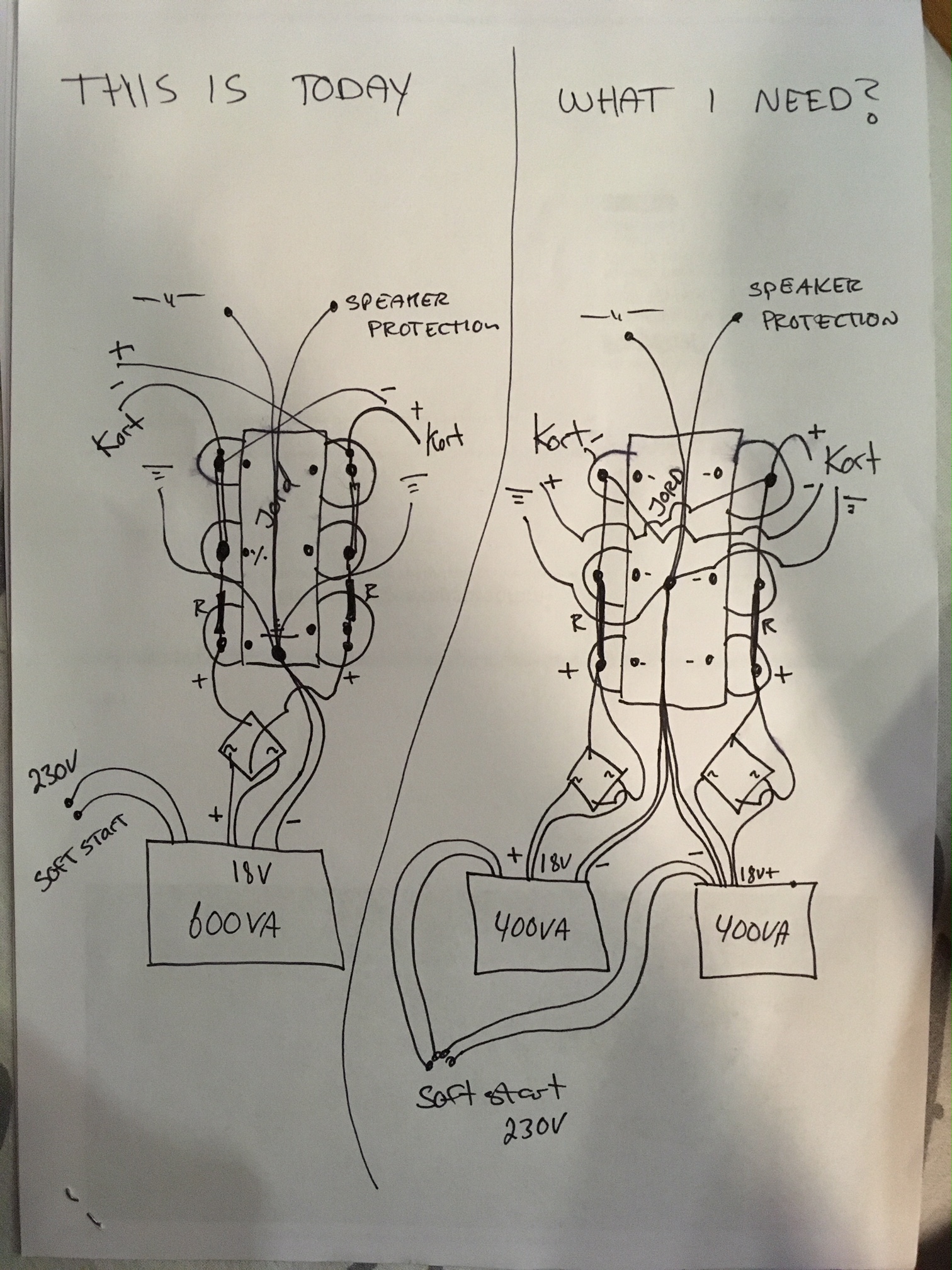

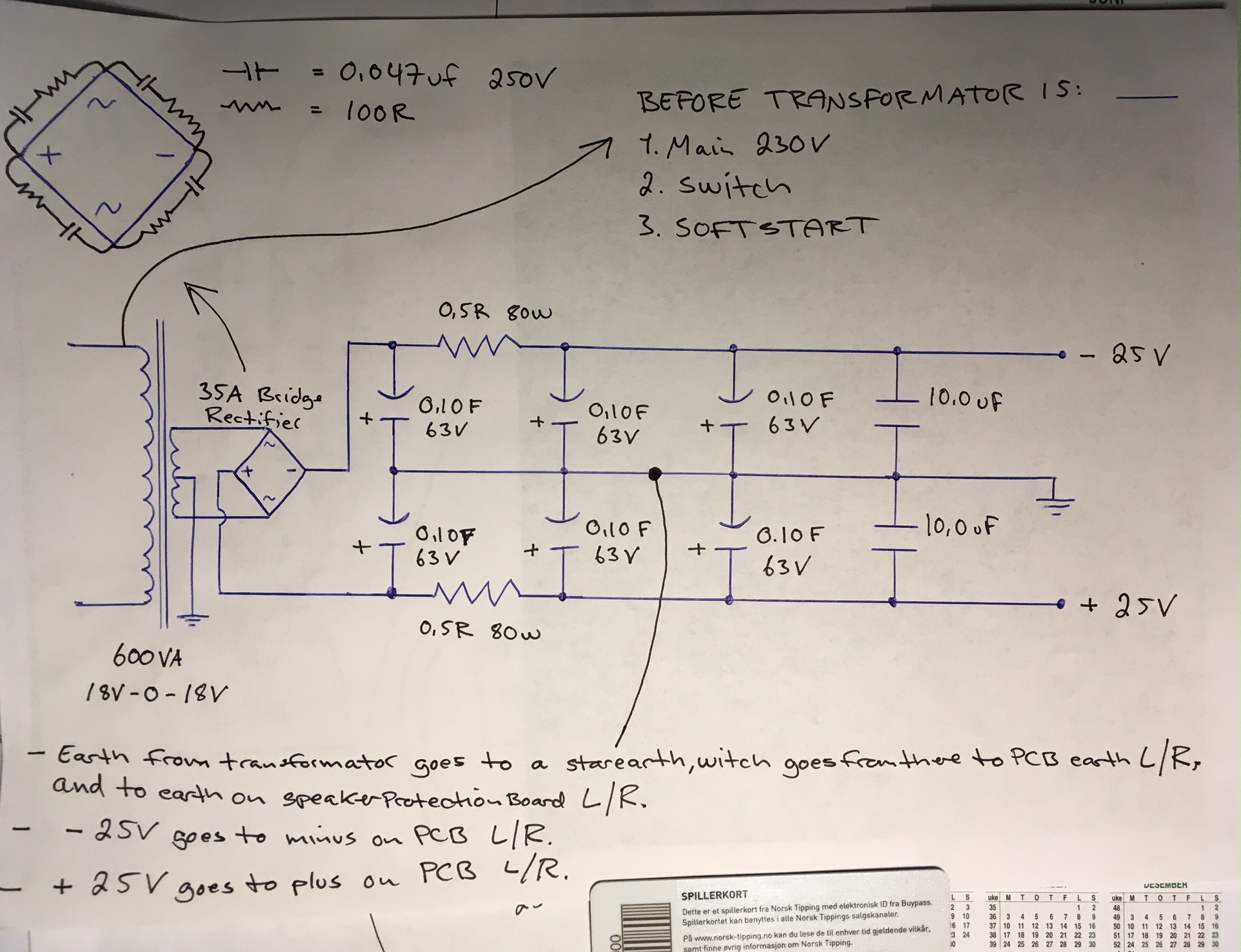

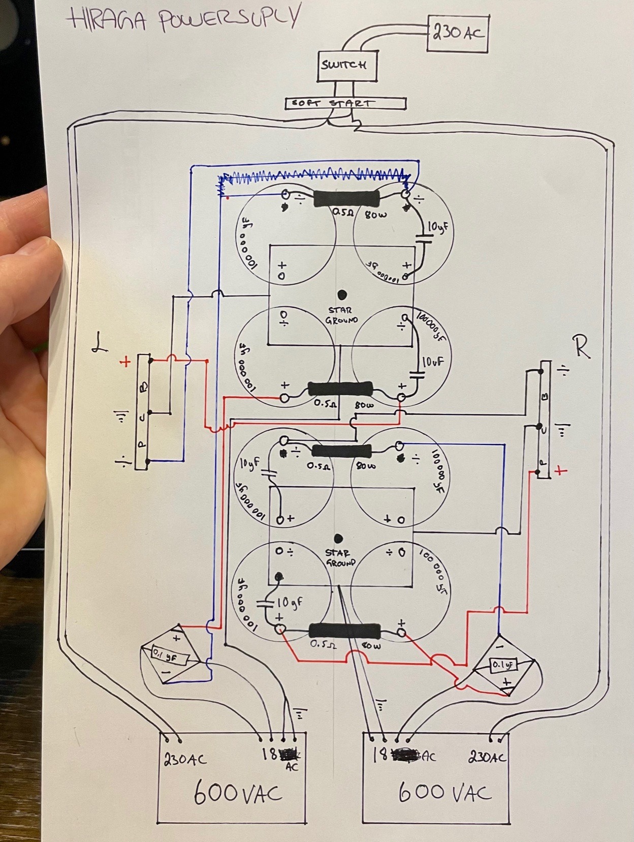

Hi, I build my Hiraga with pcb from Jims Audio 4 years ago.
Build PSU from drawings from diyaudioprosject.com with some different values.
But I have missunderstand it all, drawings show just one canal.
I use PSU for one canal for bouth Left and Right ) :
Here is some drawings and picture.
What do you people think of this?
It plays good, stabile +- 30mv dc on output, some hum from speaker within 1m but no problem when playing music.
Frank
Frank

A good and relativly cheap alternative C-L-C supply is in the attached picture:
It uses a Talema toroidal transformer with 300 Watt and 2 x 25 Volt
output (Euro 55 at Farnell).

The positive and negative supply is filtered by 4 x 10 mF
Nichicon LLS1V103MELA caps (Euro 2.9 @ Mouser).
For a tight budget, 3x 10 mF or 3 x 4.7 mF are OK too.
Two Epcos common mode chokes B82733F2232B001 are used
to filter the ripple (Euro 2.4 at Mouser) down to less than a millivolt!
The Epcos have about 0.15 Ohm series resistance and therefore
do not cost much headroom.
Be careful to insert them correctly so that the 100 Hz ripple
is seen as common mode.
The rectifier is a GBU806 or similar (1 Euro @Mouser).
A RC snubber (100nF + 1kOhm) over each secondary winding
damps oscillations due to parasitic inductance of the
transformator. A secondary 100 nF should be used
directly at each amplifier.

As i understoodd, i am good to go with just one of this transfomer to connect on two Power Supply as you described. One Power Supply per Hiraga PCB Channel. Is it ok?
You can use one transformer if the power rating is Ok for your needs.
You can even use one transformer and only one power supply circuit (cap + filter) and connect the left and right Hiraga channels to it.
Many amplifiers do it this way to save cost and space and audio quality will not suffer.
Udo

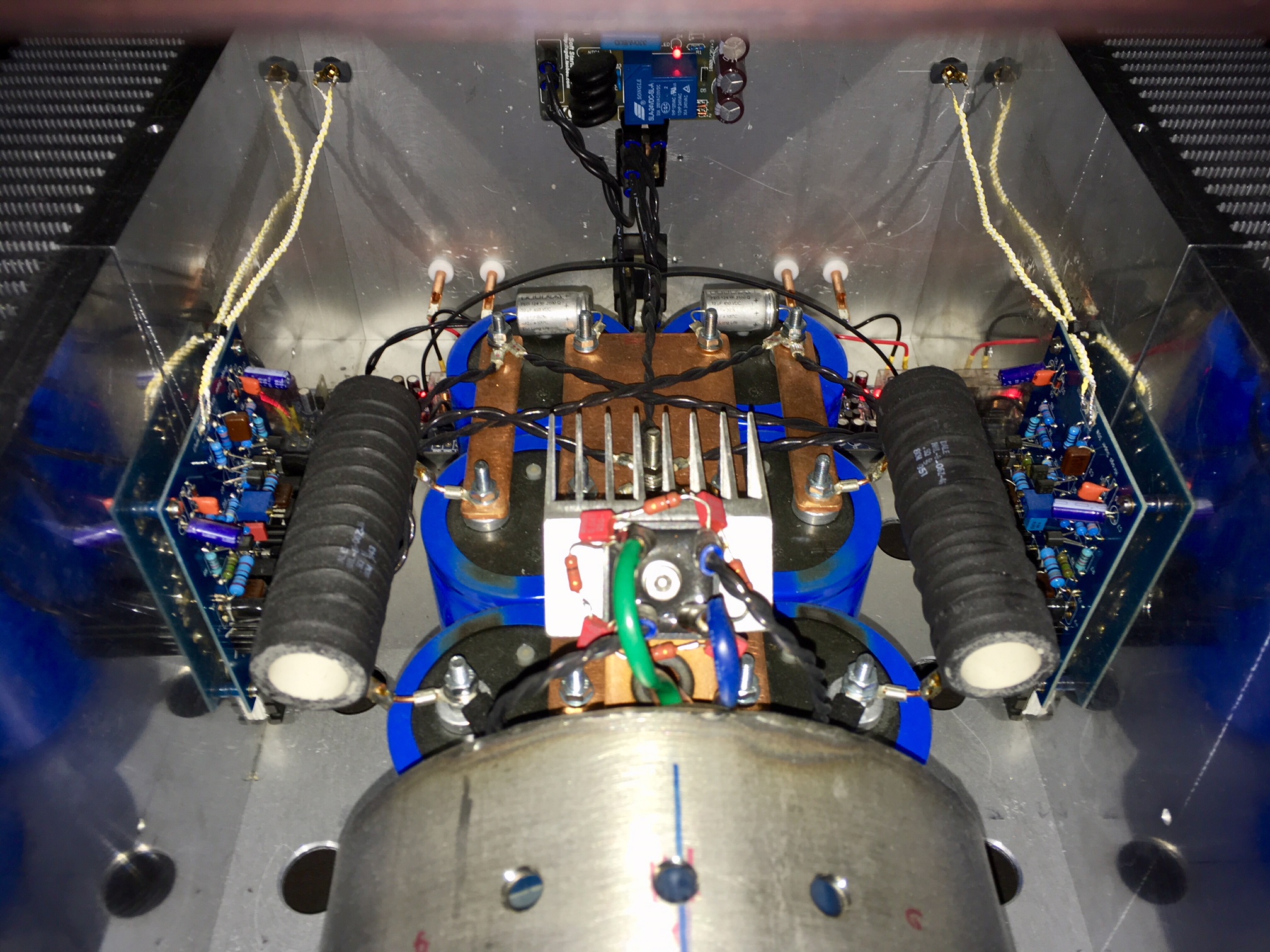

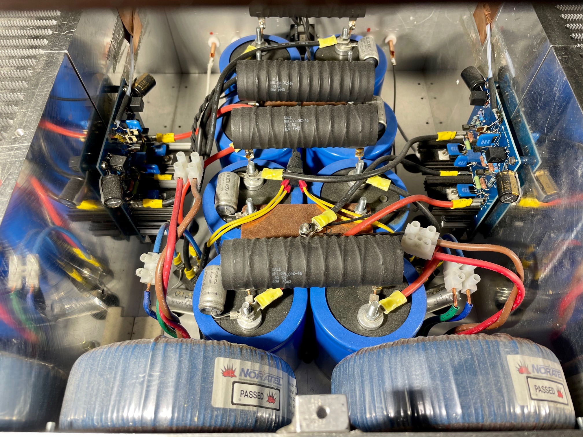

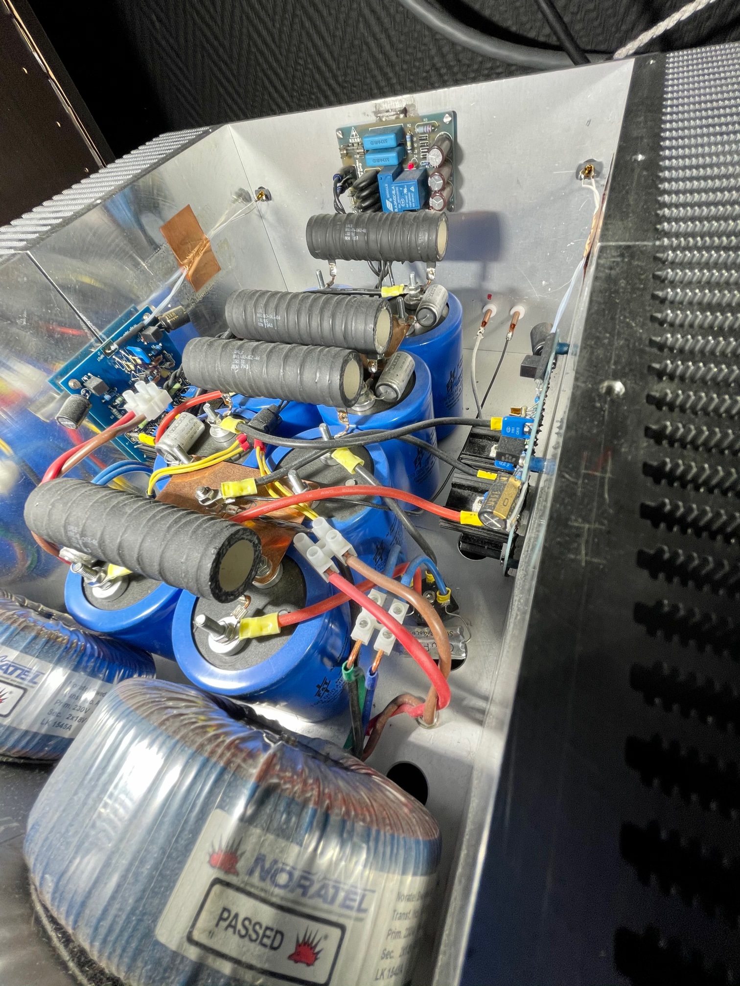

Great improvement, it looks like a massive power supply! Please, where did you buy those caps and big resistors? May you share the schematics?Regards! I am just begging my Hiraga project and choosing the best way.Hi, here is my Hiraga today. 2 transformers and 8+100000uf caps. Compare with old version, 4 posts back.
View attachment 1010332 View attachment 1010333
By the way, does it sound beeter with dual power supply? Just let me know when you have the draw. Regards!Hi, the caps is from hificollectiv ( F&T G Radial Cap ). But out of stock now. The resistor I got from ebay ( Dale ).
I dont have a schematic for the amp, but I can draw one. Give me some time ( :

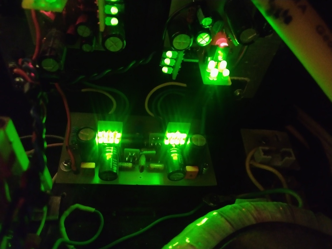

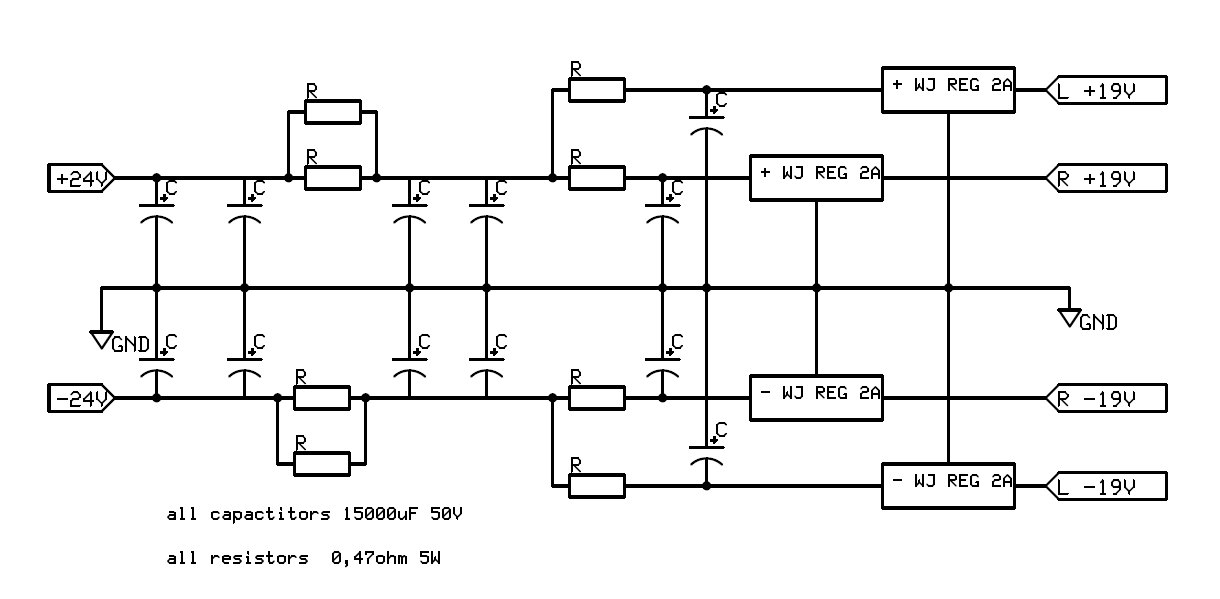

I have been using regulators with classic filtration in the power supply of Class A amplifiers for the last 5 years. The regulators are well known Improved_PN_Regs by Walt Jung but improved and modified for higher currents, they are tested on 5A. The minimum voltage drop across them is 3V. I first used them in JLH2003 then Le monstre and now in Hiraga 20W A class (picture below). I am very pleased with the results as well as the sound so they stay in the amp forever.
