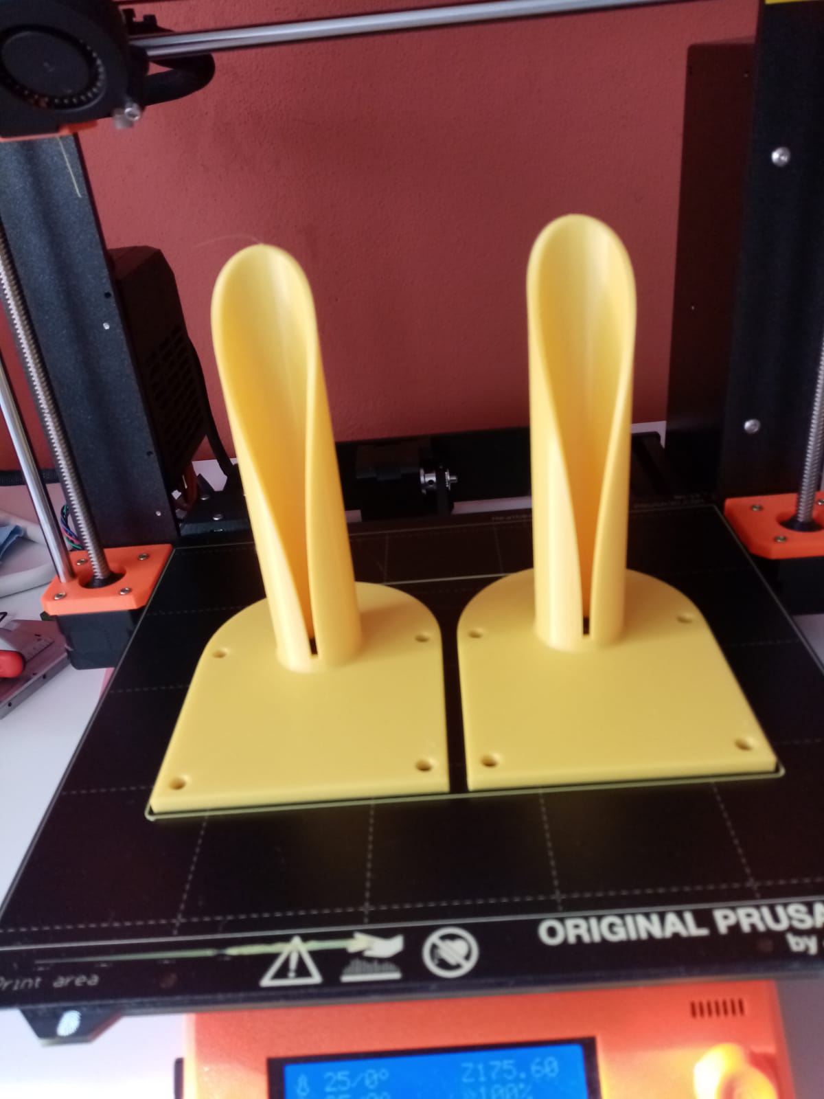

After acquiring a Karslon K15 clone, I got inspired by Freddi to try the K-Tube with a 1" compression driver. Since the orginals are very rare, I made my own with the help of Fusion360 and a 3D printer. I have the first test pair printed. In the attachment, there is the STL model. I am looking forward to trying them out, I hope to find some time during the weekend🙂

I did a quick test in my 4way horn system replacing the tweeter horn with the tube. There it plays from ca 4 kHz up. As a first impression, it seems more directional than a JBL2380 horn and maybe slightly lower sensitivity, that is basically all I can say now. I will need to do some proper measurements with the whole range of the compression driver. It did sound OK to my ear.

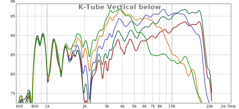

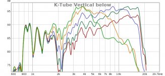

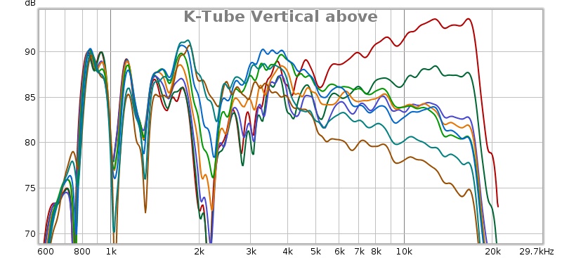

Here are some quick polar measurements. They confirm my impression, that they are more directive than the ARB-2 horns. They are not called sound lasers for nothing🙂 All the measurements are spaced roughly 10 degrees apart. Above means above the upper side with the slot down.
I would see the dispersion as 40 x 20 degrees, horizontally symmetrical and vertically on axis and 20 deg below. I would point the tubes slightly above listeners head and horizontally on axis or up to 10 deg off axis for nice symmetry. All that above ca 3.5 kHz.

By "above" the tube - I assume that means the mic was pretty much pointing straight down the tube - is that correct?

pelanj -In post 12 when discerning the tube's horizontal chararacteristics I gather the tube's long axis was parallel with the floor (?) If so, it would be interesting to see how the composite patterns look with the tube tilted 30 degrees "up". In practice, that type tube can sound pretty good - even Carl's extended length version of one Karlson X15 tube sounded nice (but measured rouigh due to its funky transitions from a little tube to the main tube - Carl said in that case it takes a lot of microphone points to tell the whole story (?) In my graph posted above, 30 off horizontal with the tube tilted 30 degrees was pretty mucH the same as 0 degrees. Going to 60 degrees off, things had dropped ~10dB by 10KHz. I should have taken off -horizontal axis curves at various microphone heights to see what happens.
