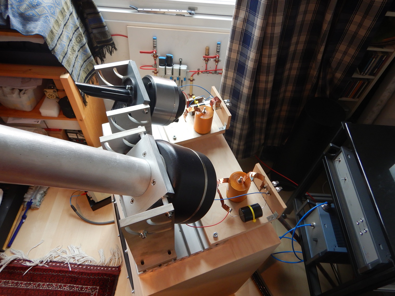

Good afternoon Freddi and Pelanj,

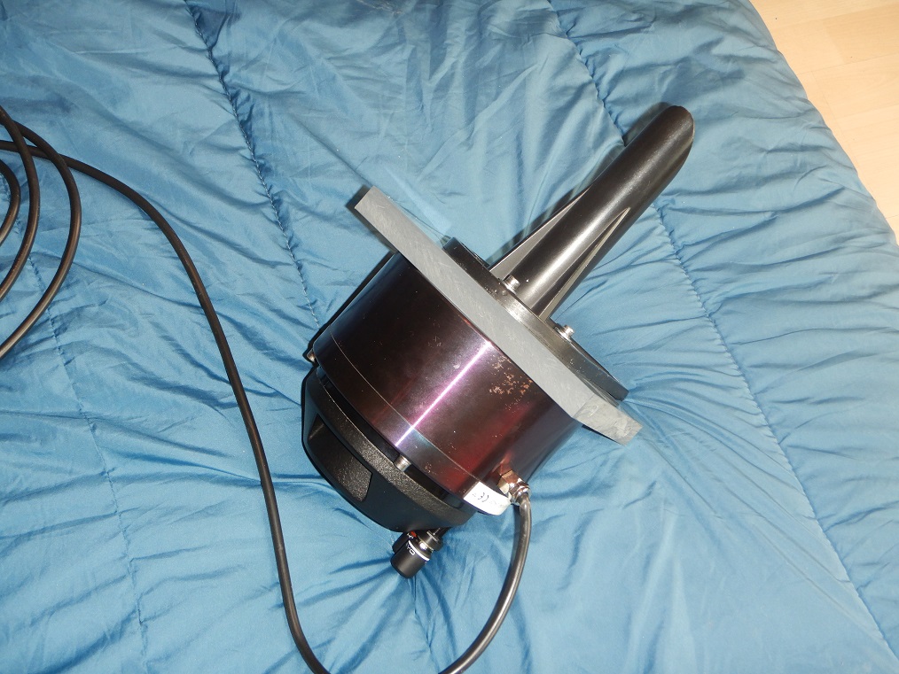

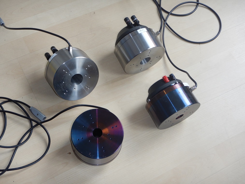

i would be very interested in such a "in between" K-tube as well.
Currently i have a 1" and a 1,4" fieldcoil Von Langa driver. These are almost the same; differences are the colour (who cares) and throat-diameter.
Till now i had the 1.4" and had to use a throat adapter (1.4-to-1) to fix them to the original K-tubes. It worked but that downsizing throat adapter acts as a high roll-off filter (in a tweeter ?!).
A couple of weeks ago i scored the same driver with a 1" throat. A natural match for that original K-tube. The highs are better and more crisp.
A throat adapter is acceptable when flaring out; flaring in restricts clearly.
So for my 1.4" (fully acceptable with a 1.5") i would love to have a set K-tubes so i could bolt them on directly.
Reinout
(the blank metal drivers are 1.4"; the black ones are 1")(so at the 1.4" i hed to down-converse to 1".....not wise )

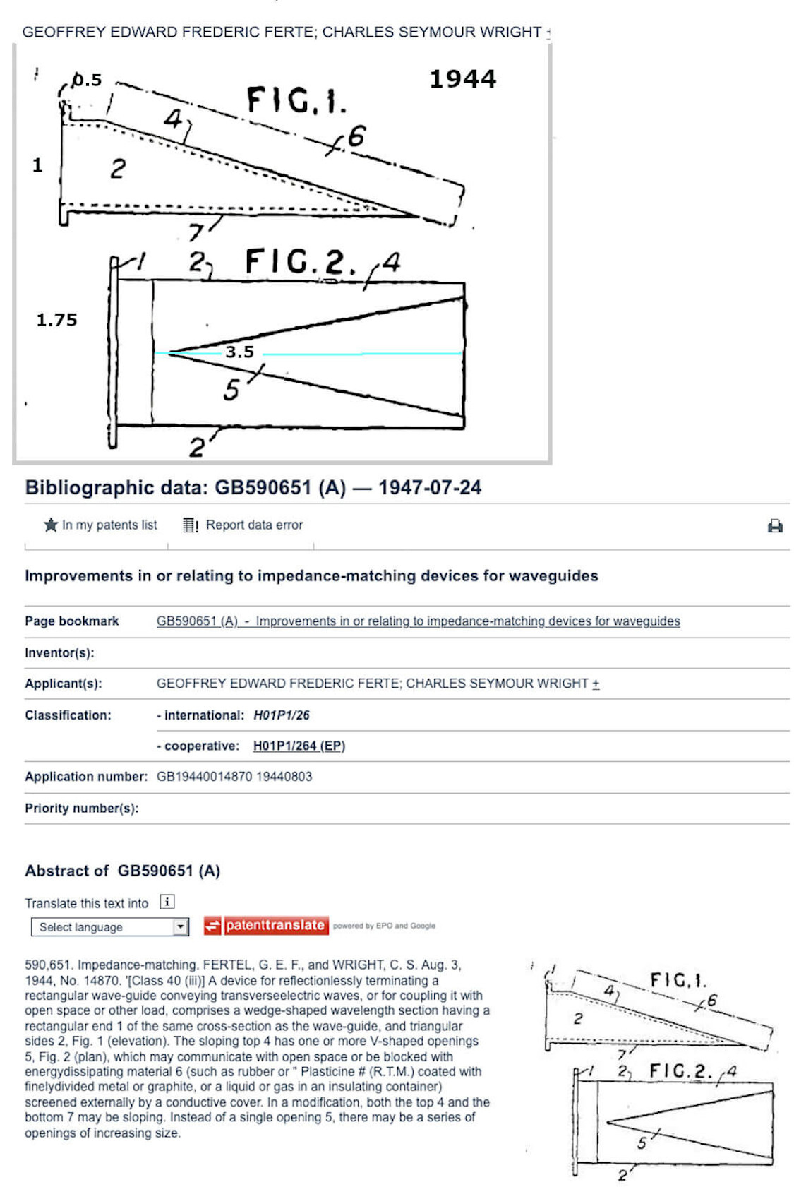

besides an oval tube per Karlson's "Open End Waveguide" patent,
this proto-K-tube /"klam" (microwave) from 1944 might be fun for experiment
and possibly with paper / cardboard. Opening other than the "V" could be tried.

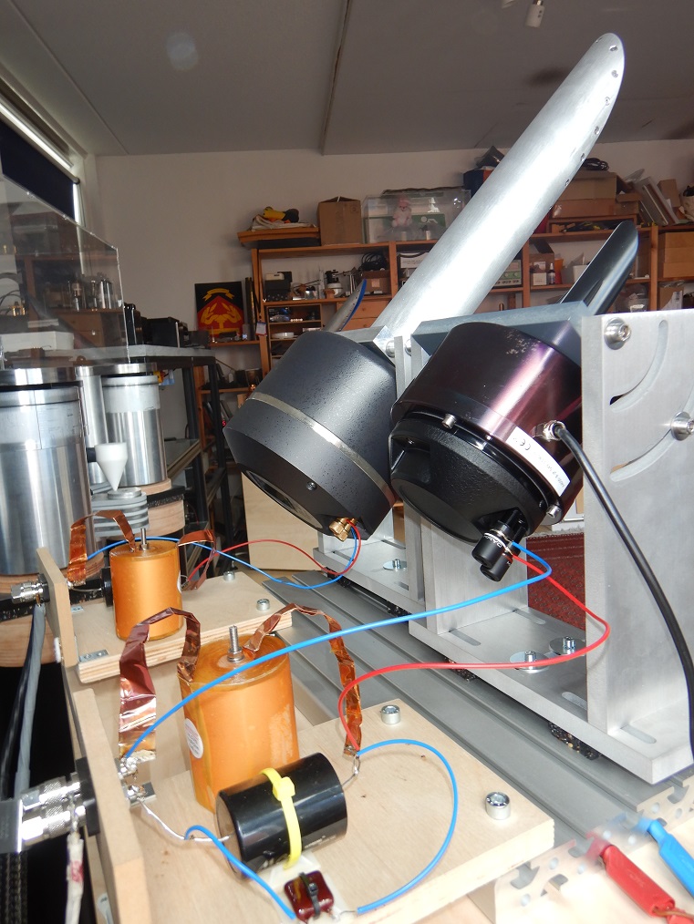

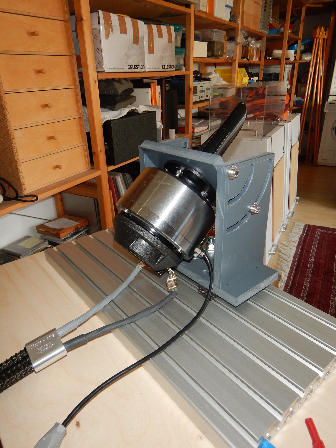

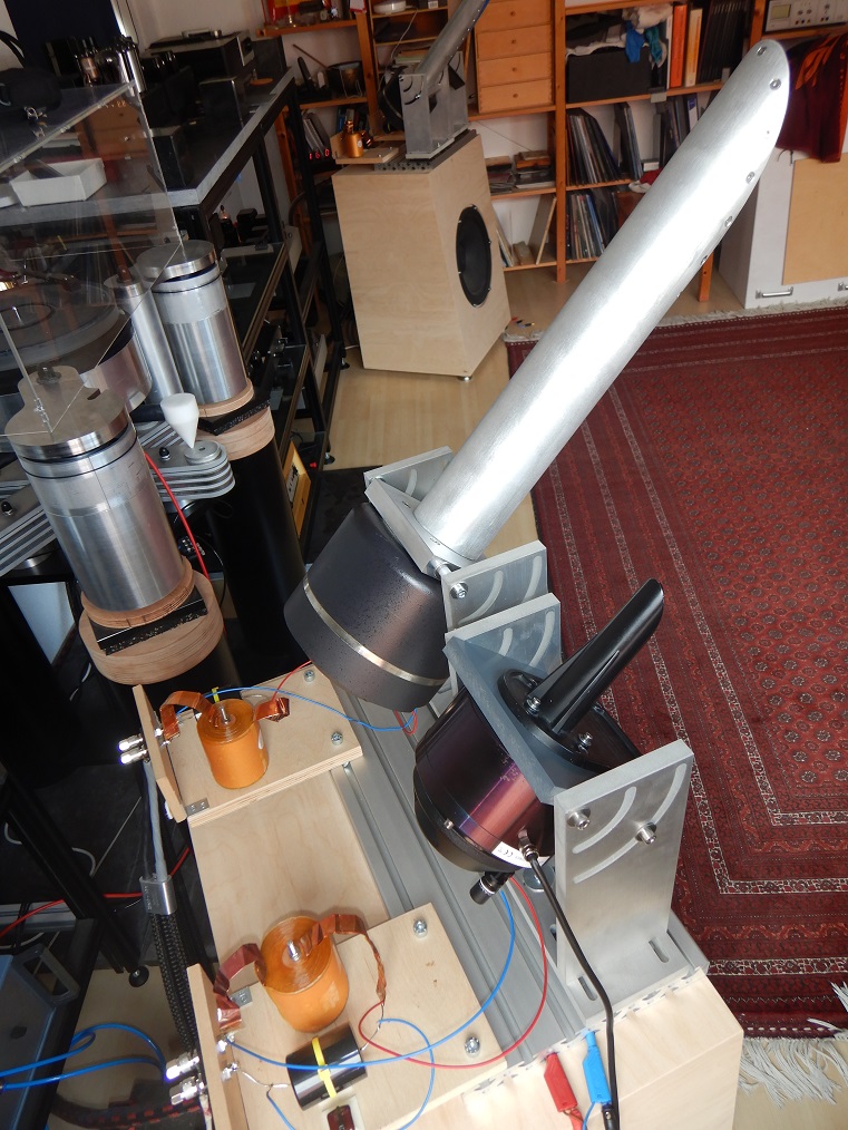

Good morning Freddi,
1. our drivers seem to be too heavy for a simple 3D-printed K-tube. Currently my 1" version is foxed on a base-plate whereas the 2" version has a full metal / threaded base plate. That last one oozes quality so that's the way forward for me. Also of note that plain 3D-printed K-tubes can resonate. I don't like that but i don't like the simple solutions (cladding the exterior with something) either. So our current K-tubes are made from 2 thermally bonded exact fitting tubes (outer one is metal; inner tube is a plastic). This works.
I'm trying with a CNC-solution to have the answer for both an integral metal base plate and the resonation. As soon as i have it ready i'll post the result.
2. Not too keen on those Russian caps you use. I tried a lot, and of course this is a matter of taste, but these will not in my filter. Other (Russian) caps will be ! At this moment i'm fine-tuning the XO's with bypass-caps. Some of them are OK, some of them certainly not.
Again: i'll post pictures when i'm done.
3. CNC is seriously expensive. First i'm going to do the classic K-tube before exploring double slot versions.
4. With a couple of active crossovers and my current stash of audio-components (oodles of funny caps here....) i've found out i like to crossover the lows actively. This saves the huge bass-coil. There are amazing coils out there (for another project i've used a Mundorf VN390 15 mH ....) but they took away the something of the speed/control of the bass. So active !
Mid/high can be crossed quite easily wth passive components. Again using the active XO's i've found out that my drivers and set-up responded nicely to a 2nd order 4K2-XO frequency. So a 3,3 uF cap and a 0,42 mH coil will do. I've got caps enough here but for the coils i tried different versions/types/manufacturors and found myself happy with the VLCU10's.
Main focus this time is a dedicated tweeter-amp; the CNC-stuff is requested but will take months.
Reinout

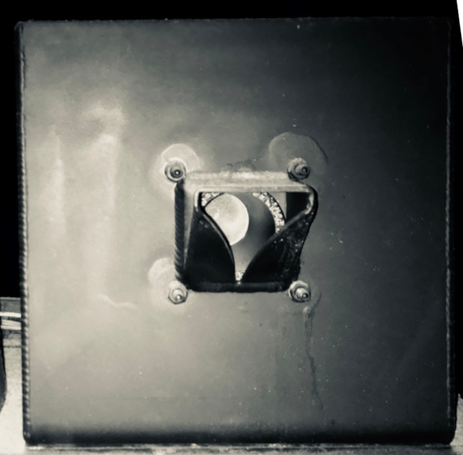

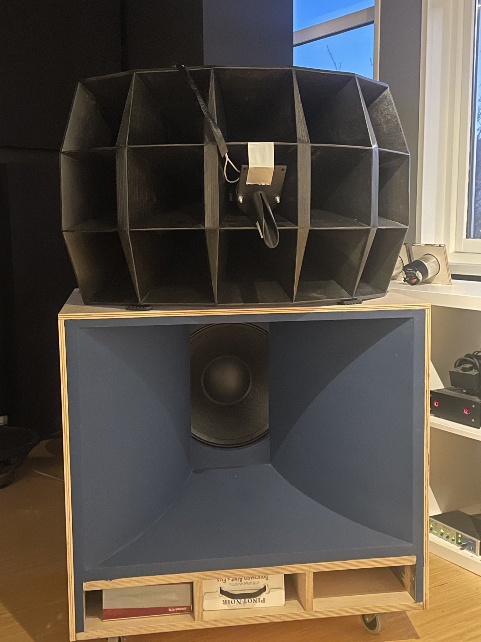

Reviving this old thread, hopefully someone is still interested in these strange waveguides! I have seen Freddis posts about them over the years, but never got around to trying. Recently I got a 3D printer, and suddenly it is very easy to make some tubes (thanks @pelanj !). I took some drivers I had lying around, Faital HF108, and duct taped the tubes into the centre cell of my Klug multicell horns. DSP crossover at 4K. It looks horrible, but sounds really good! The tubes blend better with the multicells better than other tweeters I have tried, probably because of the similar dispersion. Next week I will try the double slot version.
