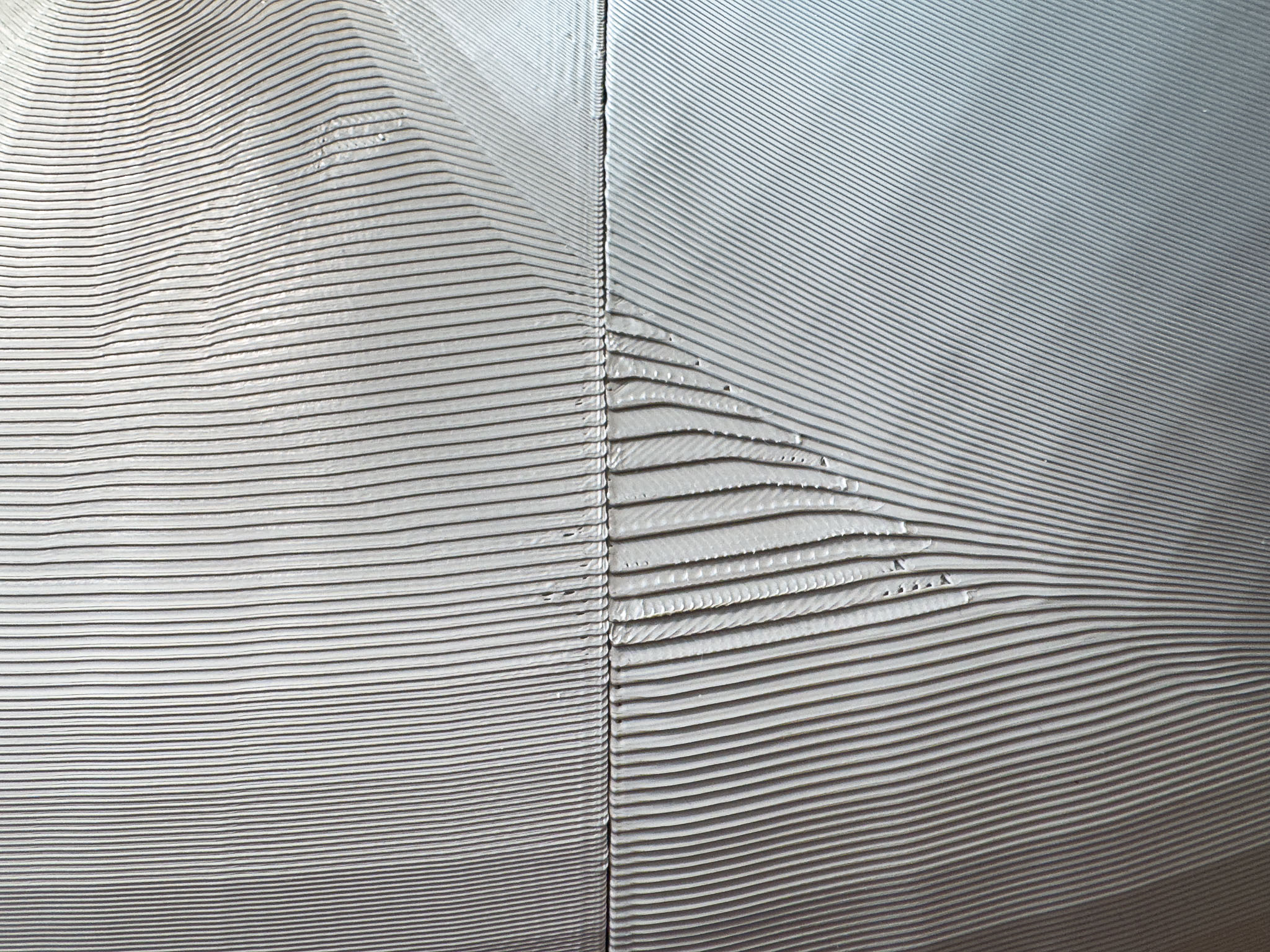

Currently I'm doing some evaluation about printer settings, layer height and printing speed for the best quality with the least rework as possible (well the latter will always be a dream in reality - but let me stay dreaming for now). The evaluation models are printing using nearly no and the simplest infill for saving time (10% grid). It's just about how smooth it can get. The first try was using 0,5mm layer height with a 0,8mm nozzle (taking 14h for the bigger part in the picture below).
Not satisfying - so currently I'm doing another print using 0,3mm layers with a 0,6mm nozzle and slower speed - the example above was printed with 120mm/s. I'm at 60mm/s now and it's looking a lot more promising by now - but not as perfect as such an expensive and time consuming project could be in the end.
So I decided to use 0,16mm layers with a 0,6mm nozzle for doing the calculations for "final manufacturing" with a much bigger wall strength (set to 17x0,6mm -> 10,2mm walls) and stronger solid bottom- and top layers (10mm). I also calculated with much more and multidimensional infill - 50% gyroid for the direct exposed parts and equivalent less dense for the outer and rear parts should be enough.

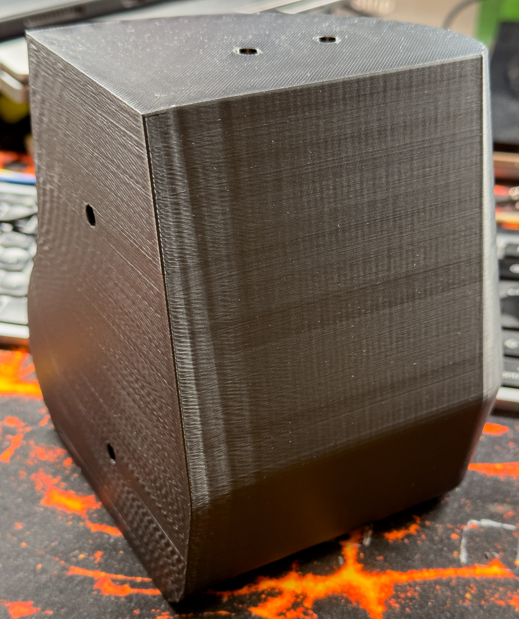

The prototype using 0,3mm layers with a 0,6mm nozzle and 60mm/s has been completed. Clearly visible that the fine steps forming the mouth are more refined than before using 0,5mm layers and 120mm/s speed. Currently I'm doing the first outer part (Part 1 on the graphic in post 1) using 0,16mm layers - the final setting for the most refinement.
Looking good so far. Note that this is with 15% gyroid infill as this is an outer part. The inner parts will get 50% infill - much more dense.

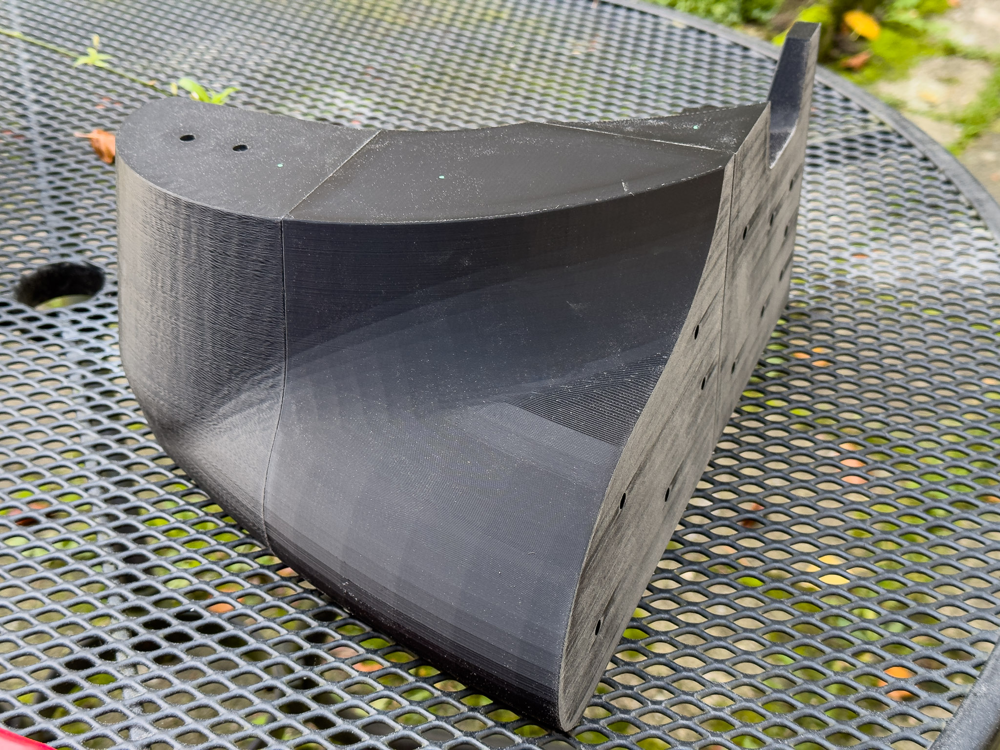

I printed the ES-450 and ES-600 on a Bambulabs X1C in PLA. My settings:
0.4mm nozzle, 0.24mm layer hight.
5% gyroid infill
2 wall loops (should've used 4, but 2 worked kinda). Only 2 wall loops leaves small holes/gaps in the print, which impedes internal coating.
To increase stability of each printed part and reduce the risk of resonances I "filled" the horn with casting resin (not 100% fill, only so much as the gryroid infill and all walls are coated with the resin). Makes the horn quite inert.
The later sanding and filling took ages though, and the horns are still miles away from the beauty of Crowe's CNC machined wood products. But cheaper, eh?

Thank you for sharing your experience! I think 0,4mm nozzles wouldn't be in advantage regarding quality here because the mouth is formed using the layer height. A smaller nozzle would only mean more printing time for the same wall strength compared with a 0,6mm nozzle.
I don't think it would be much cheaper in the end if you're calculating with energy costs and working time during preparation and post-processing. But I really like doing this things, switching off reality for some hours. Also I'm not the best woodworker of all times and with 3D printers I could enjoy this hobby nevertheless.

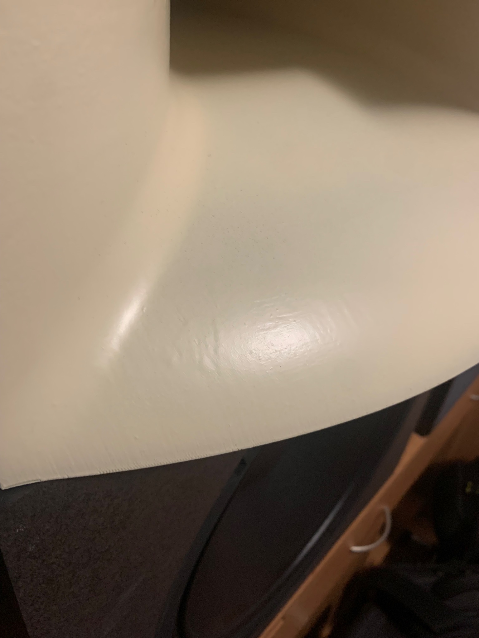

For filling, Revel Plasto is amazing, but expensive. So I normally use acrylic wood putty. There is a trick to make the surface nice and smooth - coat the surface with photoresin and harden it with an UV lamp. Then acrylic spray of your choice. Here are a few pictures of my 3D printed horn prototypes.
I used "CRAFT Resin 1:1", which is ment to be used for casting. Laminating Resin would normally be harder, not a 1:1 mix (in volume) and could get too hot for the PLA when hardening. Curing epoxy resin is an exothermal reaction, and I had a PLA print melt away when some laminating resin pooled up on the bottom and got hot during curing.What product you used as casting resin?

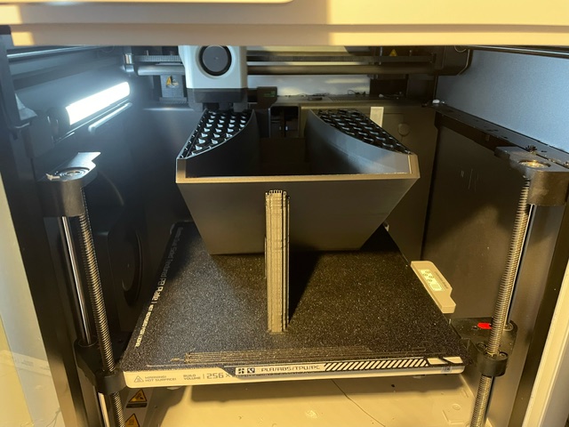

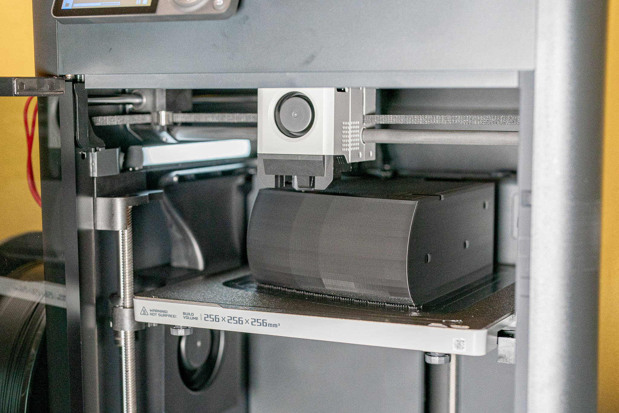

I've got a new toy yesterday: A Bambulab P1S. Closed Chamber non bed-shaker. I've done the first part out of it and it is doing the same quality than the M5C in half the time - with the 0,4mm stainless steel stock nozzle still in place. And no Z-wobbling anymore.
@Joseph Crowe also told me he would send the crossover plan for the DCX464 in the ES-290 to me tomorrow. So small but important steps forward.
Straight out of the printer after about 18 hours.

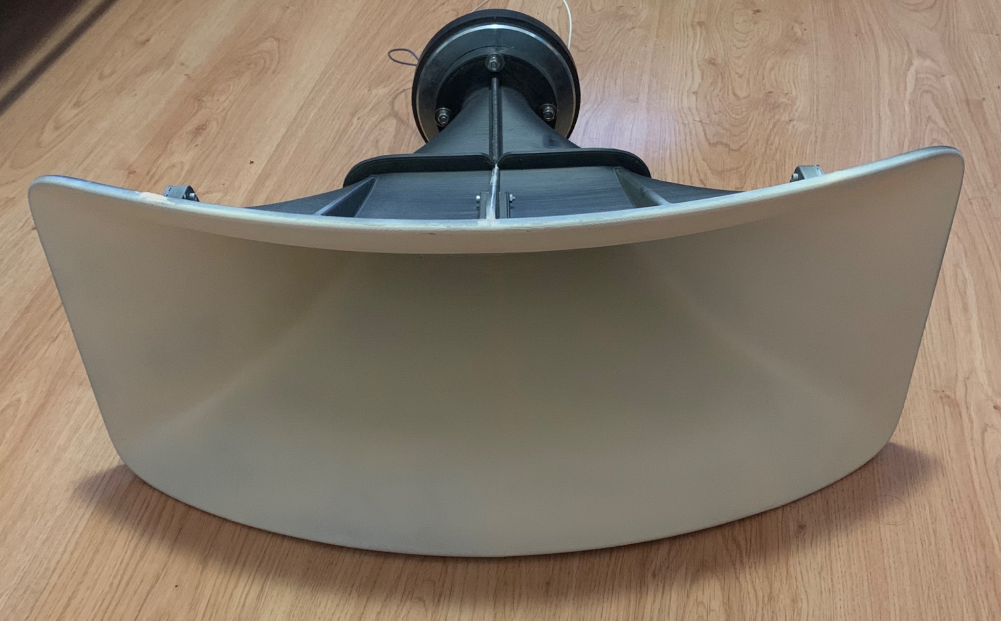

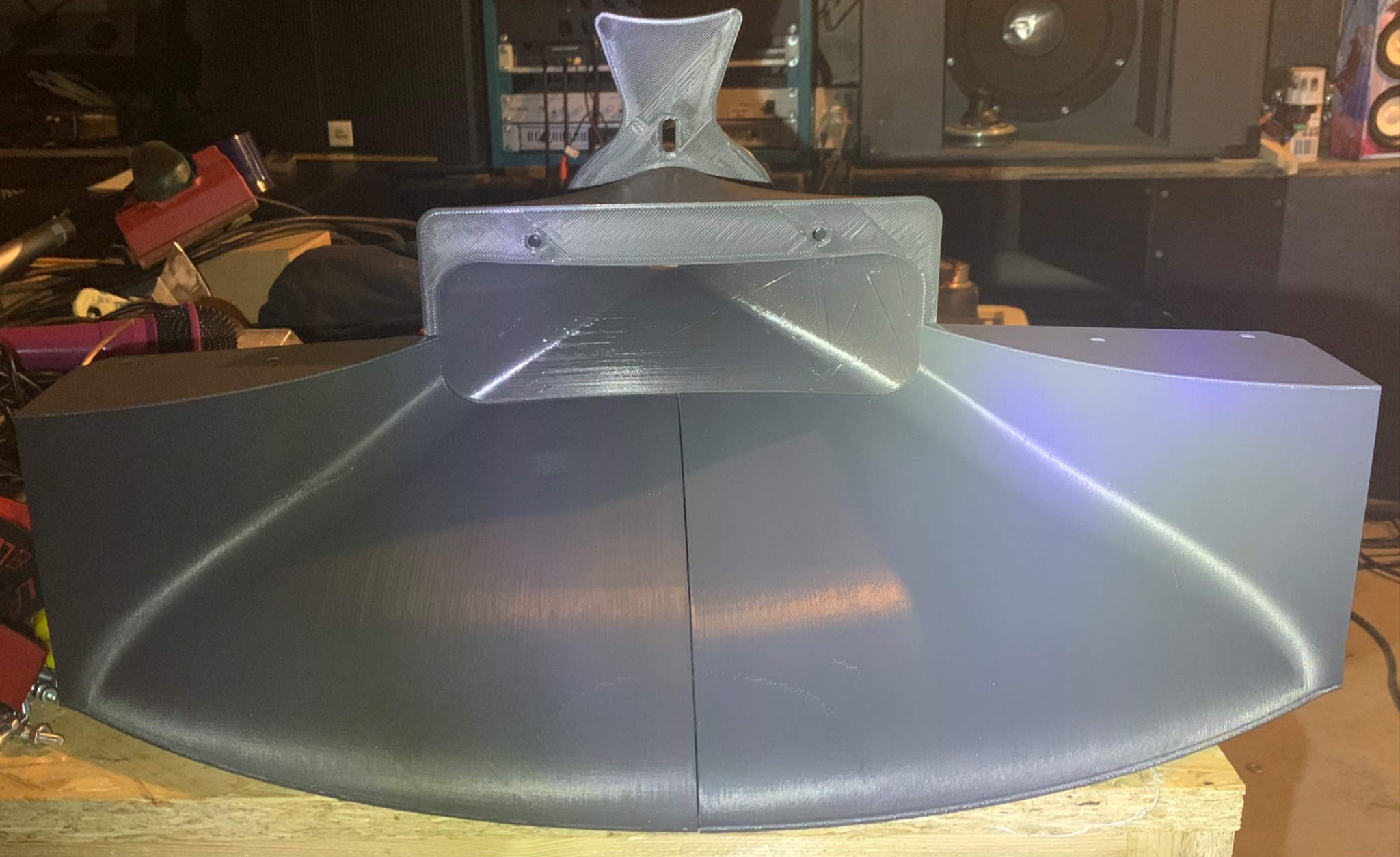

Hah, and meanwhile my print is the Yuichi A-290 horn in a downsized version (cutoff apparently at about 450 Hz).
The Yuichi has these fins (and hard edges), and they might cause diffraction effects, leading to a possibly "more spacious" sound.

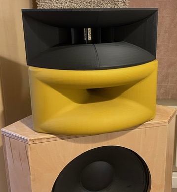

Similar size to the Crowe ES-600 horn (in yellow on photo below)

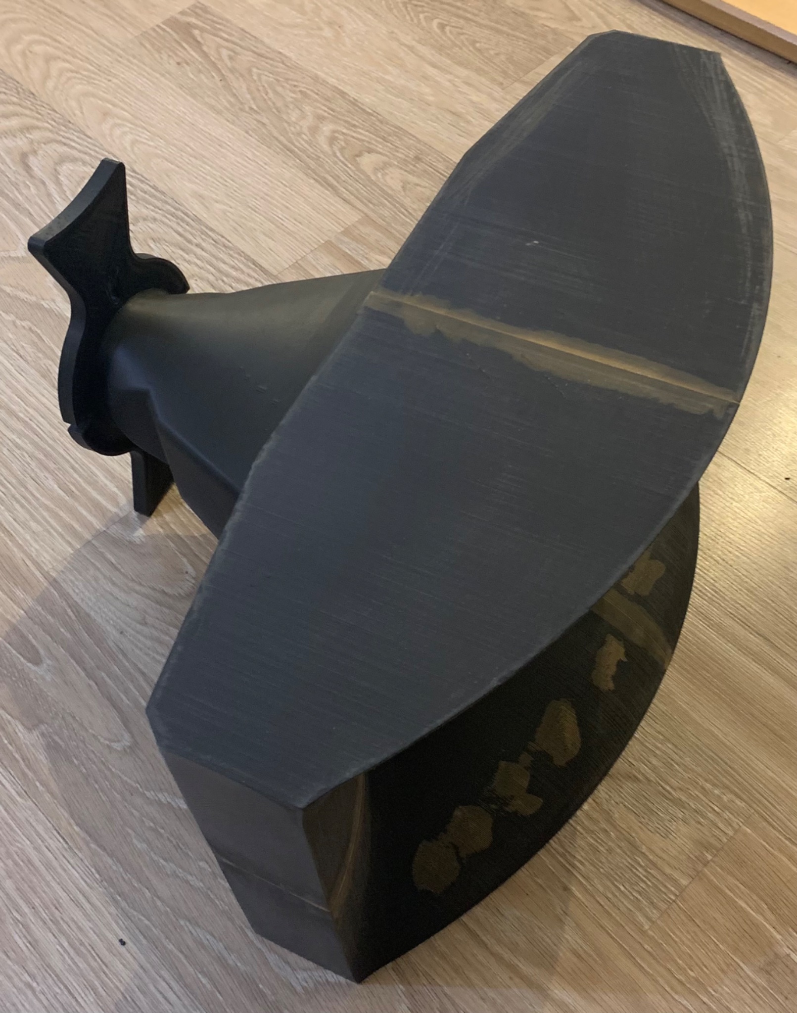

I've prepared the first three parts for glueing today.

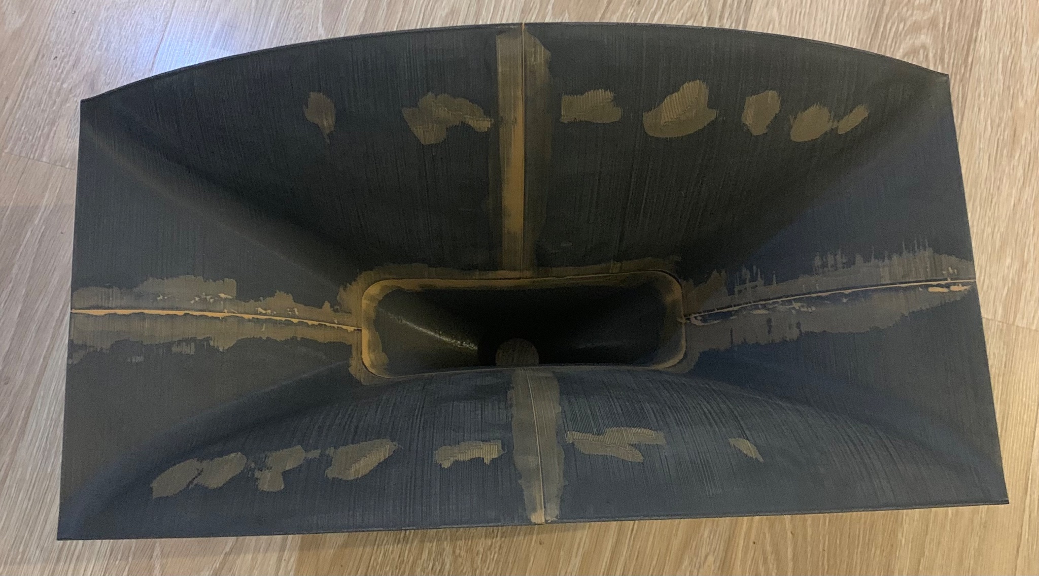

Top tip: glue upper and lower half seperately, finish (filler, sand, filler, sand, prime, sand, prime, sand, prime) the inside of these horn-halves and AFTER that glue top & bottom together. Sanding on the inside is much easier on half a horn than when it's complete.Great job - looking great!

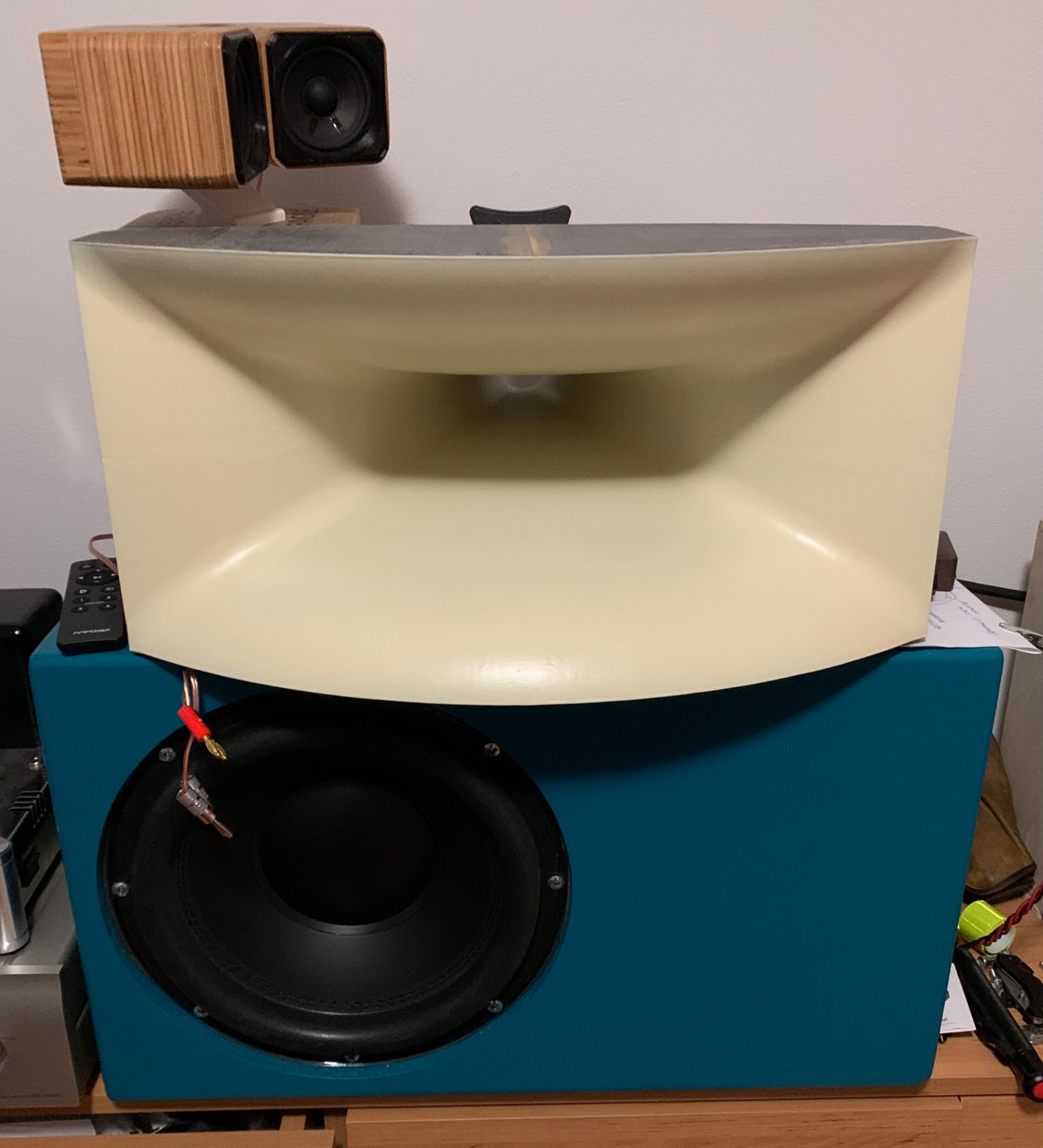

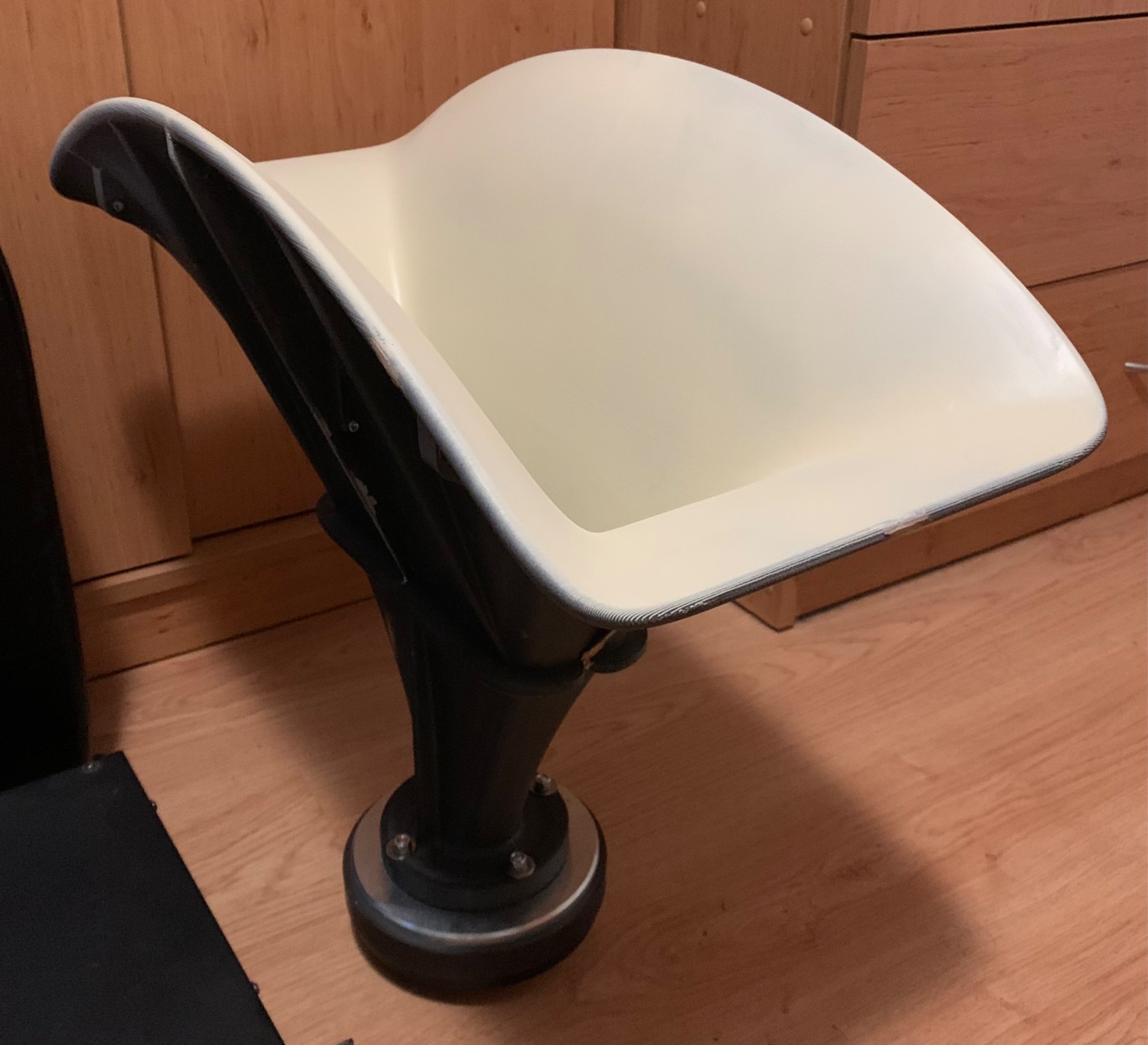

Thought I'd try out the big/original version of the Yuichi E-290. Modded the stl file from Joseph Crowe to make it look a bit less massive.
Glued together 9 parts, mounted the FaitalPro HF1460 (Textreme, 3.4"/86mm diaphragm) with the Joseph Crowe Throat Adapter No.2322. Used the Joseph Crowe rear cover No.2021 (printed in TPU95) as well.
Result -> So much more authoritative sound in the lower midrange. Love it! Yes, I'll stick with this horn.
Now just need to print another one and glue, sand, fill, prime and paint it.

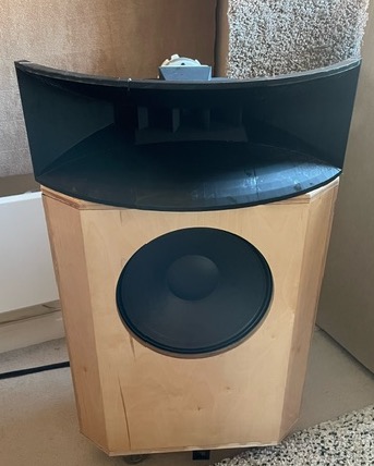

Is it the joseph crowe 1786 cabinet with a 15ob350? How this driver perform in a closed cabinet ?
