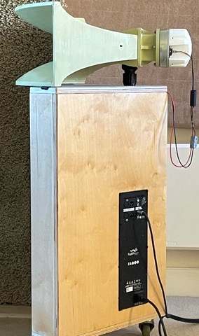

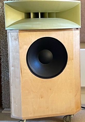

Update on the Yuichi A290 horn (with some mods).
- sanded and filled a bit (I focused on the part I'd see as a listener)
- filler colour came out with a green tinge - not the final paint colour for sure (should I go grey? or white?)

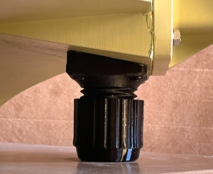

- added a modded "furniture height adjuster" from thingiverse. I printed the bottom part in TPU95A, because that's such a well damped material
- used gel pads on the bottom of the horn, resting on the wood of the bass cabinet
- with the FaitalPro HF1460 driver I didn't even need much EQ to get a fairly flat quasi-nonechoic response (will add measurements with different drivers later
- chose 500Hz XO frequency for the moment, 48dB/octave and 0.96ms delay on the woofer (32cm further in the front than the HF driver)
- quite happy with the sound so far. Integration with thw oofer is much easier with this lower XO frequency.

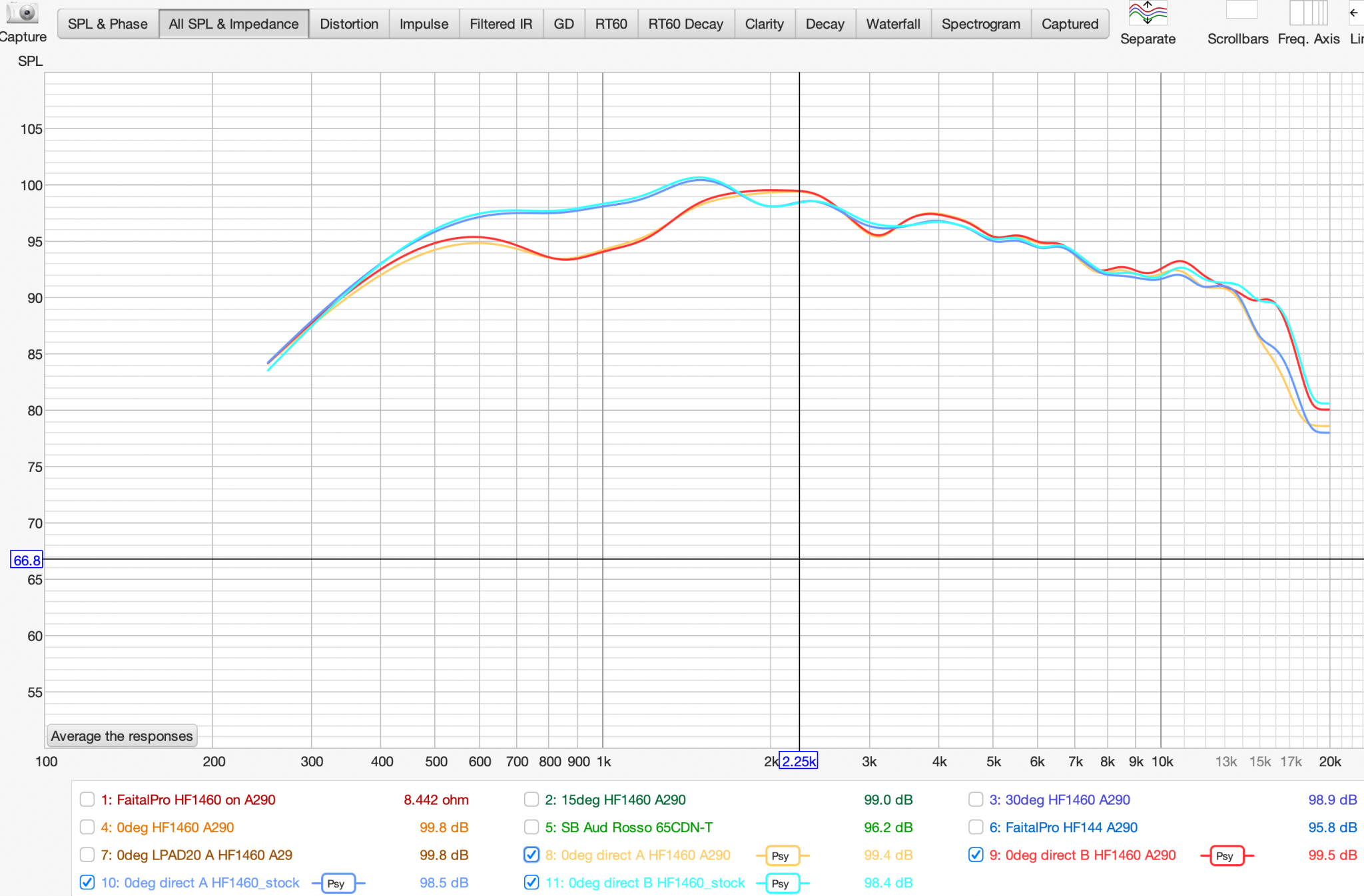

Here's some measurements on the HF1460 in the A290 horn. Quasi anechoic (gated, 4ms) measured via an -20dB LPAD, with ca. 0.6V RMS signal level at the voice coil.I'll post an update end of March (with some response curves etc.). Not at home at the moment, "workation" in lovely southern France.
Definitely wants some EQ if you run it full range from 500Hz - 20kHz. Falls off after 14kHz, which is fine with me / my ears.

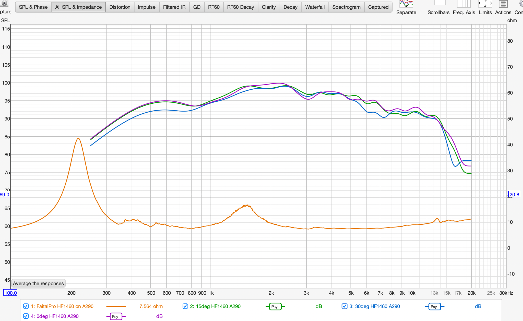

Also interesting that the level doesn't fall off that much when you go off-axis (measured here at 15 and 30 degrees)

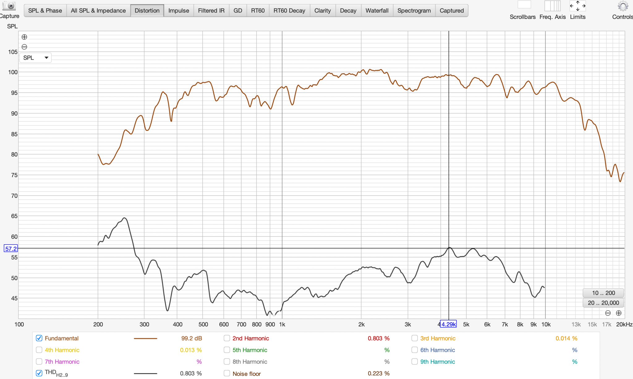

And here's the distortion (all below 1% at > 96dB sound pressure) from the on-axis measurement above.

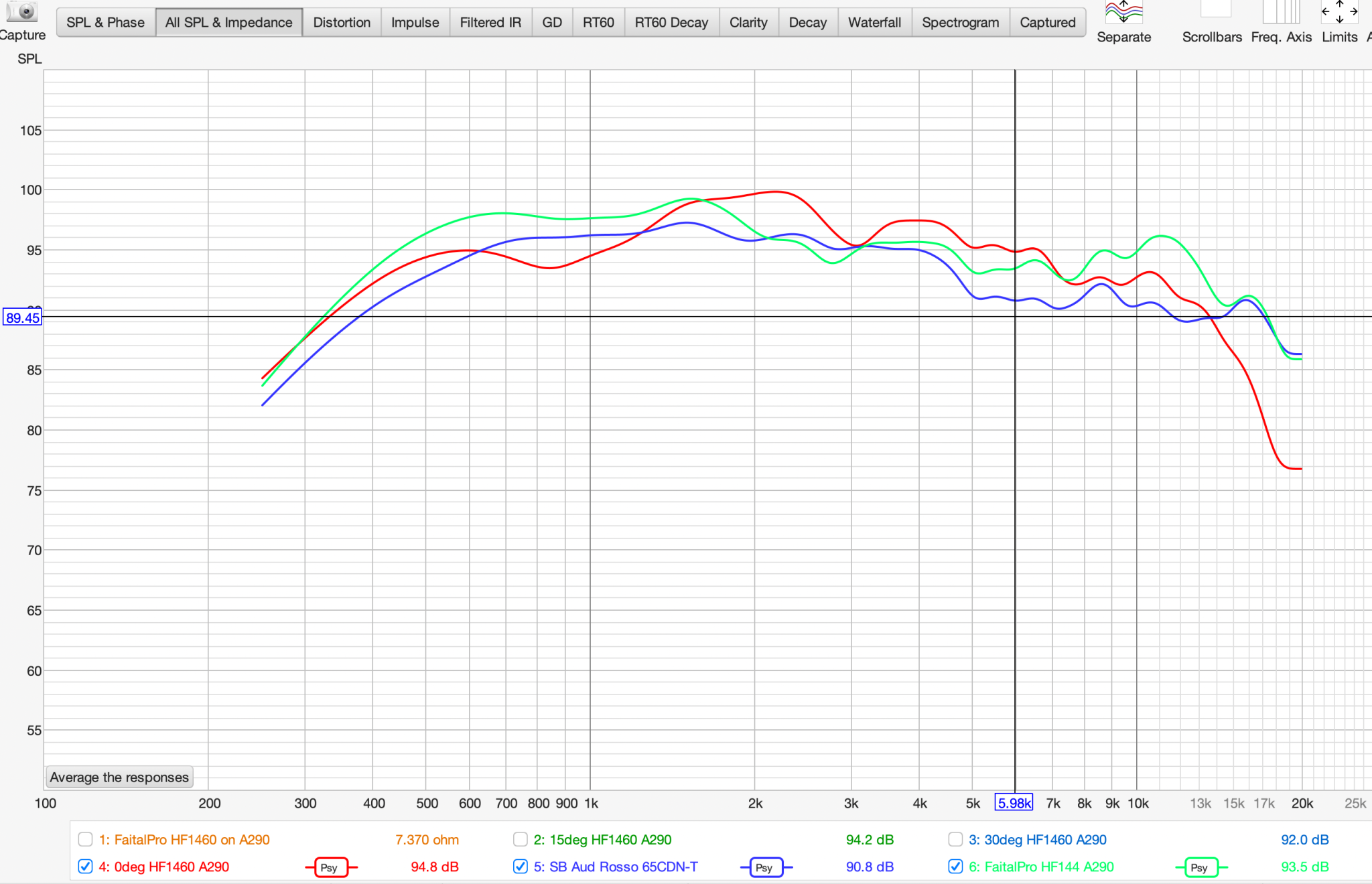

Another plot on the A290 with three 1.4" drivers, 4ms gated (quasi-anechoic), ca. 0.6V RMS signal level
The smaller drivers go easily to 17kHz, while the bigger dome of the HF1460 ends at about 14kHz.
- RED: FaitalPro HF1460 with Joseph Crowe back chamber (carbon fiber, 86mm/3.4" voice coil)
- BLUE: SB Audience Rosso 65CDN-T with Joseph Crowe back chamber (titanium, 65mm/2.5" voice coil)
- GREEN: FaitalPro HF144 in stock configuration (ketone polymer, 65mm/2.5" voice coil)
Nice looking horn print!Also interesting that the level doesn't fall off that much when you go off-axis (measured here at 15 and 30 degrees)
Interesting that the response below ~700 Hz is -2dB @30 degrees off axis, but above 7kHz within 1dB.
What is the mic distance from the horn mouth?
Is the axis of horn rotation at the throat, mouth, or some other point?

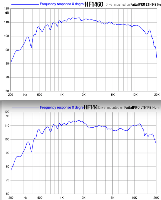

Interesting that your measurement of the little HF144 has +4dB at 800Hz over the HF1460 (with enlarged chamber), while Faital's measurements show both within 1dB on the LTH142 horn:

The response of your HF1460 also looks considerably more "lumpy" than Faital's measurements (almost twice the +/- deviation), while the HF144 mirrors theirs fairly closely.
Have you measured the HF1460 with the stock back chamber?
If you have another HF1460, have you compared the two drivers for consistancy?

Good point, Art. I first thought the LPAD and the impedance curve of the driver might cause irregularities, but it is in fact the Joseph Crowe rear cover. On this horn, it produces a suck-out in the 500...1500 Hz region. So, that's pretty much the 4dB difference that you saw.
All measured directly / without LPAD, UMIK-1 in 1m distance, gated at 4ms (quasi anechoic)
ORANGE: driver A, HF1460 @96dB, Joseph Crowe No.2021 rear cover
RED: driver B, HF1460 @96dB, Joseph Crowe No.2021 rear cover
CYAN: driver B, HF1460 @96dB, stock rear cover
BLUE: driver A, HF1460 @96dB, stock rear cover
Also, the freq extension of driver B is better than A. Not sure if I'll be able to hear that in real life.

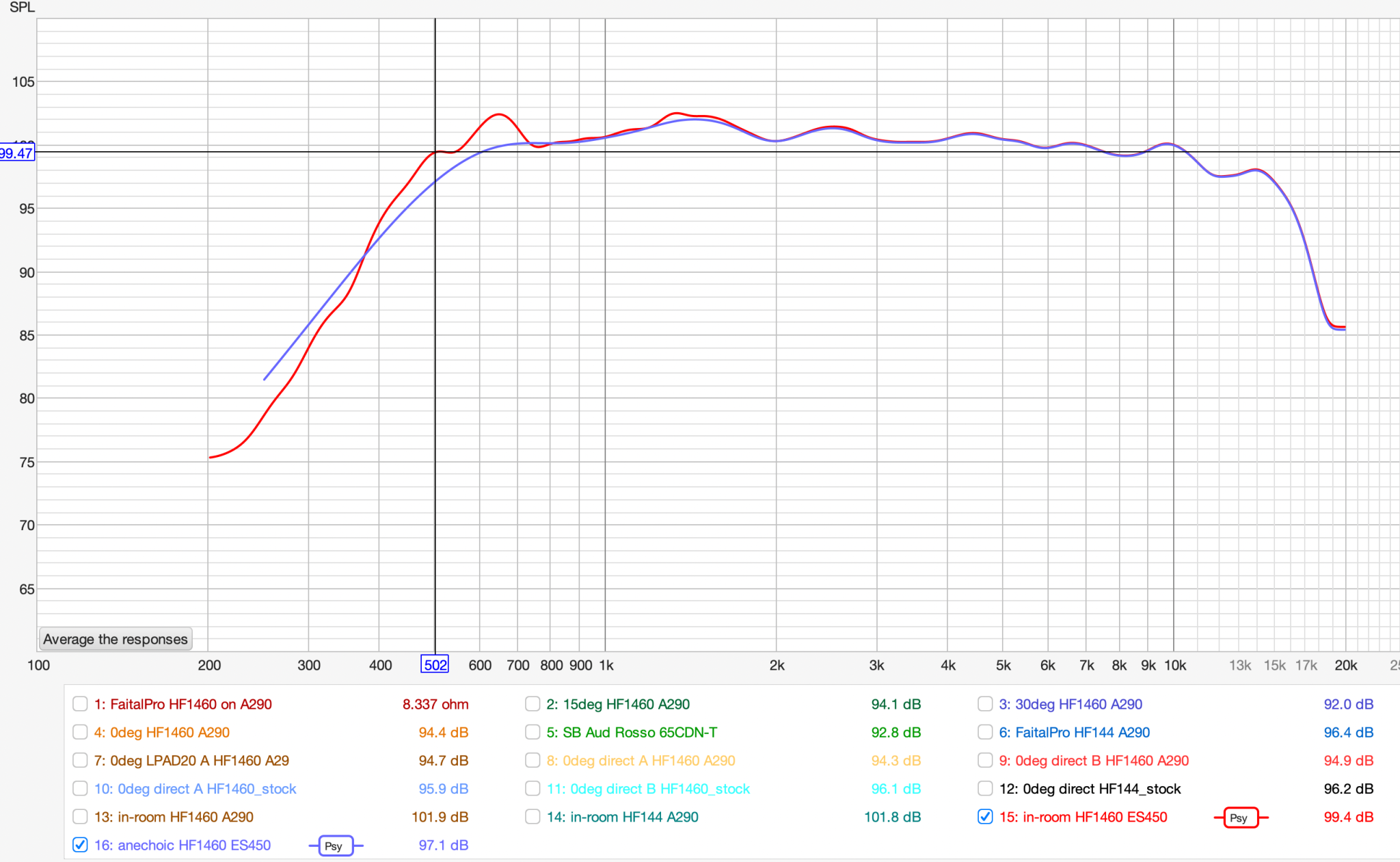

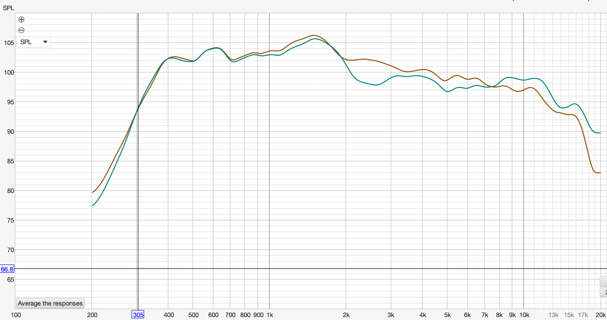

Another measurement, this time in-room and not gated. Below 400Hz the response of the A290 falls off the cliff.
That (frequency) falls in line with Joseph Crowe's measurements on the A290: https://josephcrowe.com/blogs/news/smooth-transition-throat-adapter-no-2322-for-yuichi-a290?_pos=2&_sid=2085a5871&_ss=r
Some of the lumps in the measurement can be room resonances.
BROWN:FaitalPro HF1460 on A290 horn, in-room, mic ca. 67cm away from the driver (i.e. close to horn)
GREEN: FaitalPro HF144 on A290 horn, in-room, mic ca. 67cm away from the driver (i.e. close to horn)

That was the horizontal axis. I measured on-axis, 15 and 30 degrees to the left of the horn center....

... and just for comparison with the A290, here is the HF1460 driver on-axis with the Joseph Crowe ES450 horn. Output falls off below ca. 500Hz compared to the 400Hz of the A290, and the frequency response on-axis is more even.
RED: HF1460 on ES450 in-room measurement, 67cm away from the driver, on-axis
BLUE: HF1460 on ES450 gated (4ms) measurement, 67cm away from the driver, on-axis
That more linear/horizontal FR comes with the consequence of narrower dispersion at higher frequencies.
