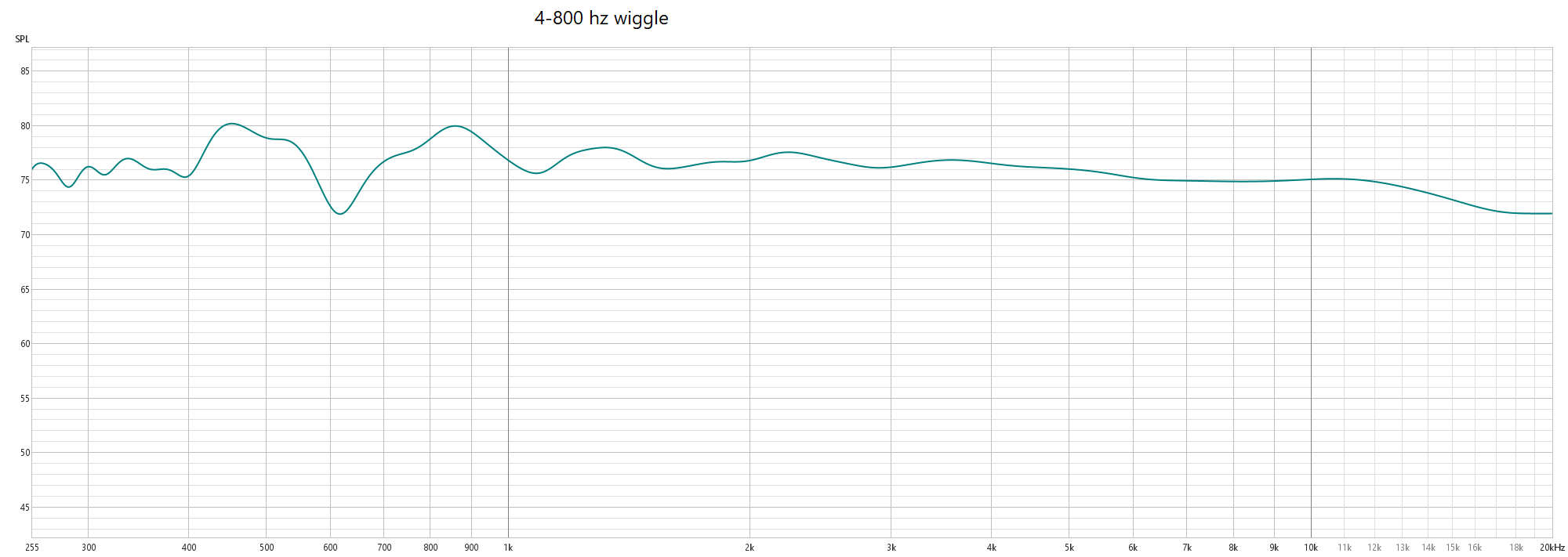

Playing around with mesaurements on my latest 3 way diy before i will do the last finetuning, and the wiggle bothers me.
Do you experienced people have some ideas about getting i better?
Mesaurement artifacts?
the mic is 120 cm away center midrange.
A SS 18M4631T00 doing 150-2,4 K in 4 liter box.
Regards John

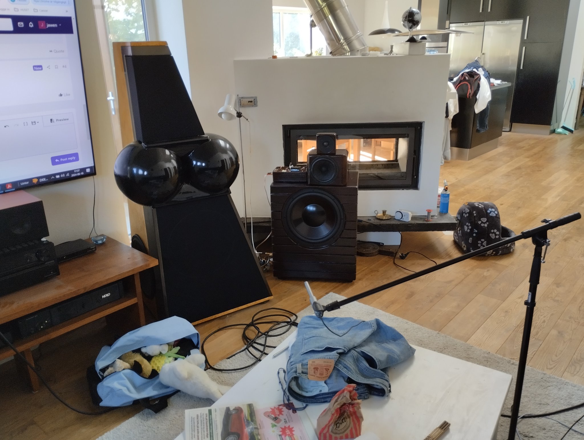

Can you measure outside? I see a lot of hard edges that will prevent a clean measurement. If you can't go outside at least move the DUT out into the middle of the room and and place it onto some kind of a stand to minimize the floor bounce. Also you need to gate it down to single milliseconds.
Get the gating right. And get the speakers outside, or anywhere you can apply a gate of 8 to 10ms before first reflection. Mostly by lifting speakers up in the air for about 2m measurement axis. Or measure using ground plane technique.Can you se this in my pic from Rew?
Reflection, diffraction due to box dimensions, floor bounce cancellation etc. Is the first thing to look for.
The 300hz+ midrange area is typical for such effects showing theyre ugly head.
You need to make a gated measurement as pointed out, that is so short you will not include any reflections or boundary effects.
Outside is the best as was pointed out.
Thank you all for helping me out
My stele operated neck and also my back is just to bad to move them at the time, im living with nervpain 24/7 but are a little better a few hours now and then.
I will try to move them more to "the middle of the room" when i can, and try with a gate of 8 to 10ms before first reflection.

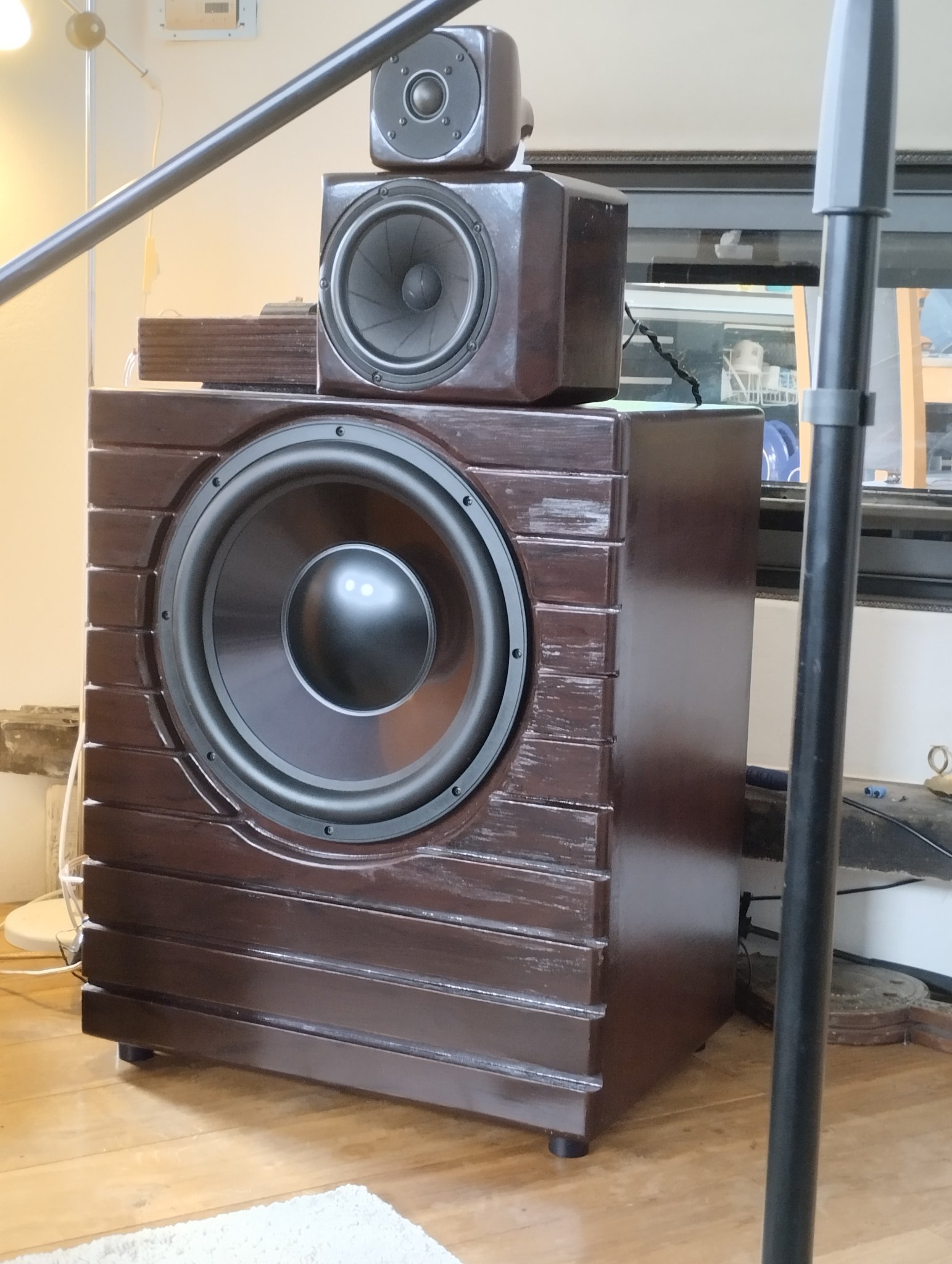

Small baffle mids are hard to get linear - ish response from. The little baffle area makes it more sensitive to other influences compared to a large, wide baffle. The diffraction and boundary cancelations are prominent, especially if the crossover is lower than the baffle area can support without significant baffle step compensation.
If the location you're measuring at is the final chosen placement of the speaker, then you should optimize the crossover for that location. Including all of its influencing conditions, so you end up with a speaker that.sounds better in that specific location. This may be a bigger compromise than is acceptable, making the solution more complicated and the desired FR much more placement dependant.
Gating the measurement definitely is suggested, but that will skew actual FR and won't include the physical placement's influences on the final FR, not fixing the response in the end. I'd redesign the mid enclosure with a larger baffle area unless you absolutely want a minimal baffle size and width. You can also play around with the mid placement in relation the LF section. I'd focus on finding the acoustic center first, aligning the drivers better which makes filter design easier and more predictable. You'll end up with a better performing speaker in the end. Using DSP would of course be the easier way but that brings another set of requirements with it.

No the speakers real placement will be 1 m to the left and pointing in another direction.
Trying to build a potent 3 way that doesn't cover half my windows in the living room, like my XXL JBL 250 clones do
But at the time my previous diy XXL JBL 250 clones stand in the way....and 155 kilo each.
Also the woofer was build for playing sidemounted (to get a slim visual impression 40 insteed of 60 cm wide)
Is both wide and high equally important for a midrange baffle?
Or is width more important then hight?

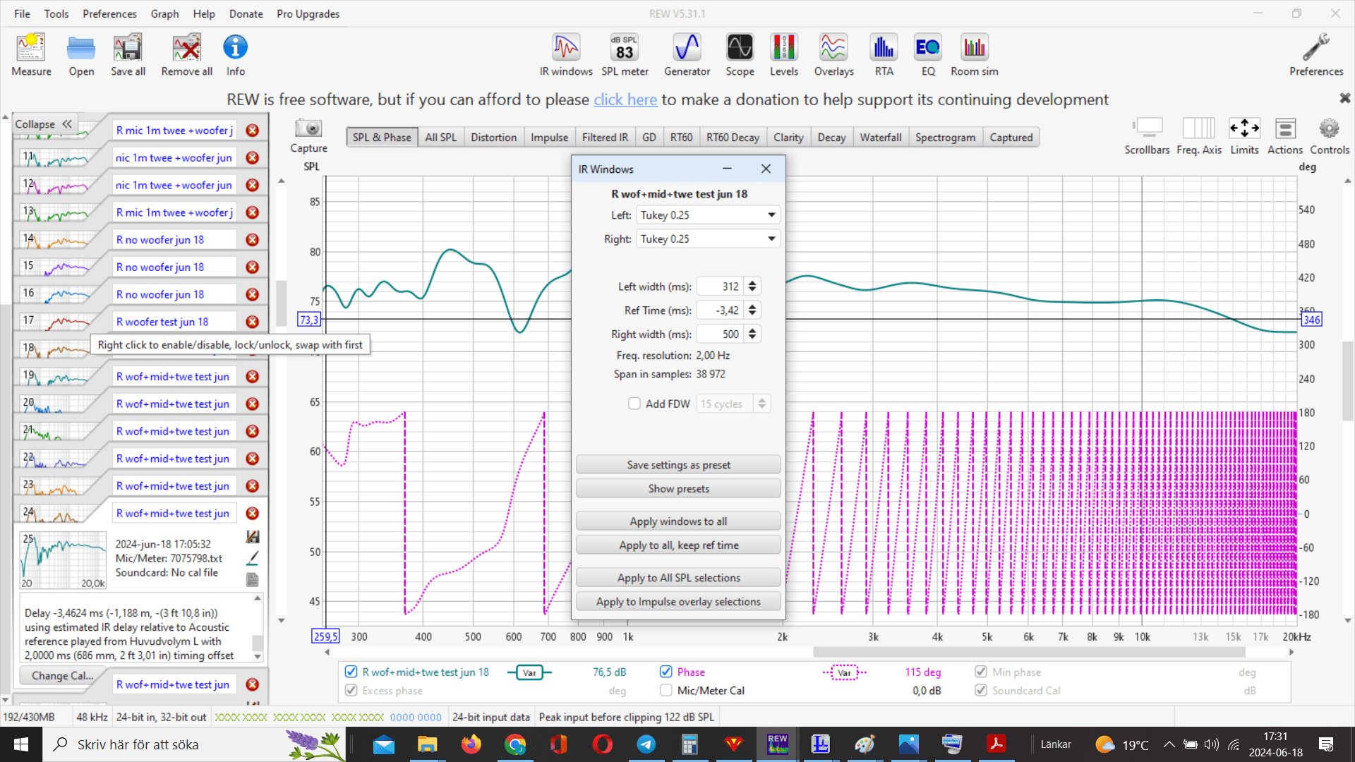

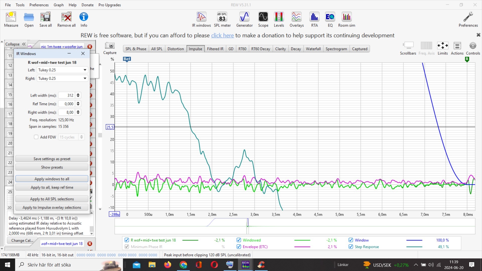

Trying to learn "IR window aka gate" settings in REW.
And haven´t done new mesaurements BUT have change the same mesaurements IR wIndows in REW. ( had bad days)
Settings now is Left window 312 ms, Ref time is 0 and Right window is 8 ms.
Impulse look like this after "new" IR window settings in REW
Does it show "things" right when i change "old" mesaurements IR windows afterwards?, or must it be changed before the mesaurements?
