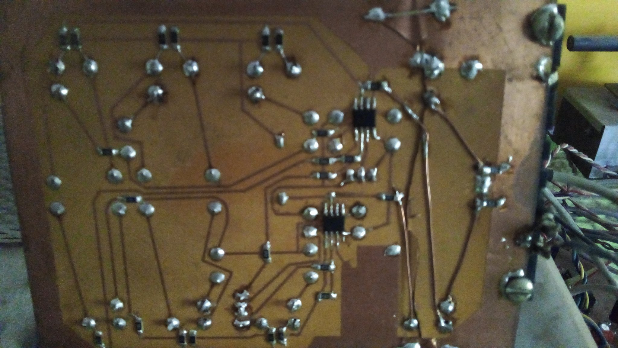

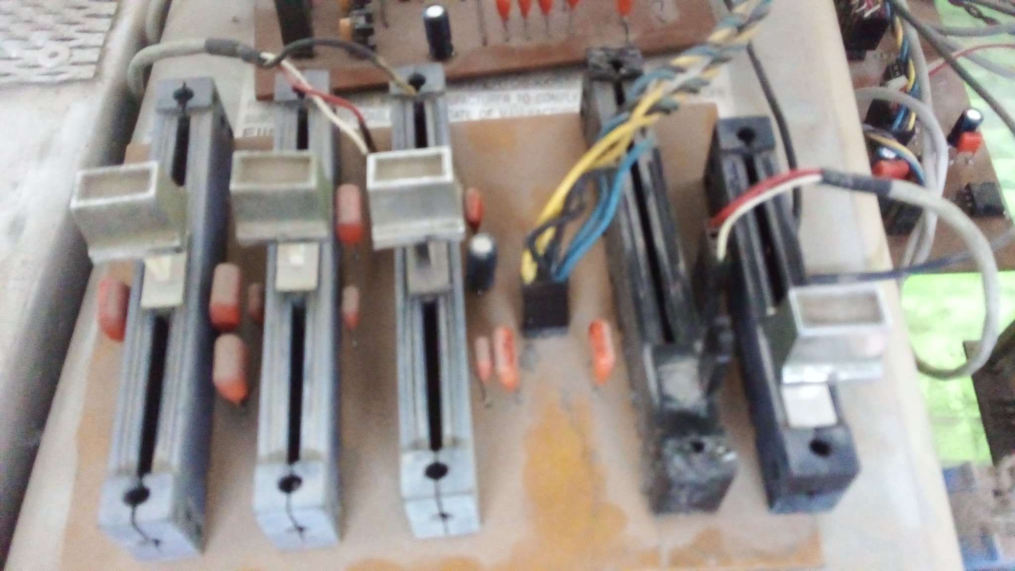

@Osvaldo de Banfield: I was using a Baxendall, which I finally got to work fairly well by using the unused back half of the Treble pot to influence the Mid-range. But the need now is to divide the Mid-range in half for better control. Rod Elliot's Project 84 will work except that it has to be split in two, in addition to component value substitution. I was also considering expanding the traditional Baxendall, also but will require extensive modification to the boards available.
Yeah. I have my own 3 band Bax and works fine. The board has about 15 years and has broken repairing the pots. "Industria Argentina" (made in argentina) a thrash.
