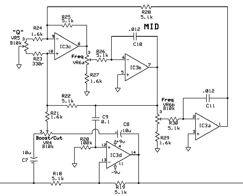

@dotneck335: After actually reading the project article, it was found to have a buffer for lower value resistors hence less noise (which I require), so if split, another buffer would need to be added--no way. Two boards it is. 4-Band is enough for guitar, I think. Essentially, it's to divide the Mid-range for more control.
I modded a Baxendall with a dual-gang so that when the Treble was turned up along with some Mids, the upper range of the Mids were boosted more, and sloped almost linearly down towards the Bass end using Db scale. I also wanted a Treble Booster so I built one but the noise was too loud and unwieldy, however it was a real quick build. With the extra bands of the P84 board, there should be a way to switch on/off a Treble band. Better there than before the preamp--too noisy.

The ESP Project 84 mitigates that shortcoming substantially. According to the ESP article, it's only at the ends of the potentiometer range where it becomes a problem. Also read ESP Project 150A parametric eq that I have from an old popular electronics article by john Roberts is two band, it has a “q” or bandwidth control which sets it apart from the design you posted

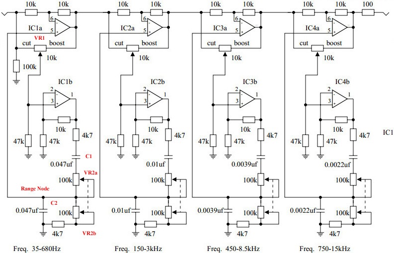

Rod Elliot said that none of his projects will work for 4-Band parametric. The ranges are too narrow to use only 4 bands. So it's either adding a fourth band to the Baxendall, or using something similar to the Boss Metalzone EQ. The Metalzone EQ is elaborate but works good. The concentric pots are confusing, difficult to adjust, and the labeling adds to the confusion. I think 4 traditional front panel pots are the way to go either way: Bass, Low-Mid, Upper-Mid, Treble.
Hello, Understanding the specific behavior of the "Range Node" component and the phasing of the dual potentiometer connections in the 4-Band ParaEQ circuit would require a detailed analysis of the circuit's schematic and signal flow. It's recommended to consult the circuit's documentation or seek guidance from experts familiar with that particular circuit design.Freezing cold here in the Northeast USA has got me holed up in the apartment, so this seems a good time to apprehend the unique circuit found here.
Want more control over the mid-range for guitar. Found a different 4-Band ParaEQ PCB out in Europe but no answer to email, so no money will be sent.
Having trouble apprehending the action around what I have named, "Range Node", specifically, the phasing of the dual pot connections, i.e., the direction of the wipers and their effect. I assume it moves the range around somewhat.
Here is what I have figured out so far: when the wiper of VR2a moves downward, adding series resistance to C1, there will be less low end boost due to the higher XC, thus effectively moving the band higher. In the case of VR2b, it seems to me a conundrum whichever way that wiper goes in relation to the other. I have spent hours trying to understand what would be going on either way, with the exception that C1 and C2 will be in series, regardless of wiper direction.
Another question is there are no input caps on each opamp. A main incoming cap is elementary, but what about the rest of them? Adding them will produce a phase shift at each band stage around 90 deg. from the preceding. I wonder what that will do the to tonal qualities. Might try that after the ranges are adjusted to suit guitar, clean channel and heavily distorted channel. At that point, the dual pots will be replaced with fixed resistors.
Well, I could build it, and if it doesn't work, the pot leads could be reversed until it does (if it does), but that is really "bush league". This is akin to the difference between an automotive technician and a "parts changer".
Any comment appreciated.
I wound up using 4 of these in series. Phase shift from the caps and the inherent distortion of the design seem to have no adverse affect on my subjective sound using a guitar. In one of Rod Elliot's articles, he shows what happens to the signal when going through these kind of circuits. In determining the Q and Freq settings, I ran a 16 tone test signal with the spectrum analyzer of my scope. The dials were twisted until I verfied the Freq ranges and the desired overlap (Q) into each of the others. The Freq and Q pot wires were disconnected to read the resistance values, because those pots will not be used in the design; the Boost/Cut will be adjustable so the amp will just have Bass, Lower-Mid, Upper-Mid, and Treble controls like the traditional tone stack except for the split Mid. In the schematic, the Freq pot parallel numbering is correct. Boosting Upper-Mid and Treble produces considerable noise so a noise gate is required for those who hate noise, which is everyone I think.
