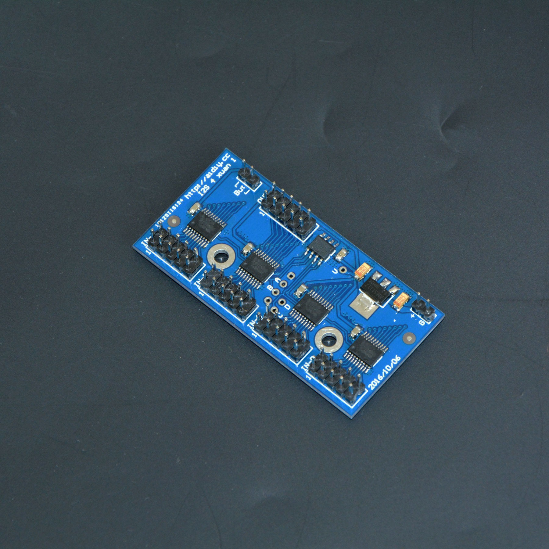

I searched and couldn't find a thread on these boards, now common on Aliexpress and eBay and I'm sure plenty of others. Audiophonics has a slightly different version (I think it is a previous revision of the same board but with a different pin out).
Anyway, the principle of operation is that it runs off 5V, uses a microcontroller to switch from one input to another. The lines are switched through 4x 74HC573 D type latches, and each of these is turned on or off via a (momentary, NO) repeated button press via an STC15W101 controller. Upto 8 lines can be switched per input (10 pins) with 2 ground pins. There are different levels on information out there available on these - the Aliexpress info tends to be short, but some ads on eBay contain a bit more info.
I've managed to let the magic smoke out of two of these now, so I can say they aren't super robust, but outside of that do certainly work. On the first one that I killed, I had grounded some of D1-D8, and you'll see in the quoted text below that this is not recommended. In the second case, I believe that I hit a short and some current flowed through the ground. The end effect is that one input stops working in such cases - in essence it becomes a 3 input switch. What I don't know at this point is whether the microcontroller has been killed, or one of the latches. - I will try to figure that out when I get some new parts here.
The text from eBay is quoted here, and you'll see there is reference to the two pinouts.
I've posted this here for comments and any obs anyone might have. I think if there is a way to make this unit more robust, it might be worth it.

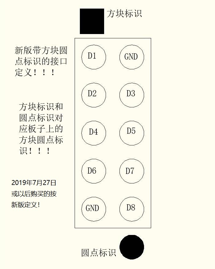

The interface definition of the new version was updated on July 27, 2019. For users who purchased before, please check the definition of the old version!
The definition of the input and output interface is as follows (note that the new version and the old version are distinguished, the new version of the board has a square and dot identifier, the old version is marked with the number 1 next to the interface): the input and output interface definitions are the same but the signal direction is different -C IN-D direction is input, OUT direction is output!
It should be noted that when one of the signal lines such as D1 is used as a DATA data line, then D1 of all input and output interfaces must be used as DATA; D2-D8 is the same reason.
Note: The GND of each board can only be connected to GND. D1-D8 cannot be used as GND! D1-D8 can only be connected to signals and cannot be connected to the front and rear boards instead of GND! !! !! When connecting to the GND of the front and rear boards, you can only use the GND pin! !! !! !! !!

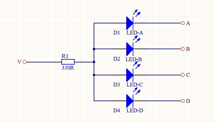

A B C D V 5 single-character interfaces on the board are used for LED display (new V character is changed to 3.3V)!
I made another little discovery on these switches - they can be set to switch between 2, 3 or 4 inputs. To do this, close the "but" selector button at power on - doing this repeatedly will cycle through the modes. This had me really puzzled for a while!!
This is why I thought I had damaged the first one (let the magic smoke out comment above) - it turns out I didn't damage it I think, I just had the contacts closed at power up and therefore on power up it went to 3 inputs and so on.
OK, so given that they seem reliable now that I figured that out, it seems that it is not worthwhile trying to reinvent the wheel, especially when these are <10e each.
Small input series resistors would improve ruggedness somewhat, as would back-to-back Schottkys to each rail. The small performance penalty may, or may not, be worth it to the user -- YMMV.
Sounds like the 'But' interface could use some 'range / current limiting', too.
