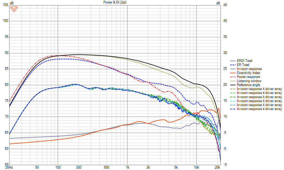

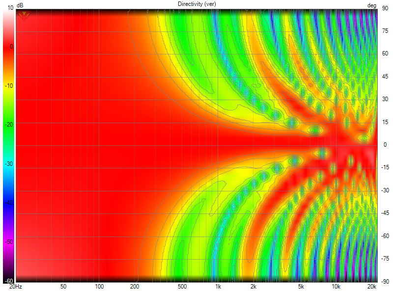

I think, judging from earlier posts Norman made, he likes bass but also likes the (single) full range speaker. I guess this would be a way to get more bass out of it (increased power handling) while retaining some of the single speaker qualities (like it's phase behavior).
However, personally I'd find what I suggested here a bit too limited as well. It actually holds up pretty good if one moves up or down, better that the graphs here depict with the nulls in the polar map. In reality they move (up and down in frequency) with changing the height but don't create a null until we are quite a bit higher (*).
Here's an overlay of -100 up to +100 around the average 1m listening height (in steps of 25mm):
attachment.php
(floor and ceiling reflections are -20dB down in this and earlier graphs)
Pretty excellent behavior for an array with this center to center spacing.
The horizontal window will be determined by the (single) driver's off axis behavior, vertically it could use some EQ as this sim didn't use a real driver on a real baffle but more of an idealized flat measuring driver. But if one is willing to do that, there is some potential here ;). It will suffer way less from floor and ceiling reflections than a single driver speaker and it will have quite a bit more power handling too on the bottom end.
(*) an example at 100mm below the assumed listening axis of 1 m:
attachment.php
See how the nulls have moved, but the output is still within the range of the previous graph.

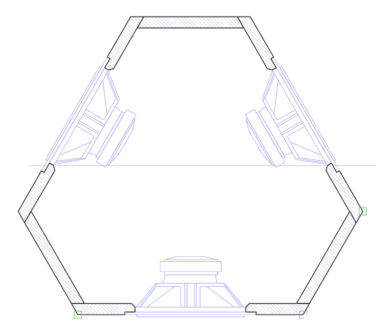

Itis a featureof things like the microTowers (both bipoles and castle) use drivers firing in different directions which makes them more omnidirectionl and room-filling.
No issues withcombing and can be used for BSC.
Scott, Chris, and i have done a number of such configurations, as with everything, one has to keep in mind the compromises.
1 on front, 1 on back, 1 onfront one on top, 2 on the front, 1 on either side. 4, 1 driver each side. 3 drivers, one forward, 2 on back (at an angle, imagine a trianglular, pentagonal, or hexagonal prism as the box).
attachment.php
dave

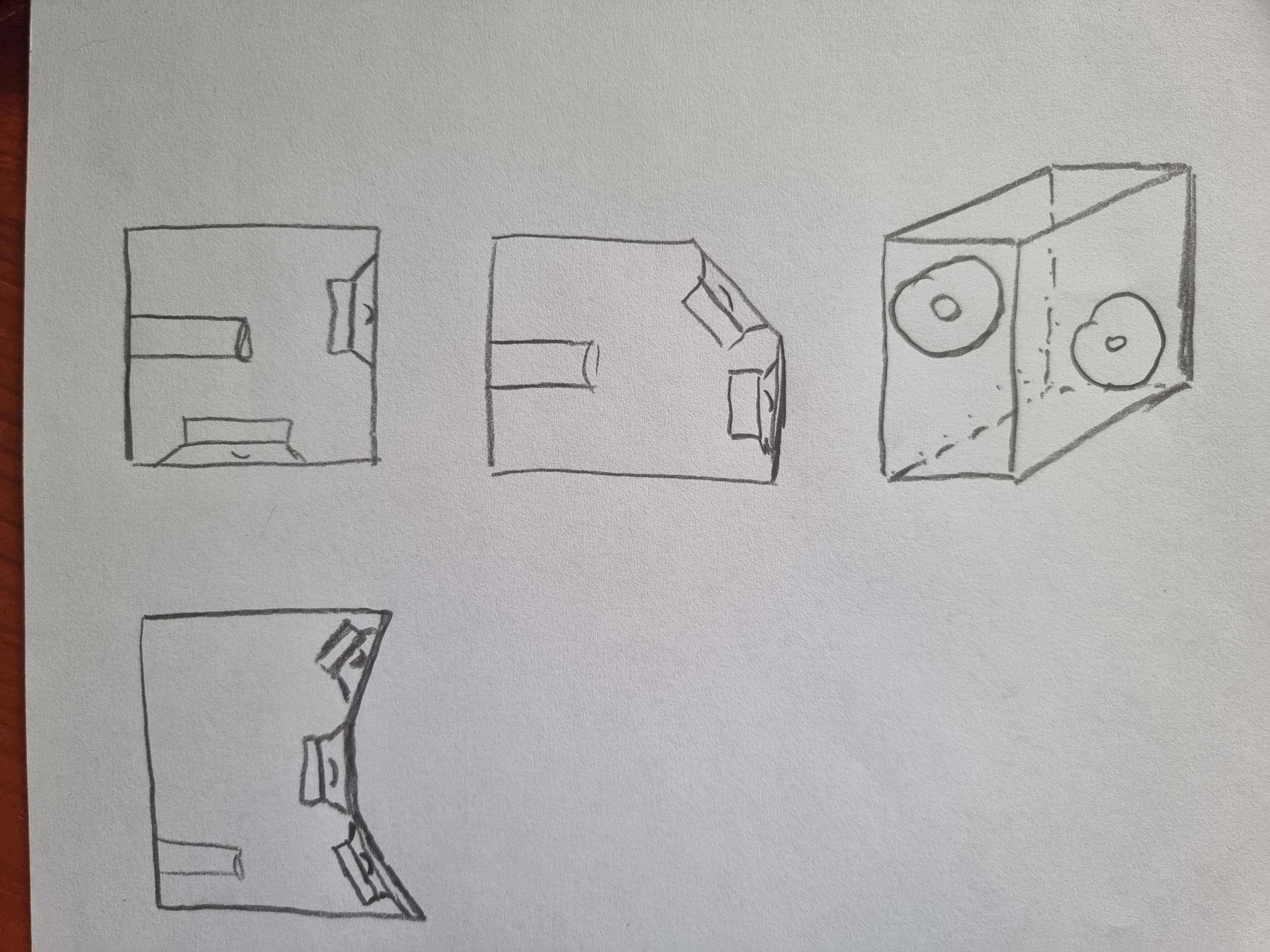

I belive biamping could solve some of the problems .I'm not done with this ideas.I still want to try 4 Alpair in a box .I haven't yet had the time or took a decision about the final arrangement of the drivers ,I hope in the and of the march this year I will come back with feedback ;)
