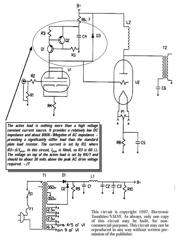

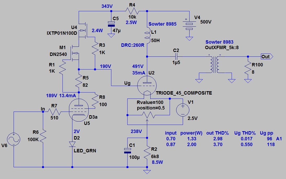

If you look at the curves I posted above, the 03N100D will set the VDS of the below FET at double the voltage compared the DN2540. That’s it about 3V versus 1.5V for 30mA drain current. Now, if you go to the DN2540 and check the model capacitances versus VDS (Crss in particular), you will notice they decrease at higher VDS. Ideally +25V, but you can’t achieve that unless you add some battery bias (you can if you want) on the top device.
I tried a comparison between the battery bias and a IXT01N100D, and frankly found just a small improvement in HF. With the 01N100D you can do well above 1Mhz BW, which is much more than you need already.

Jut wanted to go ahead and order some parts. I can't find anything called "03N100D" or "IXTP03N100D". Mouser has IXTP3N100P or IXTP3N100D2. Which one is it?

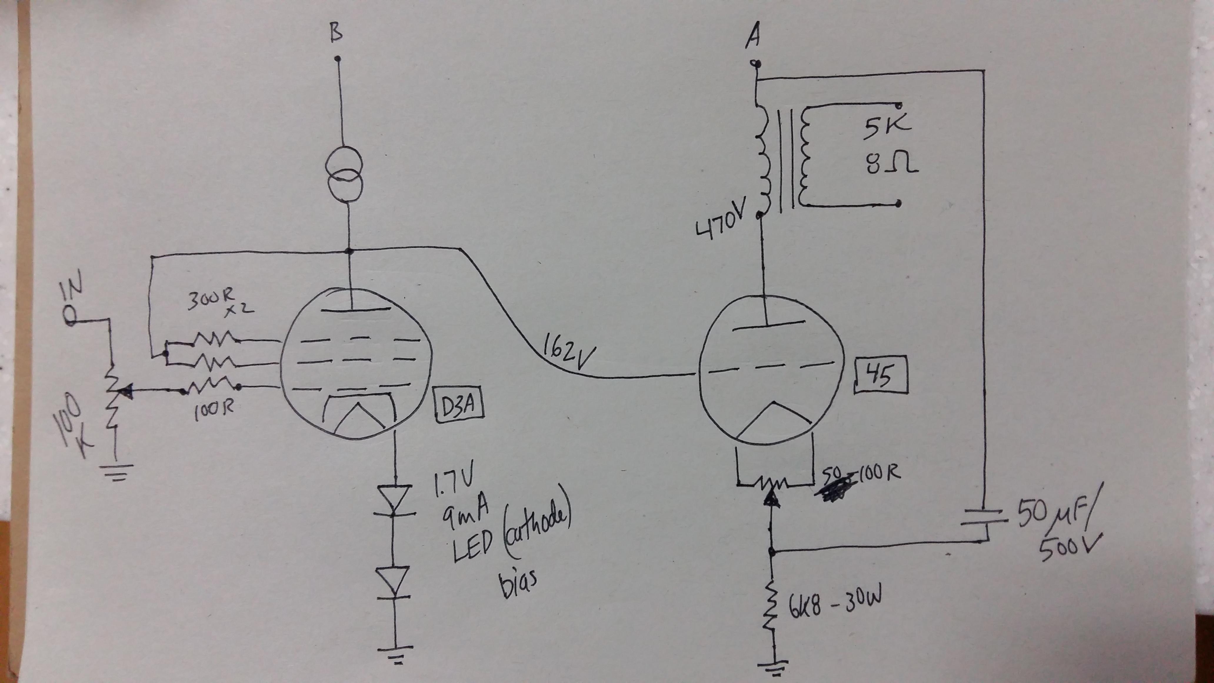

Find this directly coupled " Lafon " 45 amplifier

Nice! Can you scan the full article? Yes, I do understand some french if I really have to

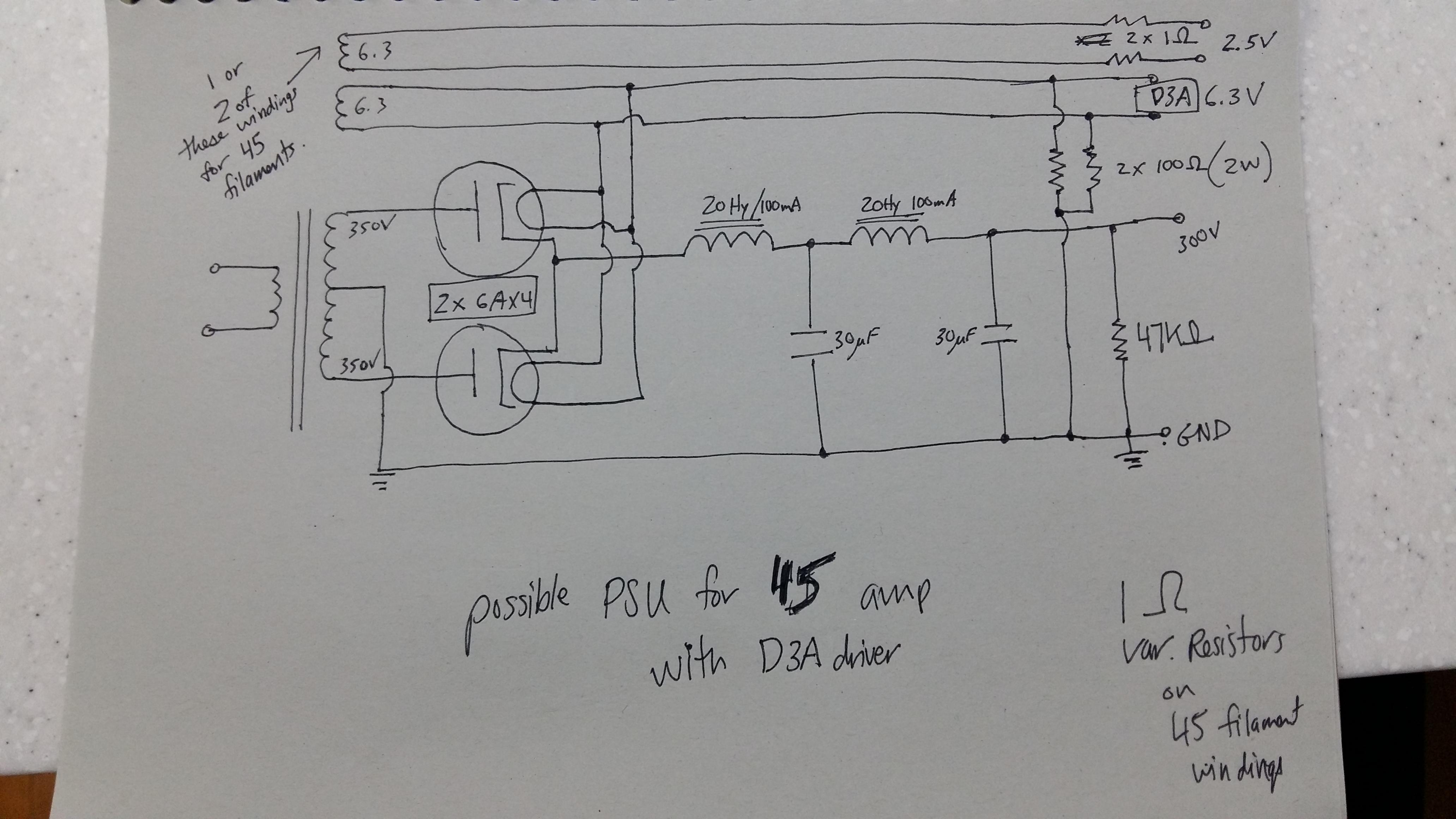

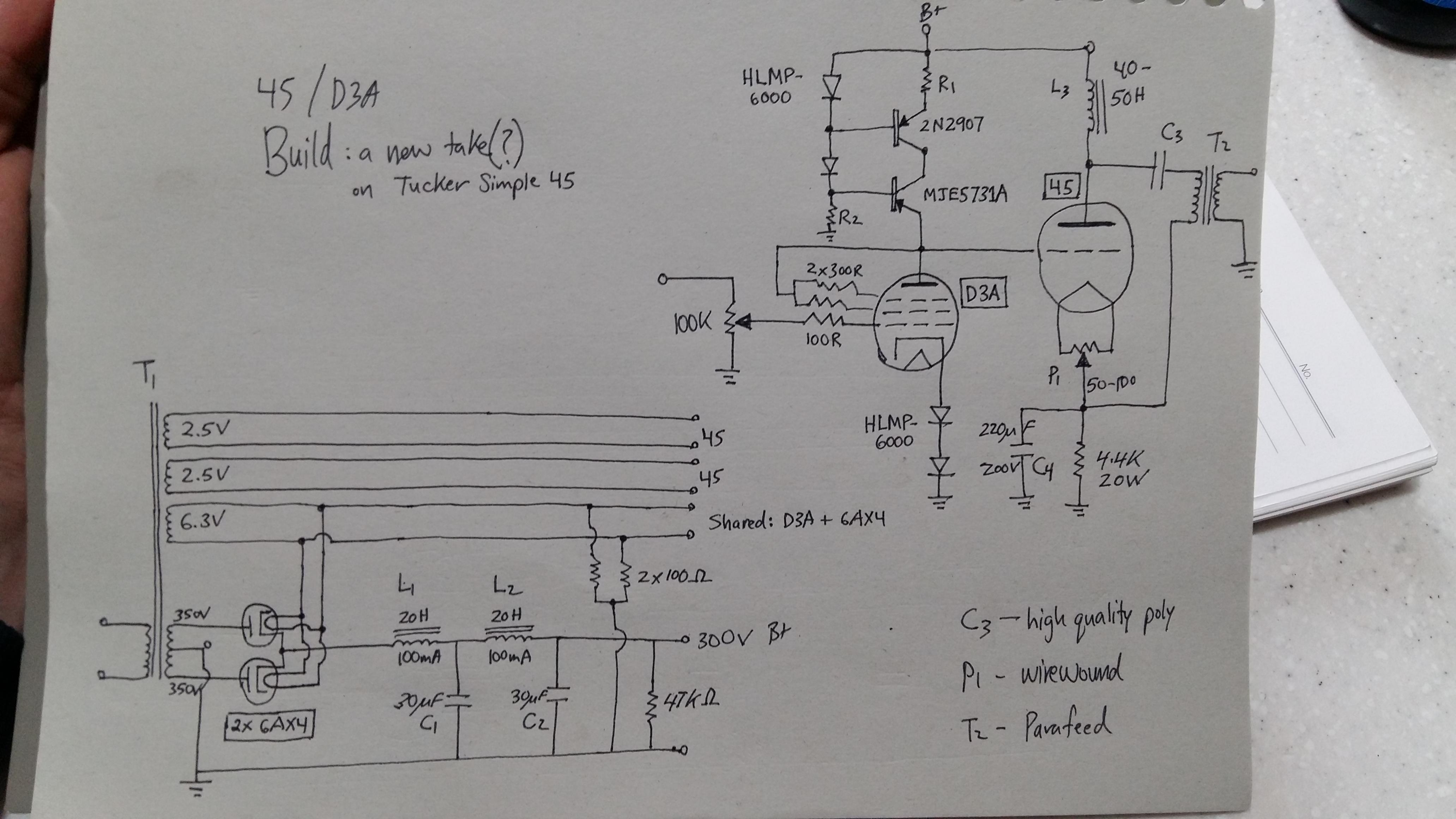

Push-Pull 45 is a nice idea. These days though, 45‘s are getting more expensive to source. Pity that.
The Cascaded 6sn7 brings almost too much gain for the little 45 tube. Indeed, it would be a lot for 2a3 as well. Also, output impedance is really still high on the 45 grid. Last part that I don‘t like with these designs is that the whole thing works like a house of cards - it assumes all valves/tubes are in like-new condition running like in the specs sheet.
Also, that variable 2.5K Ohm 50 watt cathode resistor... Pretty big. And no cathode by-pass cap from point G to ground? I have a hunch that bass response might suffer. Did you ever hear this amplifier?

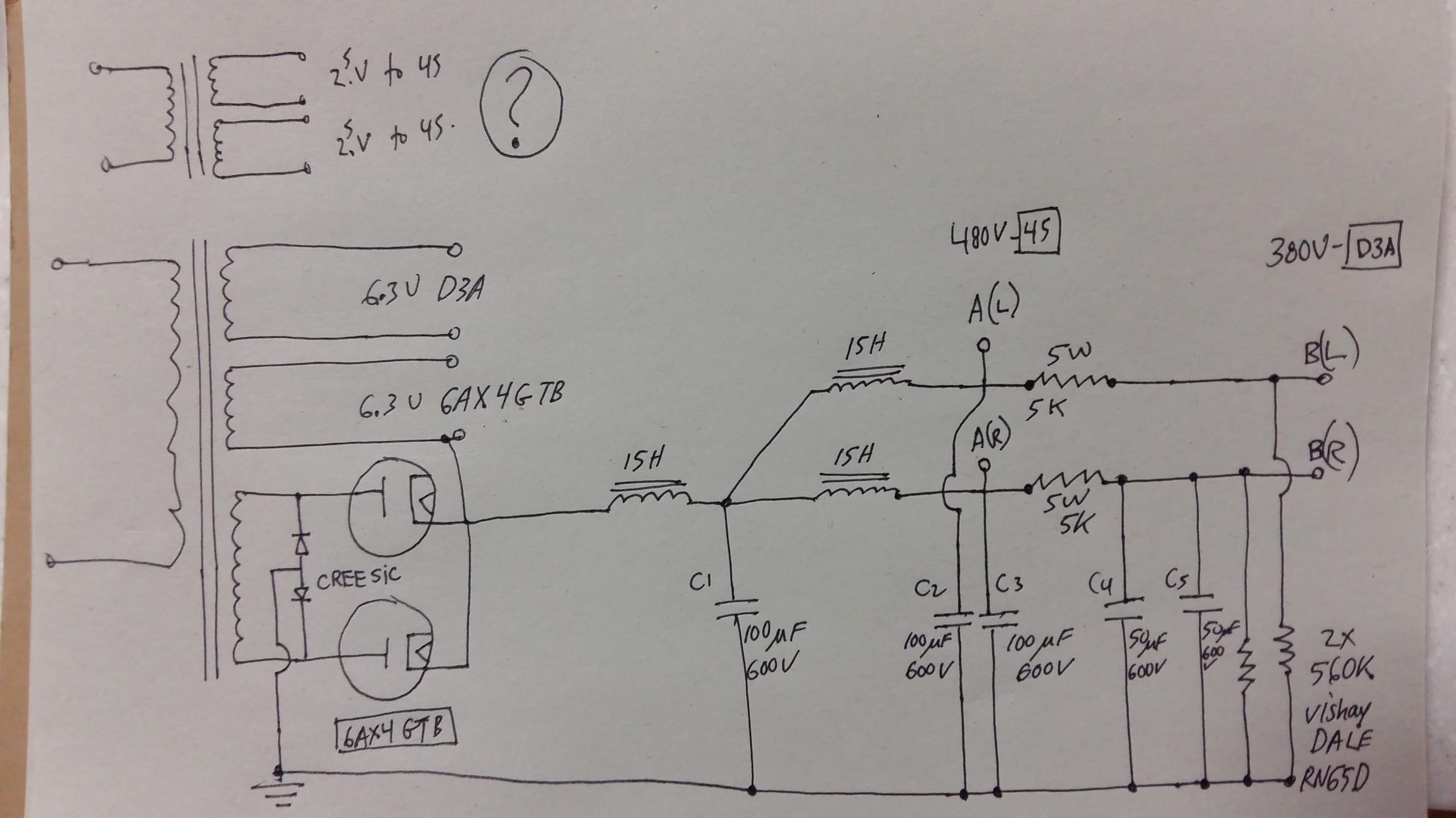

Hey mbrennwa - did you ever finish this amplifier?

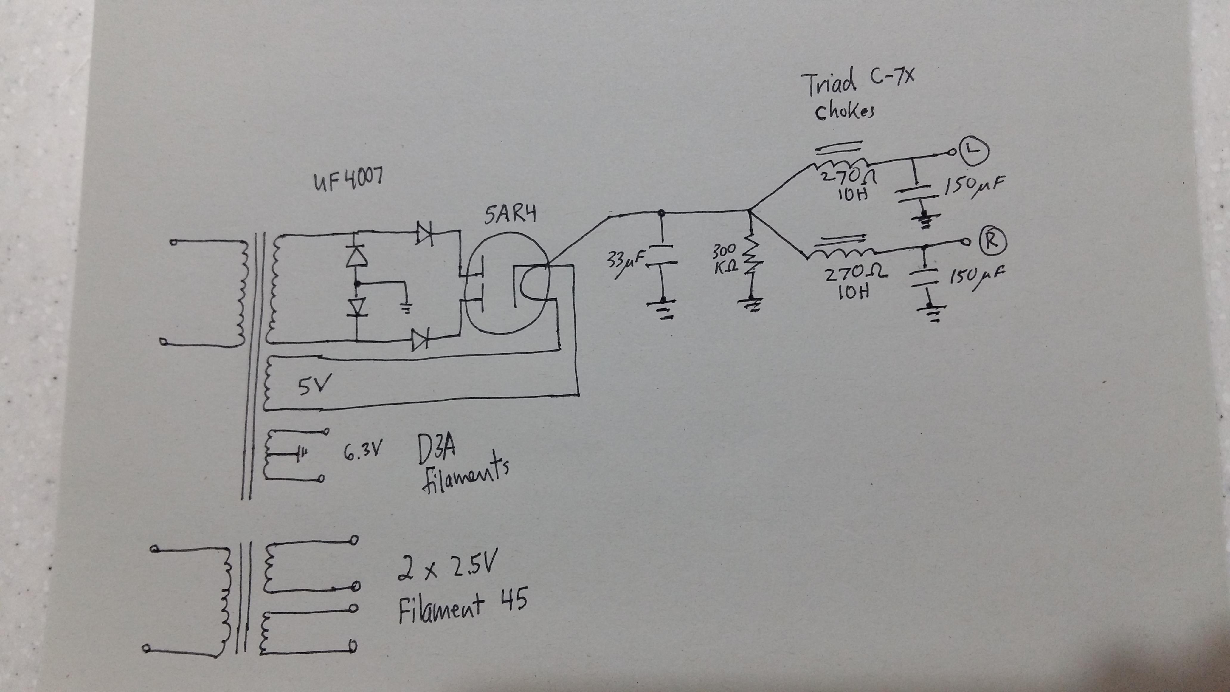

I believe I see a pair of chokes and two pairs of transformers in your pic, how is the second pair of transformers used?

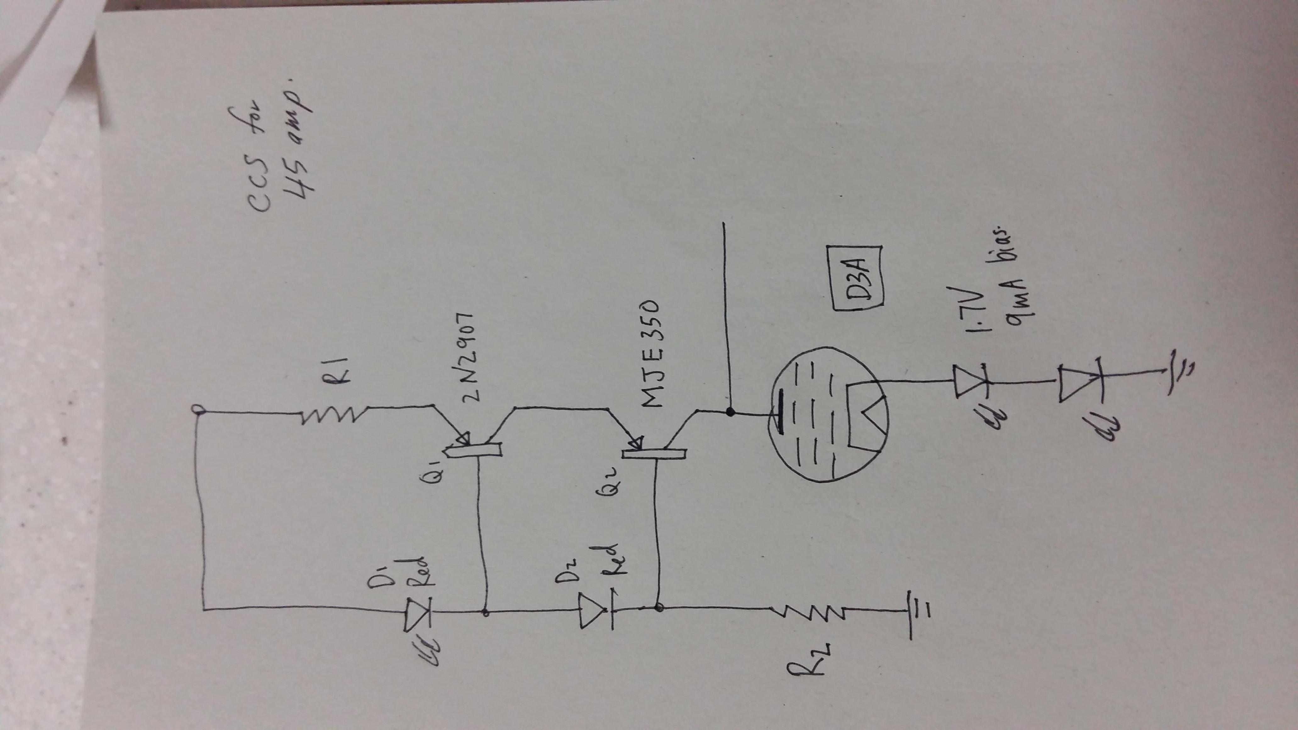

I have a 45 parafeed speaker amplifier that uses Sowter 8983 OPT, the 45 are loaded by a CCS rather than a choke however, stages are RC coupled. I am considering picking up a pair of 8985 chokes to replace the CCS loads and direct-coupling the stages, very little in the original circuit would need to change actually.
Also, I'm curious what turns ratio you used on your 10K headphone transformers. Do they have multiple taps or single? Thank you
