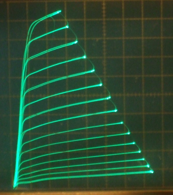

Here are some traced curves for a Raytheon VT-127
10 mA/div Vert. and 50 V/div Horiz.
a) Pentode 160V on grid 2, 0.8 V steps on grid 1
b) Triode 2 V steps on grid 1
Mu around 12
This Raytheon VT-127 looks just like a 1625 (807) tube except for the MO base and finer grid 1 wire pitch.
Mu around 12
Grid 2 too; I got red G2 when the amp oscillated without load. And definitely 200V is the maximum that I would supply for G2 of this tube. It is more like vertical video amplifier tube than horizontal sweep one. Like a predecessor for 6P15P, 12HL7, etc.

Judging from anode curves I think that I was wrong assuming that the tube was used for sweep duties in monitors. Most likely, it is a video amplifier tube on steroids.

Yes. 4P10S, VT127/CV1127, KT66 were customized successful Mazda Pen-46 design. KT66 was simplified for audio, the rest were improved for military usage in classified radars. I sold one prototype to a fellow audiophile in Australia, he loves the tubes.
