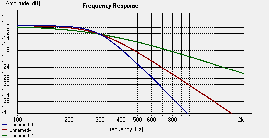

Fs = 300Hz
green = Butterworth 1st order
red = Butterworth 2nd order
blue = Butterworth 3rd order
I got it. Thank you all, I would've never figured it out on my own.
Fs = 300Hz

This was explained earlier but I will repeat it. For Butterworth:
1st order -> 1st order real pole filter (Q is not needed in the biquad implementation)
2nd order -> 2nd order with Q = 0.707
3rd order -> 1st + 2nd with Q = 1.
4th order -> 2nd with Q = 0.54 + 2nd with Q = 1.31
and so on
