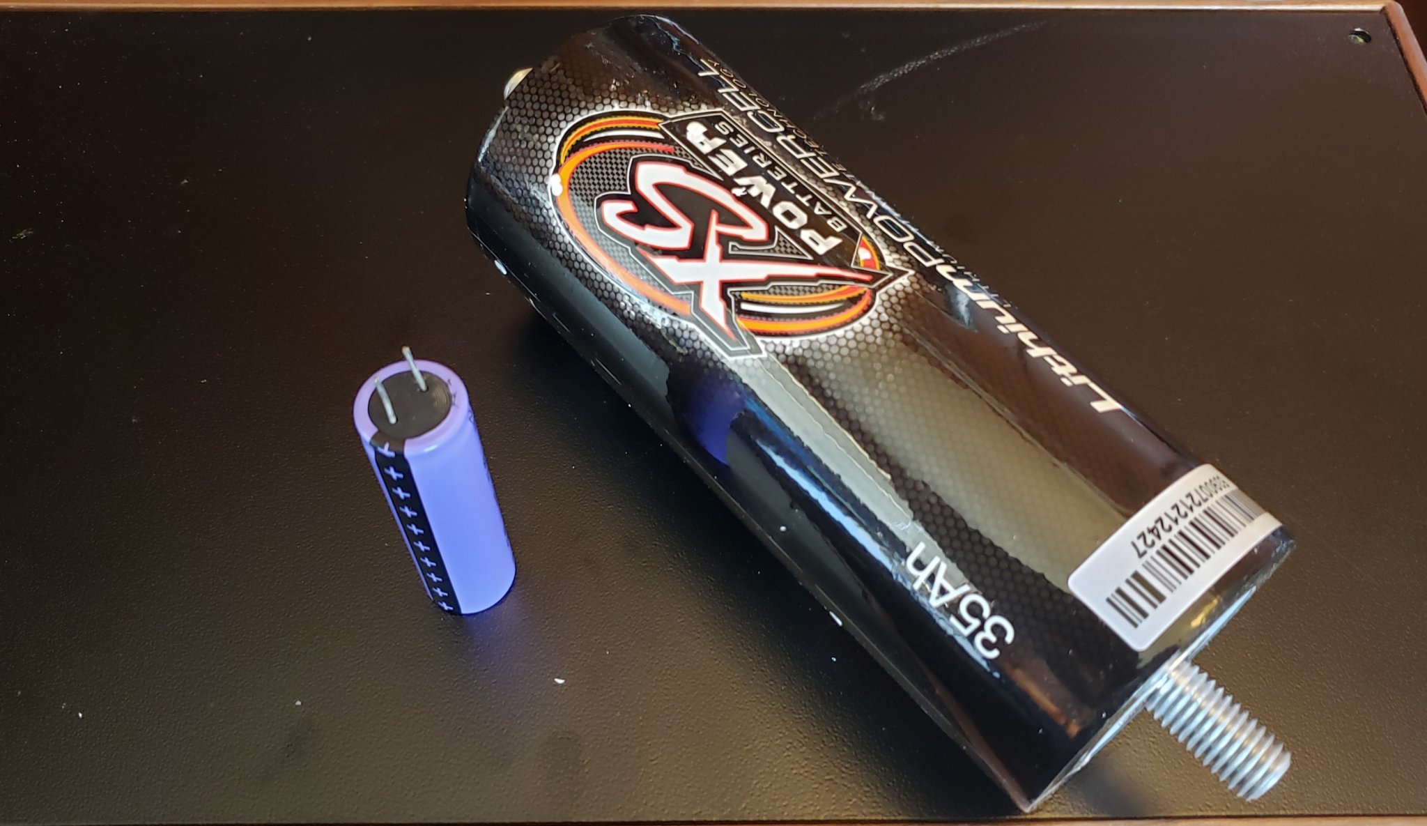

Listening Tests with LTO batteries: Round One
For the testing, I built an "ABX Board" - 4-Relay board for solo "blind" A-B testing that randomized the LED color assigned to A and B and whether relays start open or closed. A remote, wired switch changes from open to closed or vice-versa, while switching the representing LED colors. This uses an ATTiny84 chip programmed with an Arduino Uno - I attached the Arduino code as Solo-ABX-4-Relays-ATTiny84.txt. This would have to be saved with an ".ino" extension or copy-pasted into the Arduino app. Ideas for code enhancements or fixes are welcome. If there's interest, I can post the circuit of this board and pics.
some known limitations of my A-B of testing with this board-
system
power supply tested
Test 1
A- silver eBay purchased “Studer 900” LRPS
B- 1500mAh LTO batteries - 2 in series
First, listening to Janis Ian "Breaking Silence" which I recently saw recommended on DIYA (by Markw4, IIRC) as a good test track for listening tests.
LTO batteries had a bit more air and stage height… and a more relaxed presentation. I sensed a bit more distortion from the LRPS that came across as a slight "edgy" feel on both instruments and voice.
The LTO batteries had more air and a more natural, relaxed instrument timbre. They seemed to remove an “edge” off the overall sound and her voice in particular.
Instrument separation in space seems better for the LTO's as well.
Turning the volume up on silence between songs and low parts, the batteries were also lower in noise, but not dramatically. With the volume cranked, there is some buzz-hum of which a chunk disappears when switching to the LTO's, like one of several noise sources has been removed.
Next, I listened to “Silence of a Candle” (Chesky), and the LTO's were notably less strident…like the louder notes had an easier time conveying their peaks, somehow.
Test 2
A- silver eBay purchased “Studer 900” LRPS, this time with the iFi DC purifier (first version, not version 2 linked to)
B- same as above: 2 1.5 aH LTO batteries in series
LTO's are more relaxed than the LRPS again. They are also slightly quieter, although the noise level seems much closer now. It seems the bulk of noise comes from elsewhere than this particular PS, though…it is one of several contributing to the buzz-hum. I should add that noise is only evident when I crank the volume without music playing.
The iFi DC purifier seemed to narrow the difference noticeably but the difference is still there.
I perceived what I would describe as some type of intermodulation distortion on the LRPS that is not there with the batteries.
Test 3
A- silver eBay purchased “Studer 900” LRPS, again with the iFi DC purifier (first version, not version 2 linked to) and this time also with 2 350F Maxwell Ultracapacitors in parallel
REALLY close this time…. Maybe a slight edge to the LTO batteries for relaxed, analog feel. On more familiar material with more complexity (Dave's True Story: Sex Without Bodies) I think the LRPS plus DC purifier plus Ultracaps might be the winner with a better ability to handle complex material without entangling things. The LRPS+iFI+UC is a bit more “free” and open, it seems, on material with multiple voices like "8 Days a Week" (Chesky) … but barely.
*Please keep in mind that I did not know which power supply was which when I was testing and originally taking notes. Only when the test was complete did I remove the tape over the relay LEDs to see which was which ... my original notes said "red" or "blue" just to note which color of LED.

Hi Chris ... back again & now have a bit more time to give you some feedback. Again, it looks interesting & thorough what you are doing
First, I notice that you have some hum/noise in your system .. I reckon this may be either some kind of suboptimal grounding structure - or I have also experienced that oscillation may give rise to lower frequency noise (like 50 Hz related hum). I assume that amending this issue could further improve the audible "stability" of your system ... Just a thought (BTW are you using twisted pair wires for the PSU connections? This really reduces noise pickup).
Second, in relation to the inductances etc. added by the connecting wires you may already know about its implications - but otherwise might I suggest that you take a look at this thread: https://www.diyaudio.com/community/...decoupling-capacitor-simulation-model.382329/
I started this thread because I have spent hours upon hours with simulations trying to find a combination of capacitors having a low impedance response across frequencies - low to very high. IME it is not that "simple" to arrive at a frequency leveled response. Again, you may already know/have considered this.
To this end, if you are interested, there's an inductance loop calculator here:
https://www.eeweb.com/tools/rectangle-loop-inductance/
BTW - can I ask you what sampling frequency(ies) you are listening at?
And then about the switching PSU feeding the relay board etc. You wouldn't happen to have a really sensitive ADC (like from a low-noise sound card) that will allow you to measure possible noise feed-through? I do not (yet) have much experience with SMPS circuits but did some measurements a couple of weeks ago with a Dell laptop SMPS supplying a low-noise PSU I am working on. The feed-through was very surprisingly huge.
WRT your relays ... Although with my limited relay experience I would be surprised if they did not add some sonic imprint. They may of course also just be fine
. Maybe an idea is to unsolder two of them from the relay board and listen to them directly in the sonic pathway?
BTW - how do you make sure that the Ultracapacitors share equally the 5V voltage between them? I would expect that one of them would have most of the voltage across it ...

Fedex just dropped off the 65 aH LTO batteries I ordered for testing.
Haha, they are, ummm, a little large...maybe leaning on the impractical side.
One next to one of the 1.5 aH versions I've been testing is pictured. ("Hi, Dad!") At least maybe I will only need to recharge ...annually?
Still helpful for benchmarking purposes and to see just how good LTO's can sound when there are no packaging inhibitions.
A part of me is worried these will make a significant difference in sound, inspiring building a new wing for the listening room to house 2 for each 5V power supply.
Or maybe there's a "sweet spot" somewhere between the 1.5 aH and the 65 aH version... I do have some 3 aH LTO's due here any day now.
Cheers
Chris
