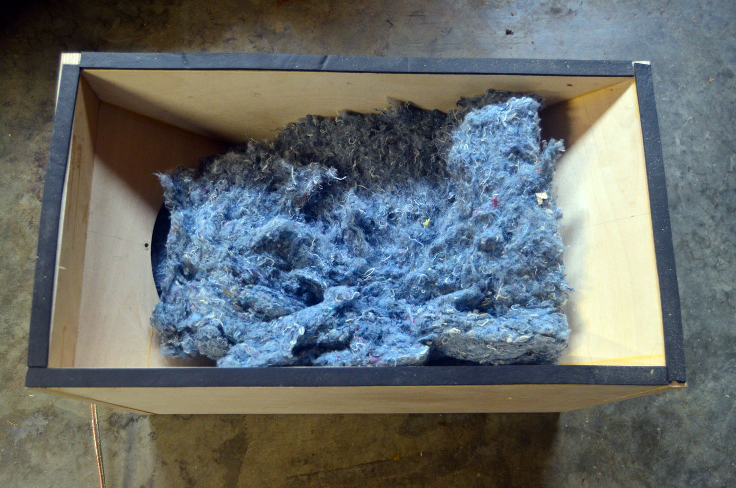

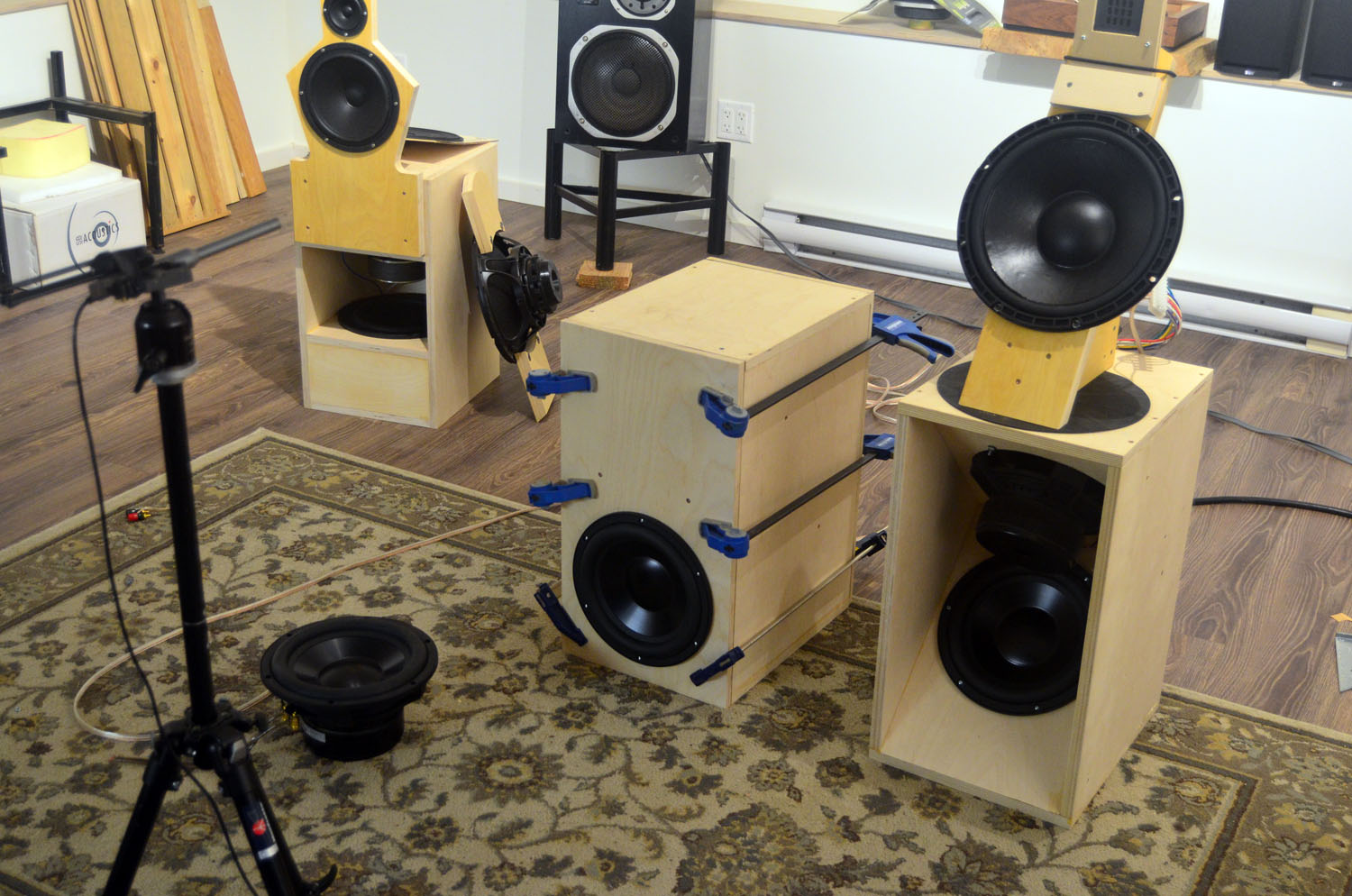

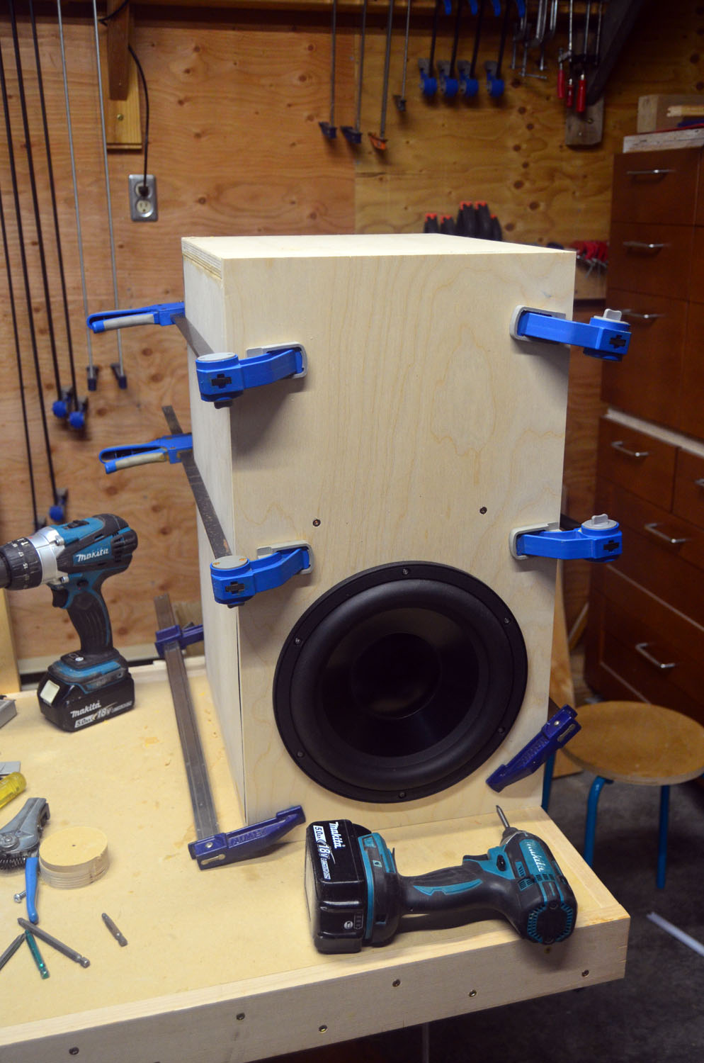

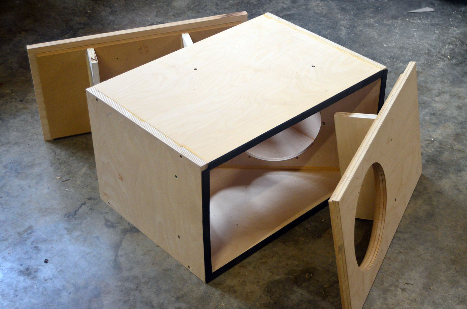

As I posted a few days ago, I decided to try my version of the AINO-Gradient 1.3 with a sealed bass box. Rather than build yet another box, I decided to make a temporary switch and listen/test in mono with one box.
A 2-layer back panel and similar front baffle with stiffening braces were built to fit the V-frame "box". The box was quite stuffed with recycled blue-jeans cotton insulation (fiberglass substitute), the edges lined with thick foam weatherstripping. The 2 panels were pressed into place, and 6 clamps used to tightly secure them to the V-frame box. One of the Dayton RSS265HF 10" drivers used in the V-frame was mounted & wires routed. The box is probably ~1.8 cu ft, agiving lower than 0.7 Q for this driver. It then moved into the lab and took position under the angled open baffle 12" and NEO8.
I was impressed at the first FR sweep I took of the closed box at 1m -- it's a nearly straight line from 40 to 600 Hz. Very easy to integrate with the other drivers, no EQ needed at all, really. I'm listening to it now. The bass and the overall sound strikes me as more natural than with the V-frame. There's a bit off bass boost that brings the -6 dB point to ~35 Hz. It sounds good at first listen. More measuring & listening...
