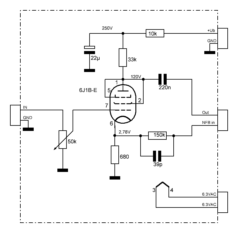

These are the circuits (triode and pentode) I tested. The component values are optimized to minimum distortion.
The results were quite similar with both 6J5B-V and 6J1B-V.
Unfortunately I do not have my memos at hand right now, so that I could say what the gain of the triode strapped circuit was.
Likely between 20...30.

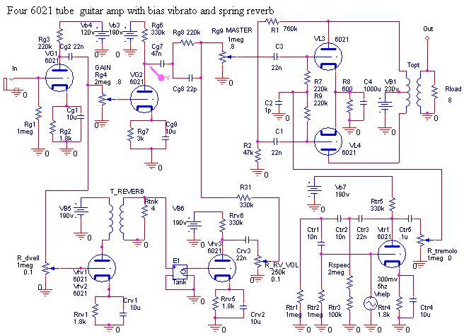

Here's a submini tube Hiwatt amp project, using 6021s, which I believe were originally used in ICBMs. It has a "self-split" PP power stage, which has almost no benefit over regular SE. Maybe you could build a guitar amp for home use with a 5678 preamp and 6021 power stage.
Here's a submini tube Hiwatt.....
I would like to look at it.....where?
I have seen self split output stages that were anywhere from "like an SE stage" to nearly perfect push pull. The good ones need a CCS in the tail which forces class A operation, and some tubes still refuse to respond to it. I found that a simple LND150 mosfet split load PI fixed all the ills of a low buck amp that formerly had a self split stage, and boosted the output power too.

I think I would put one of those bigger (than a 6021) submini tubes in for the finals. Maybe fix up that self splitter too.
