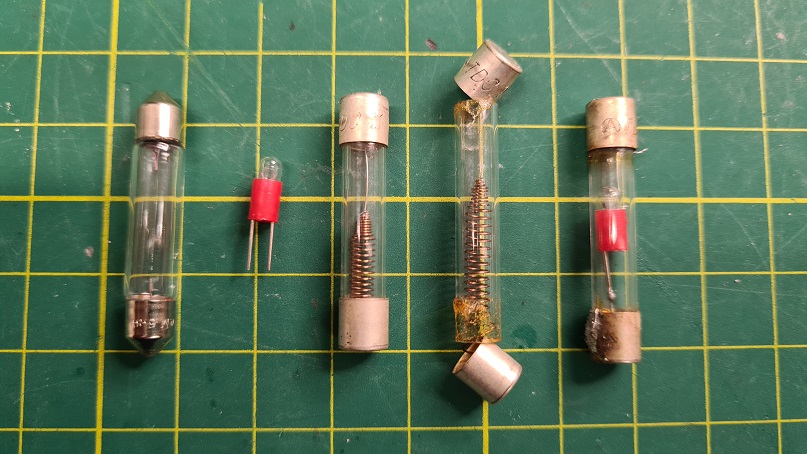

I have several Bruel & Kjaer vintage test equipment. Some of the white scale meter dials have stopped illuminating. The B&K globes are rated as 6.8V 0.25A. Thought of buying some old VW beetle globes if they had the same size. But prefer to build some being quicker. Photos are a little fuzzy.

I normally pick 20mA operating current for LEDS and subtract the LED voltage from 6.8V to calculate the resistor value.

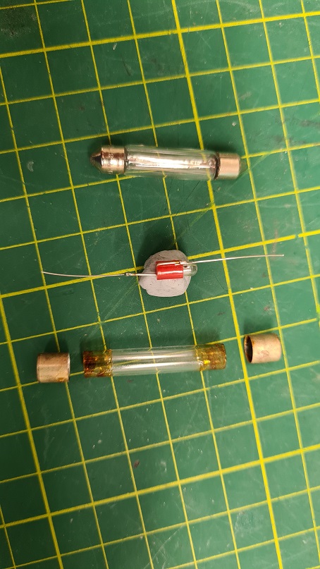

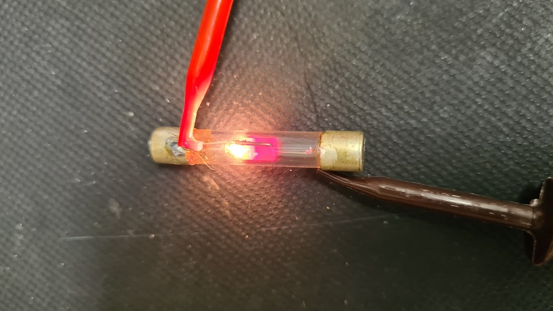

However, with no small led on hand, I used a mini incandescent lamp which could only fit inside a 3AG glass fuse. No limiting resistor needed.
