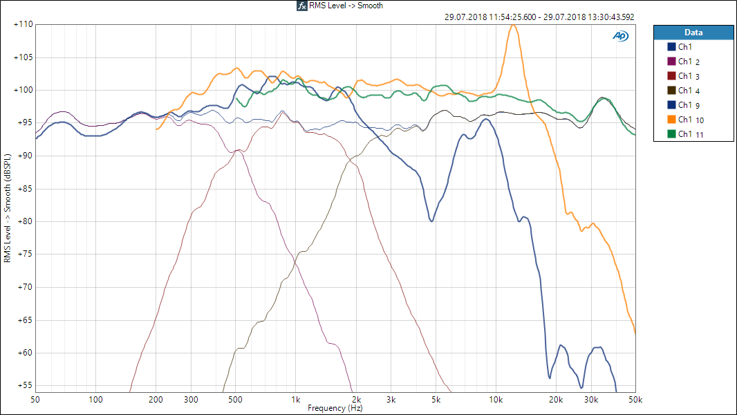

Did you ever developed a speaker from scratch?
It's not the LEVEL of the chassis, it's the frequency response which is not linear in 99% of the cases when built in the cabinet. Baffle step, edge difraction etc. add to the frequency response. Making an electronic perfect corssover will lead to a rally bad frequency response.
An older project - the fat lines are the raw speaker drivers. You need EQ AND FILTERS to get them linear. (and these are VERY well behaved drivers in a fitting cabinet)

Seriously, what IamJF shares are textbook knowledge...at least for speaker design...
The reason why we said so much about this is because that's the principle to follow. Not that you use some soulution/CH precision/FM acoustic amps will help on this problem.
Certainly you can design the active analog circuit with EQ to flatten the response of each band as well.
If you don't have time to read the loudspeaker design cookbook (or similar material), perhaps you can consider reading some writing in DIYRM by Scott Hinson.

That would be very spectacle since what you choose for your analog active crossover are all LR based crossover and will guarantee you only the electrical response to match the desired response but not acoustically.
Indeed I shouldn't presume you don't know that's the acoustical response that matters but not electrically. Just the option you put tells me otherwise.

A quick note on sound-au.com Rod is a skeptic and won’t take any BS. Information he publishes is fact checked to his satisfaction before he publishes. However some of the articles are now a little dated and in some cases the state of the art has moved on a little since articles were written, but in most cases the info is good. Since there is only on person creating content the site is absolutely remarkable. All of Rod’s project boards worked well for me first time and for me that is worth a lot.
