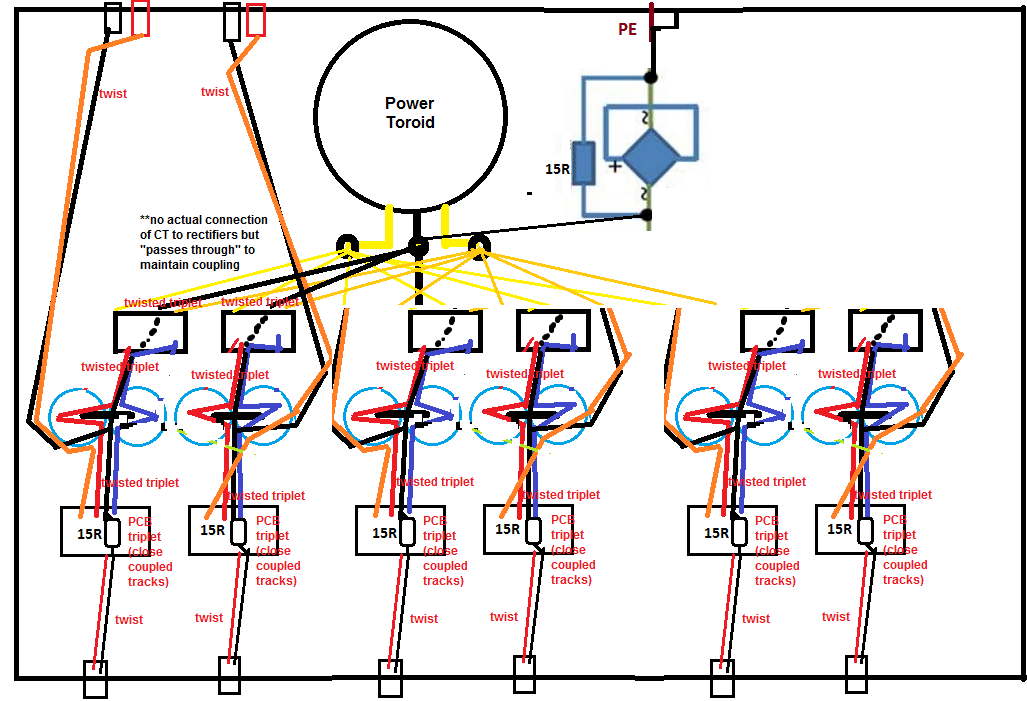

Okay so I've been busy for the last hour or so with this..
I have put the now very tatty paint diagram together for 6 channels, I believe it should be exactly as it should now be?

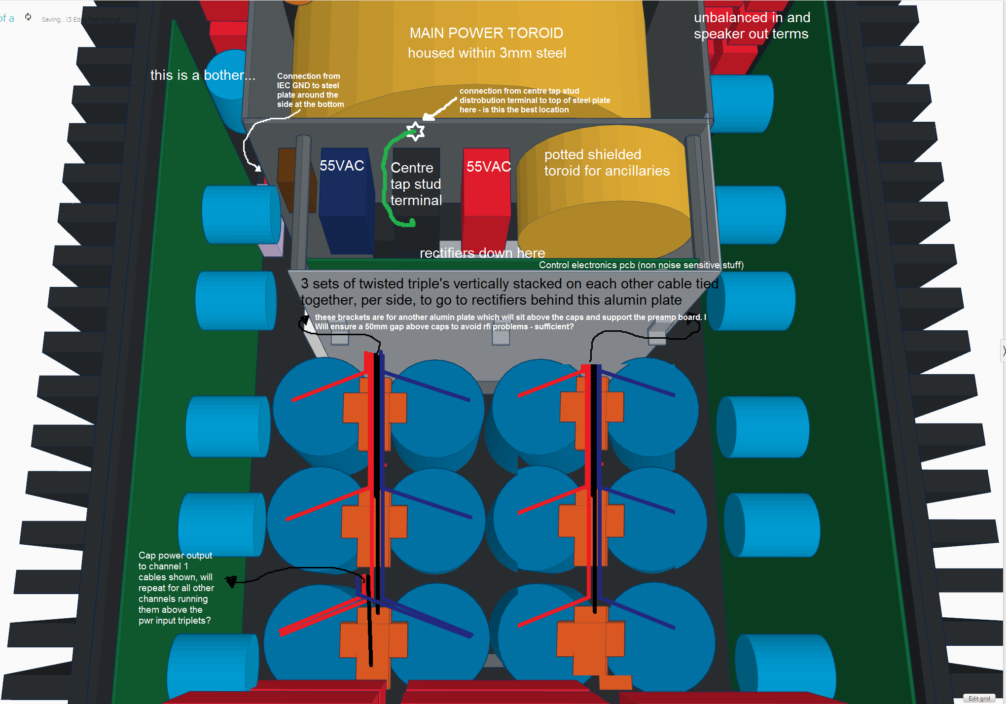

From this I have applied it to the cad drawing (crudely), does everything look suitable?
Steel shielding okay?
IEC and centre tap grounds in suitable places?
Have I chosen the best method in minimising the untwisted parts to and from the caps?
Is it okay to "layer" the twisted triples into the amp of have them run along side each other for neatness?
It is okay to have the output triples to the amps running near or along side some of the input triple for neatness?
Preamp PCB with 50mm clearance above the caps suitable from rfi point of view?
General placement of everything seem reasonable?

Looks good.
Now test it on a mono build on the bench.
Then test it in the chassis and only after passing those first two stages of testing, add on the extra channels.

Really? I expected there to be at least something I have proposed that wasn't ideal/best practice?
"Is it okay to "layer" the twisted triples into the amp of have them run along side each other for neatness?
Preamp PCB with 50mm clearance above the caps suitable from rfi point of view?"
Please could you advise on those points?

Cables running next to each other, even when twisted, can interact. You can get interchannel crosstalk.matt09 said:"Is it okay to "layer" the twisted triples into the amp of have them run along side each other for neatness?
Outputs and inputs must always be kept apart. Forget neatness; this is engineering, not art.It is okay to have the output triples to the amps running near or along side some of the input triple for neatness?

I might try and get hold of some braided metal sleeving to thread the triplets into which I could terminate at the centre tap stud. Could well be more trouble than it's worth though. Besides using 1 single centre tapped toroid I'm trying to create a no compromise design.

Regarding the size of this project I would really and strongly recommend to 1st
build just your modules and make your tests on the bench as Andrew told you.
I want this to be a reference amp I will keep for the rest of my life where the only upgrades will be re-capping / maintenance or swapping out the amp board for new designs. The power and size isn't so much to fill a huge room as have the capability to drive any set of speakers competently in the future. At the moment I'm only relatively young but will be using this amp on my 703's and MA GR floor standers.
Yes I will definitely be bench testing first.

All,
I thought this was an unusual toroid with a centre tap but in actual fact it does in fact have separate secondary windings, i.e 4 cables rather than three. This would allow me use separate 0v's derived at the T of the capacitors rather than connecting it to the 0V of the transformer. It does however mean I now need 12 thyristor bridges and more space..
Are there any REAL world gains in changing the design to the above?
Also which one of the T's would I connect the PE to if I used this design as otherwise they would all join together through the PE point.
