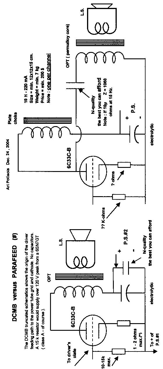

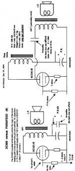

Re: How is it possible that it works?
Well, from an "audio designer" one would expect at least elementary knowledge of electrotechnics. The picture below is self-explanatory.
Alex Kitic said:.....If it is, I would like him to answer a simple question -- how is that possible, that you can actually place one power supply on top of another, and not have current from the upper connected thru the lower ps to ground... what I want to say, the upper is much stronger than the lower one... and I doubt that current is "willing" to turn in circles just in the upper circuit, without any interaction with the lower circuit?.....
Yes Alex,
This is how it works ( as Moamp explained).
Two separate current loops.
Thanks anyway for your interest and nice words.
Regarding the load, I agree with you.
I used also 1 k load ( did not go further because, as you know,
the 6C33C-B has an internal resistance of about 100 ohms ) and
I confirm that the distortion drops significantly.
However, I am know experimenting three parallel 6C33 ( resulting internal resistance circa 30 ohms ) and a 75 ohm load,
the same as a TV cable . I still can't tell if it has some kind of
interest.
Ari.
By the same message : thank you Moamp.
interest.
Ari.
Dear Kuei Yang,
I read carefully your reply and I think I'll read it again.
In the meantime, going to a real and practical ground, what
impedance would you give the plate choke, what capacitance to
the coupling capacitor and what parameters would the output transformer have.
If you have some personal experience on the matter, kindly let me know.
Ari.

Kuei Yang,
Sorry, I forgot to mention, for a 6C33 valve and expected output
power of, say, 15 Watts, and a frequency range ( within -3dB ), of 35 Hz to 30 kHz, which is roughly the performance of the Simplex.
Also, if you know it, what would the plate choke cost and its dimensions and weight.
Thanks again.

Konnichiwa,
You can get parallel feed paraphenelia from Magnequest/Bottlehead.com (nothing for 6S33 though).
I have experimented with parallel feed and prefer optimised series feed solution by and large. I merely took exception to you making fundamentally false statements about how the circuits (both of them) work.
As to "Anode Load Choke", lets assume we have a standard 600R/220mA Transformer and remove the secondary.
This frees up between 30 - 50% of the winding space and as we don't need to worry as much about losses we can easily put 2-3 times the turns onto the same core and likely get at least 3 - 4 times the inductance commonly found in a series feed transformer, which for our 6S33 anode load choke could easily make 10+++H, which is enough to keep the choke in effect out of contention when it comes to wrangeling for signal current.

stupid me!
Well, if it were not for that harsh answer, I would have never gathered the will to simulate the circuit -- and of course, stupid me. It only proves I'm human, too.
Yes, it does work, and it works great! So many times I wanted to try it, but I just could not envisage it appropriately. We sometimes remain blind to the obvious... 🙁
On the other hand, I would have preferred a reply from Mr. Polisois...

Kuei Yang Wang said:Before I forget, I hope you realise that your grid circuit signal also couples through a coupling capacitor in DCMB, again a powersupply electrolytic.
This demonstrates that there is no free lunch (except if you the "free lunch" circuit of course) and if you remove one capacitor so link two points having different DC potential for AC you need to replace it with another one.
Hi Thorsten,
The DCMB circuit avails itself of a feature that actually does provide some degree of free lunch. Because output tube grid and cathode are both coupled to the driver PS, driver PS noise is partially---and cleanly---cancelled. I say "cleanly" because any noise appearing on the driver PS appears in-phase on both output grid and cathode. The grid-cathode circuit element is about as truly differential as one can find in any active circuit.
In Ari's circuit, static measurements suggest the overall driver PS noise cancellation is about 75%. That figure, if accurate (the measurement is somewhat tentative, requiring further confirmation), effectively removes from the circuit 75%, if you will, of any capacitor used in the driver PS and any line noise.
Ari's circuit possibly can be tweaked to render the 75% figure higher, and in any event the circuit probably could otherwise be changed to implement DCMB coupling between input and driver, allowing the further benefit of noise cancellation on the input circuit.
What is not cancelled in DCMB is noise on the output circuit. That noise, however, is of less concern, relatively speaking, because the ratio of comparative voltages---B+ noise voltage to signal voltage---is higher. Experimentation might show that using parafeed on the output, and DCMB coupling for all stages but the output, is the better of combinations? Mind you, a DCMB circuit could be constructed using only high quality capacitors, rendering parafeed of doubtful extra value (except, perhaps, cost).

Dear Kuei Yang,
You will find, in the attached file, an attempt of comparing Parafeed and DCMB.
I must admit that I am not very familiar with the Parafeed subtilities, therefore, if you find something missing in my sketch,
kindly let me know.
On the other hand, I listed on the text file that I am sending after this message, the stron points of the DCMB topology, that I happen to know, having used this circuitry for 5-6 years now, in many amplifiers that I have designed and built, mainly to support some articles that have been published by Glass Audio, AudioXpress and the Italian diy magazine Costruire HI FI, but also ( half a dozen ) for my friends and myself.
I will appreciate your comments, hopefully calm, cool and collected.
Ari.

Konnichiwa,
Hmmm. That is like comparing an Ak-47 to a Lee Enfield.
Given that Parallel Feed is relevant to the output current loop (anode to cathode) and DCMB is relevant to the input current loop (grid to cathode). So I am not sure what you attempt to compare.
You can compare series feed to parallel feed, I believe I have done that already.
I think the problems you have are not in the subtleties.
BTW, please make sure you are aware how REAL capacitors behave. That might make clear why "bypassing" actually does not mean that automatically the smaller value "high quality" capacitor is the one carrying the signal current. Again, most basic EE101.
(I say this because your drawing inaccuratly seems to imply that in either case the capacitor in series with load is the same "high quality" one and the Electrolytic is not relevant, you may find the revers true if you actually apply sufficient analysis to the concept)
I am not aware of any "strong" points, at least non whatsoever that are sepcific or unique to DCMB (please appreciate that I have been aware of it since your first publication and took the pains to analyse it exhaustively - I am quite aware how it works) and in many cases other circuits (like the basic RC coupled one) can be illustrated to be ultimatly less plagued by the issues you have choosen to use as points in favour of DCMB.
Non of this BTW has got any bearing on personal preferences or any such issues, including "good sound", The issue is merely that your statement which claims DCMB eliminates coupling capaictors is absolutely inaccurate, as it merely shifts the position of said coupling capacitor. Thus, if your aim in devising DCMB was to "eliminate" from the signal path "poor quality capacitors", you have suceeded in achieving the exact opposite of your aim.
There are of course many isses past the signal passing through a capacitor that are relevant and may argue in favour of DCMB, but you have coosen to not remark on these.
It may have escaped you so far, my comments are always calm and collected. I observe, I remark on my observations and I recommedn remedies where I percieve problems. And rest assured, I do so with great calm and collectedness.
Sayonara
ari polisois said:You will find, in the attached file, an attempt of comparing Parafeed and DCMB.
ari polisois said:I must admit that I am not very familiar with the Parafeed subtilities,
ari polisois said:On the other hand, I listed on the text file that I am sending after this message, the stron points of the DCMB topology, that I happen to know, having used this circuitry for 5-6 years now, in many amplifiers that I have designed and built, mainly to support some articles that have been published by Glass Audio, AudioXpress and the Italian diy magazine Costruire HI FI, but also ( half a dozen ) for my friends and myself.
ari polisois said:I will appreciate your comments, hopefully calm, cool and collected.
Sayonara
