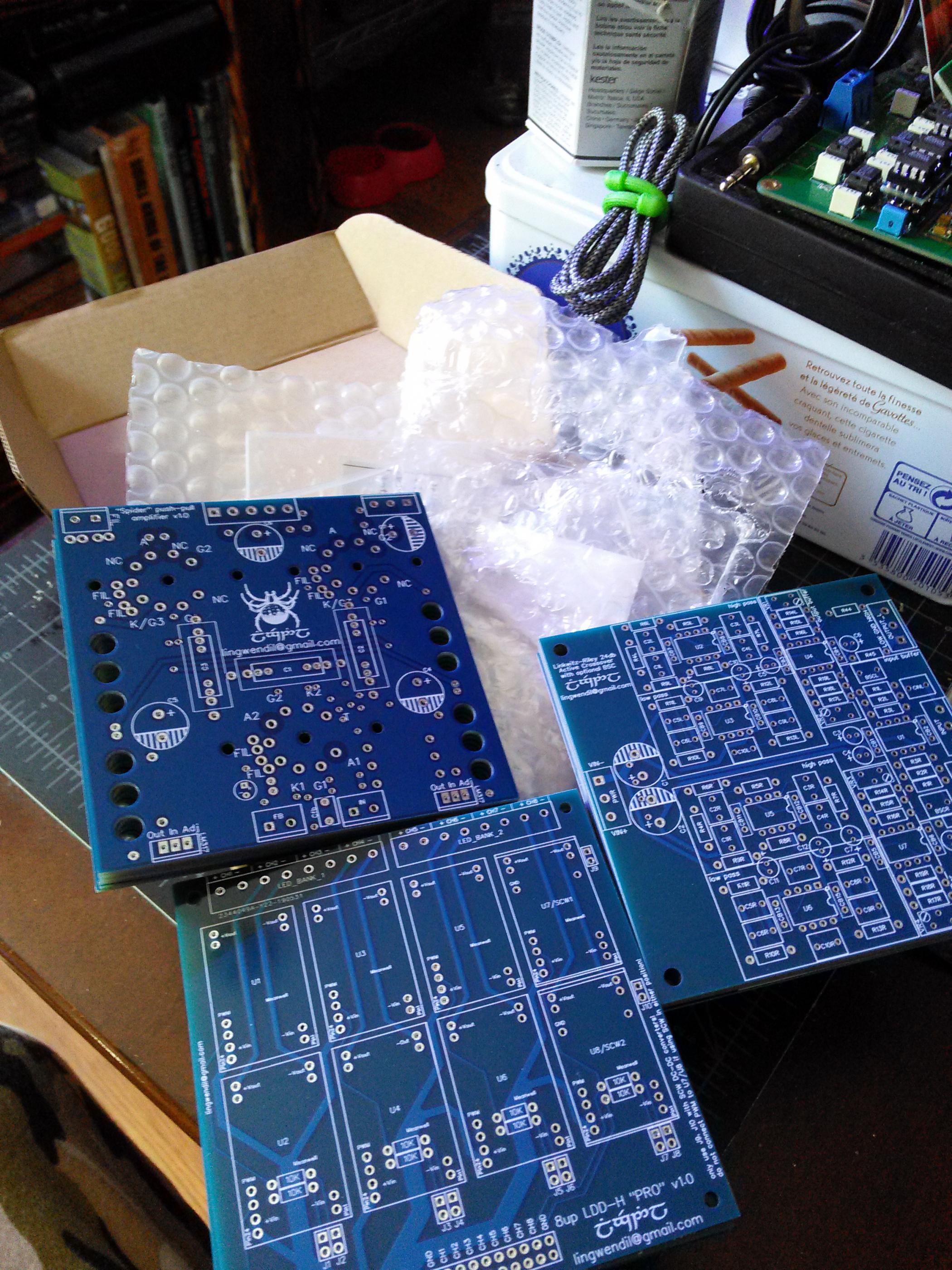

Man, I really like the blue PCBs, definitely going with blue from now on.

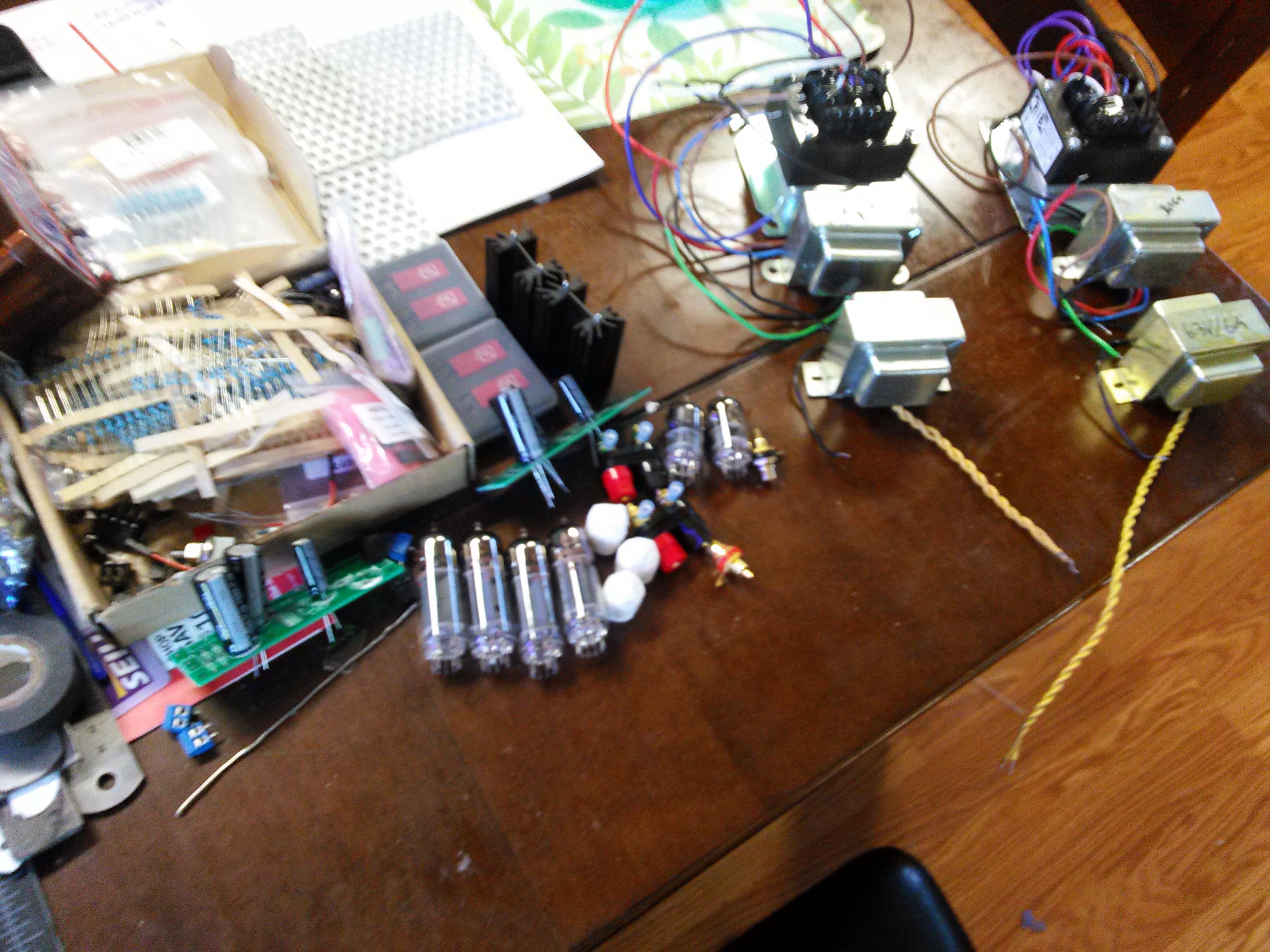

I'll start up on digging out parts to populate these, going with monoblocks since I have some cheap transformers on hand that will work well.

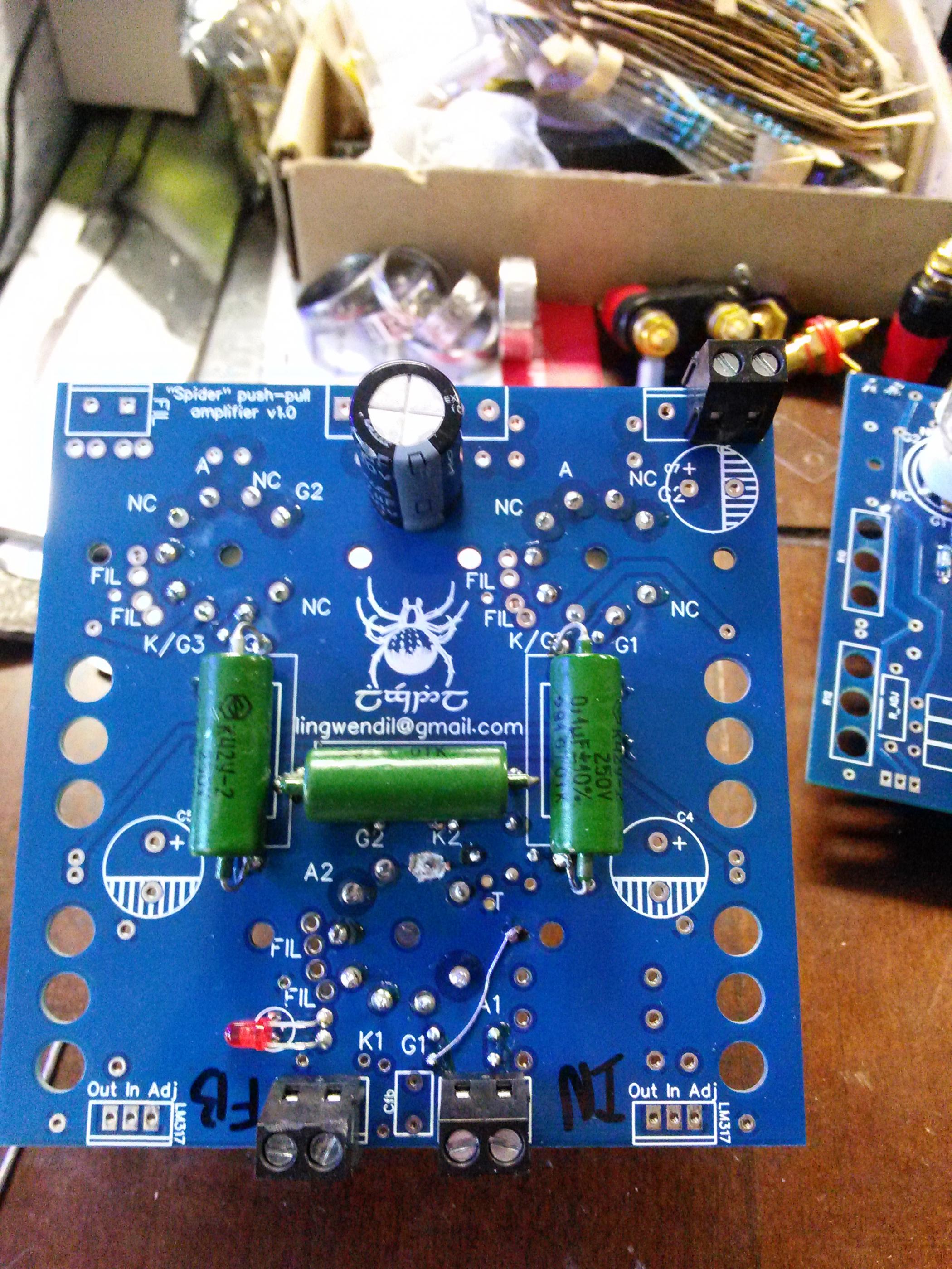

Started populating a pair, just need to dig out my larger power resistors to finish up, and I'm out of screw terminals so need to grab some. Some minor mistakes but nothing too bad (silly stuff really)
Found six Russian caps that were a perfect fit for this build 🙂
Short list of errors (which have so far been corrected on the design file just now)
Somehow the GND end of the input resistor (R3) wasn't connected to anything. Easy fix, run a trimmed-off resistor lead to a nearby ground pad. Fixed.
Cathode pin of the input tube socket (K2) was somehow grounded. Simply cut the traces on the bottom of the board to isolate it from ground, as the signal wiring is topside for this section of the circuit otherwise. Easy fix.
Feedback capacitor (Cfb) has no traces joining it across the feedback resistor. Will need to run leads from the feedback resistor to attach. Easy fix.
Silkscreen for power input terminal disappeared.
Small R10 should read R14 (grid resistors for output tubes)
Since I'm using EasyEDA I think I've found a bug- on occasion GND nets will merge by accident, and some traces will simply disappear entirely- I've noticed this on several occasions, with different computers and PCB files. I had a run of LED driver (aquarium/horticultural lighting) PCBs done not too long ago that had a similar issue with GND pins simply being tied to nothing. Easy fix, but a little frustrating.
This is why I like to test things before sending things out- and don't promise boards or take any sort of prepay until things are verified. On the bright side I'll have a couple pairs of bards to sell off dirt cheap soon as soon as I finish these up to document any additional errors.

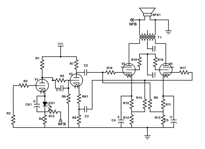

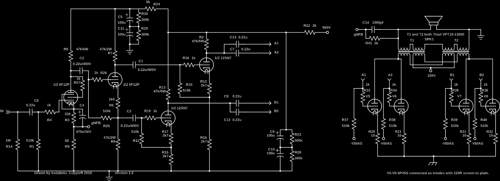

Apparently I had attached a schematic earlier with the basic loadout of the board, but I'll share it here again for posterity-

I managed to dig through my storage and have everything except for the enclosures and cathode bypass caps. Both PCBs are populated for a 6P43P-E triode build otherwise. I have very little time for hobbies at home lately so I have a handful of things that are still back burner for now. Hopefully soon- Goal is to have a pair of monoblocks to bring to Burning Amp this year.
I had to cut a trace and bridge a couple pads to use them, but otherwise no major issues. Already fixed on the PCB files.

I have been planning a build using the 12AV5GA as outputs for quite some time. I think a driver PCB that is meant to be more universal with different outputs wired on off-PCB sockets would be very versatile. Any topology in mind? I think something like this could easily use the EL36, 6AV5GA, or even regular audio types on the outputs.
Feel free to post your design goals and desired attributes, here, and let's see what sounds good to you 🙂
For instance-
triode/pentode/UL?
desired supply voltage?
bias? fixed? cathode? other?
front end- concertina? differential? both? (concertina feeding a differential sounds great)
Something like a 100x100mm PCB with output bias, splitter, and driver all onboard with the outputs wired to separate sockets offboard would be very nice and handy.

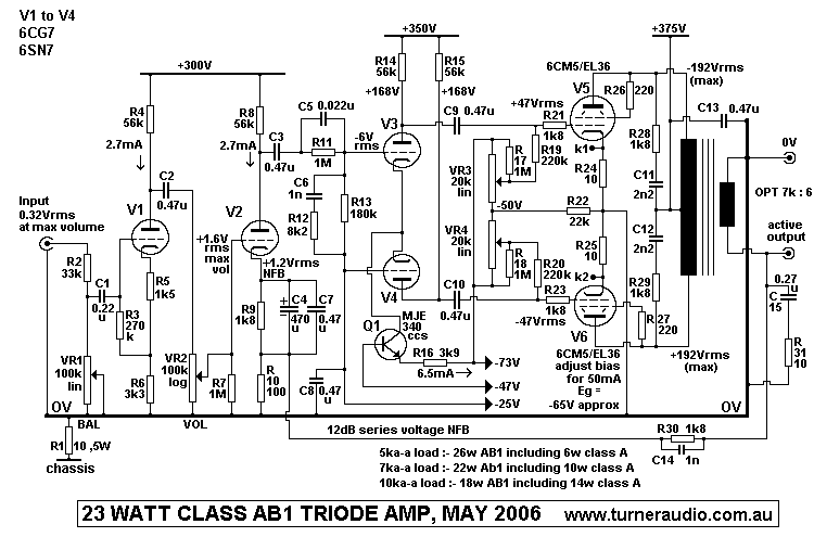

Well, just after a little bit of digging, I really like the EL36 🙂
Some interesting projects floating around, but the one that seems like a starting point to chop up for what I would want to build is the one by Patrick Turner-
2323-triode-integrated-6cm5
785289d1570030115-6n2p-6cw5-design-toroidal-outputs-schem-23w-triode-ab1-6cm5-amp-06-patrick-gif
CCS-tail differential for nice balanced drive, some NFB, triode outputs, looks nice. Maybe go with a slightly higher gain tube up front to cut out that first stage (6N1P, perhaps?) or go with a concertina with that triode instead to drive both of the differential grids.
