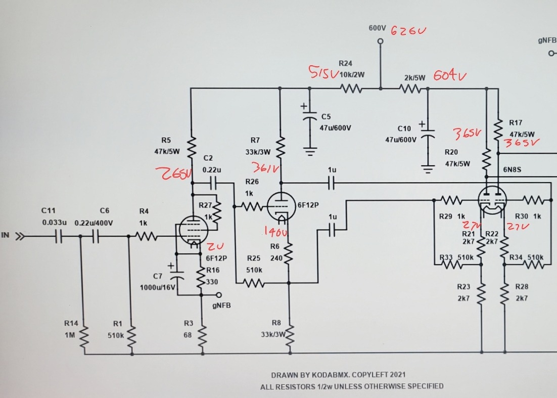

The voltage points seem off. The split-load circuit has 140V at cathode and 233V at plate so the plate resistor should eat up the same amount of voltage that leads to 373V B+ and yet you have a 400V supply. Who ate the 27V? Unless your voltmeter is not high impedance enough, the reading is not right. Maybe a typo?
Not to discourage experimentation, but why not try the Williamson front end as designed? The only change I ever make is to raise the V2 cathode resistor to 680 ohms to let the differential driver stage swing a bit more voltage.
Perhaps measure the output of the phase splitter rather than the output from the first stage, so as to confirm your measurement technique isn't modifying the first stage response due stray anode capacitive loading.

A large decoupling resistor, combined with a too small decoupling capacitor, will cause a boost in the LF response.
Because at low frequencies (where the decoupling capacitor is ineffective), the effective plate resistor is the sum
of the plate resistor and the decoupling resistor.

Is there any bypass capacitor at all on the plate supply to the 6SN7 (V1a and V1b)? I don't see one in the schematic. The schematic just shows a 400V voltage source directly connected to the plates of V1a and V2b. is that how it's actually wired up? If so, it would help a lot to be able to see the power supply schematic and voltage readings.

As indicated with the concern on the B+ feed to the first stage, Williamson purposefully introduced a 0.6Hz decoupling time constant (33k and 8uF) into the first stage to add some phase margin for better LF stability. Also Williamson did the same for the phase splitter stage, and perhaps more importantly both those stages had similar idle current and signal currents (but antiphase) - which effectively suppressed signal on the upstream decoupling cap and supply. So altering the original design may make it even more important to include LF step compensation (or something equivalent) to achieve unconditional LF stability.

Here's what I came up with: Today, I recorded the voltages of one of the amps...
C5 and C10 are now two 100uF/400V caps || 300k in series instead of a single 47uF 600V.

Maybe the power supply itself has some issue, leading to a response which looks like having too small a decoupling cap. You mentioned a mosfet regulator - which normally looks pretty good if properly designed. But if you did something crazy like using a 1 meg gate stopper the output impedance will suffer at high frequency leading to voltage drop. Measures fine at DC but not AC. That’s one possibility of where an unexpected pole/time constant could come from, and how it might get into the 1KHz-ish region.

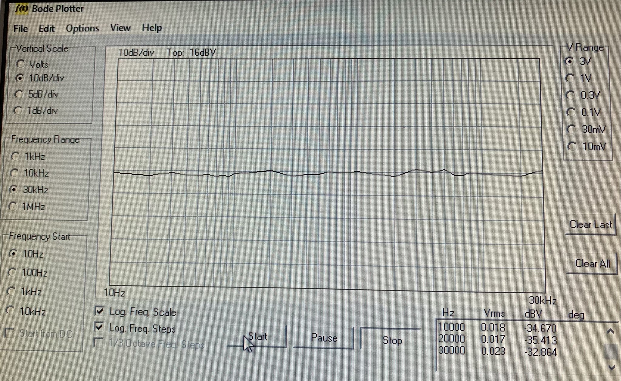

I just came back from a few hours of testing in my workshop. I tried all the suggestions I got in this thread and nothing seemed to make a difference (extra series resistors with extra decoupling between the input stage and the PI; using a bench psu for the input stage, etc.).
I was very puzzled and became worried about my incompetence to find what you indicated.
Then I changed my measuring probe (a Velleman 1/10x 60 Mhz. probe) for a Tektronix probe. As far as I can see right now the bode plot is OK and for some reason the Velleman probe gives weird results at low frequencies. I was not aware of that possibility. Does it make sense?

I have to check if my bode plot software (Velleman) has a calibration function. I don’t remember having seen such a property, the software is rather primitive. I will check this with ARTA or Visual Analyzer (spectrum anaylzer) too.
