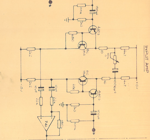

From what I am able to understand, my mixer has that circuit but with 741 chips
It seems the following generation tlo71 's were used. I wish I could find schematics for the rest of the channel. Would a photograph of the circuit work to help analyze. This is for a studiomaster 1977 12 channel mixer.

Sorry here is the drawing

I did. And allot more.
Its the only drawing I have been able to find in reference to my mixer, thanks to you and whomever posted the link on another site, I should have done the same.

is this : Low Noise Balanced Microphone Preamp , aside from the opamps used, the same circuit as this attached Drawing sent to me by the guy who Designed the RSD/Studiomaster 12 into 2, from 1977, I am working on.
If so, would I be hurting or helping the attached design by replacing the 741´s with tlo71´s? Is it possible to describe what, in theory, would change? Just finished recapping and everything is stable.

Download some opamp datasheets.

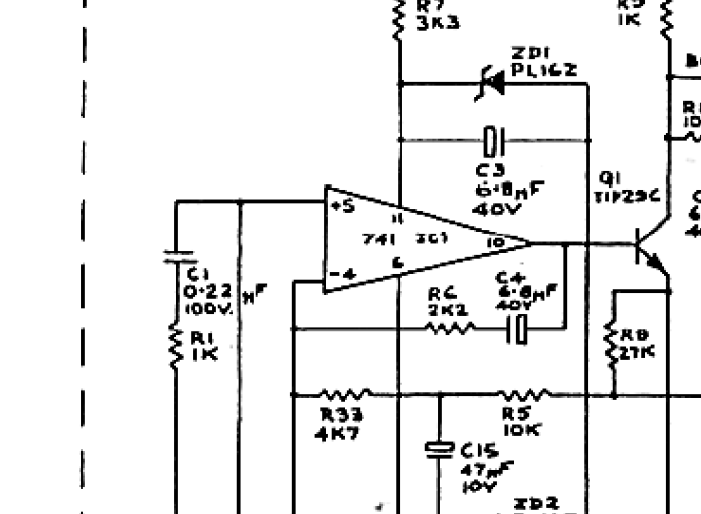

I also want replacement for my old 741 Opamps if possible, my poweramp section has one which working fine but I just can't drop TL071 there, it makes one powertransistor (Q2) to conduct all the time. I guess that is happening beause TL071 is not rail to rail, I don't know so far tried 4 different TL071's either they all went bad or something wrong. I remember tl071's being unstable with power Vs+/- I drop the schematic below.
Also want to replace the other 6 741's on input&reverb channels. So far I had to replace 2 741's of channel 2, because there was hiss&oscillation from that opamps, placed tl071 and viola! all the noise is gone and channel is working maybe my tone control for bass&treble range a bit shortened but not that much noticeable. But something makes me wonder, If poweramp meant to work with 741 how about my preamp? Am I making my preamp less effective by swapping 741's? I don't know much about Opamps but when comparing TL071 & 741, latter is rail to rail, which could make a difference?
I don't know much about Opamps I am open to suggestions !

Your diagram shows opamps marked as 741 but with pinouts applicable to a different device in a larger package. The normal 741 is an 8 pin chip. So a lot of unknowns with this one.
These are all single channel 8 pins, for some reason pcb has 16 pin holes drilled but opamp sits on 8 pin socket, only 5 pin has paths +/- volts, +/- inputs and one output as seen on schematic. I don't know why manufacturer drilled 16 holes for each single channel opamp, but it is there, and pin numbers are kinda odd because 8 pin Opamps are meant to be used on 8 pin sockets not 16, so I think this explains odd pin numbers.Your diagram shows opamps marked as 741 but with pinouts applicable to a different device in a larger package. The normal 741 is an 8 pin chip. So a lot of unknowns with this one.

That circuit would work just the same for a TL071 as a 741 running on say 9 volts. Make sure the TL071's are genuine parts and not fakes or actually dual opamps.
The TL07x family have phase inversion, I'd not risk it with those unless you are sure this won't cause problems. Plenty of modern opamps available with better performance.
I found an old 741 datasheet which shows that it was offered in a 14-pin DIP. https://www.physics.wisc.edu/courses/home/spring2020/623/ds/LM741-opamp-new.pdf
