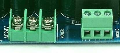

It is often that way, a good power supply which does not sag much in voltage often keeps the bass a lot more precise and 'darker', with more authority. The feedback does its part to compensate for a certain voltage drop but the difference is often clearly audible. If you want to use really demanding speakers with low impedance, remove the power supply plug and solder the cable directly on to the board if it doesn't already have screw joints. One of these guys got a lot lower contact resistance than the small surface of the coaxial power connector.
