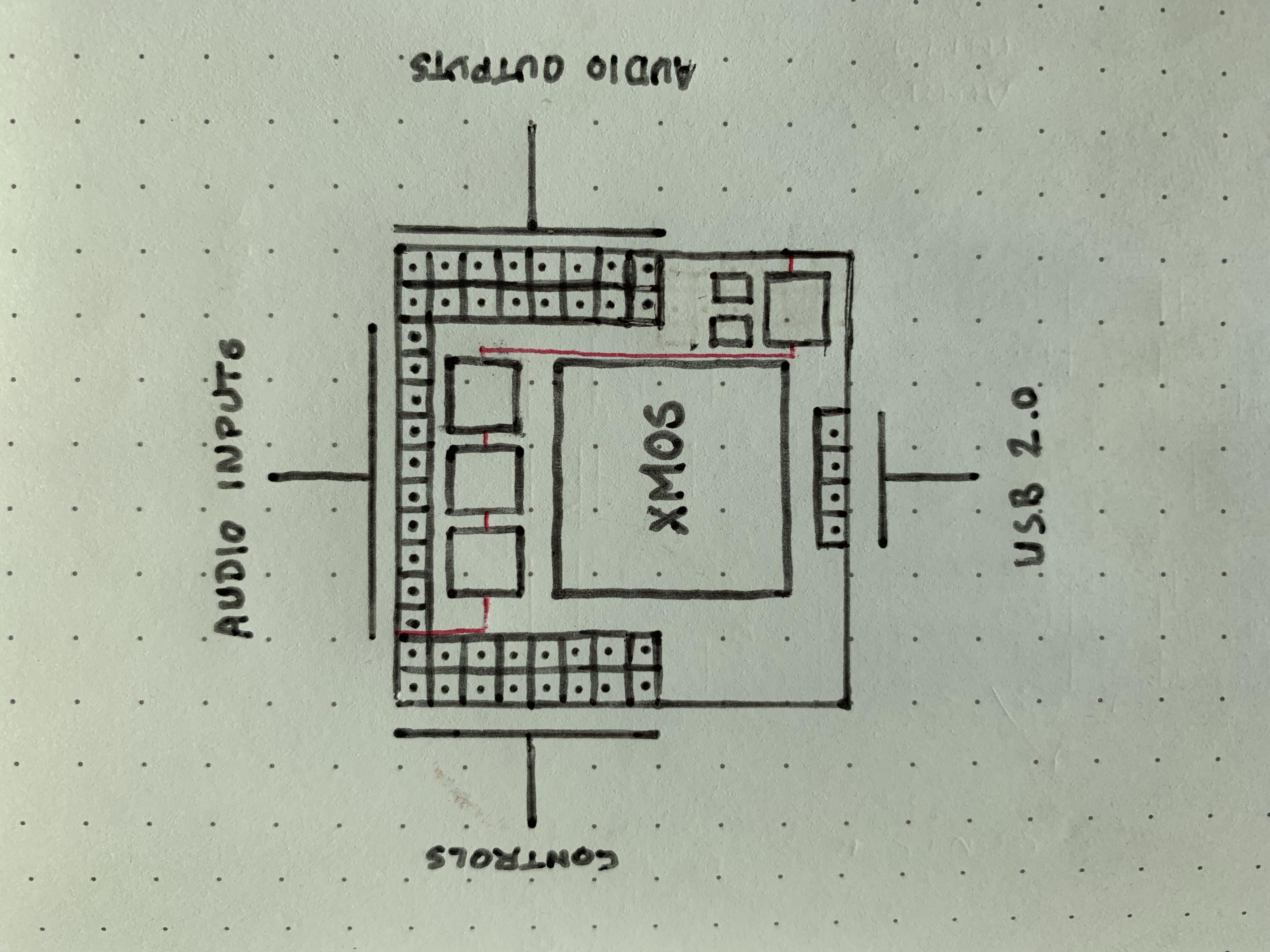

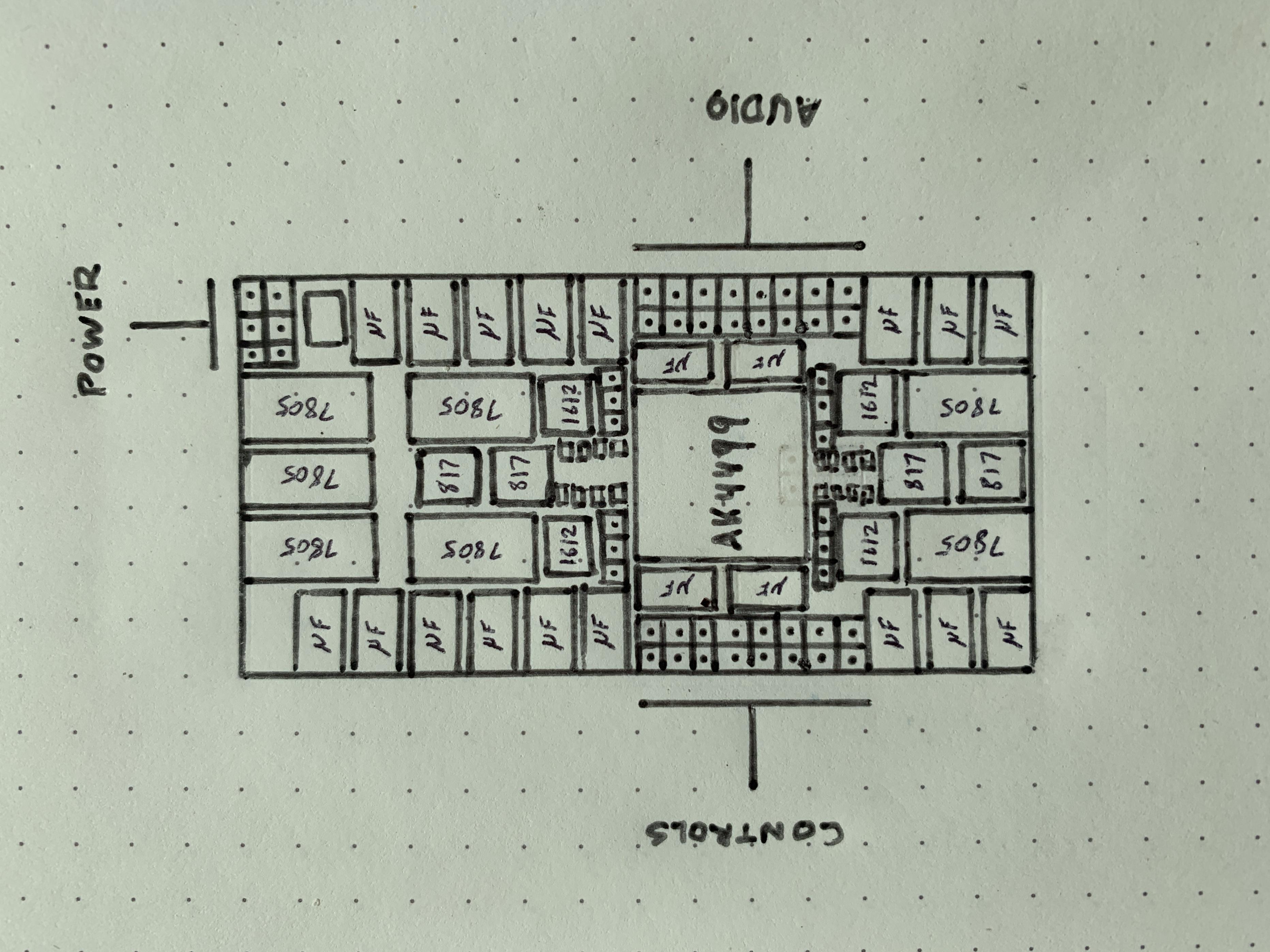

Updated USB and DAC Boards
Here are some updated USB and DAC boards for which the seven regulators (5 NJM78M05 and 2 SMD versions of the BA033CC0T) are mounted directly on the PCB. This will ensure that we do not deviate from the original design of the evaluation board, while reducing the height of the DAC assembly. It will also reduce the BoM of a single DAC board by a cool $90...
The DAC board is certainly a tight fit, and many resistors and capacitors will have to be mounted on the underside. We might also go from 70mm × 35mm to 72mm × 36mm in order to get a tiny bit of extra breathing room. That being said, I really like the layout as it stands.
The isolated part of the USB board has now been broken down into three sections:
1. Oscillators (bottom right with picture in portrait orientation)
2. Outputs (right)
3. Inputs (top)
As a result, the pins located on the top side and used for isolated inputs will not be used by the DAC board, but they could be used by some other boards. This will ensure that we can reuse the USB board across different bricks.
The four balanced outputs on the DAC board are now provided through four separate sets of three pins, which is probably better than two sets of six pins. That being said, their actual positions might evolve a little bit as we finalize the overall component placement.
On the DAC board, we now have 16 pins for the audio inputs and 16 pins for the controls, which will allow us to provide separate ground references for everything we need, but we lost the two extra GPIOs that we had included in an earlier iteration.
Now that we have a high-level validation of the overall design, we will review every single component of the AK4499EQ evaluation board in order to come up with a full BoM. And when that part is done, we will do the same for the USB board.

That being said, you are totally correct, I am positively overthinking this whole thing, but this is allowing me to understand what regulators are for, how they work, what their parameters are, etc. All this must be totally obvious to you, but I am really starting from scratch, therefore none of it makes sense to me at first. It's only when trying to solve some puzzles that a picture starts to form. Of course, some of these puzzles are totally pointless at first. But once you've solved a few of them, you can start solving some that are actually useful.
As far as the 470μF capacitors are concerned, I really don't like the fact that they are using so many of them: these are big and expensive. That being said, the 100μF and 220μF have the same footprint, and my primary constraint is PCB real estate, not BoM cost, so I'm not too concerned about them.
I don't think this component would work, because I need a 15V input, and this component has a 1.9 V to 5.5 V operating input voltage range.
Isn't the DAC digital supply 3.3V and 1.8V? Dropping almost 12V across a linear regulator is usually a bad idea. If the DAC draws 100 mA at 3.3V you would dissipate over 1W in the regulator. Even if it was half that worst case, it's still 0.5W which might get warm.
Just use 47uF tantalums if you must go with 7805s, but the high input voltage is costing you in terms of the cap size too. I doubt you need more than 47uF for such a load.
My best advice is something I should take more of myself. Keep it as simple as possible, get something done, and then improve on it iteratively. Trying to achieve perfection in the first attempt is hard. Now, I'm not saying you shouldn't do research, but you might want to prototype some sections in larger areas and get a feel for what you need.
Well, that's exactly what I am trying to do with these regulator boards:
1. LT3045 REG board
2. LT3045 + LT1963 REG board
3. LT8609A + LT3471 + LT1965 + TPS7A47/TPS7A33 PSU board
4. DAC board
5. USB board
I am not planning to drop 12V. Instead, I am planning to do what is done on the AK4499EQ evaluation board:
- On page 57, using the LT1965 as a replacement for the NJM78M05 to go from +15V MVDD+ down to +5V VDDL/R.
- On page 54, using the LT1965 as a replacement for the NJM78M05 to go from +15V MVDD+ down to +5V AVDD.
Now the question is: what do we do for going from 15V down to 3.3V for TVDD? This is done with a single BA033CC0T on the evaluation board, but I think I'll do it with two LT3045s instead, going from 15V to 5V, then 5V to 3.3V, then using the LT3471 in order to get down to 1.8V.
As far as prototyping in larger areas is concerned, I totally agree with you, but I can't do that before establishing that a smaller design could be achieved with the same components. Therefore, the plan is this:
1. Doing a lot of research upfront.
2. Sketching boards with the target dimensions (small).
3. Prototyping circuits with large evaluation boards.
4. Prototyping circuits with target components.
5. Building the final boards.
6. Iterating until we get something that we like.
I reckon that my process is a bit unusual compared to what is usually done on this forum. This is because I start as a complete newbie with a crazy ambitious project. This might be a bit disconcerting, and I must apologize for all the noise that it might be producing. If it's too much, I'll tone it down. Otherwise, I'll carry on, for I'm getting exactly what I was looking for: an awesome learning experience.
...the high input voltage is costing you in terms of the cap size too.
The high input voltage (+15V) is mandated by the Jung/Didden circuit, but you're right, it does not mean that we have to use it. Instead, since we are planning to have an external PSU giving us +15V, -15V, and +5V, we should start from the +5V supply line. My mistake: I got totally carried away by the schematic, and I forgot that we had this +5V supply line available to us.
In that case the NCP161 would work!
Sorry for my mistake.
The high input voltage (+15V) is mandated by the Jung/Didden circuit, isn't it?
Yeah, I was talking about the digital supplies though.
I guess I'd have to step back and see why you have to go from 15V all the way down if you have some lower voltages already from the PSU board. You could go from the 5V AVDD down probably without an issue (could add a ferrite between the two if you are worried).
I assume LT3471 is a typo for getting the 1.8V though, right? That's a dual output switcher.
Yep, I see you edited and you do have a 5V to use 🙂.
