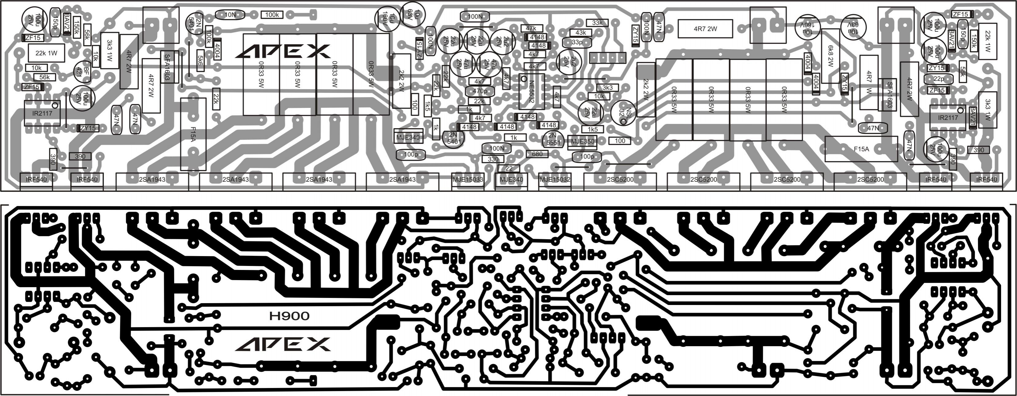

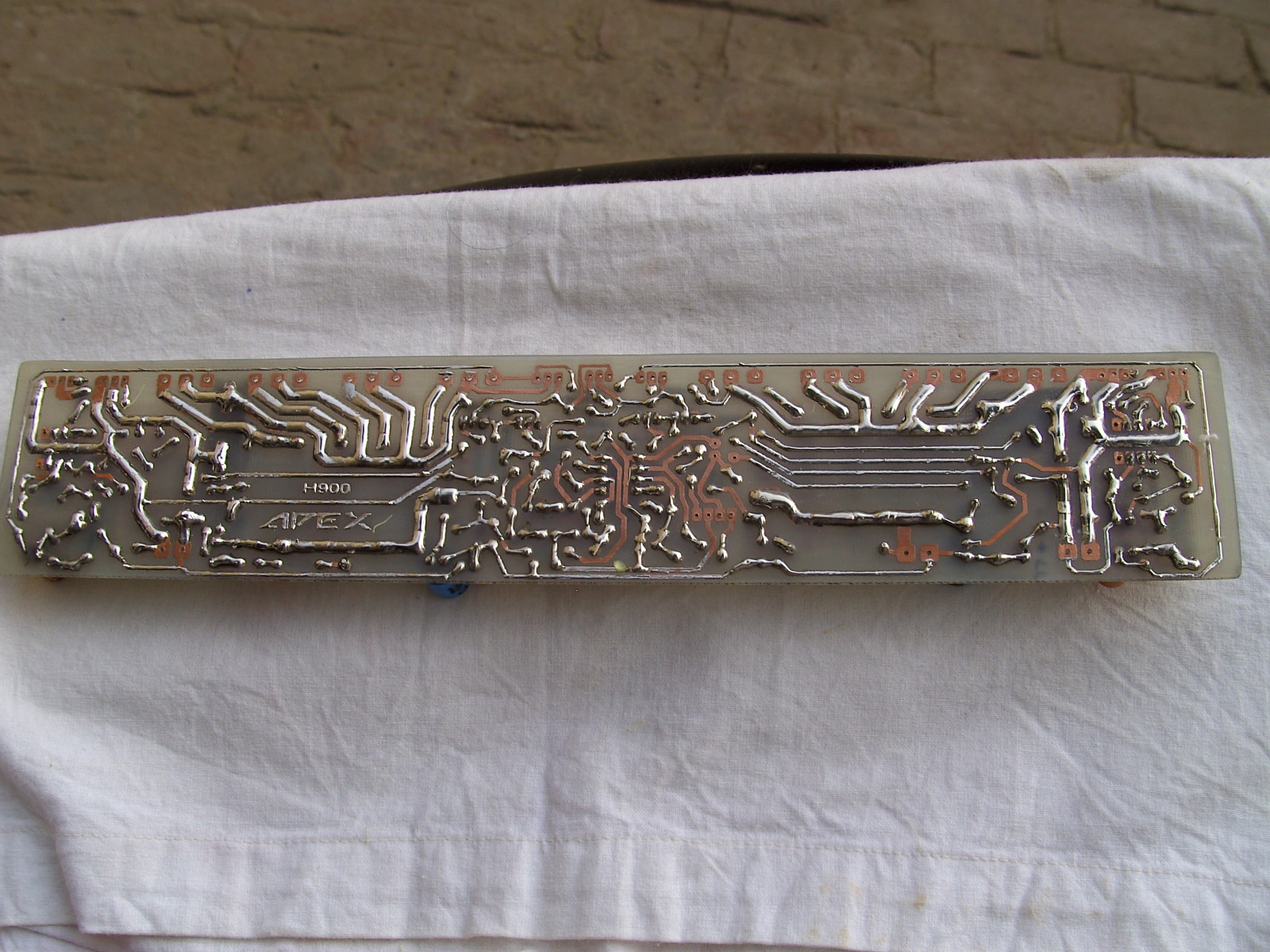

hi apexaudio

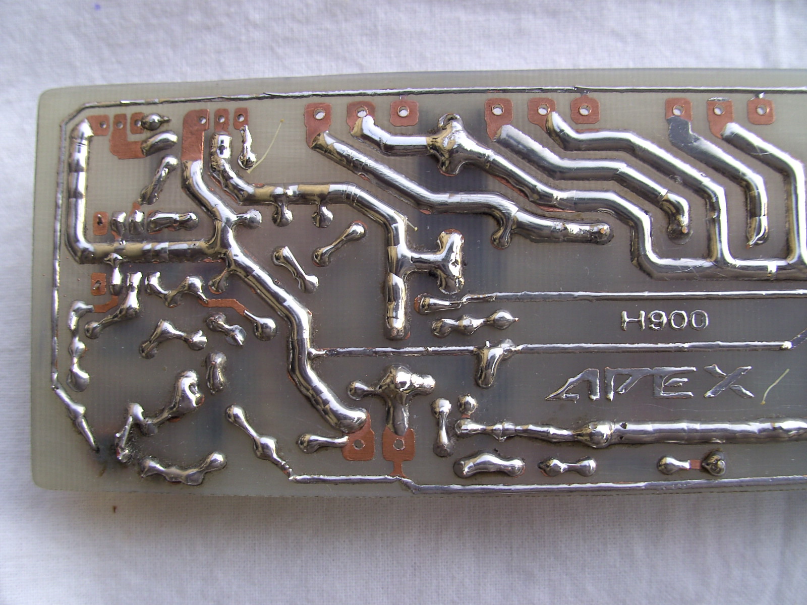

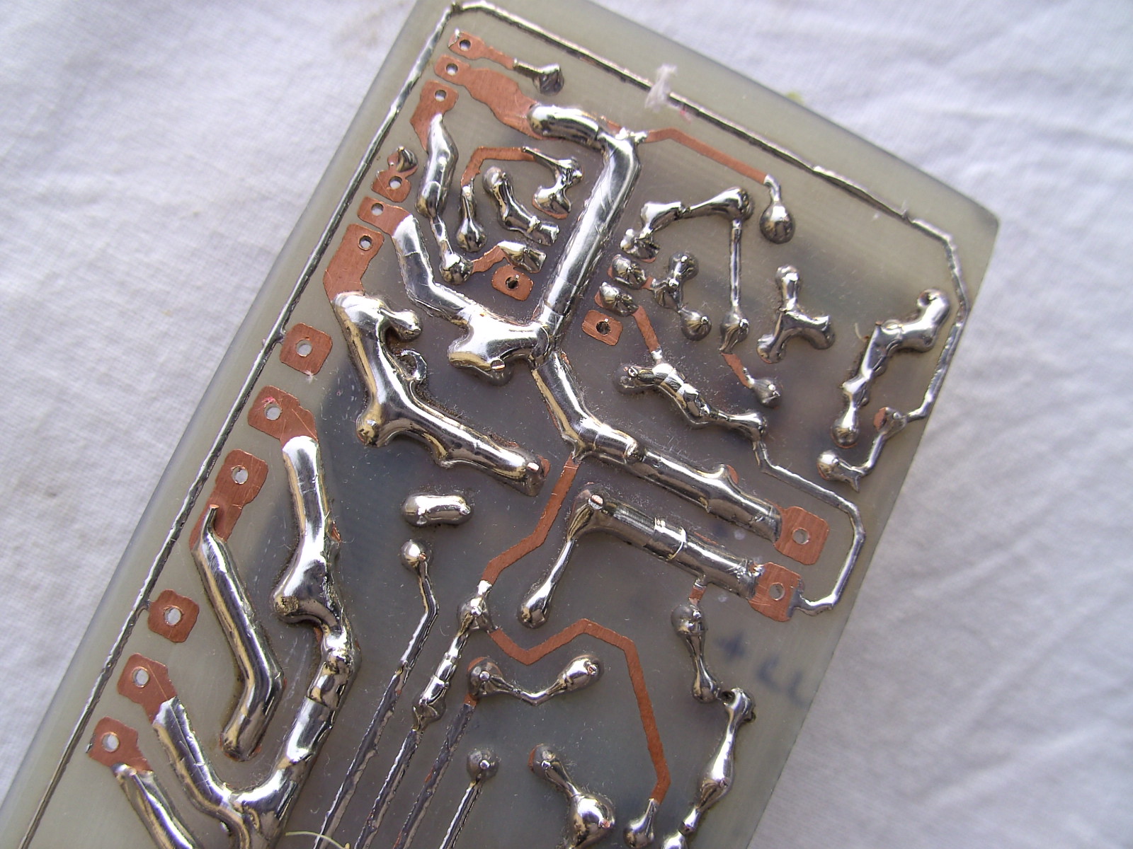

greetings posted pics of board have to smoothen solder tracks
put solder to strenghten current capability have to put strong jumpers around
irf 2807 checking for solder shorts will then clean pcb
thanking you

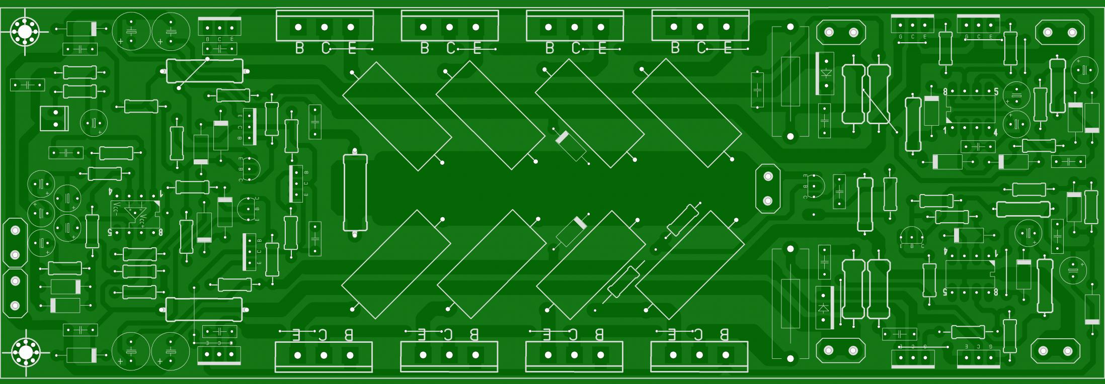

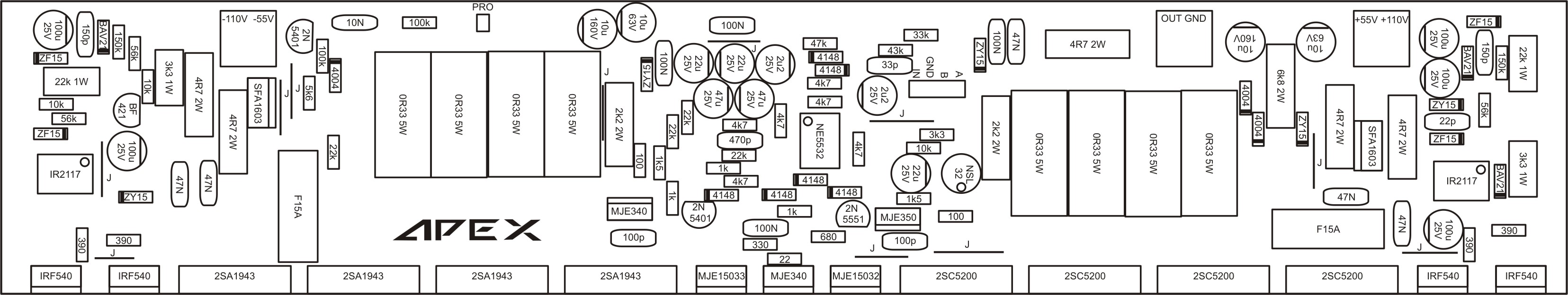

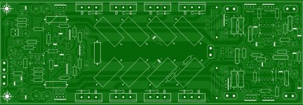

Nice work, what size it is?a new version of PCB for this amplifier ,is not yet finalized, I'll be back with the final version for corrections
U not use limiter, and there is lot of mistakes which must be corrected, keep with good work.230 / 75 mm
I designed the PCB to be used in active subwoofers with built-in amplifier
Regards
- 900W H-class PA Amp with Limiter
