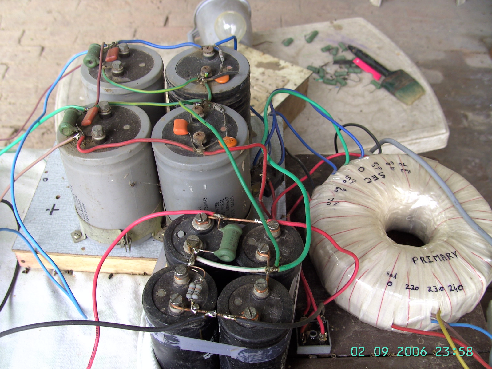

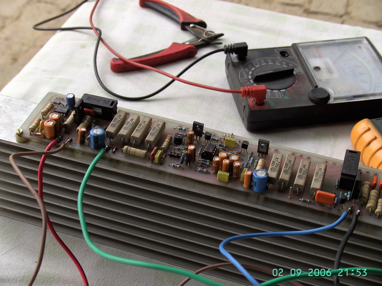

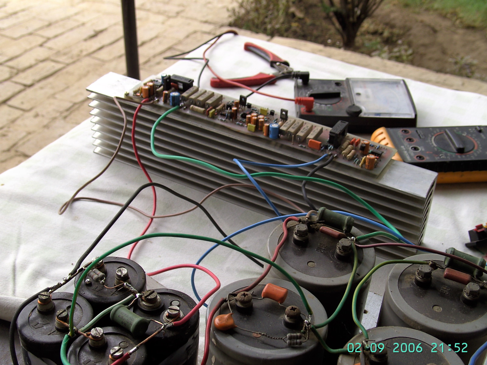

hi apexaudio
greetings
red wire 94 volts positive
brown wire 70 volts positive
green 0
blue wire 70 volts negative
black wire 94 volts negative
will send high resolution picture of pcb both rails supply drop to 16 volts approx
short suspected
thanking you

Input GND missing! Amplifier can't work without connect input GND. I can't see wire jumper (red line on component layout) on botom side of pcb, somethimes I forget connect that wire.hi apexaudio

That's correct,hi apexaudio
greetings thanks for your reply connection should be made to input gnd by seperate wire to pin next to input in is that correct
1 for pcb protect circuit for heat sensor transistor can mje340 be used instead of bd241
thanking you
andrew lebon
TIP31 can be used instead BD241, any NPN transistor can be used as thermal diode sensor but then reff voltage on comparators must be calibrate, becouse different 'Vbe on' for different transistor.

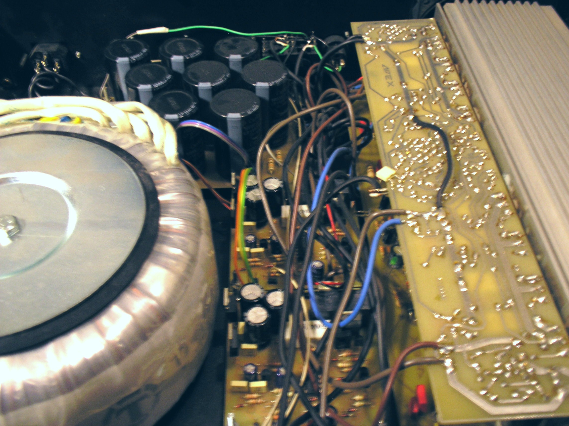

here is one of my DIY amps...

in this picture 2 pcb top & bottom share 1 heatsink?

Amplifier on picture use 2 pcbs on 1 heatsink with 2 fans, work on 0,+/-55VDC,+/-110VDC, 2500w transformer. Heatsink is about 3kg, and amp can work on 2R load, but this is H1200 amplifier, not H900.
