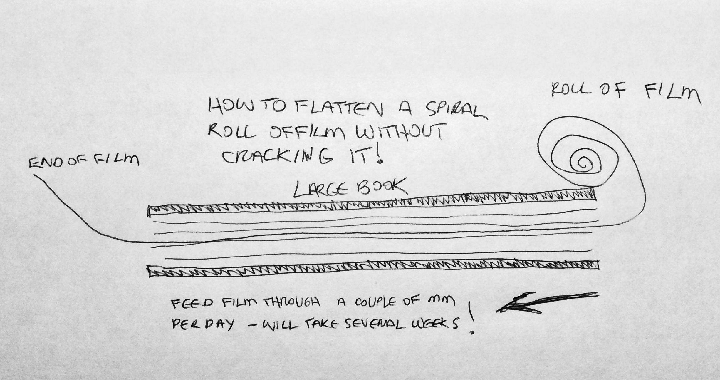

I have some 50+ years old rolls of film, 6x6 cm format that I shot in my childhood. They survived somehow, but became brittle. As soon as I try to unroll them, they break. What can I do with them? I think it is cellulose based, not acetate.
You may be able to flatten them using warm, humid air. The National Archives did this with some early sheet-film negatives dating to 1889 or so that had severe curl. They used small chambers with warm water vapor for several hours, then cooler water vapor and manual flattening. The sheets were then sandwiched between archival paper, and place under weight. After they dried, the negatives were put in polyester sleeves.
A convenient size could be three frames across, as loose-leaf style plastic sleeves are available that accept 4 strips of film with three frames each in 6 by 6 cm format.
That's a word I learned the meaning of only 3 months ago. Found a business selling flax tow. Obvious what it meant, but I did look it up to verify.-- Eastman's cellulosic photo stock business gave birth to their acetate "tow" business --
How To Flatten A Spiral Roll Of Film Without Cracking It
It may be an early form of acetate. Here is a quick sketch of a method I have used in the past to flatten out a spiralled roll of film without cracking it. As you know, the film is brittle, and it is going to take a long time to flatten them out. Feed the end of the lim into the leaves of a large book a couple of millimetres at a time. This could take months, but as they are pictures from your childhood, it will be worth it. Just be very careful, and try not to rush it.
