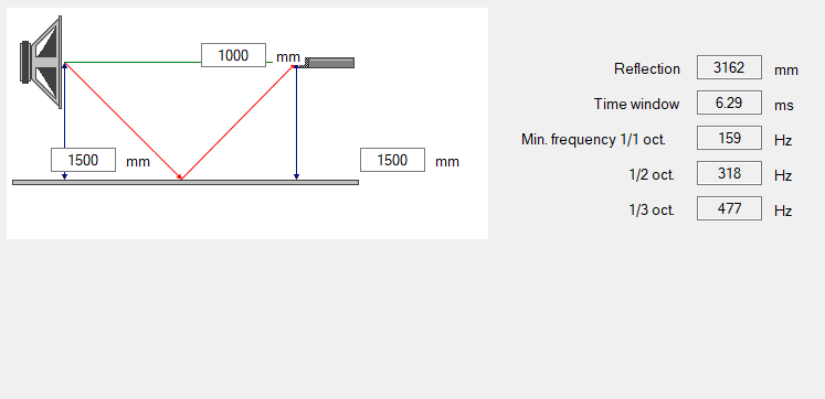

The problem is smoothing of the data. In this context valid does not mean accurate it means not total garbage, the longer the gate the better but the difference between 5ms and 6 or 7ms is not huge, it really needs to be 10ms or greater which becomes much more challenging.
You can see in the Vituix Time Window Tool the frequency at which the data loses all validity where it is 1/1 octave smoothed and the frequencies where the smoothing is half an octave and one third of an octave.

Nearfield measurements are valid somewhere up to 300 or 400Hz so it is the range from there up to about 800Hz where there is a significant loss in measurement resolution with short gates. If the drivers are well behaved and the cabinet it good then there may well be no problem and nearfield polar measurements can be taken to check for issues, impedance measurements etc.

You are not overthinking it but don't let it stop you from trying things out, as long as you know the limits of the measurement technique there is less chance of making a bad choice because of it.
Merging measurements is a good technique but the above cautions should be considered.

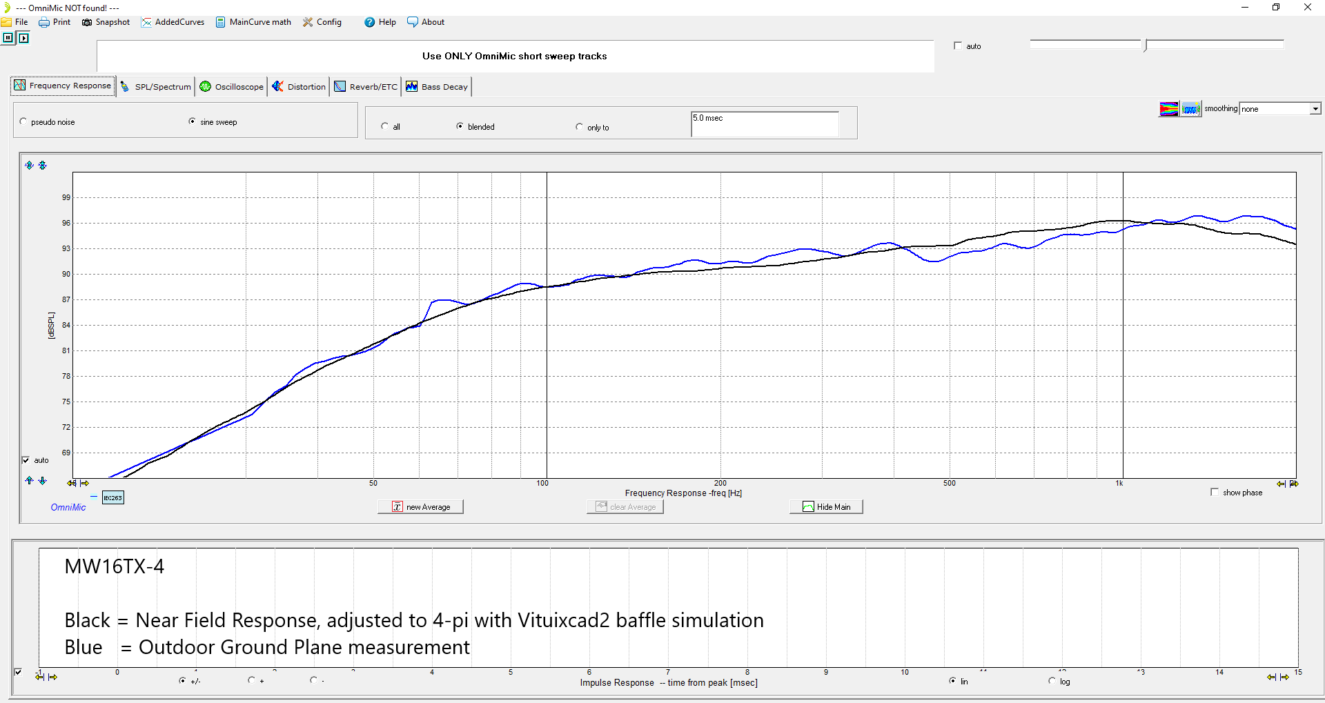

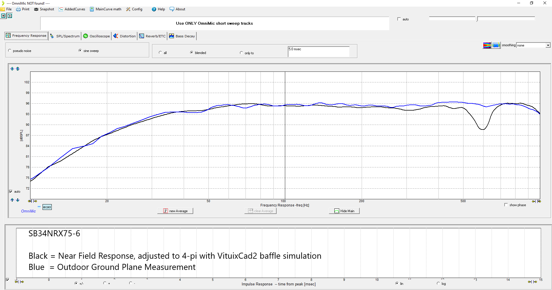

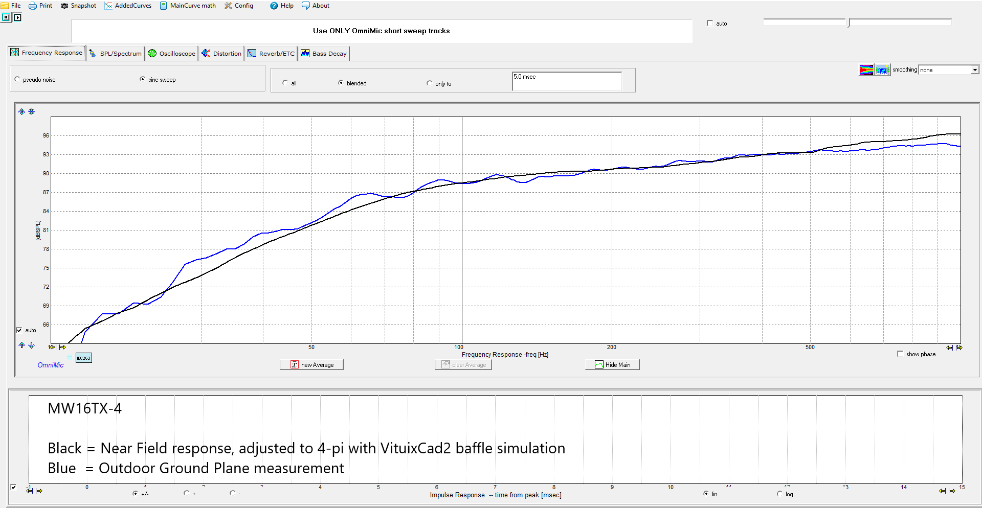

Hi Fluid... I was able to get nearfield results up to higher frequencies than what you mention. For a 12" woofer, I was able to go to 500 Hz. For a 6" driver I was able to go above 1000 Hz. The first 6" driver ground plane plot is with the cabinet on it's side, the second is a ground plane plot with the cabinet upright.
I don't have a plot to show on tweeters, but I recall that my nearfield tweeter measurements were valid up to about 5 kHz.
When I merge NF into gated FF measurements, I like to have a broad overlap between the two so I can make sure the final merged response makes sense. I also cross check the result with the full spectrum "blended" response. In ARTA, this is called a dual-gate measurement, I am not sure what it would be called in REW.

This makes sense, relative to my measurement results. My woofer has an effective Sd area of 508 cm^2, which is a diameter of 25.4 cm, so Ka=1 at 430 Hz. I was able to maintain good correlation just a little bit higher up to 500 hz, but I bet my phase was getting whacky at that point.
Same with the 6 inch driver: Sd = 119 cm^2, Dd = 12.3 cm, Ka=1 at 887 Hz, and again I showed good correlation a little bit higher up to ~ 1200 Hz.
I sometimes forget that drivers are often used above the first resonance mode. I have not done this on any of my recent designs, so it is easy to overlook the consequences. Yes, without a doubt the nearfield technique stops working as a driver approaches either the first diaphragm mode or a surround mode.

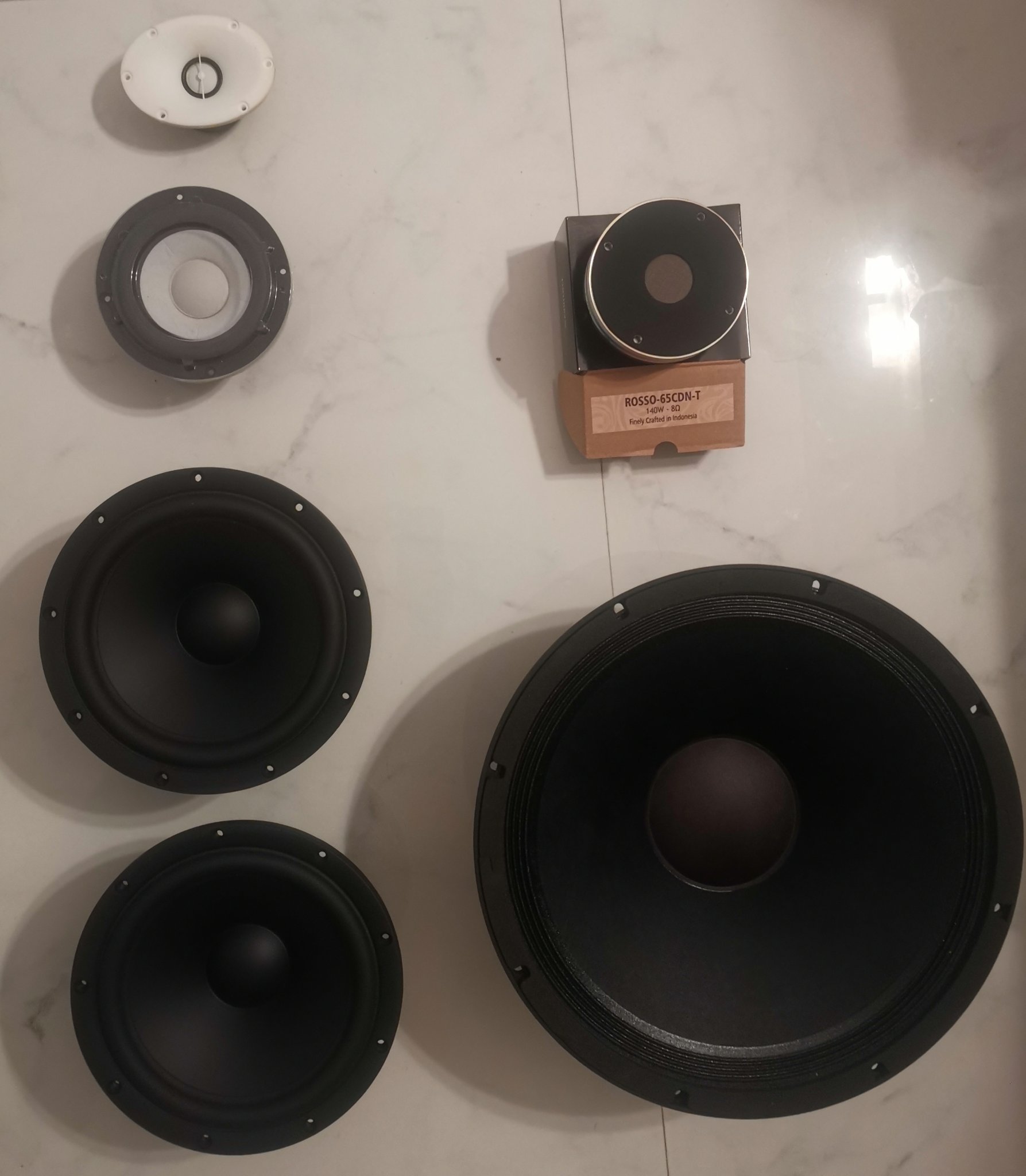

Some updates
After an eternity, I am back to my workplace. And after lot of requesting, literally begging, and fighting with the SB distributor in the country, I have been able to get two more Satori WO24P-8 drivers. :D
In the meanwhile, I got a chance to grab a 15inch Faital pro 15PR400-8 and an SB Audience Rosso-65CDN-T driver at bargain (clearance) prices. I just couldn't keep myself from buying a compression driver and the 15inch woofer seeing all the horn-related activities and threads on the forum. :D
So now there are 2 projects. The existing 3 way active project and a 2 way project with the 15inch and CD on a horn (which has not been fixed at the moment). I am still studying about all this reading the different ongoing projects on the forum.
All the hardware for crossover and the drivers I have in hand now. Just need to get boxes and put them in.. :D
I have requested some friends to help me with box building and they have started working on it. But it will take some more time due to their busy schedules.
For fun, I have attached a pc showing the driver collection. :D
Vineeth
