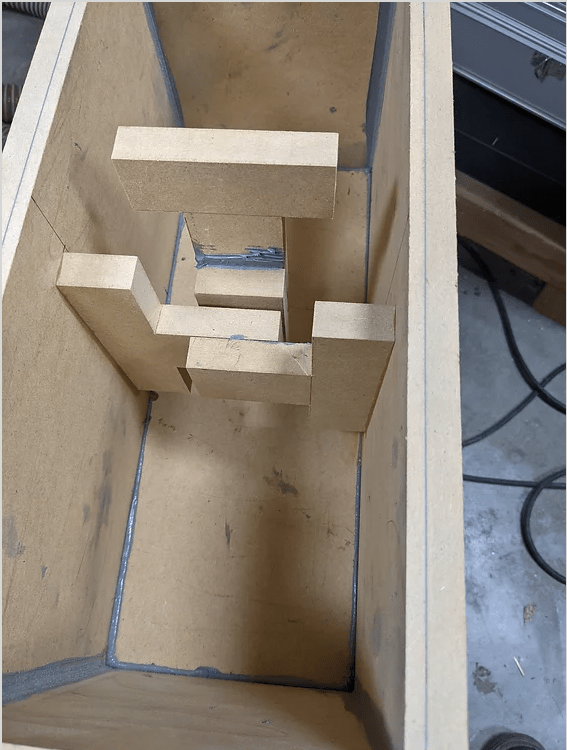

Hi @augerpro,
I have a very basic question.
How did you install the CLD bracing in the below pic:
Were the pieces of the braces attached to each panel glued already while making the box itself using the CLD panels or were the braces were attached separately (a pair connecting opposing panels, at a time) to a pre made CLD box?
Vineeth
Vineeth

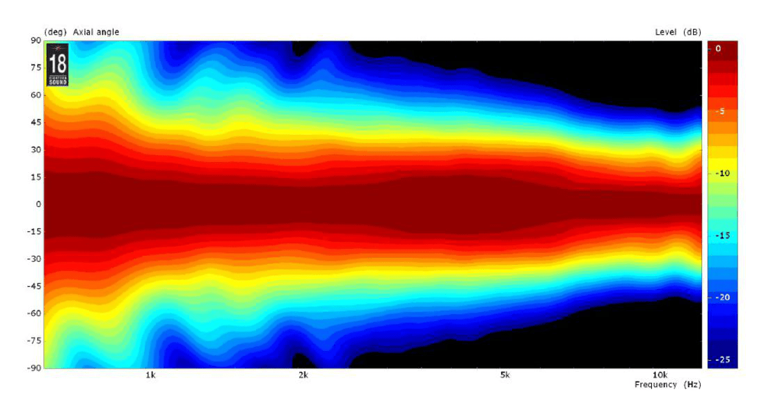

I have some general questions.
Based on what guidlines do we choose directivity index (DI) at different frequencies in a design. Is it eventual system placement in a room? Or is it dictated by choice/type of transducers?
What is more preferable, constant directivity over a wideband (700 Hz to 7kHz?) or a rising DI caused by a horn/waveguide etc.
What is more preferred?

After the box was glued up, I glued one brace on a side and one on the bottom. Use wood glue. After that is cured, I applied constrained layer to 2" of the end, and wood glue to the other and attach it just as you see it for the side brace. For the top make a piece of wood to sit across the box, so the brace as something to butt up against like the baffle. Apply the constrained layer to 2" of the end and put it in place. I'll attach a bit of tape to it and wood piece it touches so it doesn't slide down while it cures. I really need to make a video, it's so easy when you see it, but sounds more complicated to explain.
No one has done any big studies on what directivities are preferred, just that the off axis should have similar character to the on axis, and all should be smooth and straight.

Thanks augerproAfter the box was glued up, I glued one brace on a side and one on the bottom. Use wood glue. After that is cured, I applied constrained layer to 2" of the end, and wood glue to the other and attach it just as you see it for the side brace. For the top make a piece of wood to sit across the box, so the brace as something to butt up against like the baffle. Apply the constrained layer to 2" of the end and put it in place. I'll attach a bit of tape to it and wood piece it touches so it doesn't slide down while it cures. I really need to make a video, it's so easy when you see it, but sounds more complicated to explain.
I think i got some basic idea about how to do the CLD bracing.. I will read a few more times and attempt to do it next week..

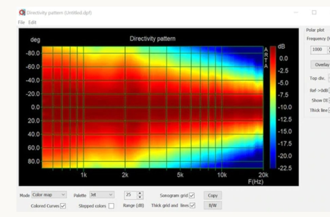

The doubt regarding directivity is, these days, I am seeing everyone trying to achieve constant like DI over a wider range of frequencies. So I started wondering whether some horns/waveguides designed in the past that have rising DI at higher frequencies is a faulty design choice or something.
For example the Faitalpro LTH142 horn vs eighteen sound 1464 horn.

You are right. I am interested in multiway speaker design and the questions were posted considering that aspect
No, they are just slightly different.The doubt regarding directivity is, these days, I am seeing everyone trying to achieve constant like DI over a wider range of frequencies. So I started wondering whether some horns/waveguides designed in the past that have rising DI at higher frequencies is a faulty design choice or something.
Thank you for pointing this out..

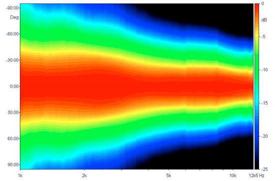

In that case how do we compare the horozontal directivity shown in the attached plot vs XT1464 or LTH142.
My doubt is if the XT1464 type directivity is right/more preferable, what can be the objective in designing a waveguide with directivity shown in attached plot?
My question is not specific tonattached plot.
For example, constant directivity is best kind of discussion is also given in this page

I think bot the XT1464 and the LTH142 are very good, they are sligtly narrowing with more-less deviation here and there.
Maybe someone who have more knowledge can explain better.
But the quick questions, that comes to my mind:
- the more constant is audible?
- if audible, then it's preferable?
- if preferable, by whom, where and with what sound material?
- is it worth the effort at all to get as constant directivity as possible?
There was shootout between the JBL M2 (constant directivity) and the Revel Ultima Salon 2 (wider dispersion with slightly narrowing response):
https://www.avsforum.com/threads/sp...akers-ever-made.2907816/page-18#post-54628832

Gainphile claims that constant directivity is best (goal) and sounds best. That may apply to his own designs , but he measured only frontal horizontal dispersion! In Princeton Univ. study we notice that his design (like all of his dipoles) have practically zero radiation backwards above 1-2kHz. When his speaker is set up in a room, listening spot response most likely is falling towards treble!
Harman/Toole & Olive studies often cited are based on normal monopole loudspeakers, which have DI rising towards treble and give sloping room response. And this kind of behaviour was regarded to sound best (using one speaker in test room). But treble must not become too low, this is why many people however like speakers with on-axis treble response rising above average.
The fun and educative thing about speaker-diy is to make different kind of speakers, with different kind of dispersion profiles! When we measure and listen to them at home (or at friend's) for longer period we gradually learn what we personally prefer best. But the fellow diyer has her/his different opinion... For example I have listened to several diy horn speakers, and they sound too much like headphones IMO.
I think there are a couple of aspects of this to consider. Where do you want to listen and in what kind of environment. The room where you have measured seems to have a lot of hard reflective surfaces. A narrower coverage pattern changes the balance of direct to reflected energy. Do you want to listen in one spot only, across a couch or in the whole room. The narrow coverage pattern will work better for a single position but as you move outside the coverage pattern the sound will change more.The doubt regarding directivity is, these days, I am seeing everyone trying to achieve constant like DI over a wider range of frequencies. So I started wondering whether some horns/waveguides designed in the past that have rising DI at higher frequencies is a faulty design choice or something.
There is an element of this in the DI of the speaker. If the DI is flat the sound will be very consistent over the whole coverage pattern, if the DI rises the sound will change more within the coverage pattern based on position.
If the DI is flat and the on axis is also flat, the speaker will sound bright with most existing recordings. If the DI rises and the on axis is flat the sound will be closer to "right" with existing recordings without needing EQ.
What is best and preferred will be a matter of balancing these competing priorities, there is no one universal right answer.
