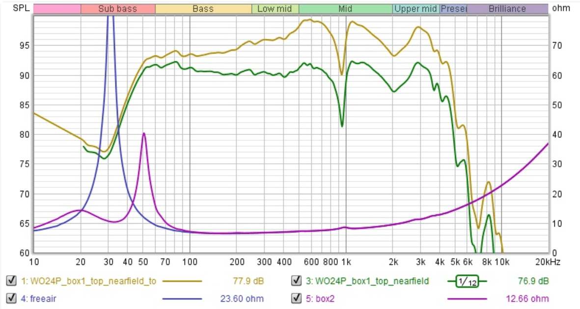

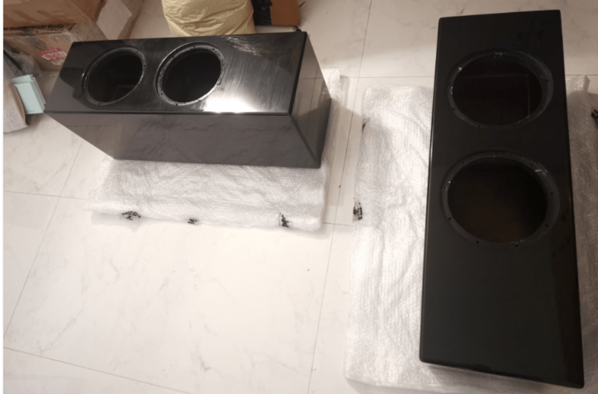

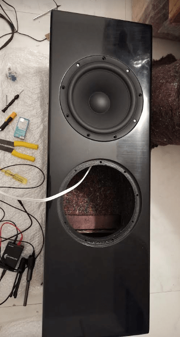

So I applied some damping material in the boxes and tried to get some nearfield frequency response and impedance measurements of a Satori WO24P-8 woofer fixed in the upper box of the cabinet as shown below.
Here is what the inside of the box looks like now with the driver removed:
Basically I glued some Alubutyl damping sheets that I had on the side and back walls. Then covered it with 10mm thick acoustic felt material.

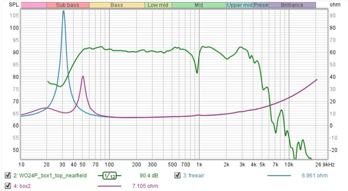

Then I noticed two impedance bumps one around 230Hz and around 460Hz. In order to try to get rid of them, I put 25mm thick 8+ type melamine foam pad that I had on the top of the cabinet as seen in above pic, one at the bottom of the cavity and one piece somewhere around 1/3rd of the height. I also put a loose roll of polyfill on top of that as seen in above pic.
Here are the impedance measurements of the driver in free air and and box as treated above.
Also shown in the nearfield frequency response of the driver
Now the impedance blips around 230Hz and 460 Hz seems ?to be gone.
what all useful information can we get from above plots???
I am also yet to fill th8e enclosure.
what do we get we get from filling the enclosure?

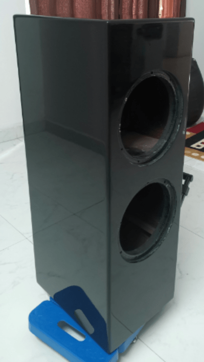

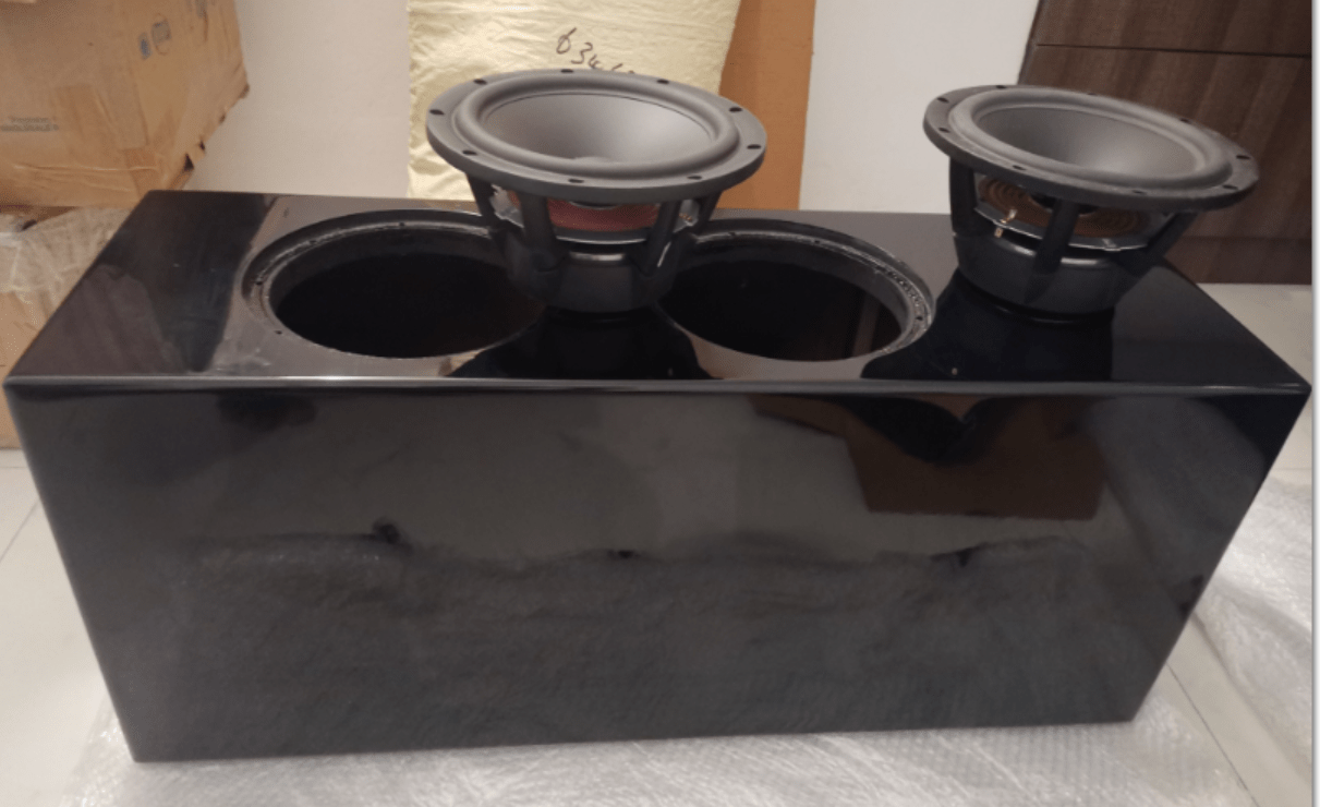

If one of the woofers was out like in the picture it wouldn't tell you much, if they were both in then there is a leak which is seen by the double hump in the impedance.
The dip at 950 corresponds to an impedance blip but nearfield measurements are usually not that accurate above 400Hz and dip is probably from that. Otherwise pretty well behaved but with the slight bass lift it could sound a bit boomy.
Filling the enclosure will increase the apparent volume of the box and change the tuning.

There is also a very small hole in the piece that separates the two driver boxes through which the wire comes out. I will close it fully, then attach the 2nd driver also and take measurents again. Each driver has a 35ish litre sealed box of its own in the big enclosure. so even without the second driver, the current driver is supposed to have a sealed box of its own.

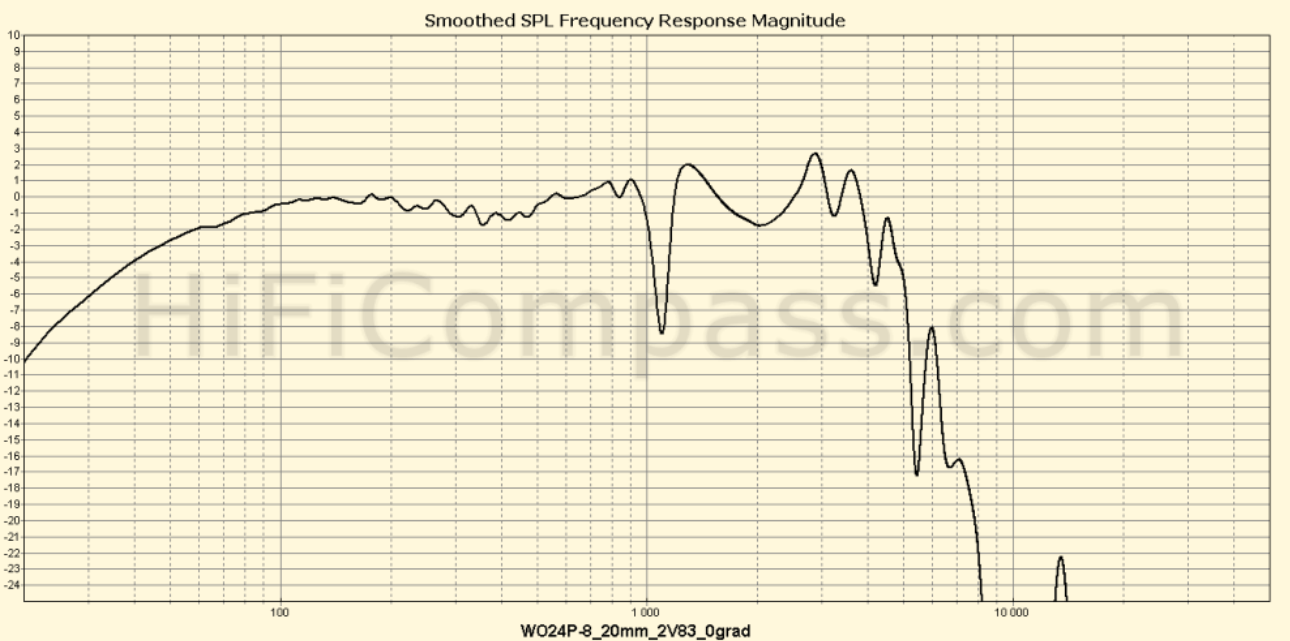

The 950Hz dip is there even in the drivers natural response. This is also seen in hificompass's measurements. I thought it is caused by the Surround of the driver itself.
The nearfield measurement is not baffle step adjusted. Part of the bass lift seen the plot is due to not adjusting for that i think. I will create the the baffle step adjusted pic using vituixcad ad post it soon.
Also is loosely teased out polyfill enough for enclosure filling?. The current box tuning frequency looks to be around 50Hz.
The dip at Hificompass is about 1dB at the same frequency yours is more like 10 and quite high Q.
At 1k you are in the difficult to measure with high resolution range for gated measurements and nearfield becoming unreliable so you would have to cross correlate all the different measurements to try and work out what is going on.
I would try a piece of fibreglass or something like that placed in the middle of the enclosure between top and bottom on a brace if you have one near there. That might help kill or at least reduce any problems from the long dimension.

It is hard to see when the impedance traces are overlaid but check to see if the blips are at the same place as they are in free air. If not they come from the cabinet and you will need more damping or bracing if you want them gone.
You don't have to fill the enclosure at all.

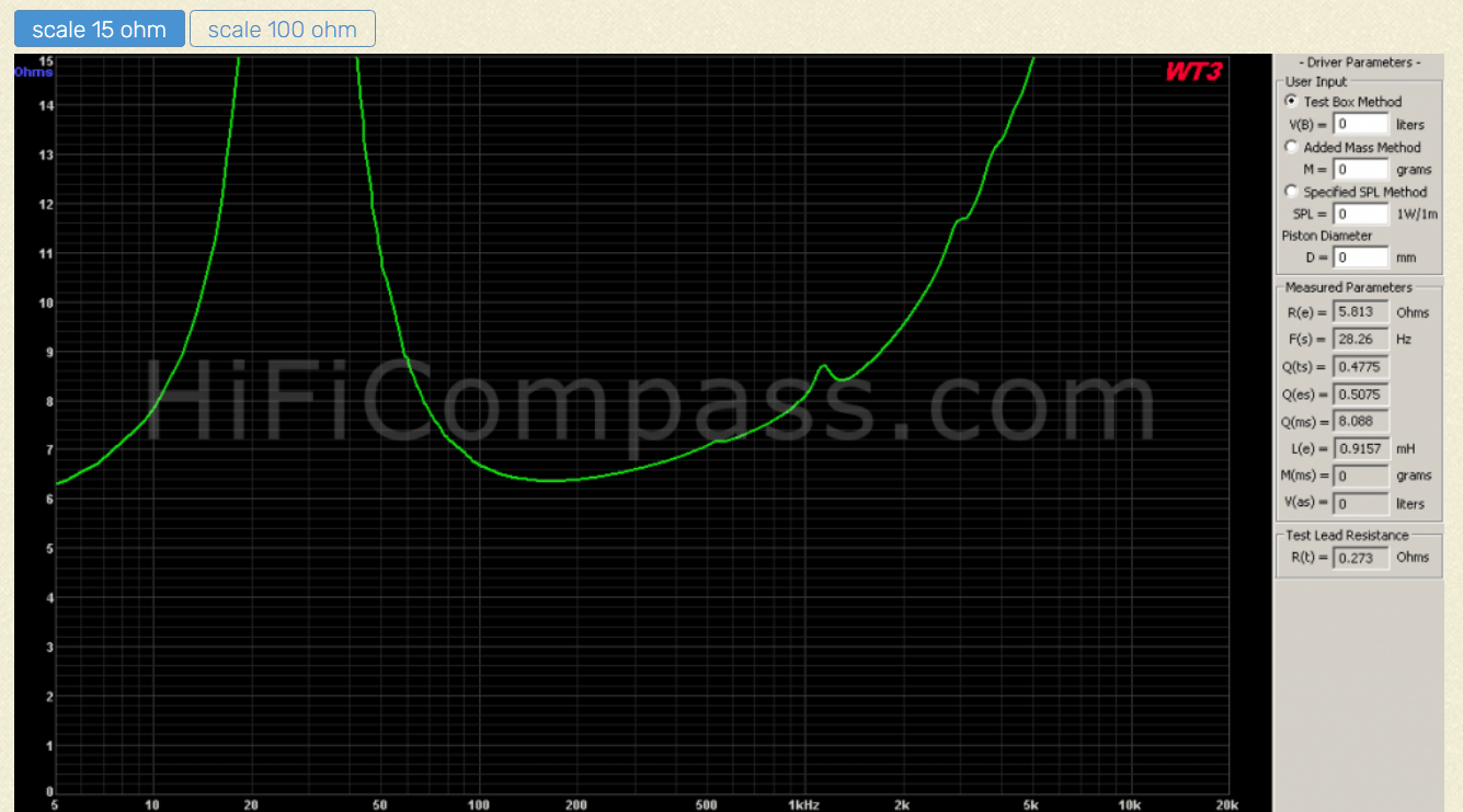

This plot I got from hificompass. normalized nearfield for the same driver. It shows a deep notch around 1kHz similar to mine.The dip at Hificompass is about 1dB at the same frequency yours is more like 10 and quite high Q.
Hificompass impedance measurement zoomed in (it shows that blip around 1kHz and sort of its integer multiples):
Yellow plot below is my baffle step adjusted response and green, the not adjusted one as earlier.
The impedance bump around 950Hz is there in both the free air plot and the driver in box plot.
Both curves are overlapping there. This is why I thought it is driver related.

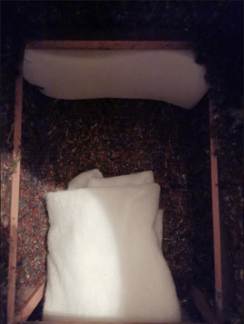

Actually the long dimension already has 3 pieces of 25mm thick melamine foam and 30ish cm long roll of polyfill in a cylinder like shape with the round face of the cylinder having a diameter of about 15cm. All this did get rid of bigger impedances bumps which were there earlier at 230Hz and 460 Hz.I would try a piece of fibreglass or something like that placed in the middle of the enclosure between top and bottom on a brace if you have one near there. That might help kill or at least reduce any problems from the long dimension
I am not allowed to bring fibreglass material inside home as people at home are worried about its potential health hazards. Hence all this circus with other alternative material..
Also this driver is brand new. Its fs also looks to be around 30Hz from above blue impedance plot which is different from the published 24Hz fs.
So once I start using the driver more. Will these parameters change?
I speculate the 1kHz dip might be cone edge resonance or surround resonance or how it is called? edge moves at opposite phase than center of the cone and destructive interference happens, especially on-axis. How big is the driver? distance from mic (close miced) to edge is about half wavelength? Is it in far field response as well? Thats quite a deep notch anyway
edit. foundit https://hificompass.com/en/speakers/measurements/satori/satori-wo24p-8
The blip is not bad on farfield response, perhaps it is some resonance because impedance blip and magnified with distance from mic to cone edge when close mic. Frequency of dip changes perhaps just with distance from mic to dustcap.
There is that deep notch in nearfield response, impedance bump around the same frequency, steep rise in even and odd order harmonic distortion in the different harmonic distortion plots all around the same frequency. It seems to be distance dependent as the 315mm HD plots at hificompass show lesser rise in distortion compared to the 20mm measurement. Also far field frequency response don't show such pronounced dip.The blip is not bad on farfield response, perhaps it is some resonance because impedance blip and magnified with distance from mic to cone edge when close mic. Frequency of dip changes perhaps just with distance from mic to dustcap.
The other thing we have to keep in mind is what fluid said about nearfield measurements becoming not really trustable at such high frequencies.
But there is something going on around that 1kHz frequency
I wonder what exactly is the cause of all this..
1kHz being a subharmonic may also be seeing rise in distortion components due to that. Just speculating.....
Yeah its fun try and imagine what might it be, but its gonna be there nevertheless and swapping driver is only way to change it. But hey isnt't it stop band of the woofer box in your application? so doesn't matter much anyway.
It would be nice to know what it is, how much does it matter in application and how to spot it from measurements if it does matter, or distinguish from other possible phenomena if it doesn't. Lets see if some one knows what it is
I wonder if and how it shows up in a spinorama if you make one.
