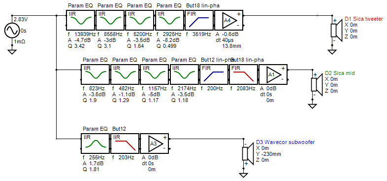

A crossover making exercise using linear phase filters 😀
I have updated the latest project files here if anyone wants to take a look
https://drive.google.com/file/d/1a7JggO4WGSuuGhyxZxYnpzWRJGMYqD3h/view?usp=sharing

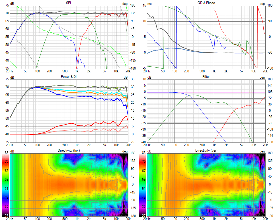

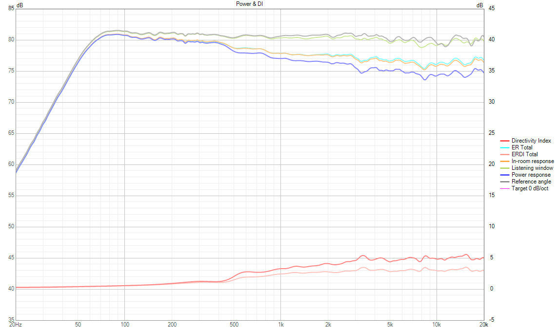

It might be just me, but the peaking in the 400-500 Hz range to me would not be desirable. Otherwise, this looks very very good.

Peaking at 4-500Hz might be a measurement artefact, if simulation is done per IRL measurements.
I'd love to hear your impressions of the minimum phase/minimum latency crossover differences. I feel like I can hear the 'flips' in big multiway systems sometimes. Not often in music, but more so when there's a slide on a stringed instrument or an electronic track. It's practically screaming at me during sine wave sweeps for room correction.

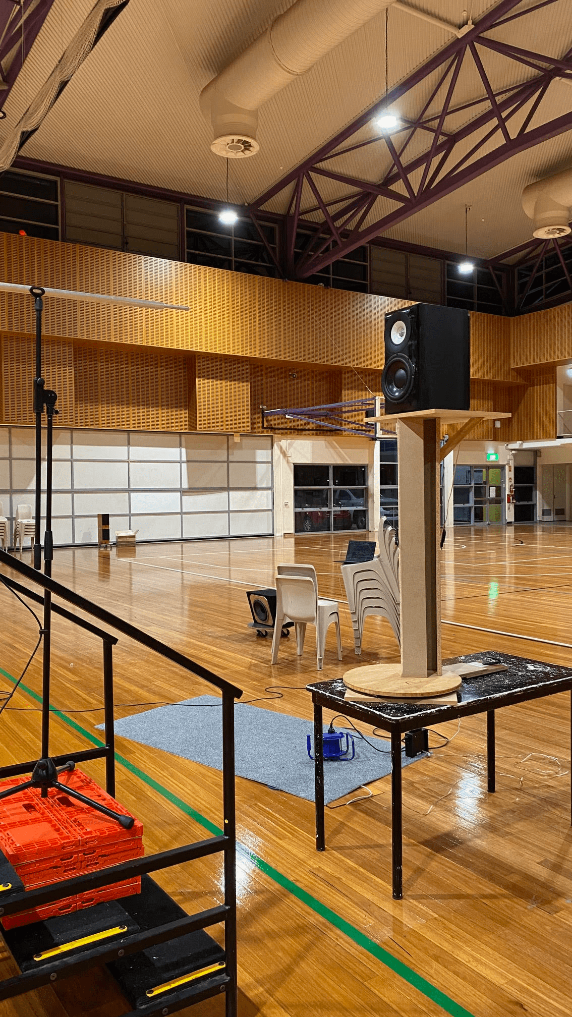

yes, that could be true. With the standard process of merging near field and gated (4 - 8 ms) far field measurements, combined with a calculated/simulated baffle diffraction, results in some measurement uncertainty. The maximum measurement uncertainty is usually in the 200 - 600 Hz range. In this range, the NF response is highly influenced by diffraction simulation, and the far field response has low resolution due to the gating.Peaking at 4-500Hz might be a measurement artefact, if simulation is done per IRL measurements.
Fortunately for all of us, this is a region where ground plane measurements really shine. With a 15 ms gate, we get good resolution down to 200 Hz. With a ground plane measurement, 15 ms is sometimes possible in a large room. Or outdoors we need just a small flat area.
It is also possible to judge this region subjectively by ear. If there is a peaking at 500 Hz, he will know it soon enough...
@hifijim ,@wolf_teeth, Can you help me by pointing out the 400-500Hz bump? Is it the 1 dB bump in on axis response around that region, after crossover?
I think I might have to try a ground plane measurement as well next time I get a chance to measure.
Also, I realized that the c-c spacing of the drivers is 23cm which is less than 28cm (1/4th wavelength at the 300Hz crossover). So can this speaker be called a point source speaker? 😀
Between 100 and 1K there is a 1dB rise up and fall down peaking at 350Hz. The woofer crossover shelves out adding a little bit more output throught that region. The really deep null in the native woofer response at 1K is a little strange too.
Thanks @fluid.
Now I understand. I will take a look at the woofer curves again. The woofer shelving out later in its slope down area looks a little strange.

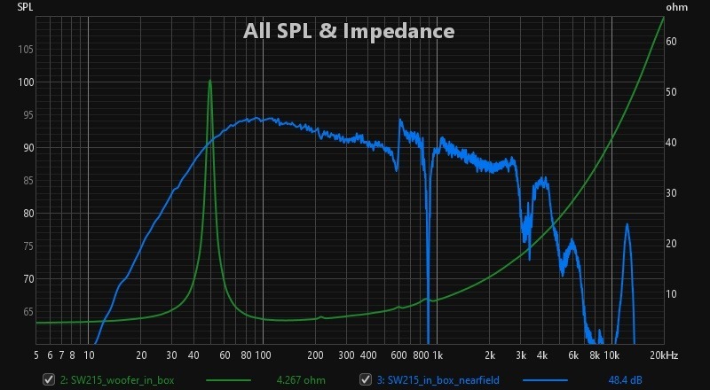

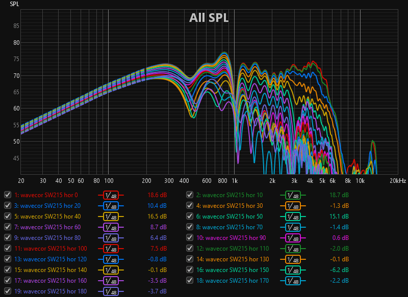

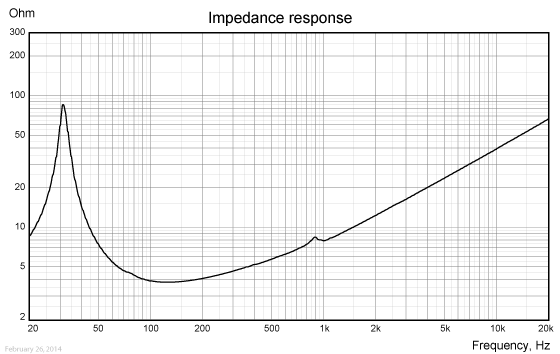

I think the 1kHz deep dip has something to do with the big surround of this subwoofer driver ( Wavecor SW 215) The company data sheet shows this.

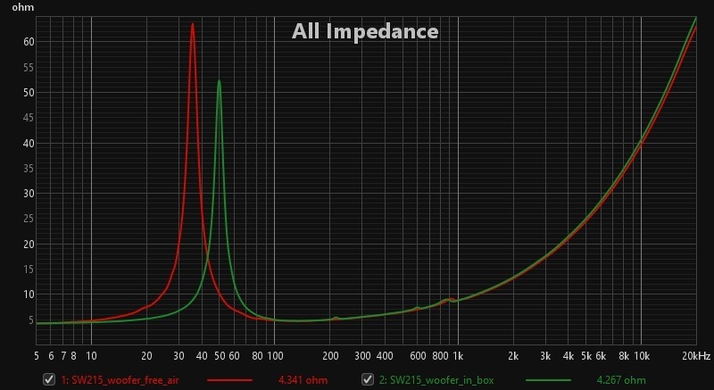

My impedance measurements and neafield for the driver in box looks like this (before baffle step adjustment)
and the polars before merging with nearfield like below. I suspect the very low frequency resolution and the window effects in the low frequency region is contributing to the wiggles as well. Also there are resonance around 200Hz, 600Hz, and 900Hz. 200Hz one seems to have minimal effect but the other two have more effect
The overall +1 dB rise running from 200 - 800 Hz... as @fluid pointed out. This is the kind of thing which is usually taken care of during the subjective voicing process... It is really hard to judge the impact of 1 dB humps by examining a frequency response plot... it may be a non issue. Room positioning will have a substantial impact on this also. So even if this is NOT an measurement anomaly, it may have no sonic impact.Can you help me by pointing out the 400-500Hz bump?
Generally, my preferred frequency balance is to have the maximum at 50-100 Hz, and then a very gently downward slope from 100 Hz to 10k, and then flat above 10k.
Overall your project looks really great so far.
hifijim +1, NF+FF merging process is not exact (especially matching NF level to FF level where both overlap in broad frequency area, at least they should, but often it is not the case so one has to decide by the feeling, so +-1dB NF/FF level mismatch can occur), same goes for gated measurements with ~4-5ms window. So this all, especially for 3way with lower crossover ~300Hz, is a guess. One should do the procedure as precise as he can, but must be aware of the weaknesses of the method, and make crossover adjustment based on subjective evaluation.

I'm with @IamJF here. A broadband 1dB rise will change the spectral tilt of the entire speaker. It is enough for me to want to unpad the mid and tweeter a bit if left that way, and if the measurements are reality. If it is just a splicing anomaly et al, then it may not be present as described.
The +2dB@240Hz in the woofer xover for that matter is likely debatable for the same reason, and likely may not be needed. I think this is what is causing the issue in the on axis response.
We really are splitting hairs here, but as far as hair goes here, you want it rather controlled and not unkempt.
